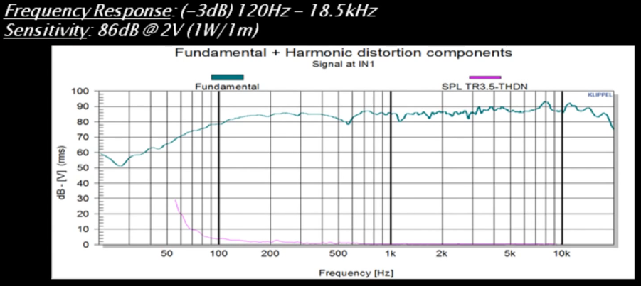

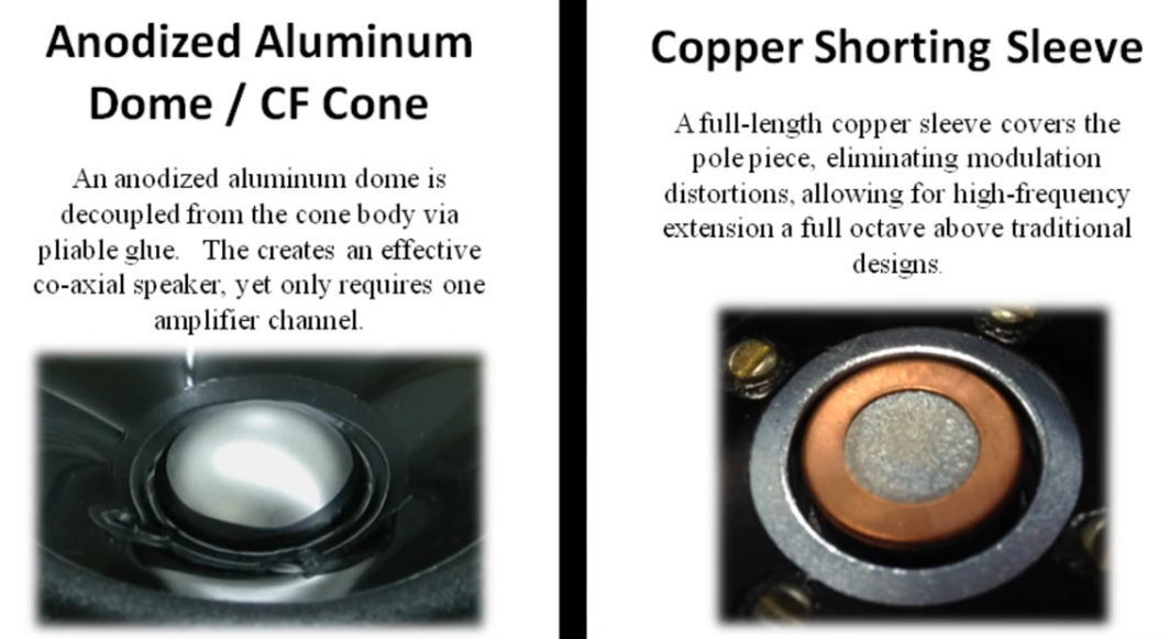

Those Jeep parts look awesome, the price is ridiculously low for what you get, especially the 6.5" drivers too. The sub costs a lot but the other drivers are attractively priced.
I did not watch video for 6.5 in driver - how good does it look and what are they charging?

Agree those Alpine parts looks awesome, initially thought because of that dip between 500 and 600Hz that it has under hung surround and dip will be reflected off axis too but picture show its not underhung surround, great if X gets a pair and share with us.

The way they detailed the design process was very nice. They know what they are doing with the driver design. The 6.5 inch has a decent amount of xmax, a very stiff, but damped cone and has been designed to work well in very small boxes. The inclusion of the shorting ring is excellent too as it's one of my criteria for a well designed driver.
No this driver will not do anything but work as a bass unit but for that use it looks pretty good. I don't think it has a pole vent, which is my only misgiving, but they cost less than $20, I don't know what shipping to the UK would be like, but this could be a very nice driver for the bottom of cheap three ways or compact FAST systems.
The 3.5" really intrigues me too! It's a shame the sub unit is $150.
