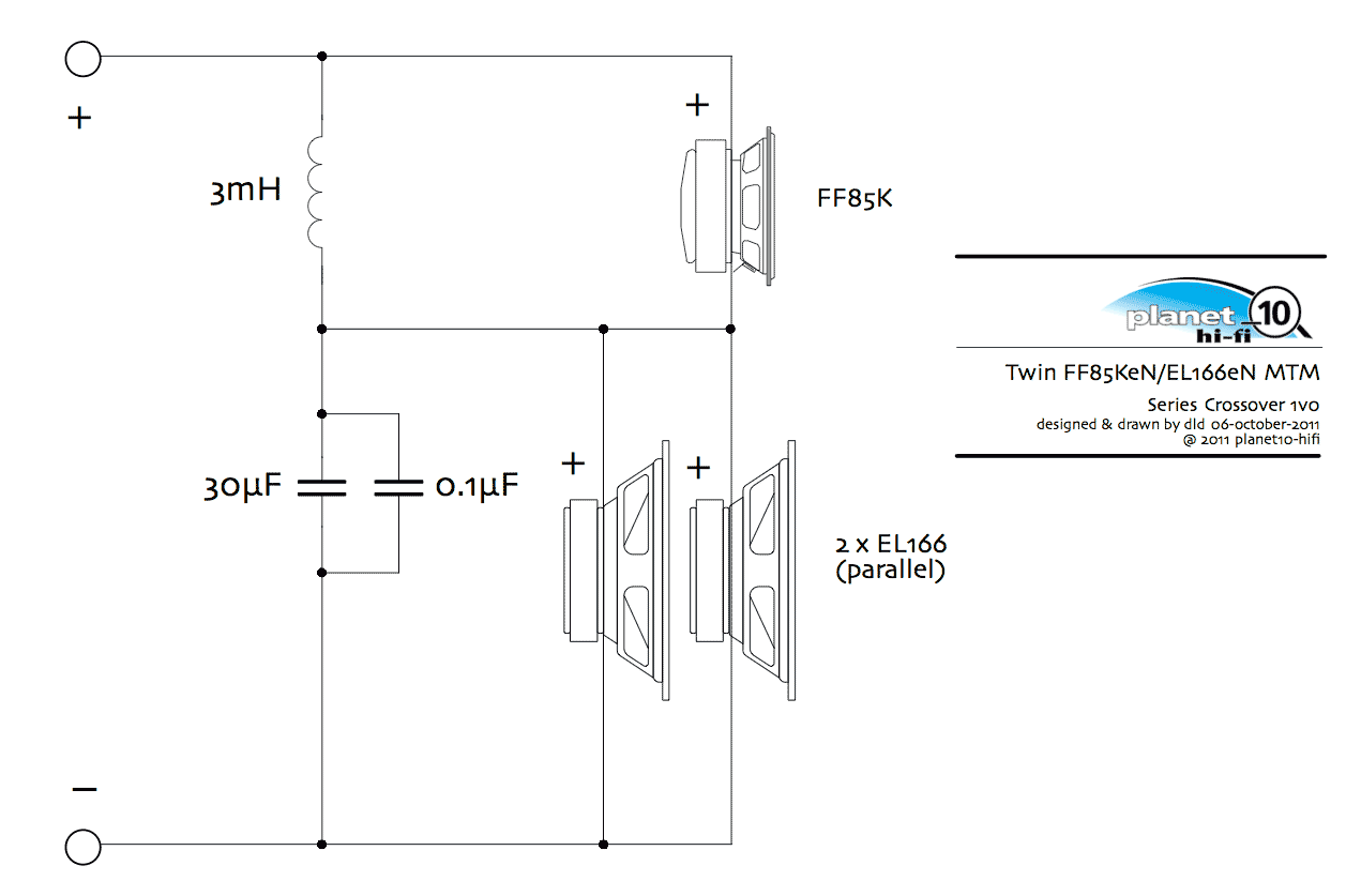

Woden Design's Twin EL166 ML-TL (with my own variations). Executed as an MTM with an FF85KeN. We started this one before FF85 was discontinued, you could use your favorite mid-tweeter -- i think Alpair 6M should be a good candidate -- or a tweeter of your choice.
Lots of good well controlled bass. Even thou XO work is still at early stage, i am quite happy with them.

Here is the XO we ended up with.
The new FF85wk should drop right in.

Part of the design brief with Tysen was to keep it slim. They need to be toed in 30 degrees, woofers on the outside for best performance. At the frequency of the XO the drivers are essentially coincident. The XO and the shapes were all carefully tailored.
Now when we did the MTM with EL166 we did all those things you suggest. XO was much simplier and could be passive. About the same XO point as Tysen.
