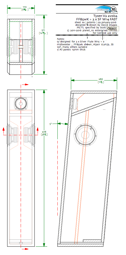

Were plans with dimensions ever published for this design?
Here is what i mean... this is the one with the 3.5 litre bass enclosure.
http://p10hifi.net/tlinespeakers/FAL/downloads/miniTysen-0v7-map-200509.pdf
You could substitute Alpair 5 or 6 or a 3" HiVi or a TB or ...
dave

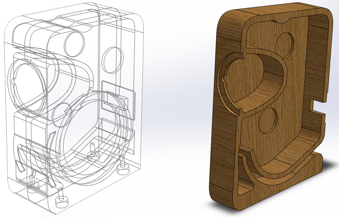

This project research was inspired by a pair of DIY Boenicke W5s I saw on FB, carved out of solid oak. this design did have a long curved internal port which flared to the back.
I am pretty far from understanding all the terms and math involved in cabinet design.. but this does seem important....
Also, the small bullet shaped sub enclosure in the W5 is also way smaller than the chamber in the design Planet10 posted earlier. Is there an ideal volume for this chamber?
I am thinking either the Fountek FR89EX or the original FE85.
I am still deciding many aspects of the project, especially the electronics. The minidsp active XO is appealing, but adds a lot to the cost. A 2.1 tripath amp is probably more practical, but I have not found the right one yet.
Any advice?

It's probably not out of turn to suggest that as a general topology, with appropriate revisions to suit T/S parameters, any combinations of your favorite - or ready at hand- FR drivers and mid woofers could work well in this configuration. I of course have a couple of my favorites - including even the polka dots, but I'm not about to be dogmatic one evangelical about them.
I'm eager to try a set of these with the option for both passive speaker level XO and active bi-a ping . Sooner or later I may even need to invest in mini-DSP nano or some such.
It's just been a bit hectic for me lately, and I'll be away from the shop for at least another week and half.
Colin -even with access to a CNC capable of that depth of cut, such a fabrication from sold wood of any species could be tricky.
As for 2.1 tripath, or similar amps, I think the limiting factor would the quality and flexibility of the XO filter circuitry. Personally I'd always be inclined to external amps and XO, or at least something like the mini-DSP and plate amp systems - not inexpensive though, and sizes may also not suit a compact project.

ChrisB, the solid wood design I saw on FB was done with a drill press and a range of different radius Forstener bits going down to a uniform depth many many times until the cabinet void was turned into a huge pile of shavings.
This seems like it could be tedious and require a lot of hand cleanup with a router / dremel... But, it does look doable without CNC.
I am not sold on the solid wood idea - it is cool mainly for aesthetics which is part of the appeal of the Boenicke. (I may get access to a CNS and cut the curvy parts out of layers of plywood, which would also look cool)
I will try to get permission from the guy to post it here.
