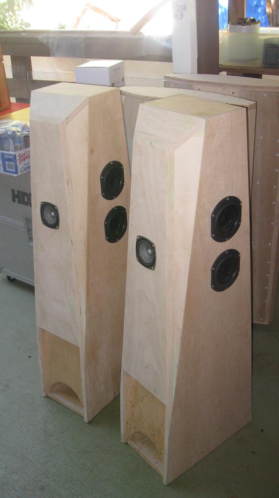

Tysen was designed as an illustration of a concept. Since then we have done the MTM floorstander (in this thread), an MTM stand-mount (FF85wKeN + 2 Silver Flute W14eN), a woofT for the uFonkenSET (with 2x Peerless 830870), the Facets with FF85wKeN and 4 of the Peerless (pictures of the last 2 unfinished in the 10th annual VI diyFEST thread at least), and Alpair 7.3eN with 2 SDX7eN -- probably our best speaker to date, we are holding off on pictures until they get pretty (in the works).
![366766d1376971631-10th-annual-vancouver-island-diyfest-2013-new_mtm.jpg](https://www.diyaudio.com/forums/attachments/clubs-events/366766d1376971631-10th-annual-vancouver-island-diyfest-2013-new_mtm.jpg)
Yet to be clad in, and cosmetically softened, by 1/2" cedar "veneer" with edges rounded all round.
dave
