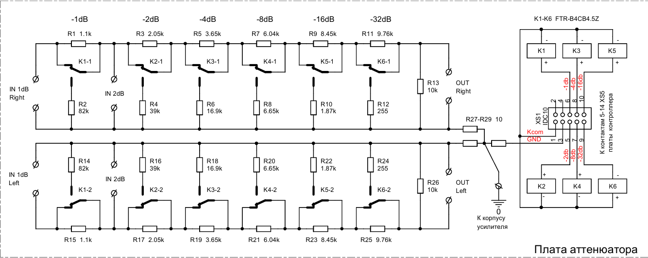

What is the purpose of these boards with relays?the boards with relays
If these boards with relays are for speaker protection you don't need them because the amplifier itself has own speaker protection circuit. Also note that ground of the amplifier is the first terminal next to the speaker output.

Dear Berlusconi, these boards are the so-called Nikitinsky relay volume control, as I wrote, controlled by a controller with a display. Its power supply has a soft start for a power transformer, protection against a constant component in the 230v network and temperature protection, as well as various settings and opportunities. I give a link to the forum, I think you can read the translator for review. Do you think this is a problem when the ear is close to the speaker and the hiss is barely audible?
Probably not, it is more likely to be grounding problem. But, when solving the problem try to eliminate all unnecessary complexities. If you really need to attenuate the input signal use a fixed resistor or a potentiometer instead of that complex thing with multiple relays.Do you think this is a problem when the ear is close to the speaker and the hiss is barely audible?

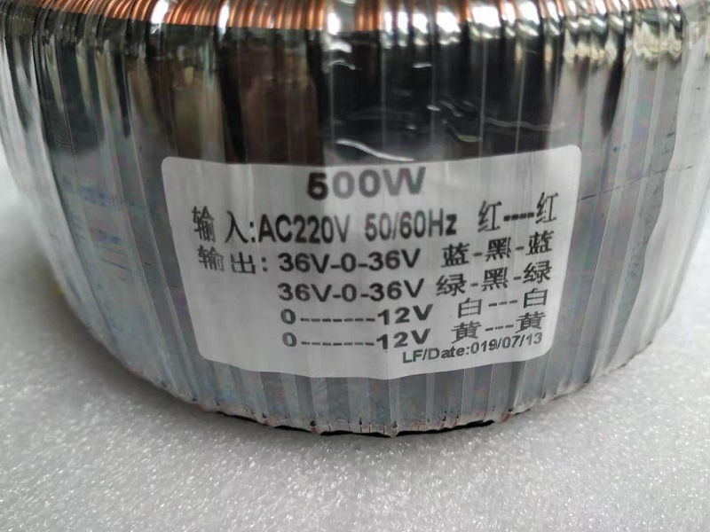

Also: do you have separate two 12V transformers for speaker protection circuits? You need either two small transformers or a single transformer with double separate two 12V secondary windings. A single 12V transformer common for the both channels creates noise.
Try to be systematic: first try just one channel simply connected to the main transformer and speaker protection transformer. If this works, then try connecting just the other channel. Then continue with both channels connected simultaneously. You need first to allocate the source of the problem. Also, do all tests with the minimum bias settings. 20mV at the "test" points.

The relay volume control is good, better than ALPS, I’m not using it for the first time, especially since there is a lot that can be implemented on the controller, everything cannot be described here. Transformer with separate windings. I wrote that at the moment grounding does not affect the noise, then when I assemble it to the end, I will experiment.

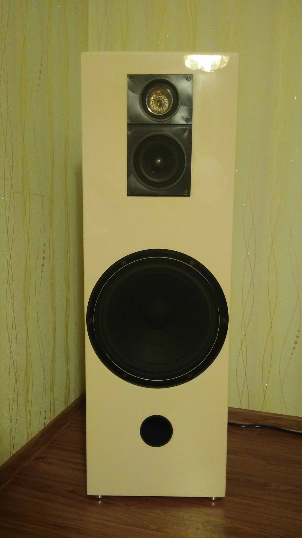

I do all the measurements on load resistors of about 8 ohms, instead of acoustics, and plugs at the inputs. After setting the quiescent current to 20mV, I connect the speakers in an hour. I can barely hear the hiss in my ear in the tweeter. Grounding is not yet connected anywhere. But I temporarily soldered the wire to the case from the negative terminals of the inputs - there were no changes, which indicates a good layout of the boards. I think so, please fix it.

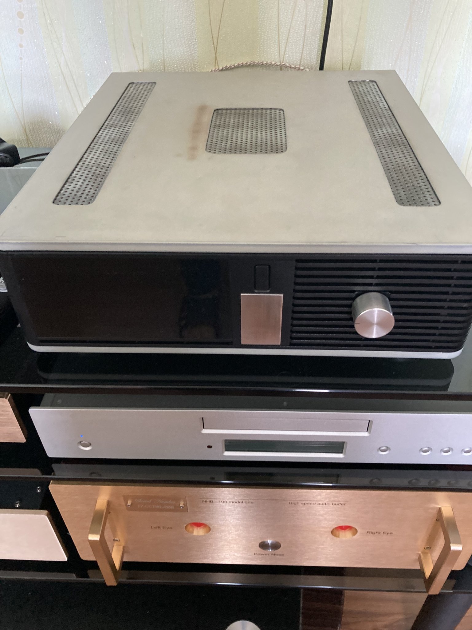

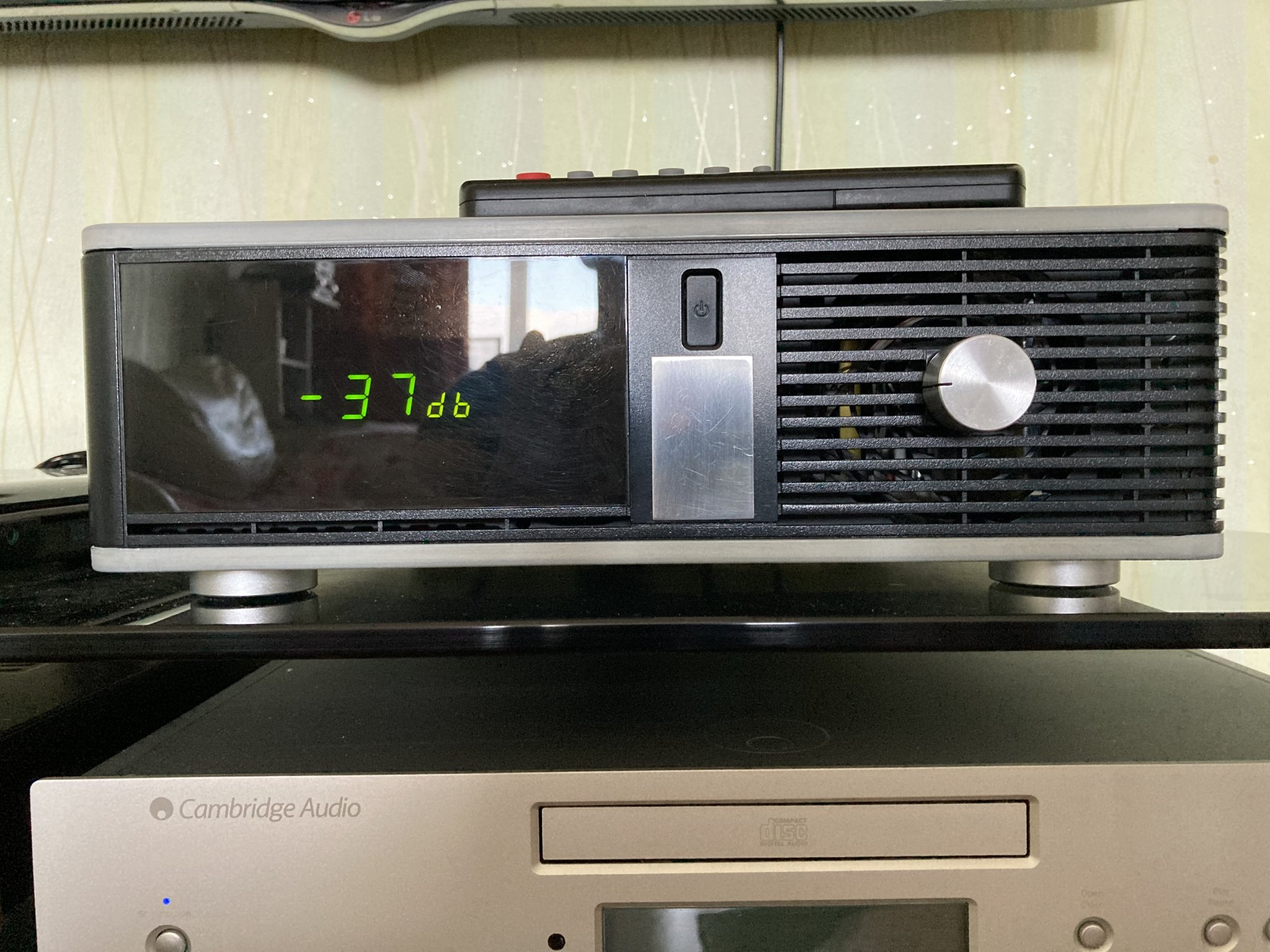

Hello everyone. I finished 90 percent of the A60. It remains to install temperature sensors and paint, bring the case back to normal. I can confidently recommend the amplifier for repetition. The sound is useless to describe, for this money - a bomb. I think this assembly will shake anyone for $ 3,000 or more.
Great news dear friend,I will add. I switched it on directly from a simple CD player, no preamplifier or tone block needed. Pink Floyd plays like I'm at a concert.

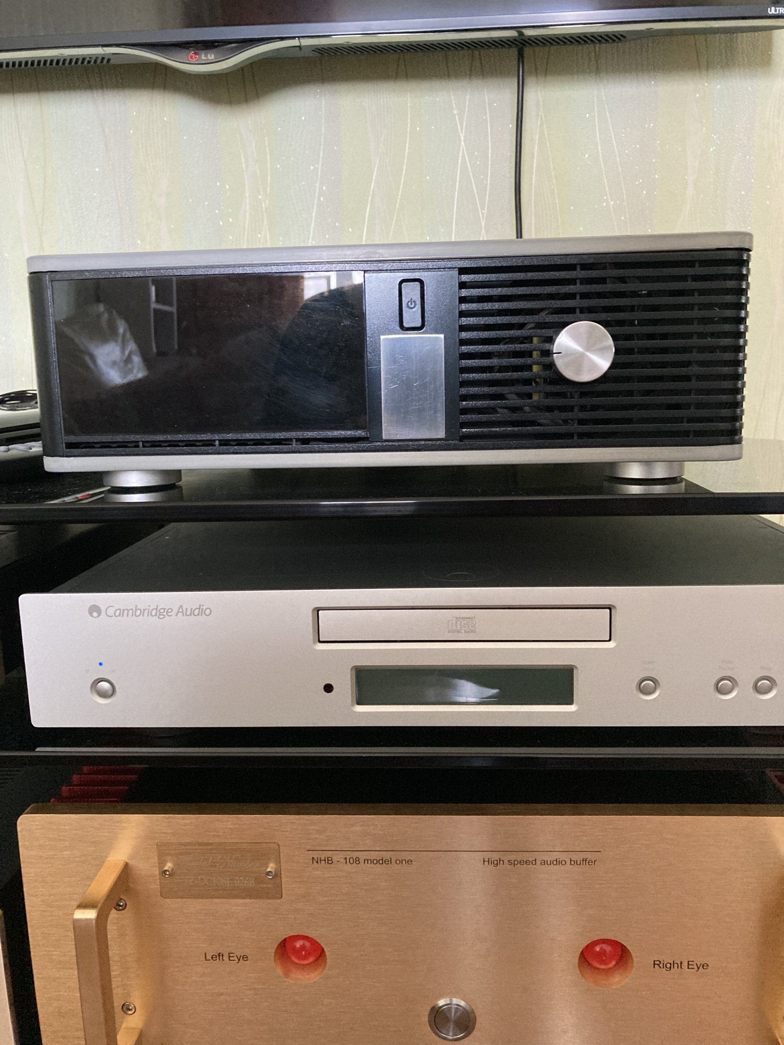

Berlusconi I'm waiting for comments from all my friends, in reality he plays at +60, until I can distinguish from dartzil. Maybe friends will distinguish.
A60 is much better than the DartZeel NHB-108 clone. Measurements indicate that as you increase the power of NHB-108, THD goes up high and it has both even and od harmonics.@Berlusconi I'm waiting for comments from all my friends, in reality he plays at +60, until I can distinguish from dartzil. Maybe friends will distinguish.
In addition to that A60 has much wider bandwidth: from practically DC to several hunderd KHz. At low frequency, below 3 Hz speaker protection detects it as DC and opens the relay to protect the speaker. And it is stable and without slight phase shift.
