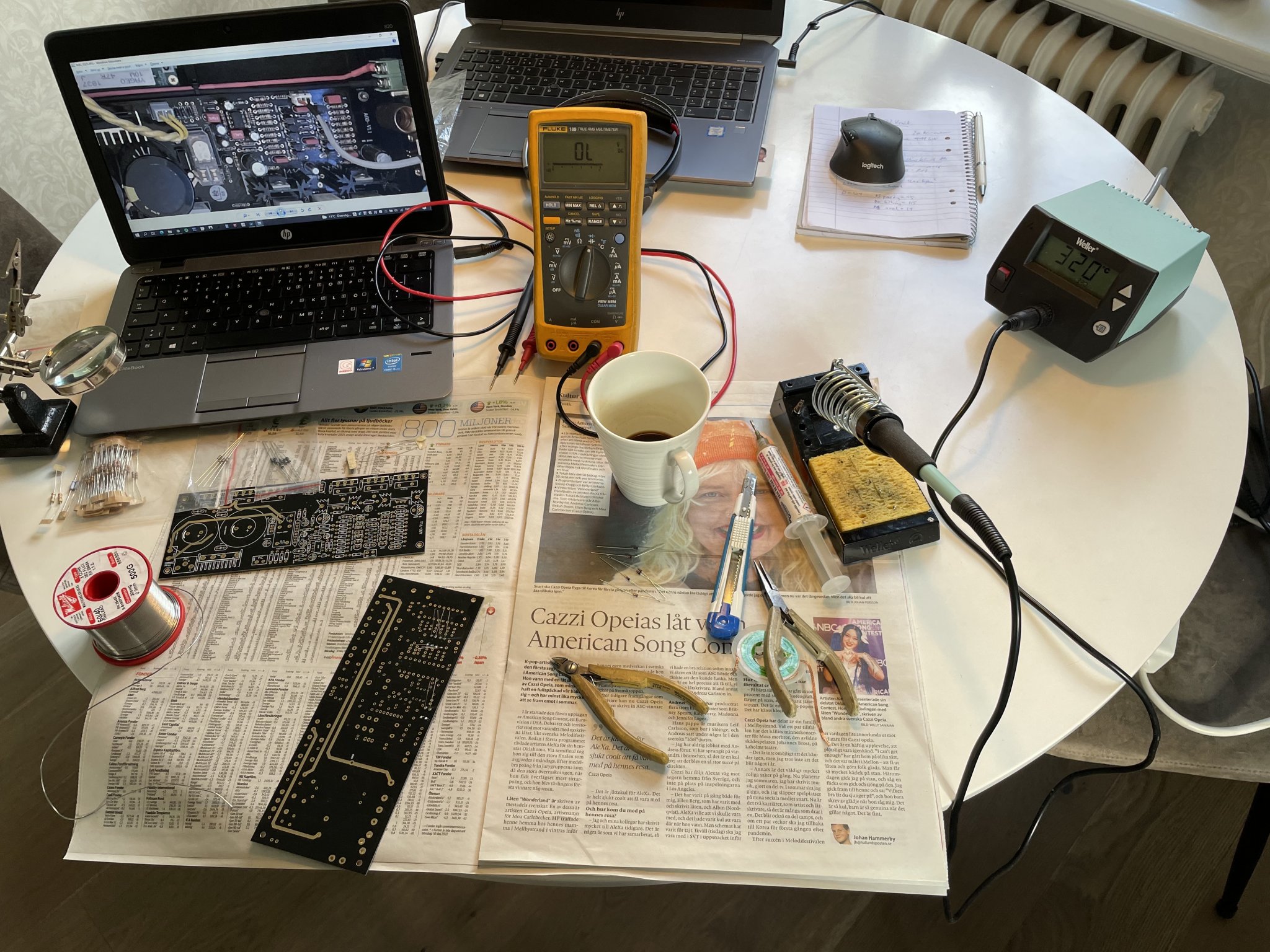

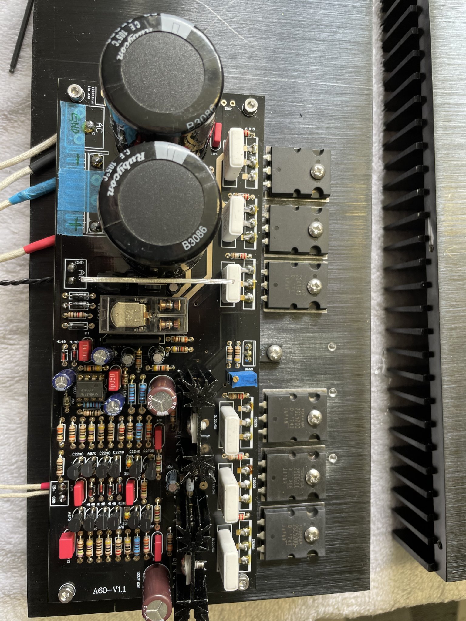

I’ve put in some hours this week. Populated the boards. Everything was in the kit! Even got 2extra 10k resistors which I don’t find a place for.
Not too hard to read the screen print and I’m good to go for power up during the weekend 😊
I have rectifier and big filter caps already so sneaking past the that part of the board.

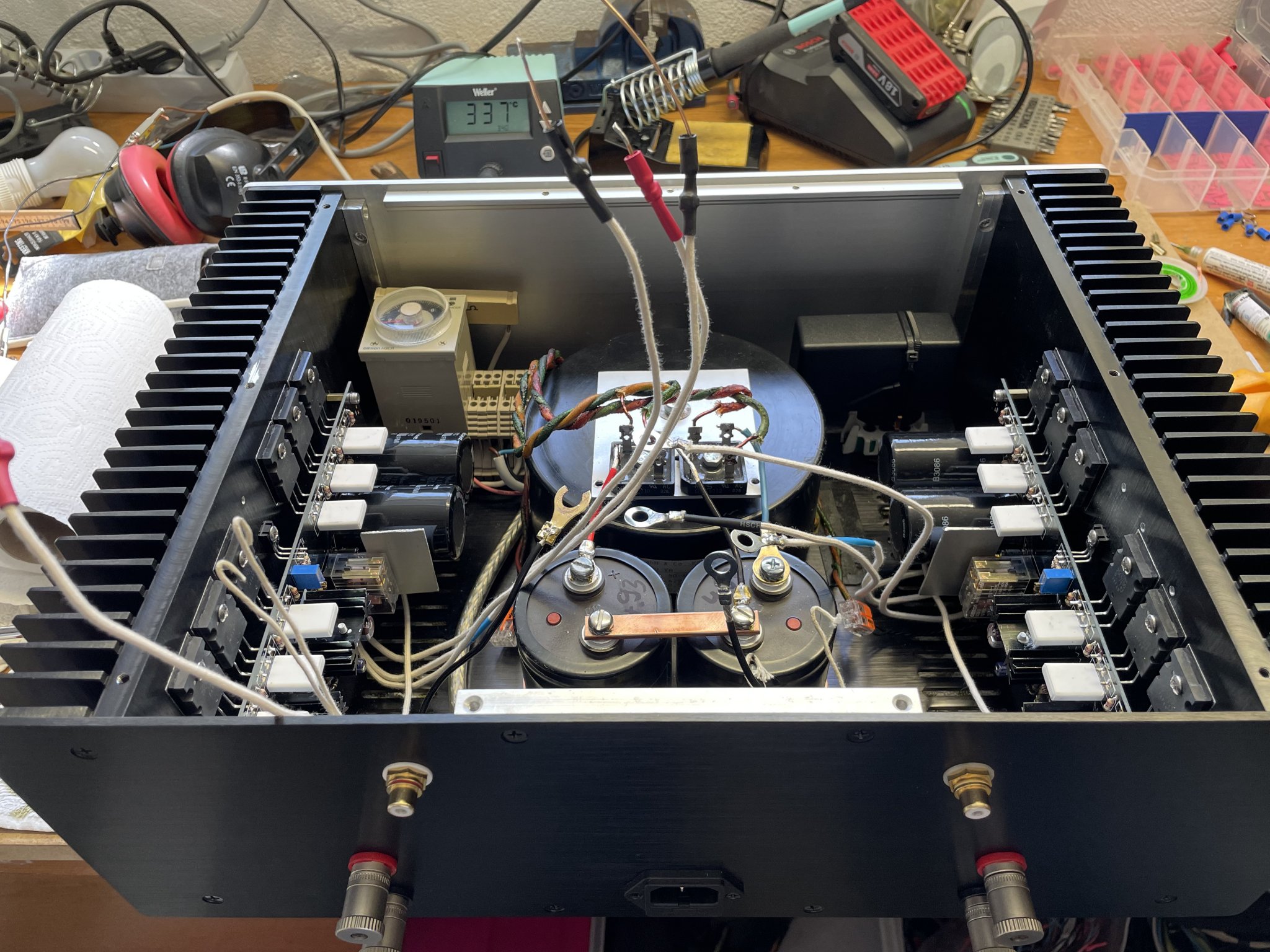

Great build deerhunt,
Exactly, connect the signal grounds at the input, and then connect them to the star ground with a single wire. Connect the "Output" grounds to the star point with the thickest wire you have at disposal. Connect the speaker returns to the star too.
However, do not connect the load to the output before you make sure you have low bias. Start-up with bulb protection and make sure your heat sinks heat-up slowly and uniformly. Now, it is the right time to remove the bulb protection, try without the load connected and then connect the load. Burn-in the boards first at low bias by slowly increasing the input signal. Then you may start adjusting the bias. Once you achieve higher temperatures re-adjust the bias. Bias will decrease at higher temperatures. Counterclock direction increases the bias. Next time you start-up, the bias will be initially higher but will reduce with the increased heat sink temperatures. Do not hurry-up with the bias adjustment. You will have plenty of time to find the value that suits you.

Hi Berlusconi
Thanks for your support! I have it running now at 35mW. Can place my hand on the heatsink above transistor so I guess around 45deg.
Currently struggling with hum. I have looked at the excellent pdf instruction in earlier post.
I have one mains transformer and double 17VAC secondaries. So one “main star point” outside the board (copper bar in the picture)
I don’t have double main secondaries unfortunately.
Tried to understand your last post. Not sure if I got it right😊 Playing around with some crocodile lugs. What did improve was connecting the rca input jacks together. As stated in the pdf, better to have the rca:s closer together…
When playing music the hum is barely noticeable and I can hear the sweet tone of the amp. The NHB-108 will never enter this chassis again, that’s obvious so far.

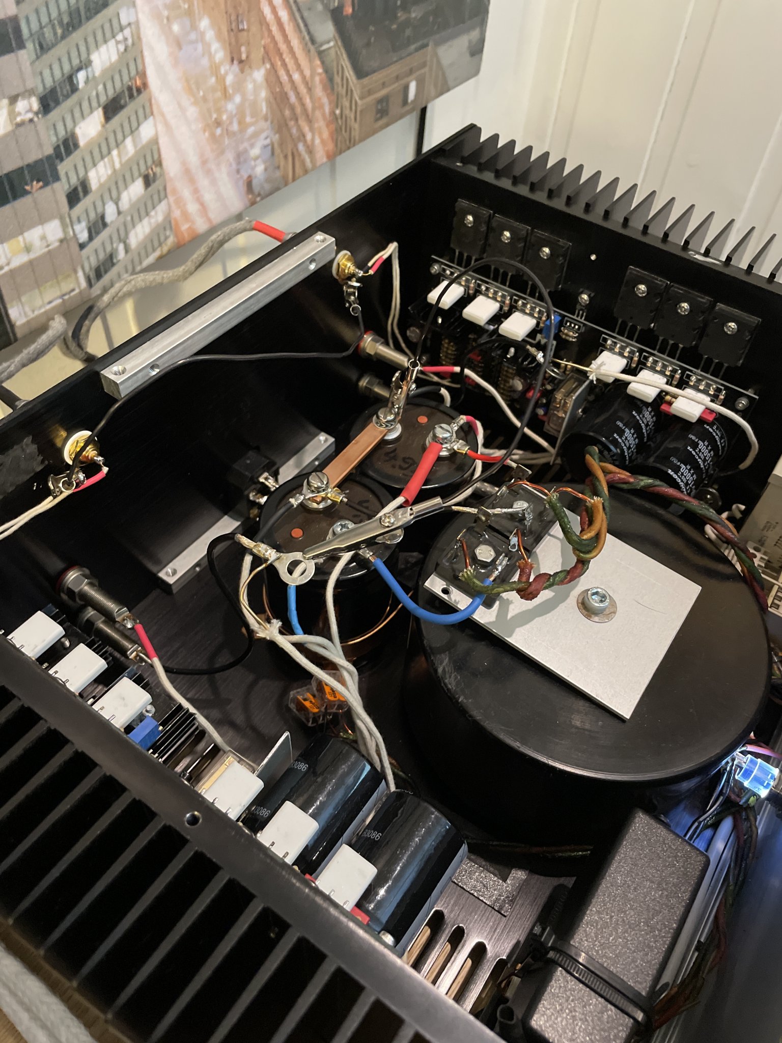

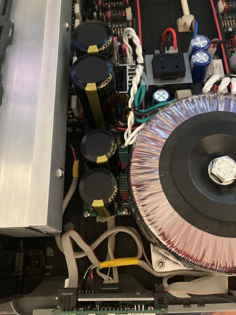

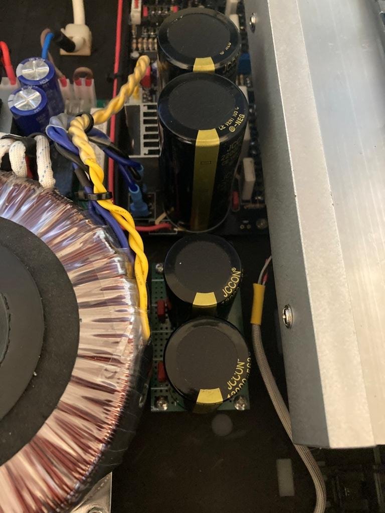

Finished upgrading the amp. I added 20,000 microfarads per channel to the power supply, stuck thick aluminum plates on the radiators, set the temperature sensors to turn off when the temperature in the channels exceeded. At idle at a temperature of 65 degrees (shutdown at 70), with a quiescent current above 25mV, it worked for 5 hours without problems. The next stage is to drive the music to the fullest.
Nice build Paroxod4!
Do you have double center tapped secondaries? It looks like that on the picture. I have thought about phasing of my (single) secondaries. Not always clear how they correspond to the double low voltage (12ac). Isn’t the 12ac connected to ground as well?
What to you have on the speaker binding post, some zobel arrangement?
Look at the photo. From the transformer, the leads are green (36-0-36v), blue (36-0-36v), white (12v), yellow (12v). For each channel, the power goes separately and is not connected anywhere, at the input through 10 ohms from the volume controls (relays on the left and right on the back wall) are connected to the case. Additionally, you don’t need to connect 12v to the case or anything else, the board has already been made correctly. Yes, a Zobel circuit is installed at the output, almost all expensive amplifiers (also on Accuphaces) have it. Smart people also write that it is desirable to install an RC circuit before and after the coil. The board already has RC installed at the output, I added RL-RC and connected it directly to the speaker output terminals. Berlusconi will correct me and supplement.

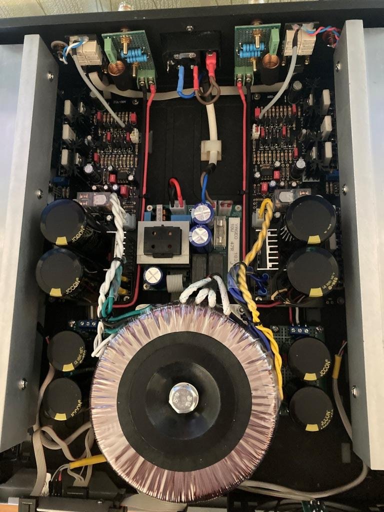

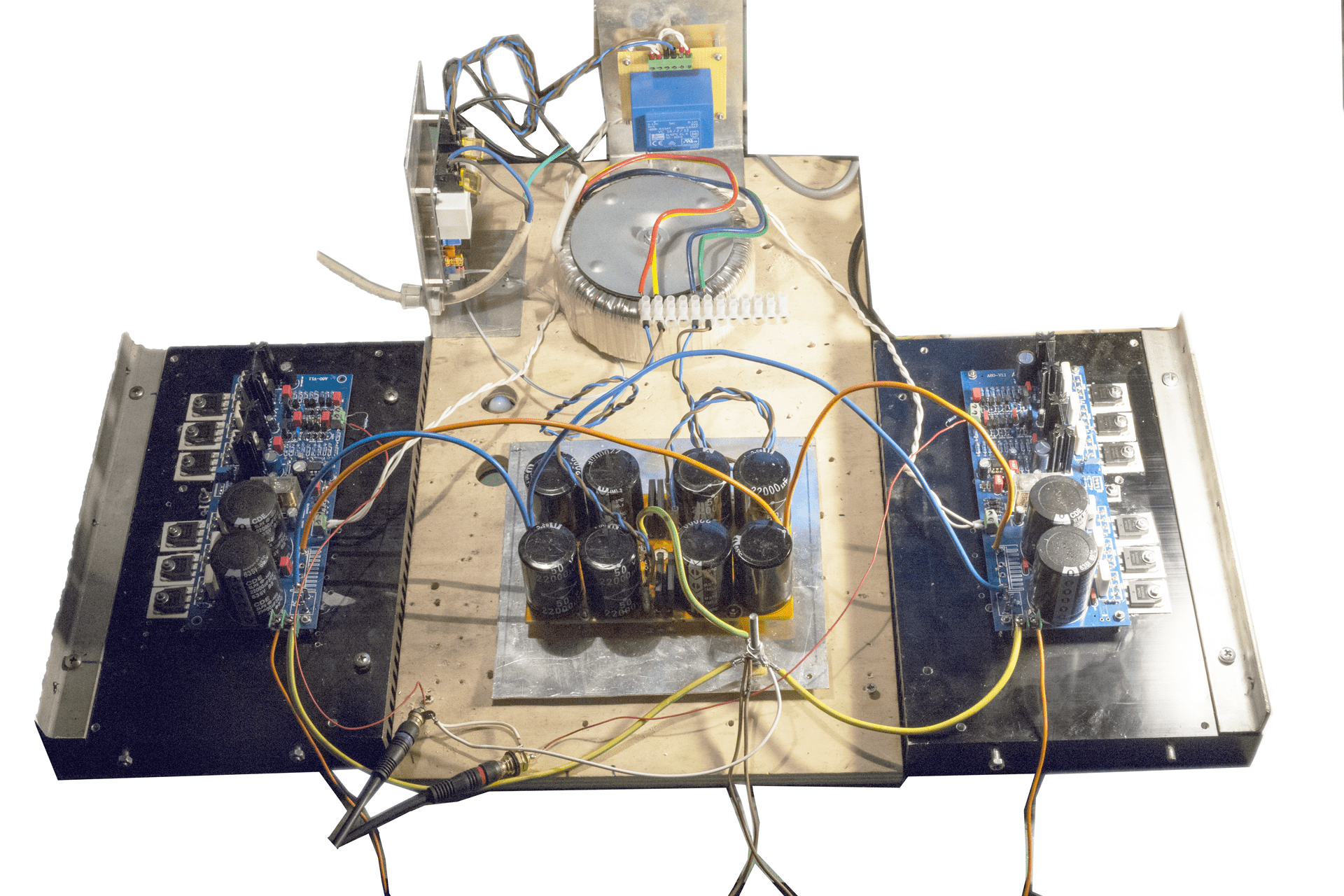

A snapshot below shows how to connect individual parts into completely silent amplifier. The amplifier was assembled with longer wires with aim to enable expanded view with every connectio visible. In actual lay-out wires should be as short as possible.
In this particular case I’ve used a single power supply with a single transformer. Yet, the amplifier is as silent as a graveyard in desert at midnight. There are no undesired sounds whatsoever.
Let us start:
1. AC supply goes through a soft-start.
2. output from the soft-start diverges to: A. main transformer and B. a 12V transformer with two separated secondaries.
3. the 12 VAC secondaries are connected with twisted pairs of white wires to the »AC« terminals on the boars. Note, however: polarity is not important even though there is a »GND« label at the »AC« terminal. This is just AC power supply for speaker protection. It is important to have separate secondaries, otherwise a single transformer directly connecting boards will create an ugly hum.
4. Obviously, four outputs from the main transformer are connected to AC inputs of the main power supply.
5. If you have a rectifier bridge installed on board, de-solder it and connect power supply there, instead.
6. Positive rail of the power supply is connected to the + side where a rectifier bridge was built-in.
7. Negative rail of the power supply is connected to the - side where a rectifier bridge was built-in. It is on the side opposite to +.
Now important: grounding.
Make a star on a screw and separate individual connections with metal screws. This assembly must be isolated from the chassis.
8. First, connect the power supply ground to the star and fix it with a screw.
9. Next, connect the »OUT« terminals from the board speaker outputs to the star, with thick wires. Complete this connections with a screw.
10. After that, connect speaker return wires to the star. Again, fix these wires with a screw.
Now, even more important:
11. Connect the RCA grounds with a wire as short as possible. It is desired to have RCA connectors as close to each other as possible. This will eliminate the nastiest ground loop. Important: RCA Connectors must be isolated from the chassis.
12. Now, connect one of RCA grounds with a single wire to the star.
13. Connect RCA inputs to »INP+« terminal of the input terminal at the board.
14. DO NOT connect »GND« of the signal input to anything. Return path for the signal »ground« is already provided at the star. This is essential part of everything.
Note: Separation of individual connections with screws at the star ensures that currents flow in the direction of the most intense currents. Note that the signal ground is the most vulnerable and is placed at the end to guard it from intensive currents.

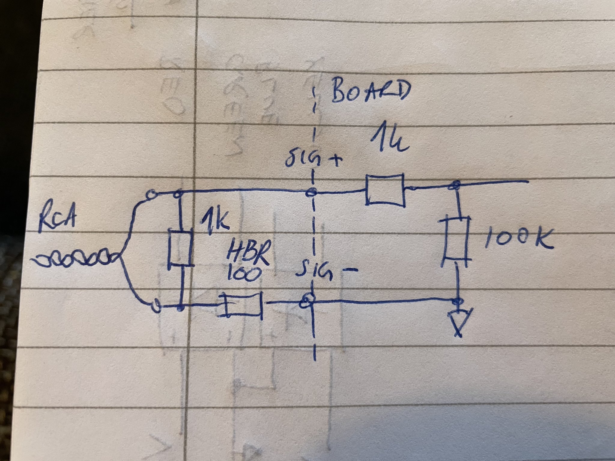

15. To further improve the sound, you may install a 1K resistor at the signal input of the board between »GND« and »IN+« terminals.
That's all.

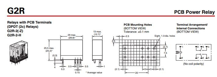

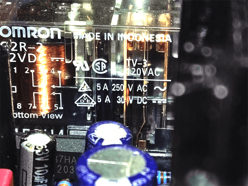

Quick question, I see there is relays on the board, is this for the speaker protection? or must I order some speaker protection boards to.
https://ae01.alicdn.com/kf/H506dbab78a3743178b096b2288b24971e.jpg
I order a soft start board and Input boards with RCA and XLR. Heatsink I already got and 2 x 400va 36-0-36 toroidals with 2 x 12v tapings. Will build my own enclosure for it.
You're right, there is speaker protection on board. In this particular case, otiginally it is Omron G2R-2 12VDC.Quick question, I see there is relays on the board, is this for the speaker protection? or must I order some speaker protection boards to.
Datasheet
Observe the proper pinning on the attached snapshot.
Note: there is also servo on-board so you don't have to worry about DC ofset.
