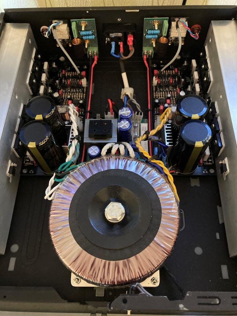

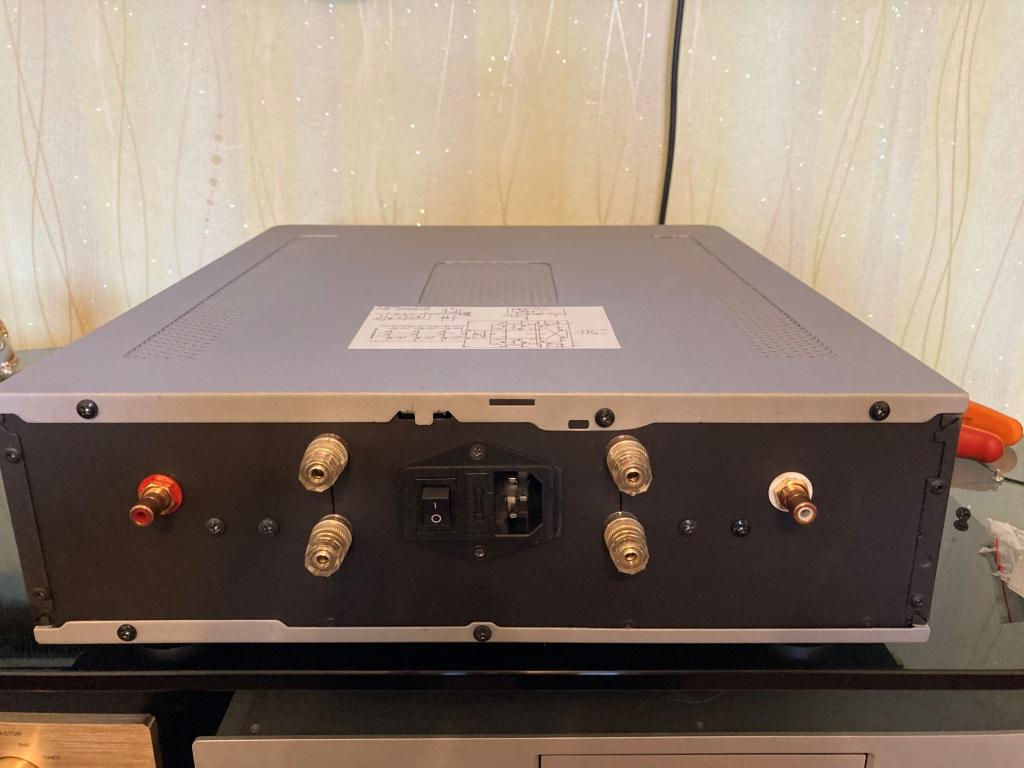

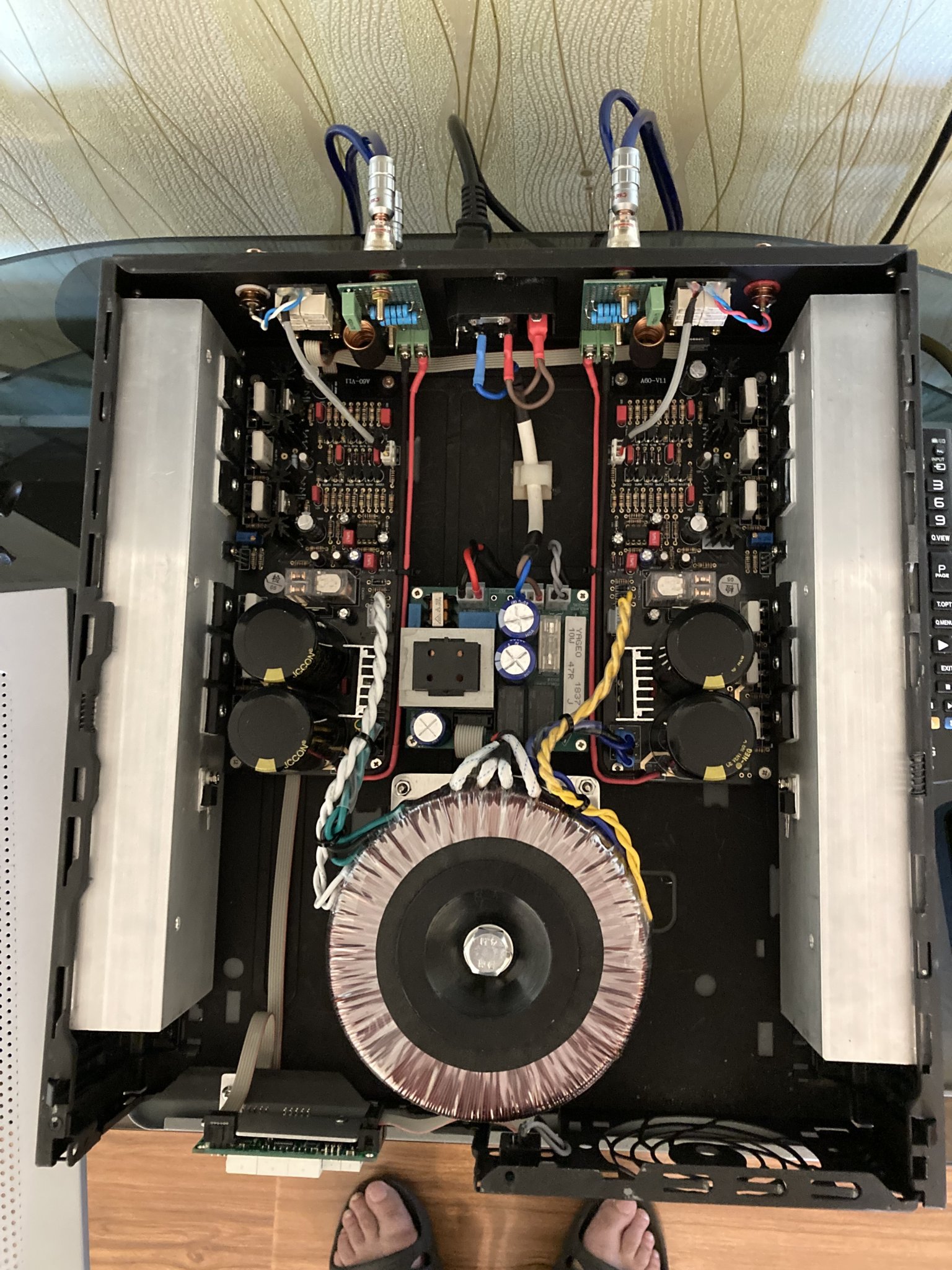

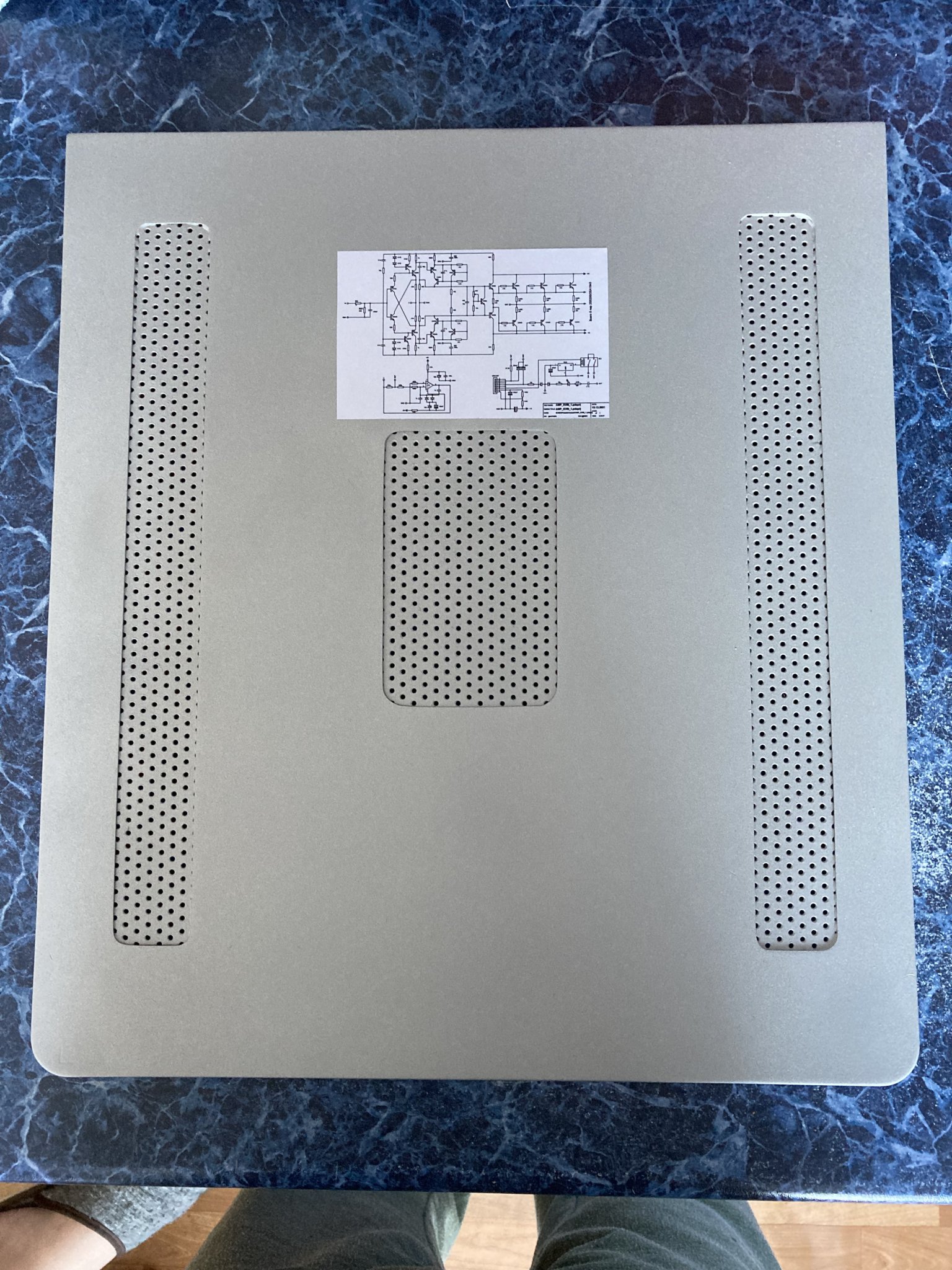

Hello Berlusconi. I have been listening to this power amplifier for 2 months now. I have already reported that my preamplifier-power amp combination was not optimally matched to each other (excessively loud sound at the very beginning of the volume control range). Although they were recommended and bought in one Chinese store. But like any non-brand item from China, this technique needs to be improved. I just, as I reported earlier, changed the mode of operation of three pairs of transistors (A970, C2240) and perhaps the influence of the "servo drive" on OP07. To do this, I increased the value of the 22 ohm resistor to 470 ohms. I'm talking about boards on transistors 5200/1943. Now a couple of boards for MJL4281/4302 are ready.
On one of them, I could not eliminate the noise at all until I got rid of OP07 (removed from the connector).
Without OP07, the pauses in the music are absolutely quiet. If I have free time, I will check and listen to new boards and share the results.
At the same time, I changed the DAC (to ESS9018) Muses 8920 to Muses 02. I listen from Raspberry + Volumio. It might be easier to hear the difference now. Another option for the sound source is CD on the CS4398 (XRCD, K2HD, HDCD and SACD).

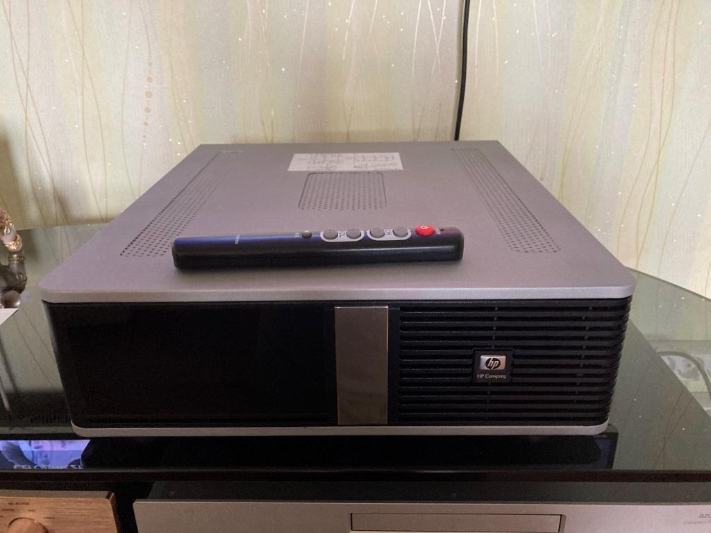

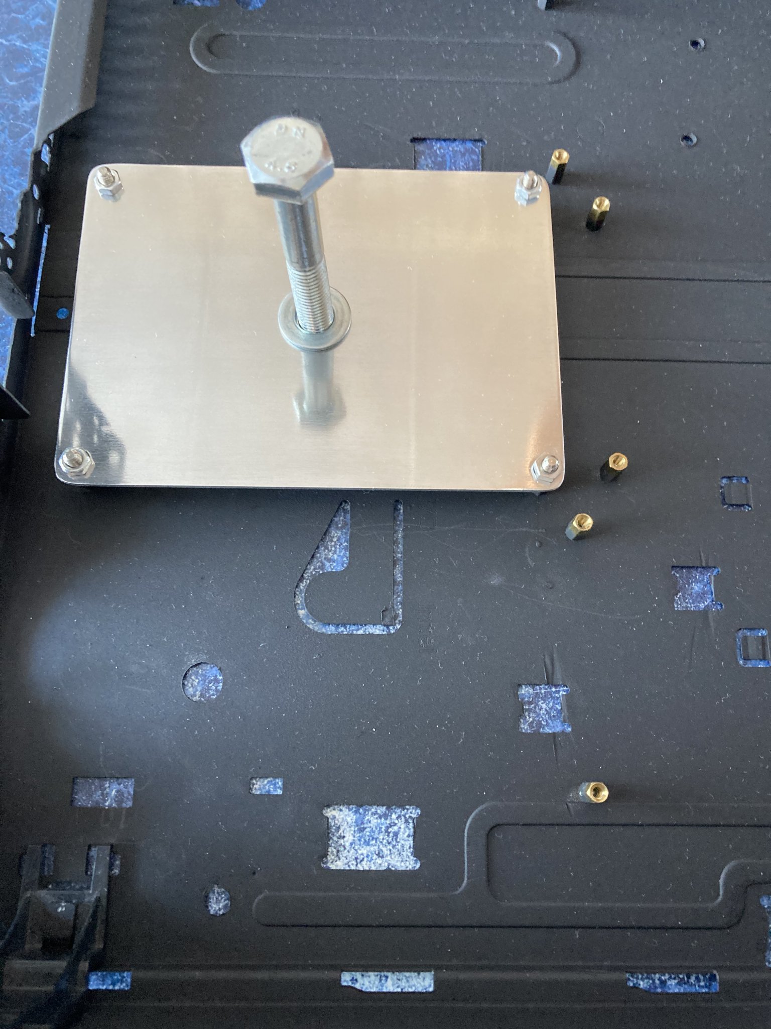

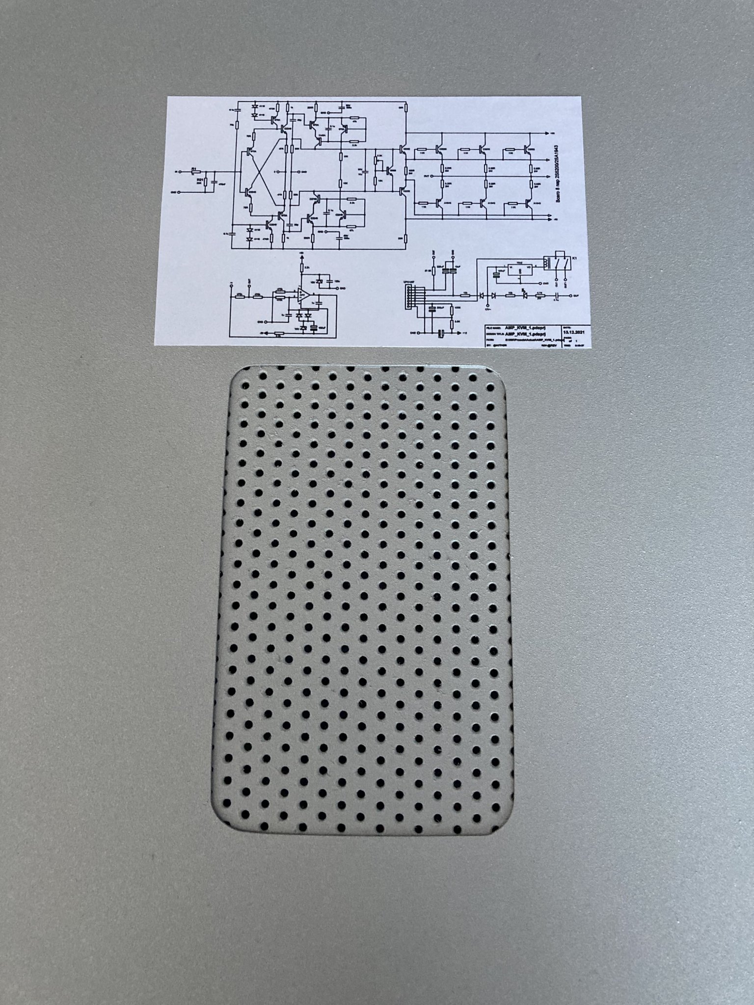

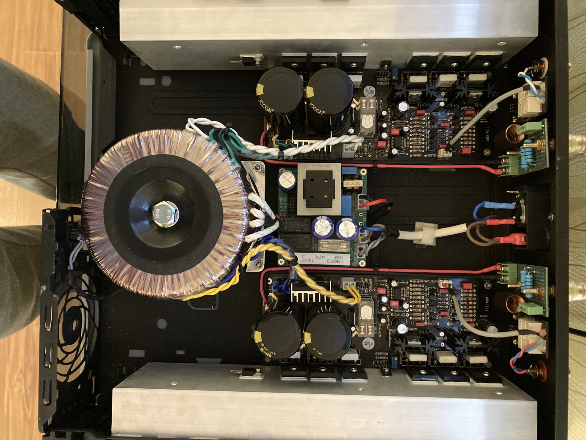

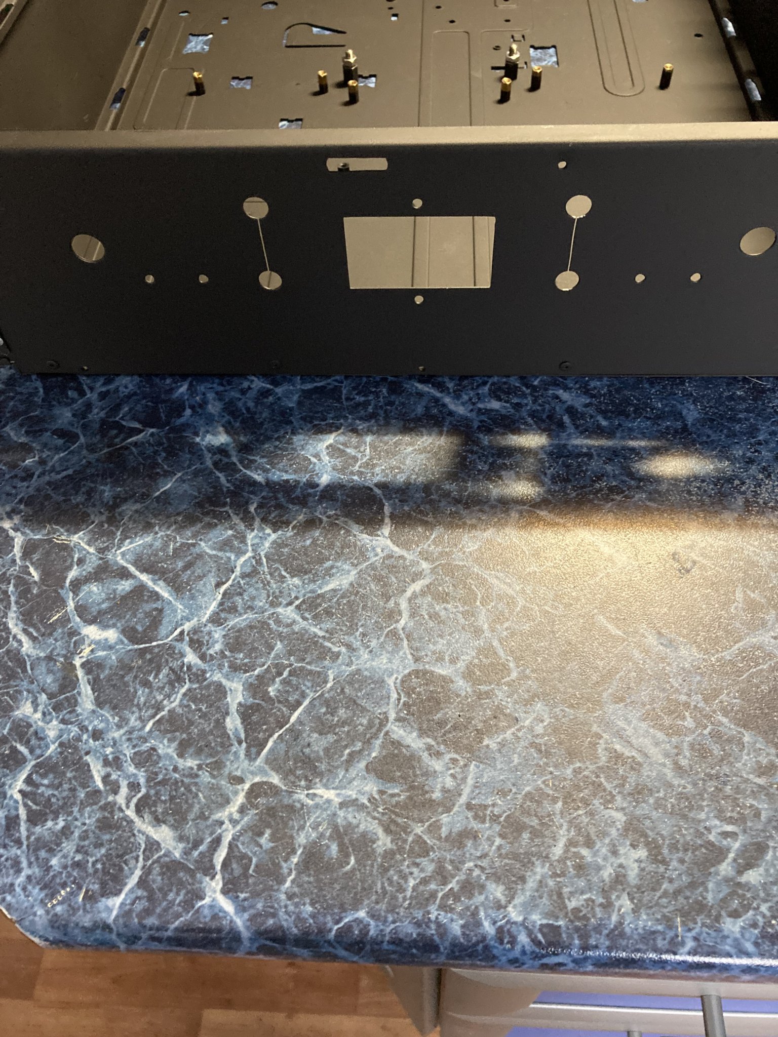

I finished painting, the first photos. The platform for the transformer is shiny. There was a small joint, I ordered a diagram sticker and covered it up.There is a removable platform from below, as well as a cover from above.🙂

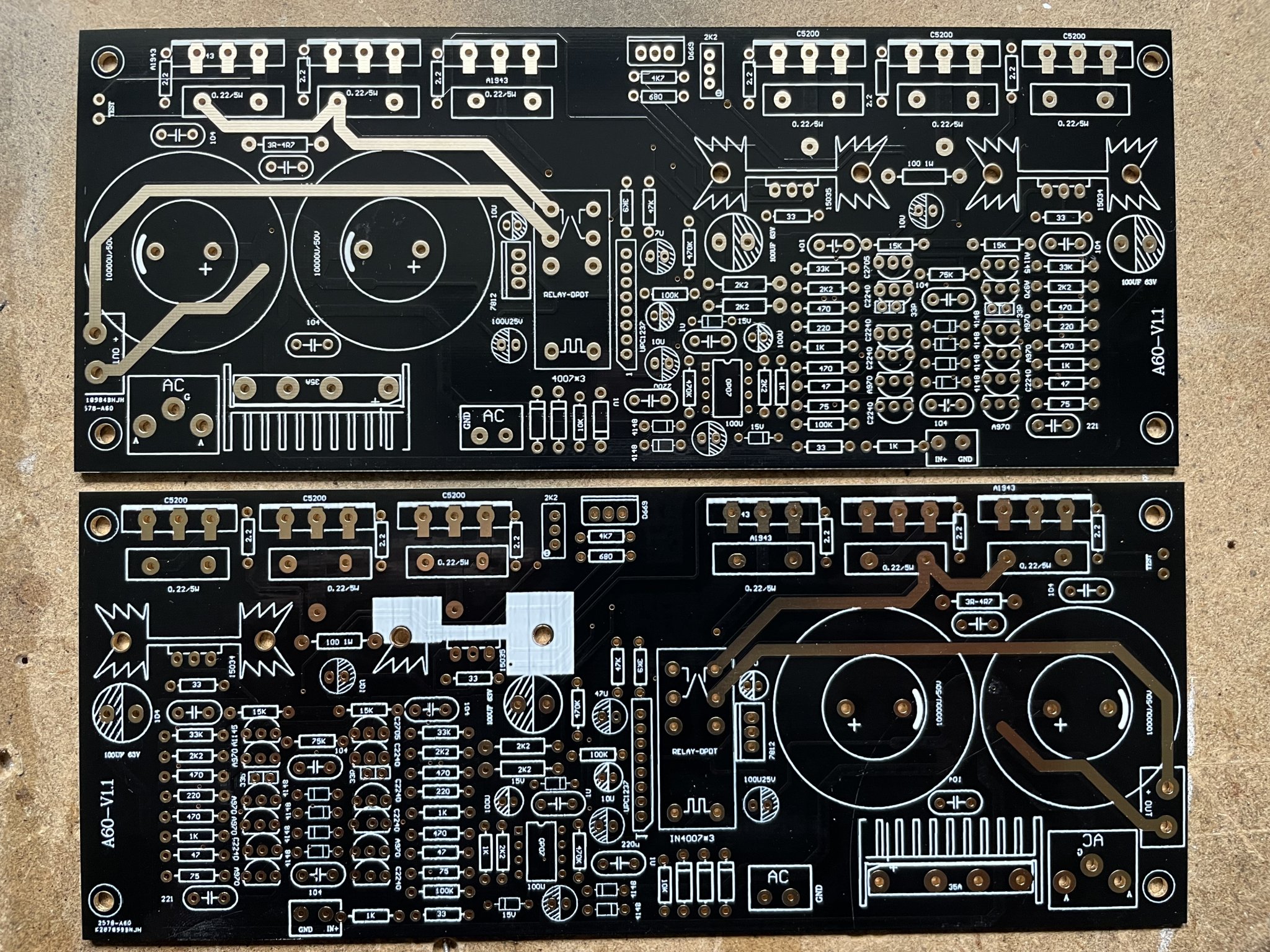

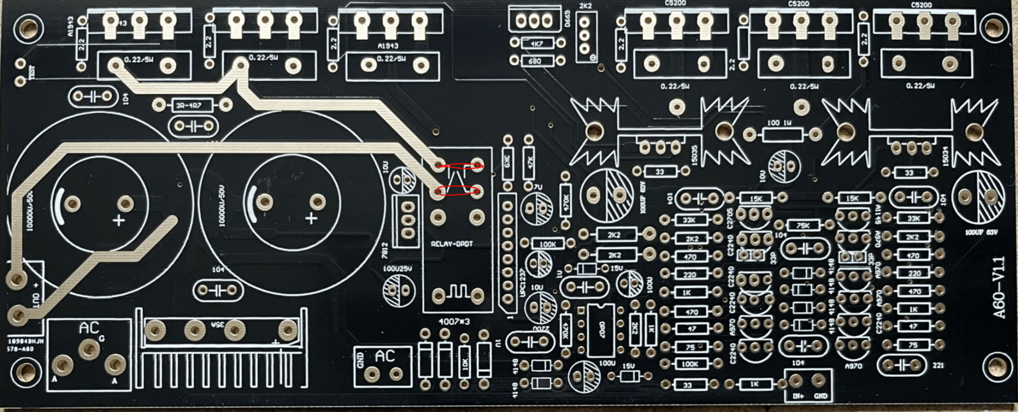

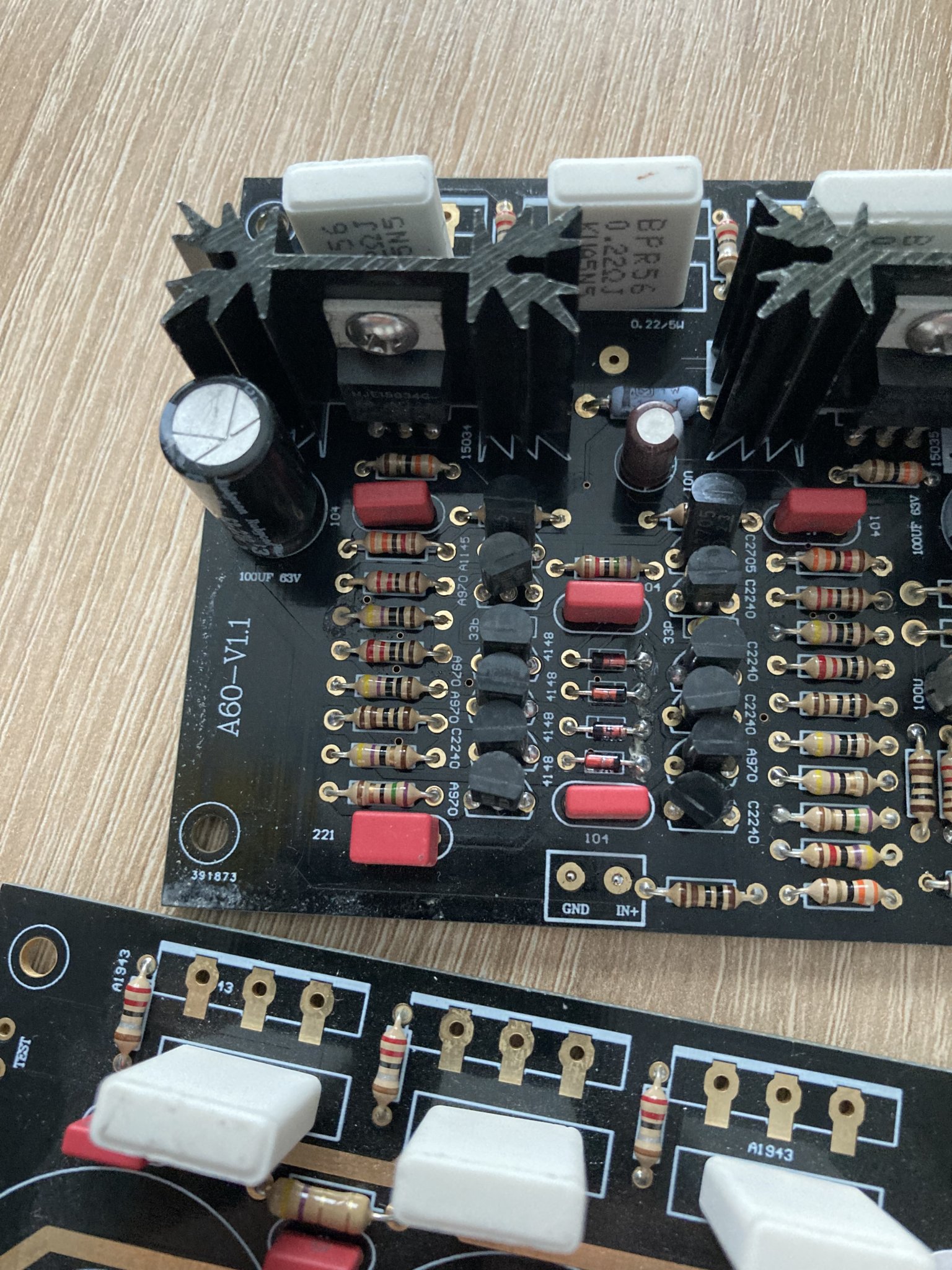

I just got my boards for A60. They seem to be version 1.1.
The boards will replace the NHB-108 which has it's shortcomings. I'm hoping for some more bass control and stabile soundstage. Still with a warm and organic sound - let's find out🙂
I have a couple of questions for the nice community. Please share yor knowledge.
1. Does these boards I have any known issues like errors in print or lay-out/traces?
2. Is aux voltage of 17,2VAC too high? What are to max voltage for the aux circuit components?
3. From heat dissipation - is it best to mount the boards with power transistors facing down? Or perhaps it doesn't matter?
4. Is there a circuit diagram with readable component values or I have to trust the screen print?
Thanks in advance!

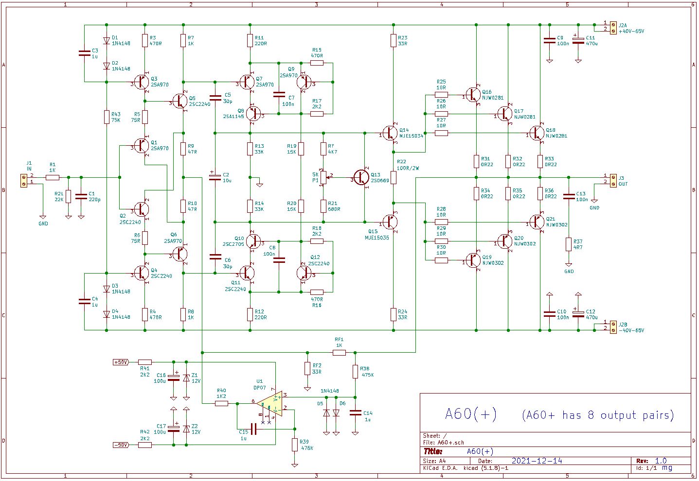

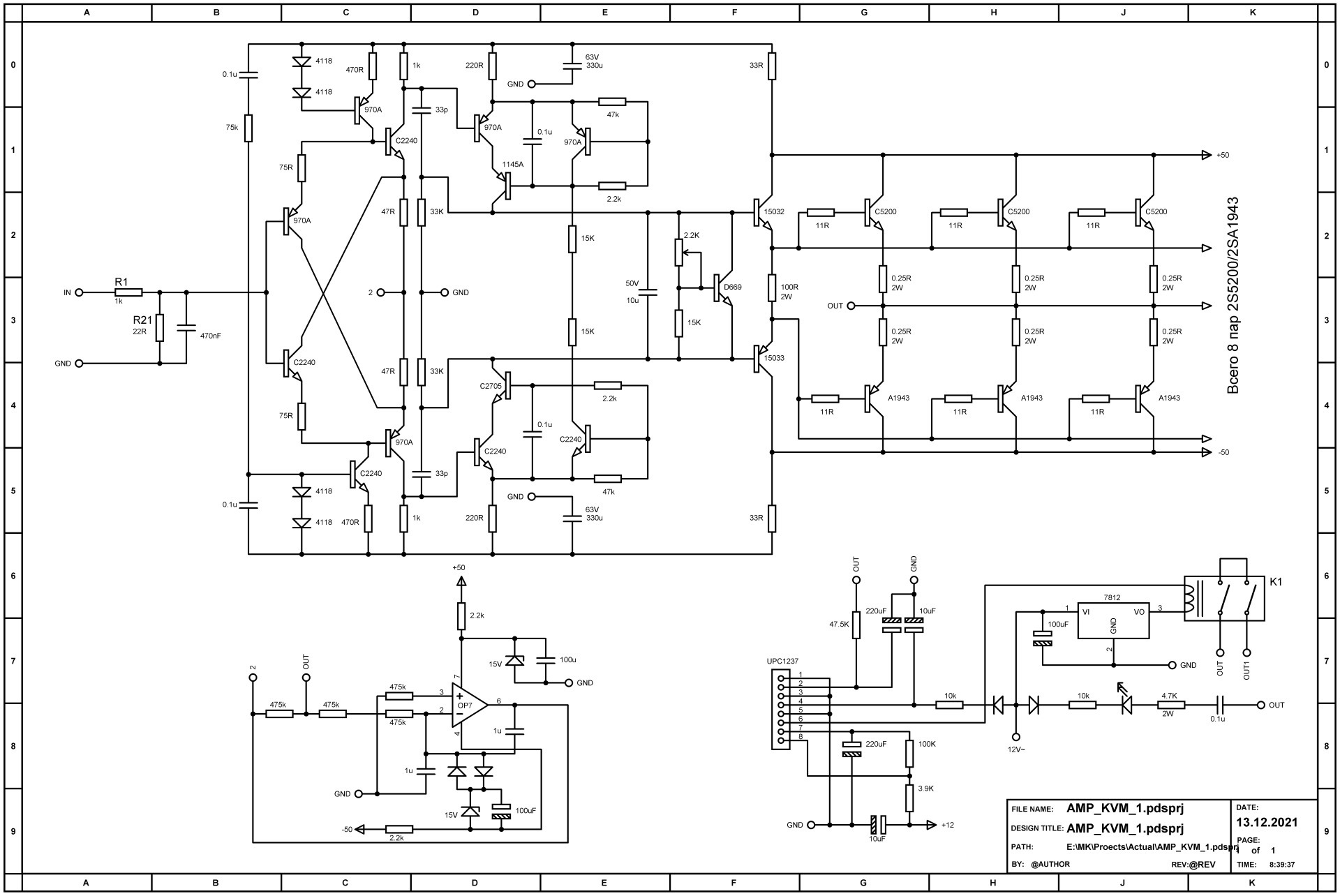

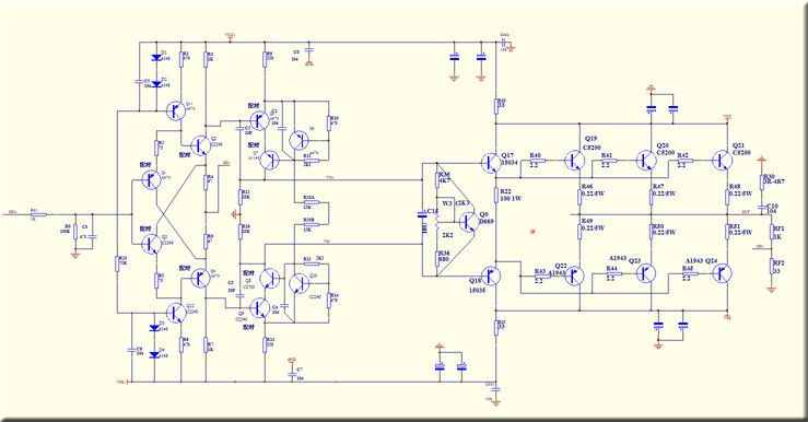

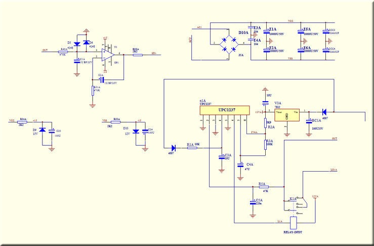

Hi!
I have bought these, but did not built them yet. I made a schematic though. Good luck!

It's very different from the real A60
Indeed Mark, it is just 'inspired-by', but I don't care for usual marketing spin, what I really appreciate is the real world performance and measurements. I've tried quite a few DIY kits and this amplifier has the best performance/sound. I have kept JLH 2003 version, Krell KSA50, STK4042Xi chipamp and 3 pairs of A60(+) which are my favorite. All other projects, including DartZeel NHB-108 clone, ended-up in the bin.
Thanks in advance!
1. None that I'm aware of
2. You rather use a small transformer with two 12VAC secondaries. These are too cheap to save the money on them. Separate secondaries are essential to avoid ground loops.
3. Don't worry, just have large heat sink for output devices. Othertwise, heat dissipation will limit your choice of the quiescent curent. With adequate heat sink you may extract the first 20-24 Watts of pure class A performance.
4. The values on the silk screen are all correct. You only have to take care to install IC1237 in correct direction. Also, smaller boards are mirrored, so take care that components are soldered in correct direction.
Take care and welcome aboard

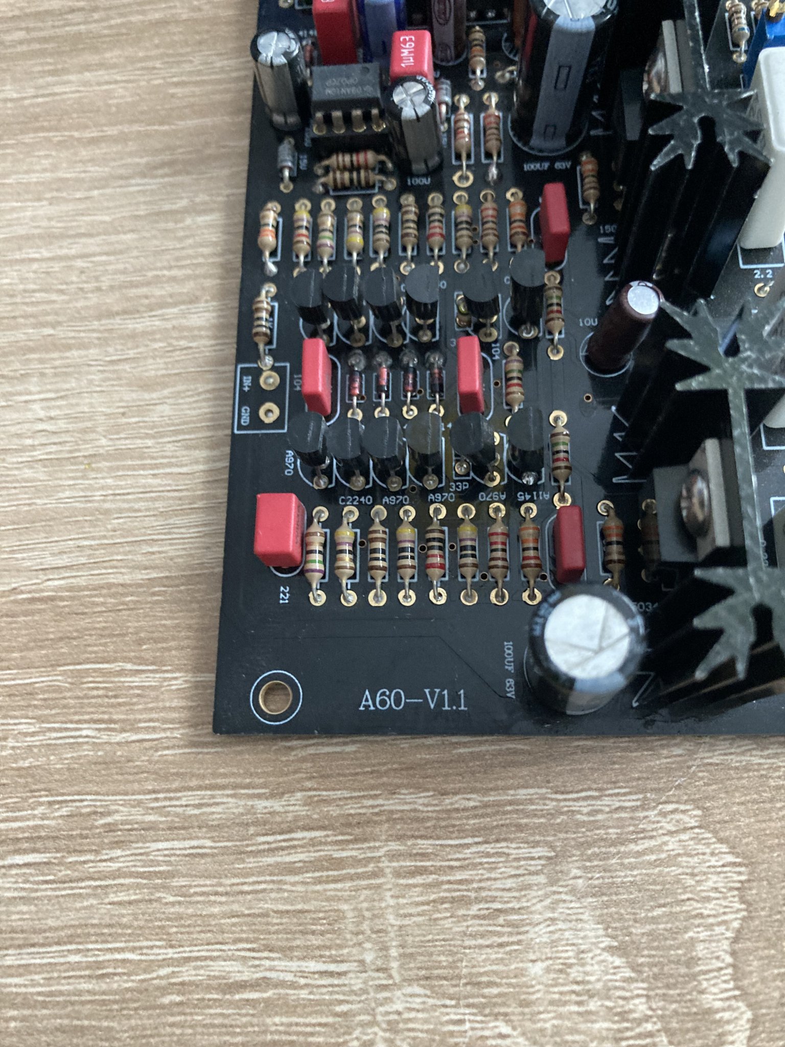

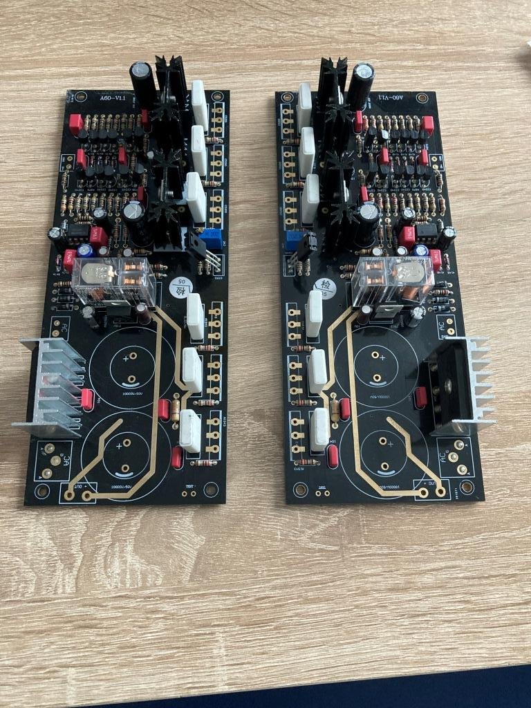

There are many good photos of the A60 and A60+ on the forum here. You just need to carefully look at them and install them according to the pictures. It is natural to look back at the diagram. If necessary, I will post high-quality A60s. Aliexpress also has the right boards and there are large photos on which you can easily prepare this amplifier. As the respected Berlusconi wrote, he has no flaws. Good luck.😉

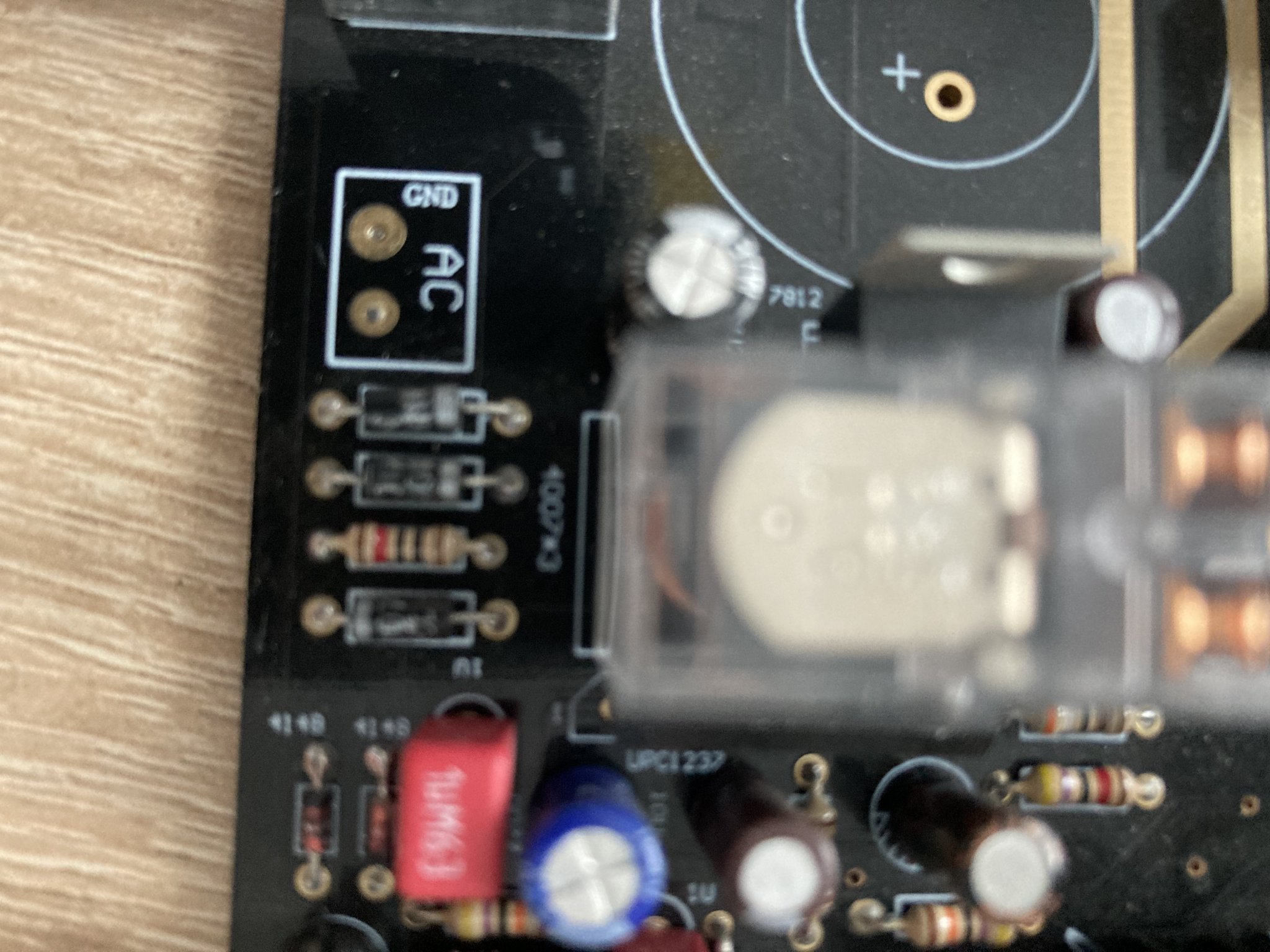

Those of you who have the actual PCB's could check if what I'm saying is correct:
It could be possible to maybe double-up the relay contacts (and half the contact resistance, i.e. improve damping factor / improve the sound). Of course, this would need to be checked with a multimeter on an actual PCB...
