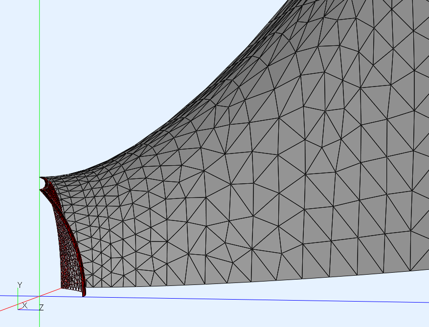

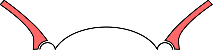

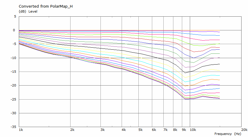

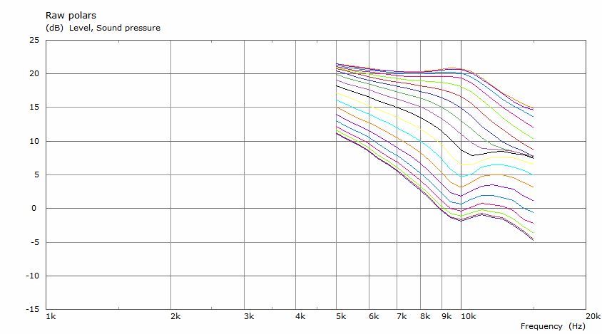

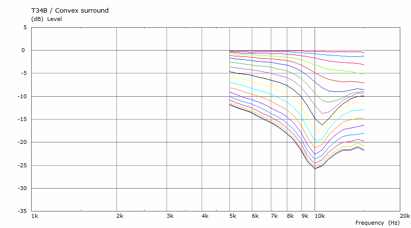

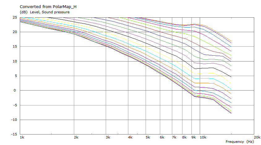

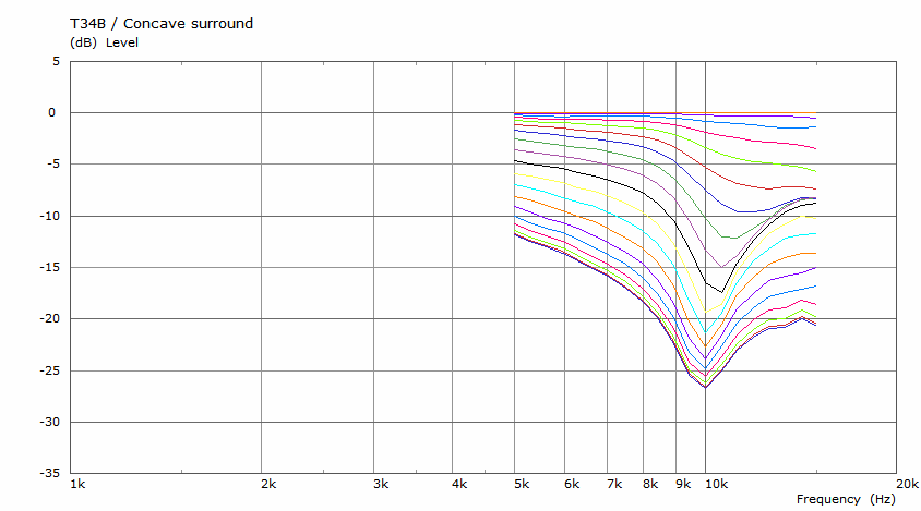

This doesn't follow from the data.Regarding the T34-A; an (unmodified) OS-throat is probably not the best interface for the concave surround. It's basically a cavity that's extended axially by the OS-profile and likely the cause of sub-optimal performance in the treble range.
Convex surround:
Concave surround:
It's just that the OS profile doesn't fit to the source shape and velocity.

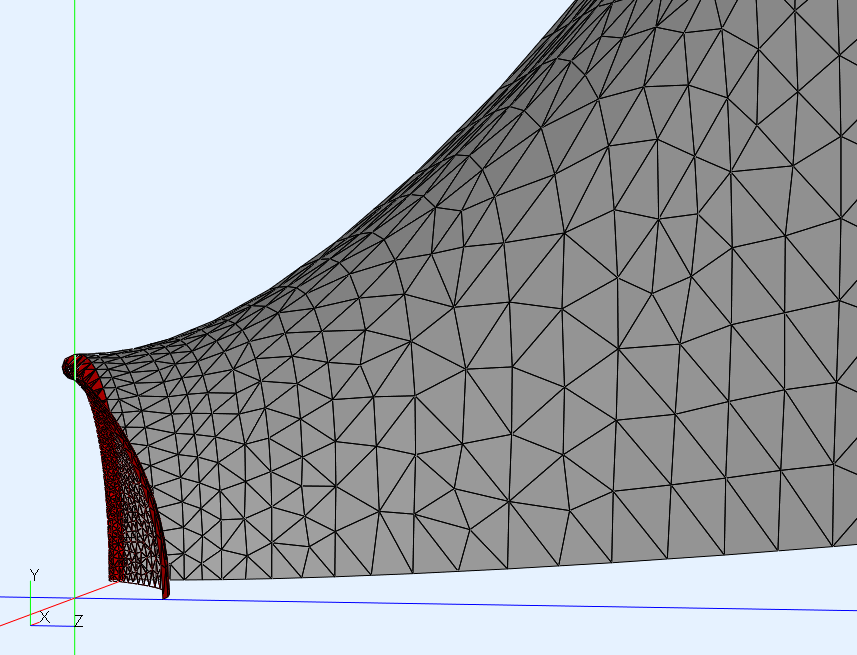

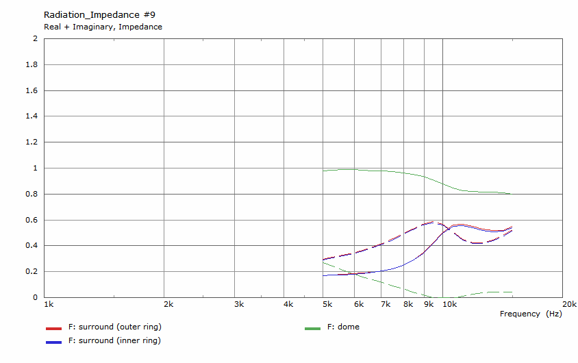

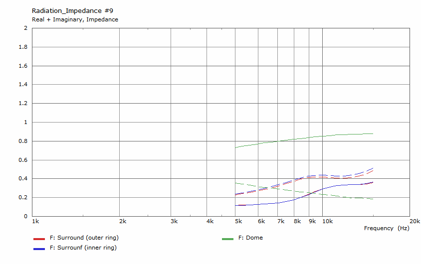

I can model anything defined by a source definition script. If you (or anyone else) provide this I can try it. The problem is that the real diaphragm may not be moving as a rigid body - then the simulation won't be correct. With the tweeters above, this simple assumption (used throughout ABEC) is fulfilled to a large degree, at least in the audio band. I'd be not so sure with a bigger driver.
Now it starts making more sense - this is still a conical throat, only narrower than before (this is ~60 deg, the previous was ~100). So it is not the OS profile per se but a non-matching profile in general.
Convex surround: ...
Concave surround: ...
Yes, either convex or concave - depending on the size and shape of the surround, an OS throat is not ideal for the wavefront emitted from the "average dome tweeter". However, this doesn't imply that an OS throat cannot work with all dome tweeters.

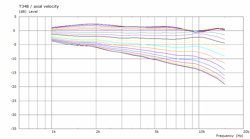

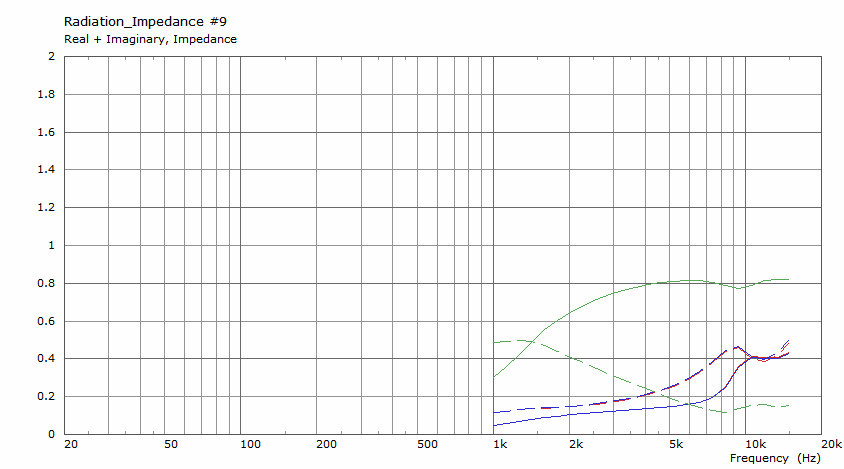

So here is the correct simulation, i.e. with axial motion of the diaphragm (normalized at 30 deg):.. this was not a simulation of a dome tweeter but a pulsating source...
A pulsating source remains the holy grail
