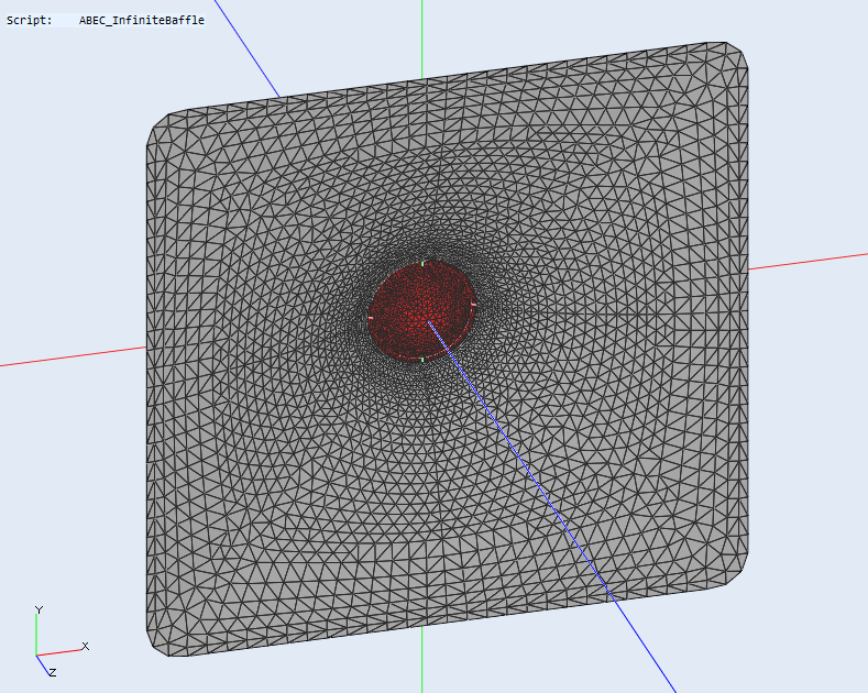

My file looks like mabat's post in Gmsh. However what threw me was that in ABEC it looked like a flat red disc, but looking at it more, it is curved like the dome, but without the surround features as in fluid's post:
Figured it out. The Source.Contours values needed to be in the Abec Project Setting area of the cfg. I assume sticking it at the end of that section is ok?
The order should not make a difference and I put it exactly where you had it in your example script and it worked first time. Perhaps just a gremlin 😉
It really should make no difference and I tried the very file you attached and that gave me a dome source, so I'm little in doubt that was the cause. It is true however that if the syntax was wrong somehow, the item Source.Contours would be ignored which would lead to a default source instead - that would be the one you showed. That's why I wrote you should see a mentioning of reading the file in the output messages.
There's basically no syntax checking - what's not recognized is just ignored.

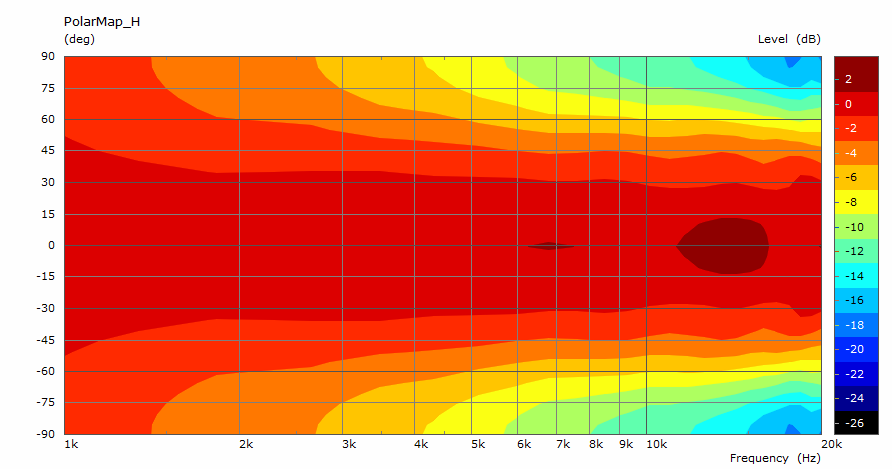

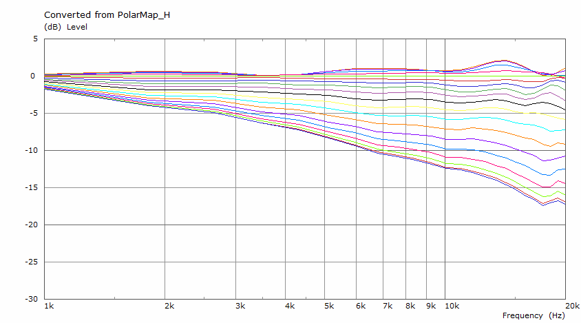

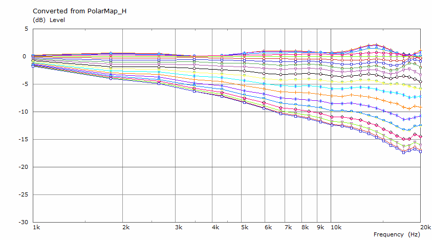

- Today I experimented a bit with such small shallow waveguides for dome tweeters and this ATH profile seems quite promising: profile parameters
It translates simply as follows:
Geometry.Definition = 1
Throat.Profile = 2
Throat.Diameter = 36 ; [mm]
Throat.Angle = 0 ; [deg]
Coverage.Angle = 0
Length = 30 ; [mm]
Term.s = 2.8
Term.n = 1.33
Term.q = 0.996
