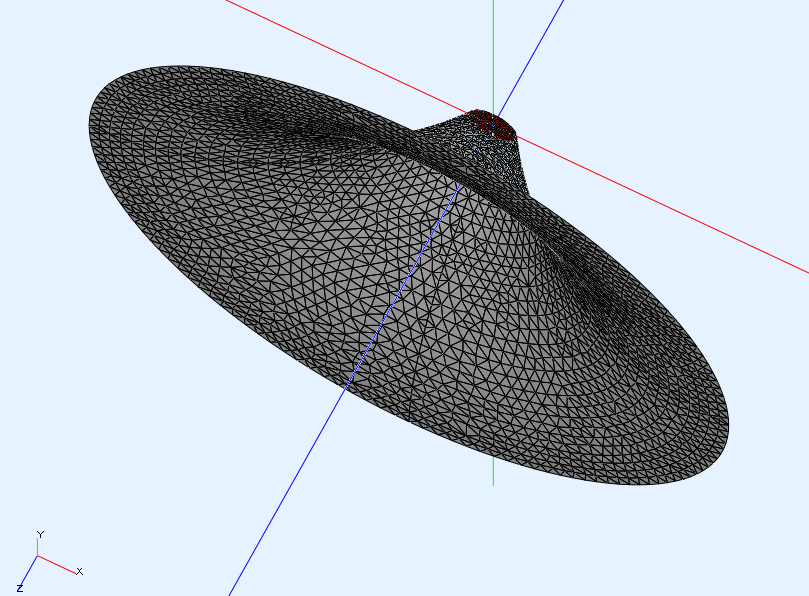

So where would I add the ellipse script for the mouth you posted above in the .cfg file? Would I have to delete another entry (I'm still working off demo1.cfg)? Here is what I have so far for a 180mm major axis ellipse with .618 aspect ratio:
GCurve.Type = 1
GCurve.Dist = 1.0
GCurve.SE.n = 2.0
GCurve.Width = 180
GCurve.AspectRatio = 0.618
What are Dist and SE.n? What if I just wanted a normal ellipse, not a superellipse?

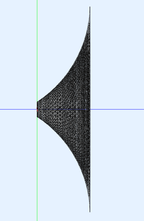

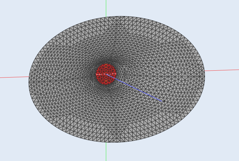

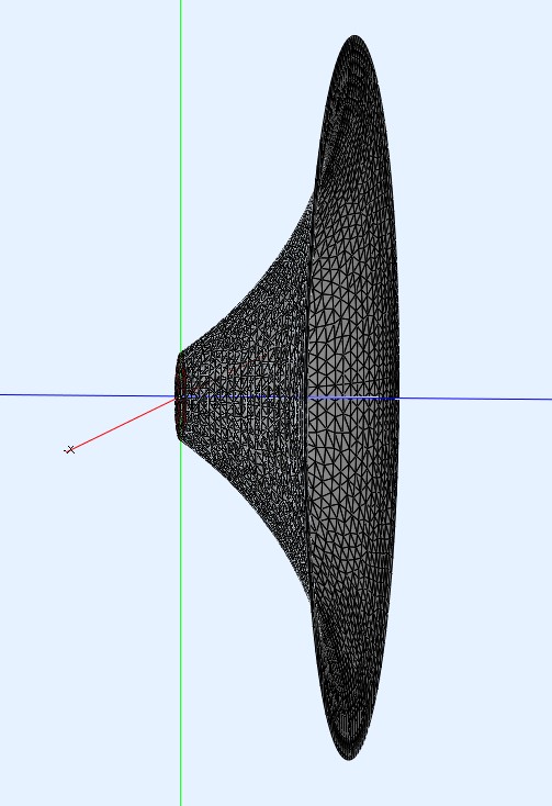

I can give you a "beta" version 4.6.1 right now: ath-4.6.1-beta
At the moment, without a proper documentation, just use these lines:
Geometry.Definition = 2
Throat.Profile = 3 ; circular arc
CircArc.TermAngle = 1 ; angle at which the profile connects the baffle [deg]
Throat.Diameter = 36 ; [mm]
Length = 30 ; [mm]
GCurve.Dist = 1.0 ; guiding curve at the end of the profile!
GCurve.Type = 1 ; superellipse
GCurve.SE.n = 2.0
GCurve.Width = 200 ; [mm]
GCurve.AspectRatio = 0.7
PS. I also fixed a bug: GCurve.Width now sets the correct size for an ellipse (not half the size).

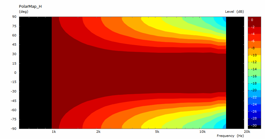

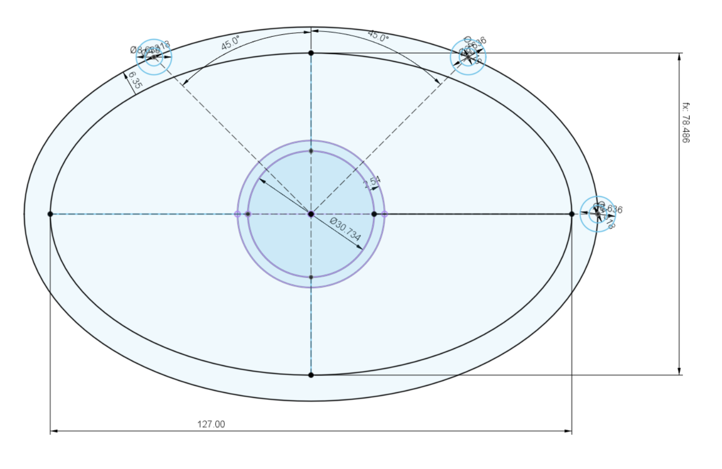

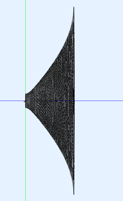

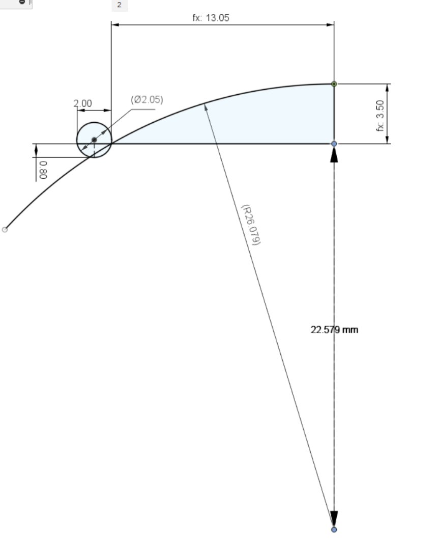

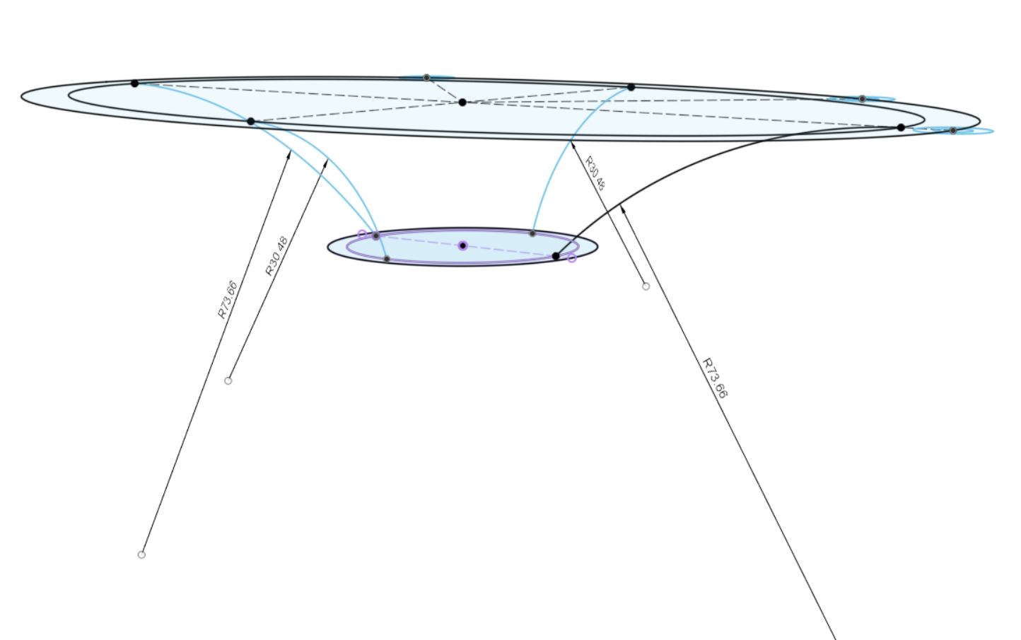

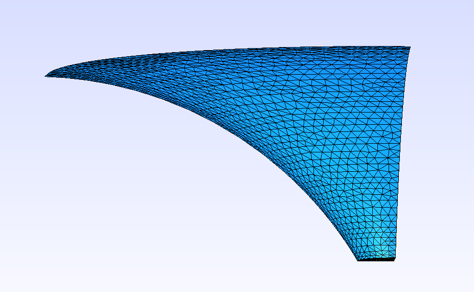

mabat> it would be a great help if you could provide me one .cfg with the new features based on the dimensions below. From there I think I can tweak for any future tweeter/waveguide combo. Looking to model out to 20khz, with N frequency steps of 30 on linear.
Basic dimensions (sorry for odd sizes, converted from inches):
throat - 30.374
mouth major axis - 127
mouth minor axis (golden ellipse) - 78.486
vertical horn profile radius - 30.48
horizontal horn profile radius - 73.66
depth - 19.05

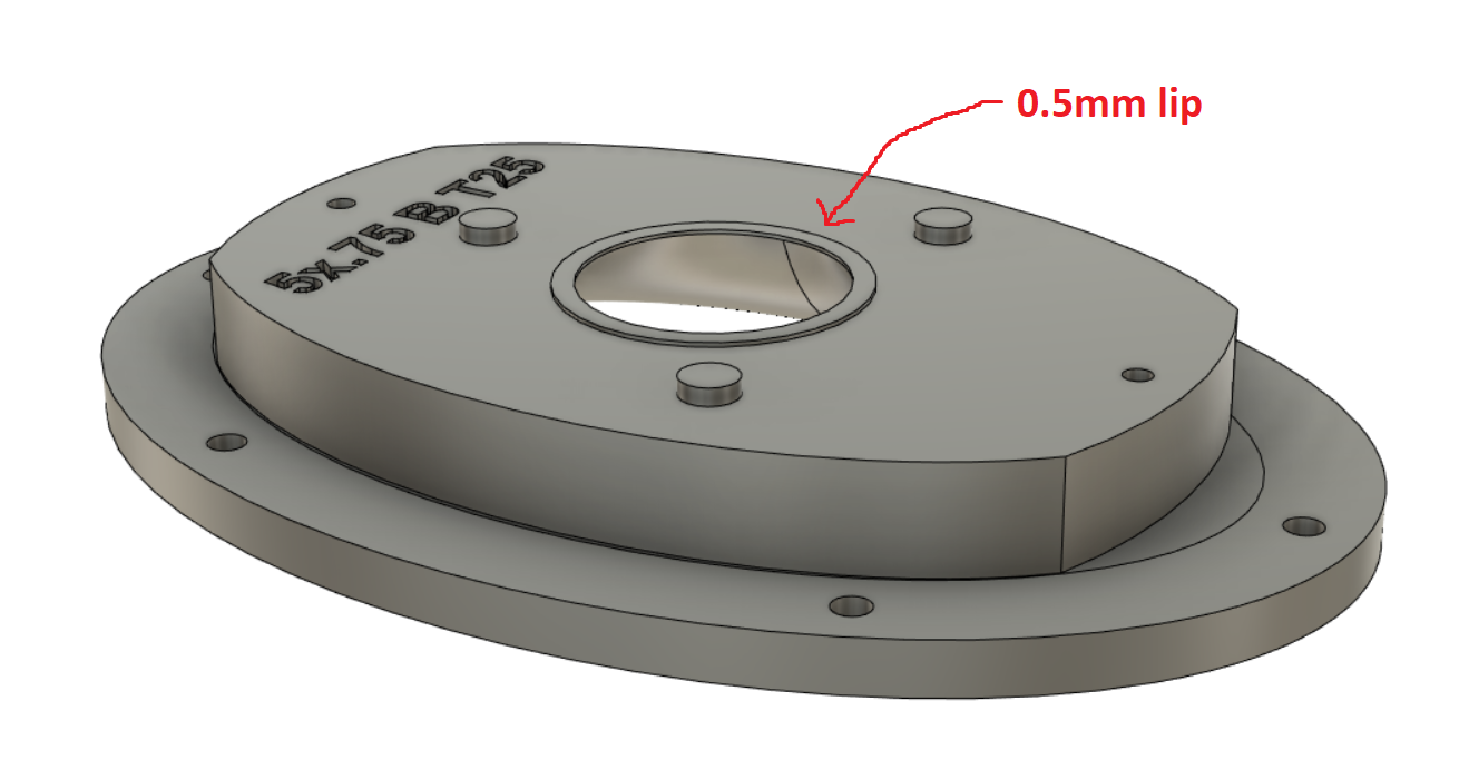

lip (see attachment) - 0.5
The dome attachment should be easy enough to read.
