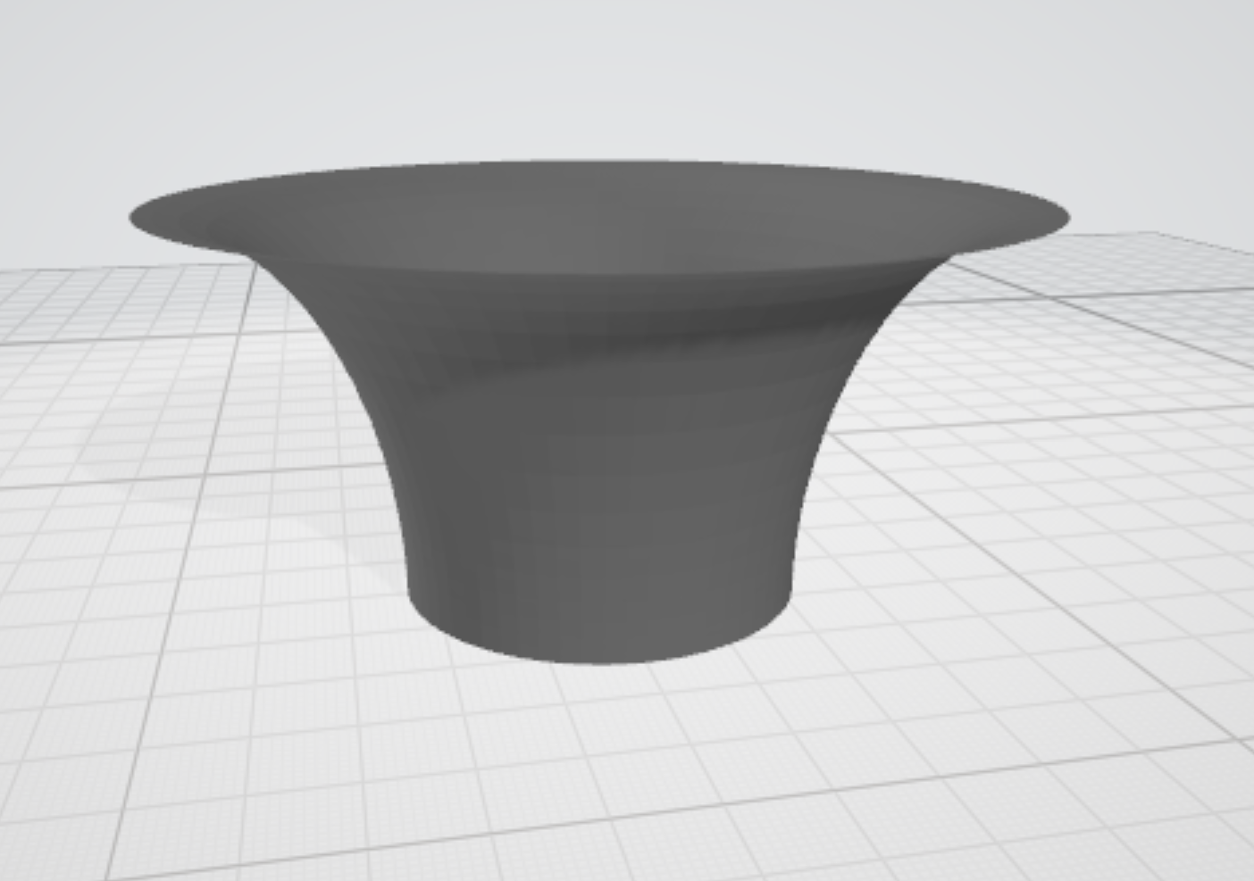

I used ATH 4 to create a waveguide. Once the software is set up it's extremely easy to create the waveguides. ABEC software was a little difficult to find, however. I wonder why they stopped distributing it.
I only have two problems now:
1) I don't understand anything about waveguides or how to properly design them.
2) I haven't figured out how to work with STL files so I can make templates for tools to DIY the waveguides.
I wish there was a DIY waveguide/horn sticky like the crossover sticky Allen B made. He explained the basic issues of crossovers and how to design and measure them.
Anyway, the software itself is very easy to use.

some things to consider:
1) the angle of the waveguide walls largely determine the coverage angle. IE, if the walls are 90 x 90, you'll get a wavefront that's (mostly) 90 x 90.
2) The diameter of the waveguide determines how low it will work. For instance, 1khz is 13.5" long. So if you have a waveguide that's 13.5" in diameter, it will control the wavefront down to about 1khz.
It's surprisingly simple! But like all things, The Devil is in the Details.

In regards to the difficulty of waveguide design:
A waveguide is basically a cone.
We have an entrance at one end (the throat) and an exit at another (the mouth.)
If it was perfectly conical (like a cone) that wouldn't be ideal, because there would be a mismatch at the entrance and the exit. That's where the oblate pheroidal stuff comes in; we have to match the curve of the waveguide, and the device that's driving it. That's why the exit angle of the compression driver is so important, and why the wavefront shape matters a lot.
Once all that makes sense, you'll start seeing it apply to all kinds of strange things in the world. For instance, I saw the same ideas pop up in an article that I read about freeway offramps. Basically the freeway engineers figured out that there's exactly *one* shape that's optimal for matching the offramp of a freeway with the road that it's attached to.
