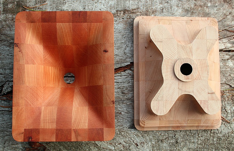

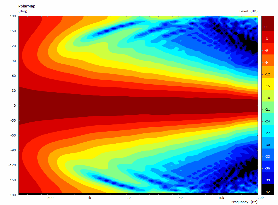

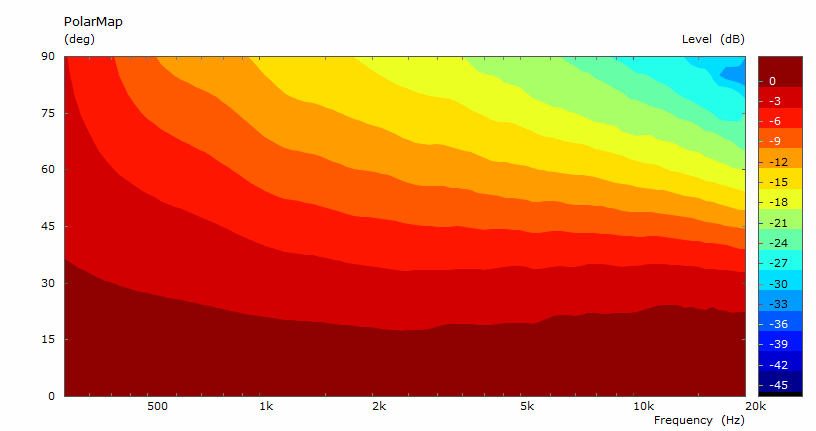

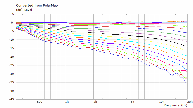

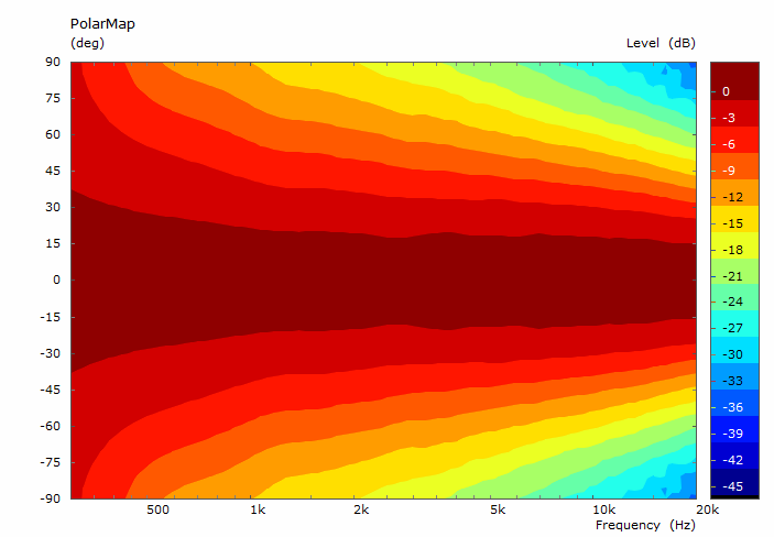

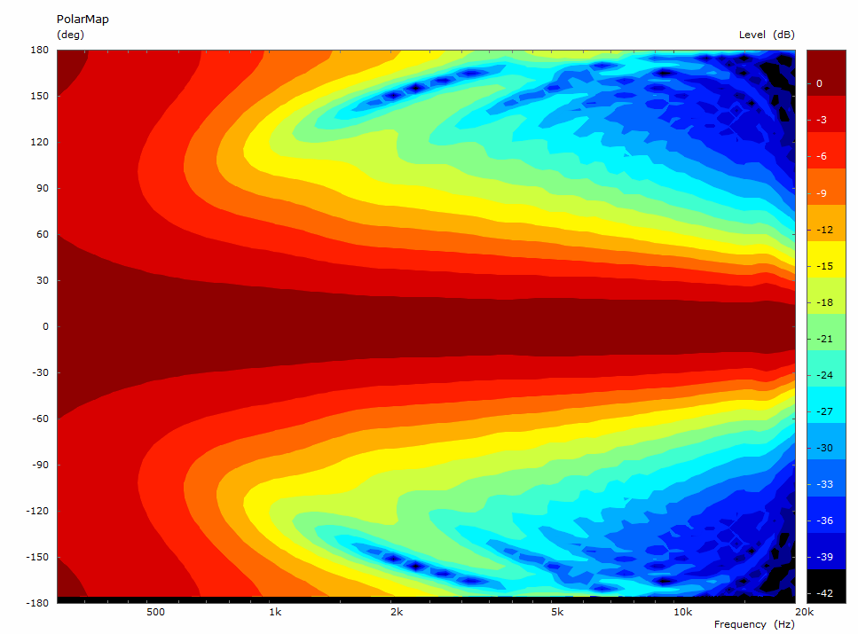

Back to horns - preliminary results of one of my recent designs: Free standing waveguide for 1" driver, ⌀260 mm. Thanks to Pet007 who printed and measured the prototype.
887394d1603621043-acoustic-horn-design-easy-ath4-cd60-83_n92_ath_254mm_volne_test_polars_sum-jpg

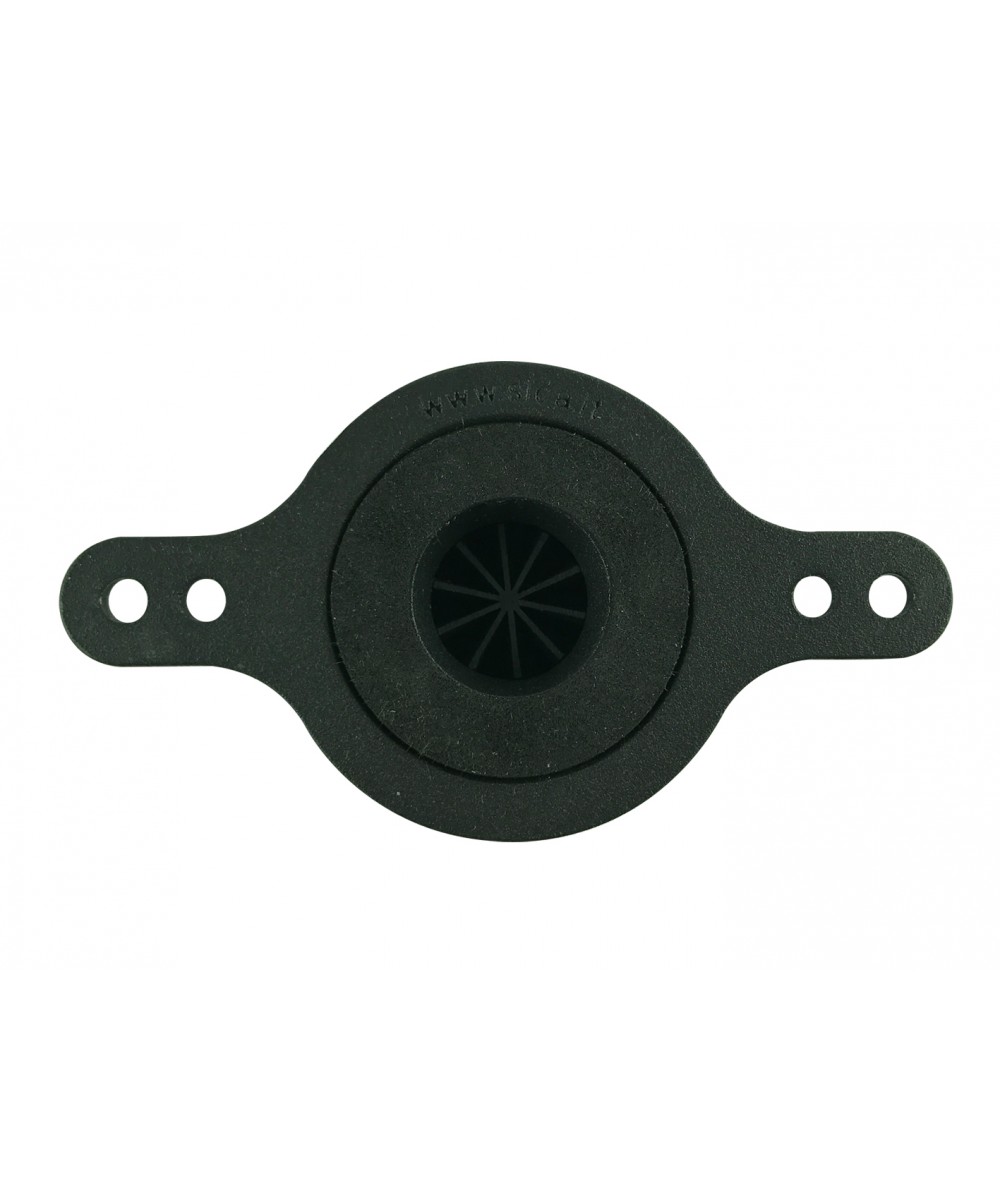

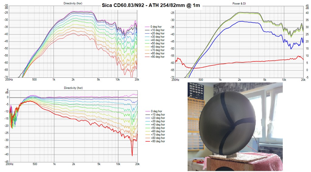

Exceptional performance - again, despite the tiny Sica's radial phase plug and especially considering its price.
837442d1587762394-acoustic-horn-design-easy-ath4-z009484-front_1-jpg

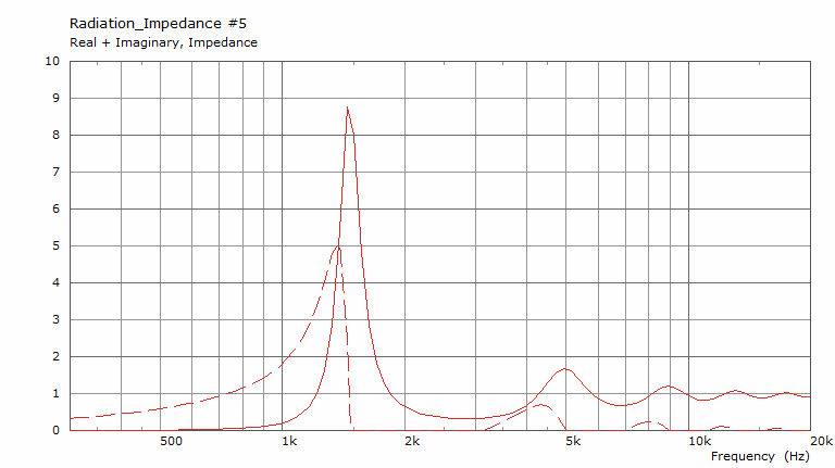

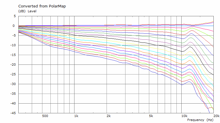

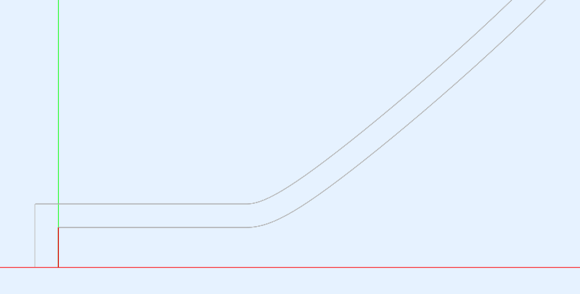

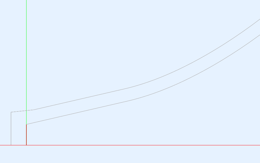

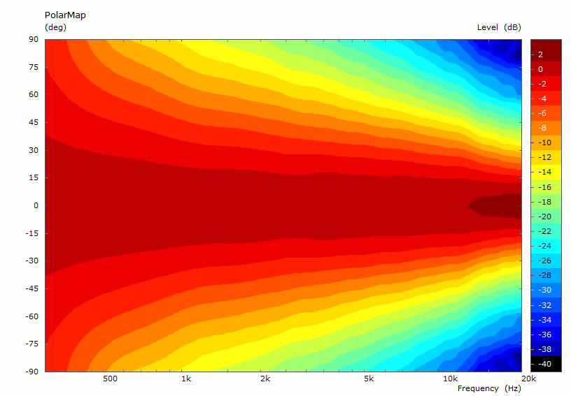

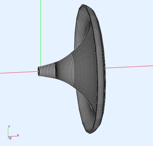

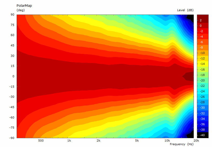

Now I prepare a free standing waveguide for BMS 4554, ⌀370 x 120 mm. This is 1.4" driver nominally but it has aboout 40 mm of conical exit (~26°), i.e. the actual driving area is quite small, only about ⌀17 mm.

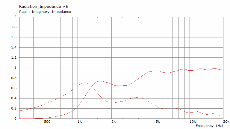

This is a simulation including the conical exit section (as shown before, there's still a reflection apparent in the impedance data due to the wavefront mismatch).

Hi, is a flat wavefront from driver best (or the only) way to get smooth impedance match to a horn? If there is conical extension with the driver the wavefront can't be flat? Just trying to understand if there is already some kind of rule of thumb to narrow down good drivers for ath generated horn that would match simulations well :)
Joined 2004

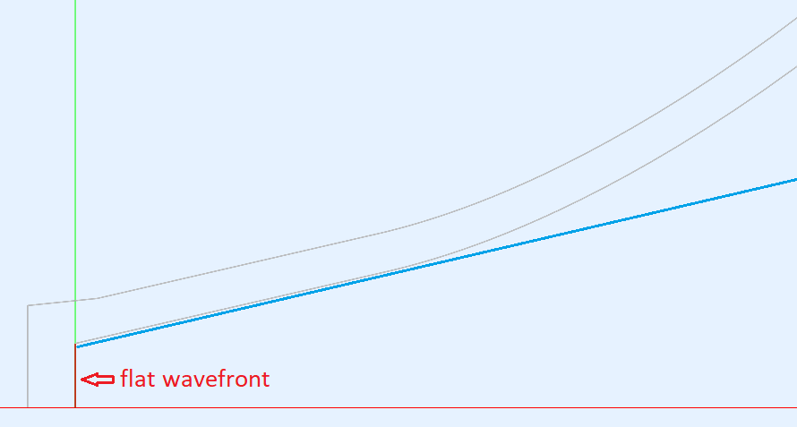

No no, not at all. I stated that only for completeness because at the moment flat wavefront is all I have implemented for the CircSym. Flat wavefront is the right shape to drive an OS waveguide (without any reflection). For example it would be spherical wave for a conical waveguide. In the presented case the conical exit is connected to something resembling an OS contour so there's the mismatch.
Joined 2004
I plan to print several throat geometries and measure them with the drivers I have at hand to see if there's any real trend. For this even a very small waveguide should suffice.
- That all said, the reflection shown above really doesn't mean much in the overall picture. It has some minor effect on SPL but that's about it.

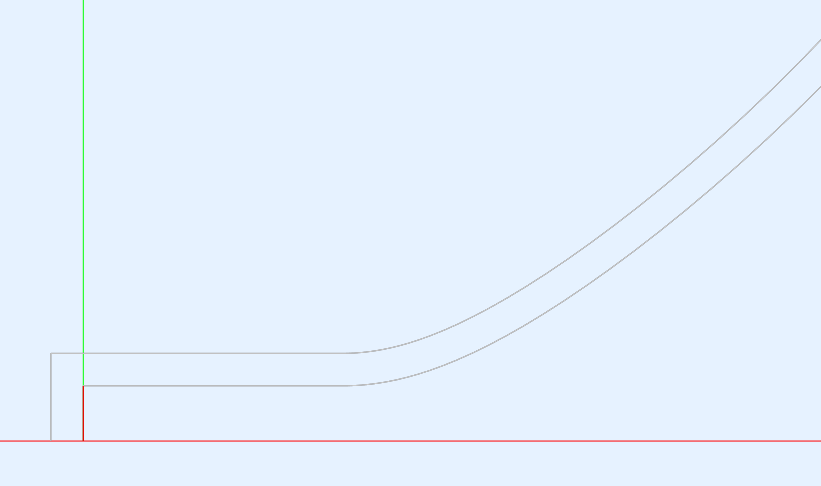

Well, in fact this is the horn curvature. One has to look at the driver exit section (if there's a one) as an integral part of the horn. In the example above this whole composed contour is driven by an ideal flat wavefront. What's the actual wavefront, I don't know. I only know that the smaller it is the less critical it is.
attachment.php

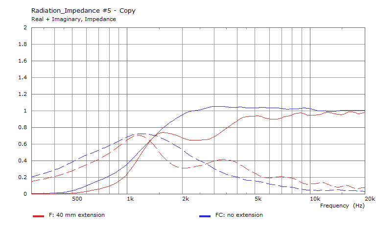

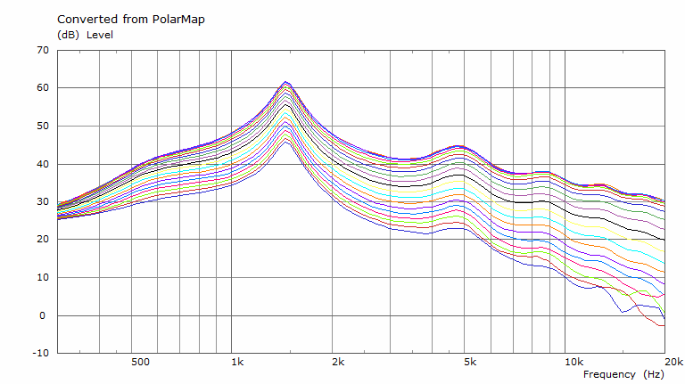

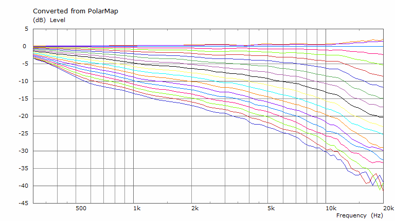

This is for a tubular extension inserted into the driver down to the phase plug exit.
If one was willing to compensate the strong resonance otherwise it's pretty good :)
attachment.php
