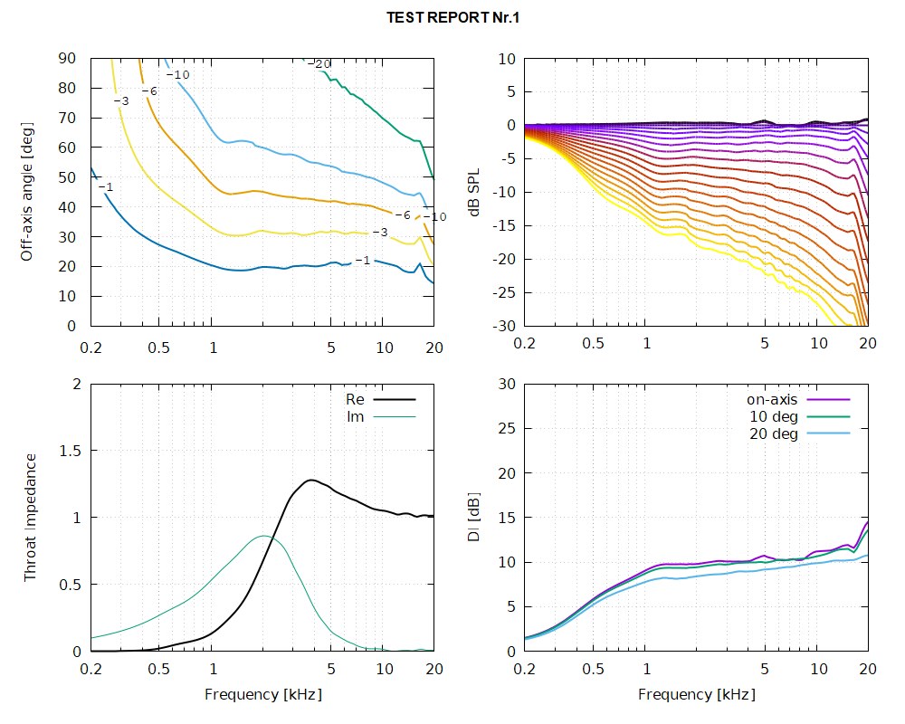

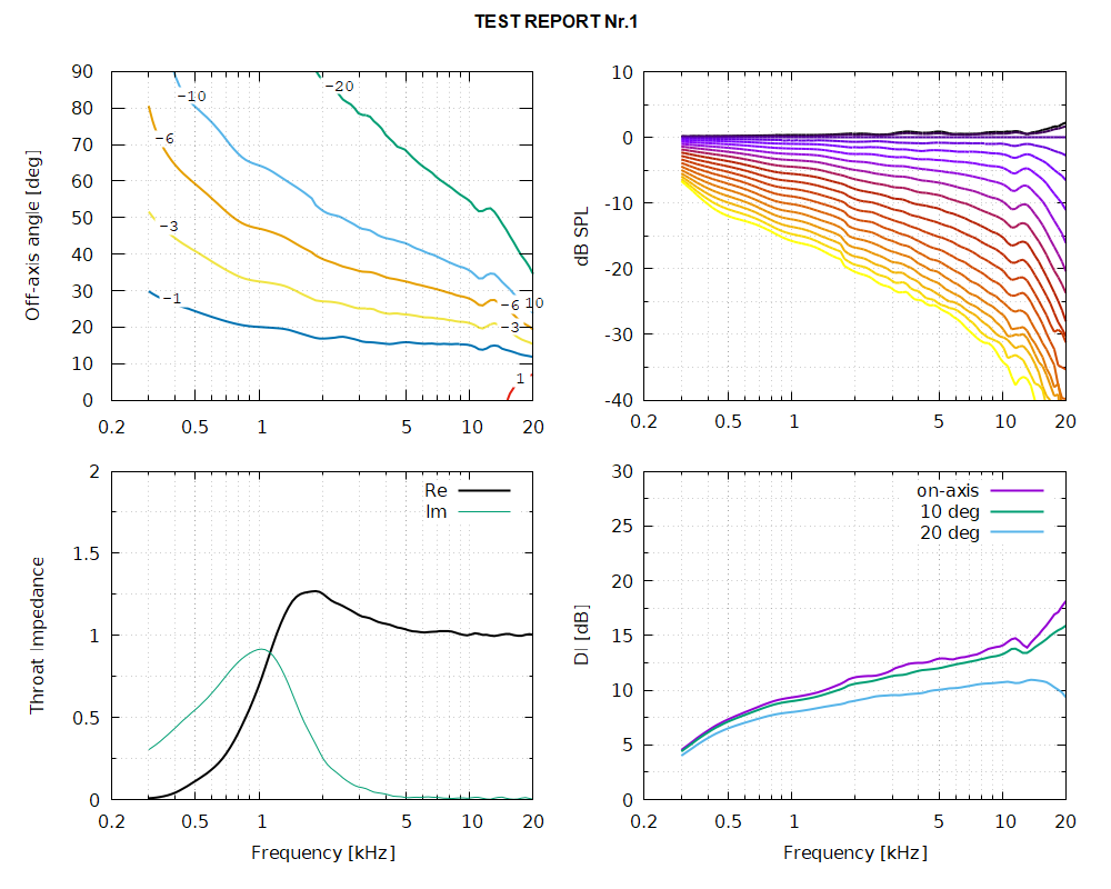

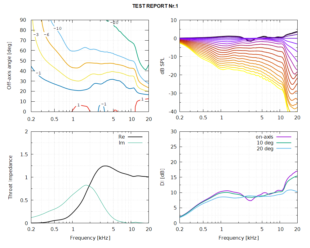

In the meantime I work on the optimization routines, including a "standardized" report format. So far so good 🙂

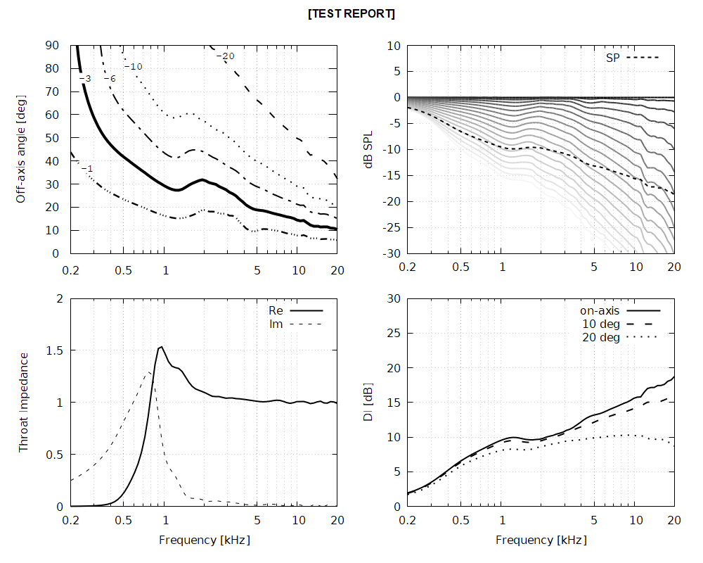

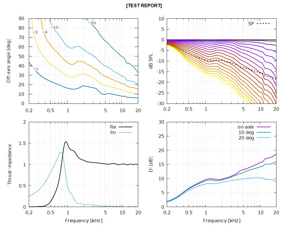

- Added Sound Power curve (SP), i.e. the frequency response of an omnidirectional source that would radiate the same total power. Actually, it isn't as obvious from the polars alone as I thought in the past and it's worth having it there.

That would be simply 0° - 30° in the axisymmetric case, which is all I plan to do. Sounds reasonable and I can easily try slightly different subsets as well, e.g. leaving out the on-axis response. I have data each 5°.
Maybe I will shrink it to 5° - 20° for the start.
Sounds good, although I'm not sure of the rationale behind omitting the axial response. The listening window (using the ANSI/CTA-2034-A definition) is nearly the same as the listening axis response (18°) with my speaker despite the slight axial ripple. The difference between the curves is like half a dB.
