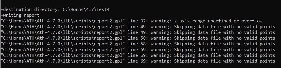

I have been trying to get the report function to work on a meshed xy freestanding horn but I get these errors. The vacs output looks OK, any idea what is going wrong?
This is the config
This is the observation script
Code:

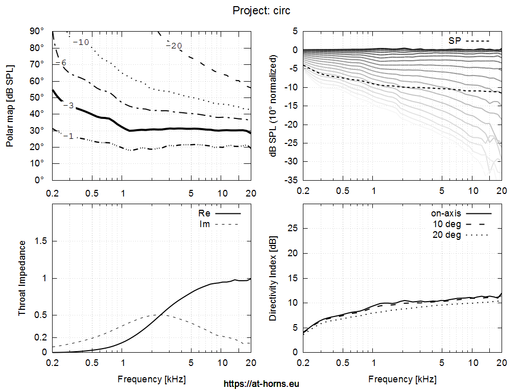

Do you mean you have the same waveguide shape calculated both with full-3D BEM and via the CircSym mode? I tried this and the differences were quite subtle.Not as clean as the circsym result, but still...
I would think that the ripples in the above report are more due to the waveguide itself.

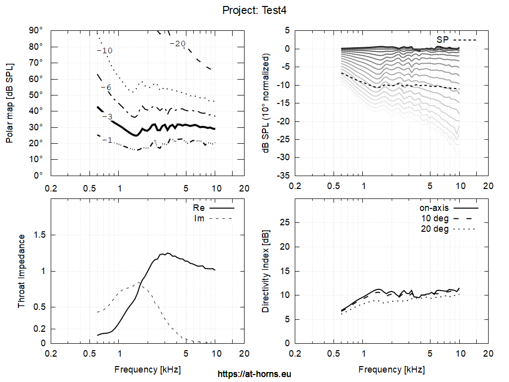

Yes the graph above is the same guide, (a different set of frequencies 600 to 10K to reduce time when fully meshed) but otherwise no difference.
I had to reduce the mesh density more than usual to get the elements reasonable, and the interface made more of a difference this time. Where did you place the interface when the sims were similar?
The spiky ripple is definitely the sim rather than the guide.
Circysm test for comparison
Then I suspect something must be different between the two models. This doesn't look like a typical numeric issue (only).
IIRC, I placed the interface at the apex of the mouth (in the full-3D case) but don't remeber the details. But I agree that these details have weird effects sometimes. With the CircSym, I settled on using just one (exterior) subdomain.

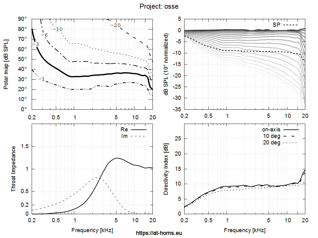

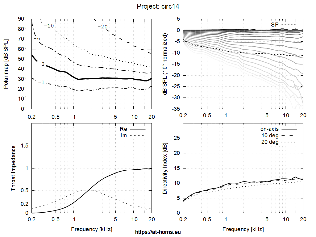

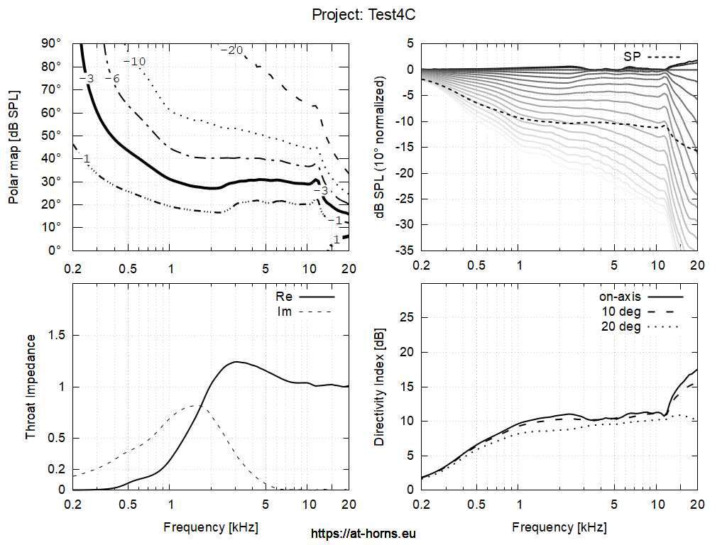

here is couple of my tries, one OS-SE for 1" and two CircArc, 1" and 1.4". All for asymmetric free standing WG's. They are looking promising, I hope so.
There is one thing what is not clear for me. OSSE show significant rise in DI when wavelength become smaller than throat diameter. On other side CircArc is almost flat. Is that some simulation error or inherent feature of CircArc design. If is it later is there any explanation for it
You are definitely on the right track
The CircArc examples would be exceptionally good, IF you used a practicable source at the thoat - I suspect that you left the default, matching spherical source there (i.e. a pulsating one). Then it surely would be this good but such source doesn't really exist - no available compression driver will do that at the moment, I'm afraid (and maybe we still could try to make a one).
- Try to connect a common throat extension of a compression driver to the above models (Throat.Ext), driven by a flat wavefront (Source.Shape) and see what you get. Or just a flat wavefront directly, without any extension.
Yes, I left the default. Is it the option 2- flat wavefront more realistic?
Or I should model the source and implement it in script file. Easy to say but without CD almost impossible.
Are you modeling your horns with some source model?
What is your opinion about lack of DI rising in CircArc?
I would use either flat or a spherical wave but with much larger radius (and in that case it's maybe best to try to simulate an exit section of a specific driver).
As I said, I find it realistic with that source. That's the reason I tried to develop the spherical wavefront phase plug - it could be this good, no matter the throat size, at least in principle. (In the end it probably woudn't because of other reasons.)What is your opinion about lack of DI rising in CircArc?
I'm just guessing here because I don't know the wavefront shapes at the exits of compression drivers, but if there's a conical extension (as almost always is, although there are drivers without it), I assume a spherical wave corresponding to that exit angle could be used as the first approximation. Or just a flat wavefront..
