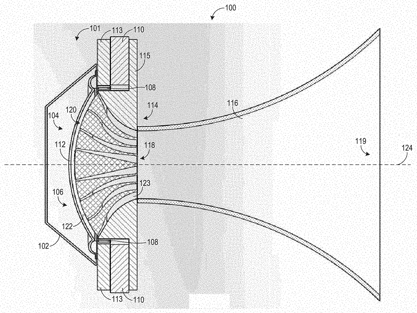

that insert seems like really good idea. It will be very easy to make it on lathe machine (and probably more precise than 3D printing).
It will make entry angle 0 for all CDs where is applicable so, as I understand, naturally better for the flat wavefront.
To not squeeze the exit to much maybe will be the best to take 1.4" CD and implement such insert

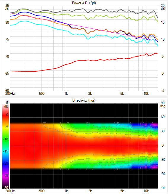

Dunno, but here are some extra plots.
it is depend of the length of throat exit. If it is short enough it will be possible to incorporate it in OS throat profile of WG. Otherwise we need an insert if want to follow the WG profil from pp

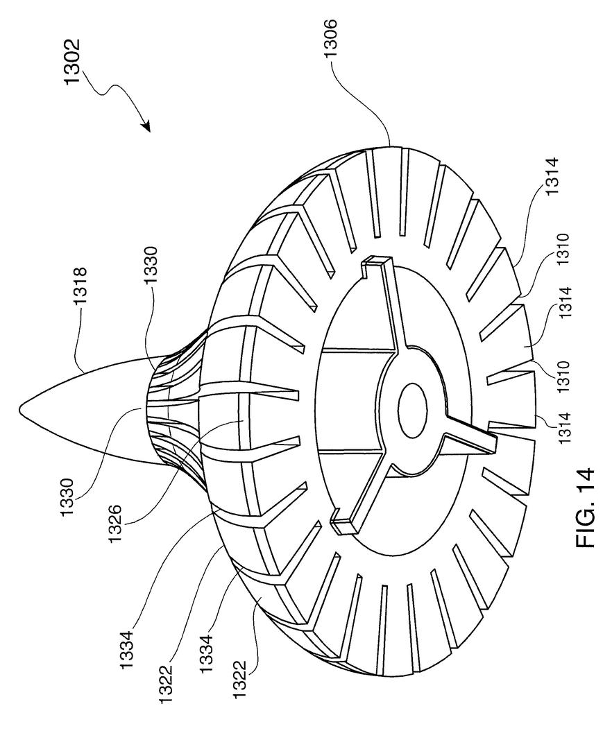

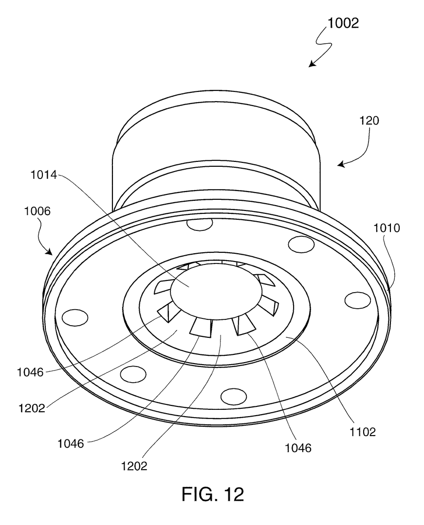

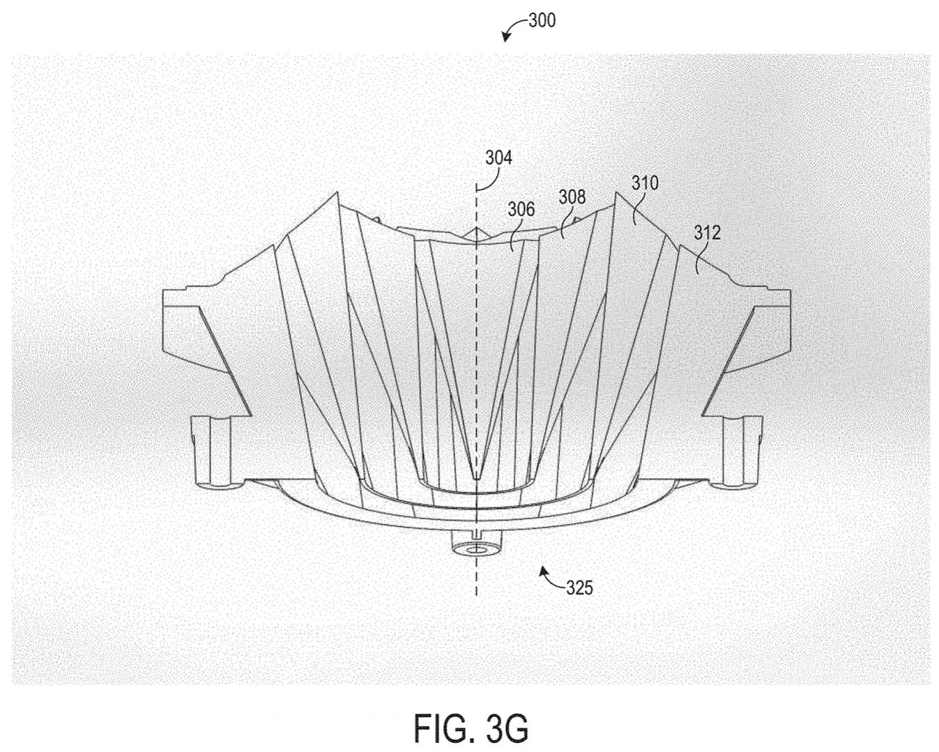

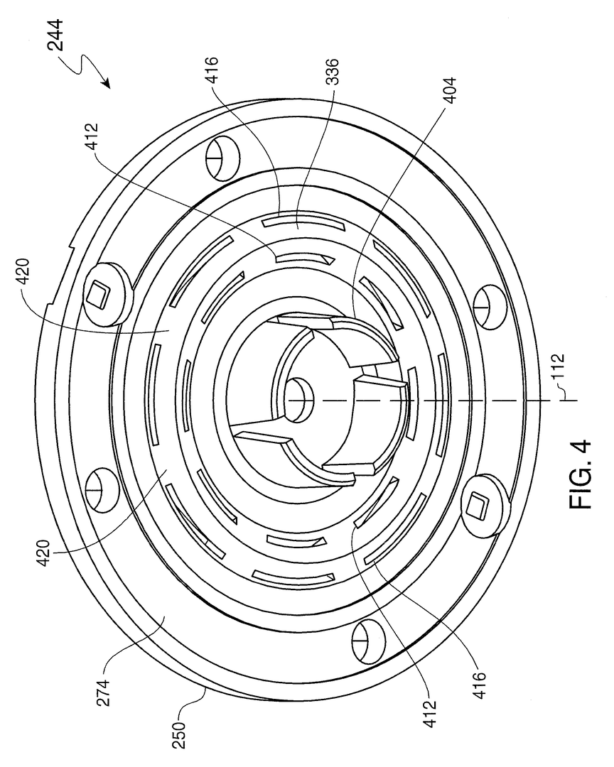

This probably also depends on the type of diaphragm and the specific design of the phase plug.
The outer slit of a 3 slit annular phaseplug may, or may not interfere with a throat insert.
The same may be true for some ring radiators in which the wave front is directed past a centrally located plug.
