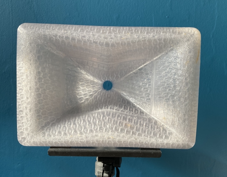

Here are some pictures of prototypes I've been printing:
![20210422_070328648_iOS.jpg 20210422_070328648_iOS.jpg](https://www.diyaudio.com/community/data/attachments/866/866551-b8057258cf892062bf67045e3241d0f2.jpg)
![20210422_070342298_iOS.jpg 20210422_070342298_iOS.jpg](https://www.diyaudio.com/community/data/attachments/866/866557-3828a635e609c8e6933b5136358514a7.jpg)
![20210416_070201296_iOS.jpg 20210416_070201296_iOS.jpg](https://www.diyaudio.com/community/data/attachments/866/866563-912863f02e41d679394a87ca75346c89.jpg)
![20210513_132238709_iOS.jpg 20210513_132238709_iOS.jpg](https://www.diyaudio.com/community/data/attachments/866/866571-4a5c701f2e934696a7a1d4c63992a676.jpg)

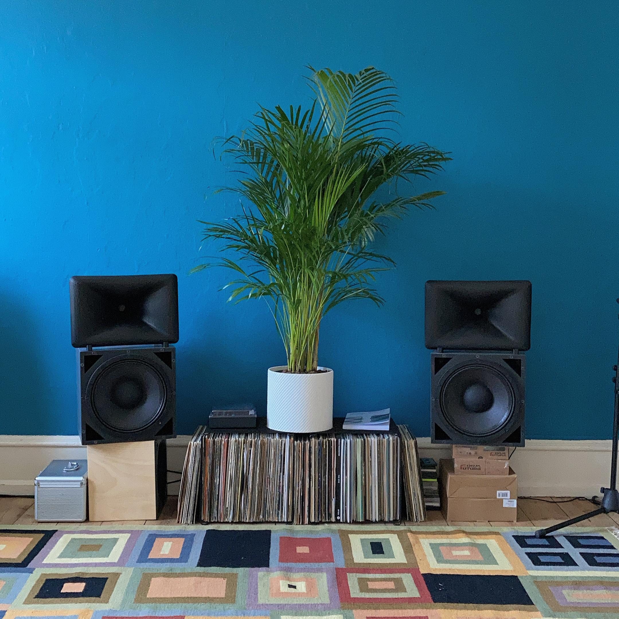

There is an invisible cage protecting them acoustic creatures from these light eaters and I think it looks marvelous! Also would like to understand the 2-way system with parameters and so.for the love of (insert deity name here) take that damn plant off those albums....

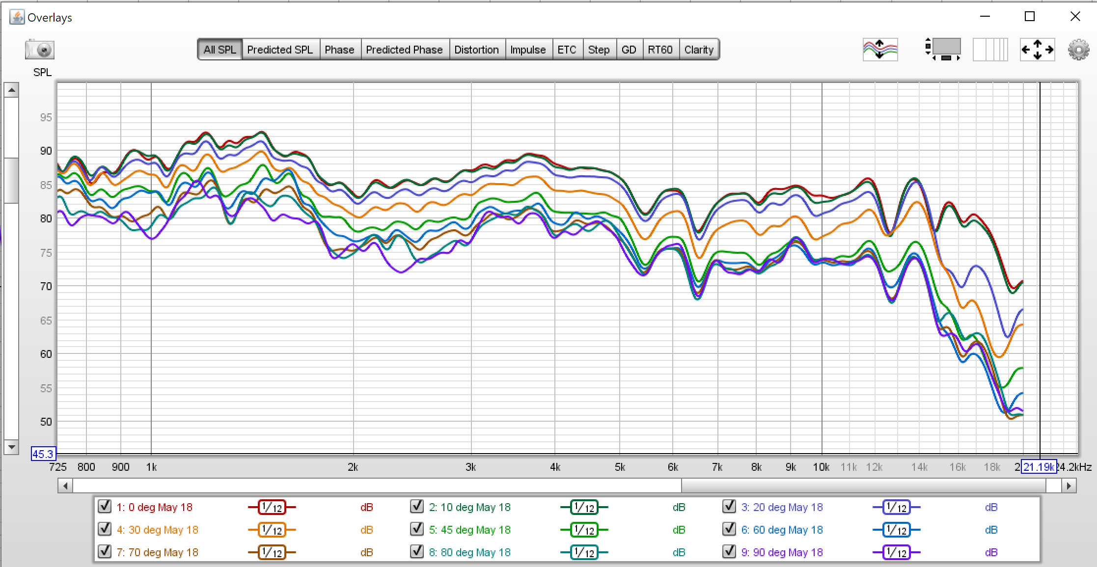

Here's the horizontal polars at 1 meter. Not looking very good.
Any gating/windowing applied?
