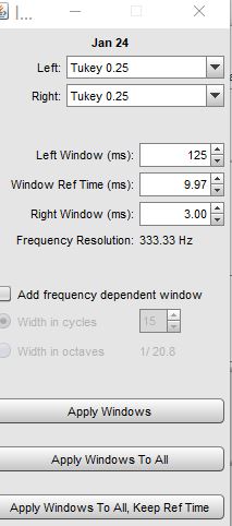

Then I ask your help, to please fix my understanding....
Given:
Frequency Resolution = Sample Rate / FFT Size = 1 / Time Window
or expressed as:
Time Window = FFT Size / Sample Rate = 1 / Frequency Resolution
What Sample Rate and FFT size can give a Time Window of 3ms, and provide better Frequency Resolution than 333Hz?
Once a 3ms gate (post impulse peak) is put in place, how do the above relationships not hold mathematically?
Thank you !

Guys, I don't mean to be dense....
May I use REW 'IR Windows' to try to understand what you are saying?
When Right Window is set to 3ms, Frequency Resolution is 333.33Hz.
(And magnitude graphs smooth out to show the resolution reduction.)
I totally get gating works fine once above a frequency where the reduced resolution is no problem. (like for the waveguides in this thread).
But for understandings sake, I still do not get how resolution doesn't decrease with gating......
Do any of our measurement programs use this 'zero-pad technique' you mentioned, to maintain resolution after gating ?
![REW gate snip.JPG REW gate snip.JPG](https://www.diyaudio.com/community/data/attachments/873/873707-6e44679b6ed06b3588a5766c3092f3d9.jpg)
It does, but as long as you don't trim the actual IR significantly, this resolution is still high enough to describe the DUT accurately (and can be "increased" further by zero padding, that's another thing).But for understandings sake, I still do not get how resolution doesn't decrease with gating......
- How long gate would you need to measure a device with a perfect IR? A few samples should be plenty without loss of anything, because in that case the frequency response is also perfectly smooth - you don't need much resolution to describe that. The better the device, the shorter gate can be used (i.e. the shorter its impulse response).
