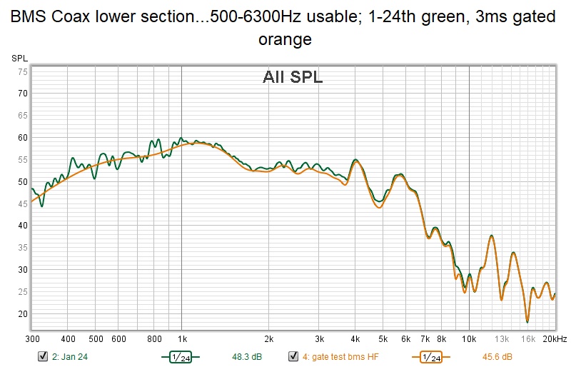

Here's a comparison of the lower section of a BMS coax, a device used in reality, good from 500Hz to about 6kHz.
Same measurement. Green is smoothed to 1/24th. Orange is 3ms gated.
![REW gate compare.jpg REW gate compare.jpg](https://www.diyaudio.com/community/data/attachments/874/874567-b35699db2c738485d707d5eca394b31f.jpg)
You can say what you want, but below 1000Hz, the gated curve doesn't give me enough frequency domain info, to do good work with.
I ask you again, please don't frame your view on gating as pure truth, without specifying the narrowed set of conditions for which it holds.
The science of the time /frequency tradeoff isn't just about HF horns....especially in a world that is asking horn/CD combos to dig ever lower in frequency.
Many of us watching this thread have hopes it will lead into larger horns with lower frequency control, than can be made into synergy designs.

Frankly, I'd say that none of those curves is truly representative of the actual device. Orange is too smoothed and the green seems to include too much of the environment.Here's a comparison of the lower section of a BMS coax, a device used in reality, good from 500Hz to about 6kHz.

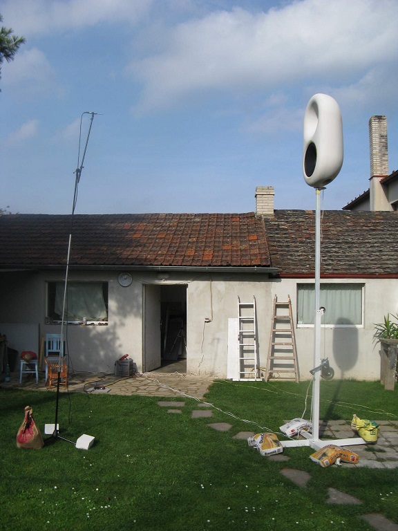

I agree. That measurement was the first thing I could find made with REW, and was taken indoors for an unknown reason. I wanted to use REW because of my previous IR Window panel reference.
Here's the outdoor setup I use for measuring/tuning. Always with dual channel, other than a rare REW sine sweep for distortion. Pink noise is so much easier on the neighborhood, than siren sweeps Lol.
The 3 mic boom rotates, but I usually rotate with a turntable.
It's a very handy mostly reflection free setup, for 100Hz and up work.
Below 100Hz, for subs, I just drag them out onto the driveway and measure at 4m, well away from buildings, cars, etc.
