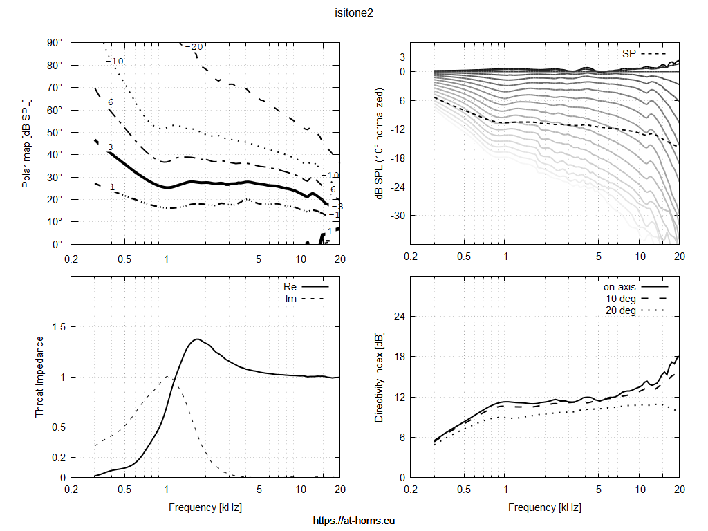

From what I can see, the old config files no longer work in ATH 4.7.1?
The new config files features this format:
ABEC.Polars:SPL = {
MapAngleRange = 0,90,19
NormAngle = 10 ; [deg]
Distance = 3 ; [m]
Offset = 95 ; [mm]
But there's no apparrent way to generate polars on the X and the Y axis?
When I include a stanza like this, it doesn't work. (It used to.)
ABEC.Polars.Dist = 2 ; [m]
ABEC.Polars.Step = 7.5 ; [deg]
ABEC.Polars.Points = 8
ABEC.Polars.Horizontal = 1
ABEC.Polars.Vertical = 1
ABEC.Polars.Diagonal = 0
ABEC.Polars.DiagonalInclination = 0.0

Yes, sorry about that. You have to set an inclination angle for anything else than the horizontal. It's missing in the manual:...
ABEC.Polars:SPL_V = {
Distance = 3 ; [m]
Offset = 95 ; [mm]
Inclination = 90 ; [deg]
Remember this was a coaxial compression driver. This is about as good as it gets for that kind of device. The good thing is that there are no vertical lobes above the lower xover point - what you see is basically the complete behaviour of the loudspeaker in that band.

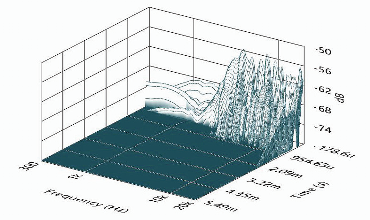

The ripples / resonances are likely - at least to some extent, inherent to the DCX464's design, probably due to interference from the HF diaphragm and the exit channel.
The ripples (> 8k) are at least present in the plots I've seen from the DCX464.
Perhaps Mark(100) has some measurement data for comparison.

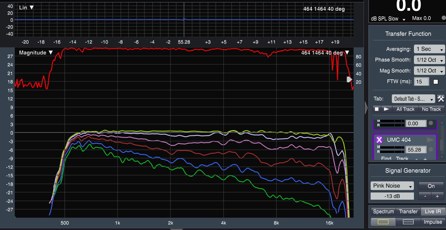

Hi Ro,
I posted this some time ago in the dcx464 thread...so nothing new.
When i saw the lack of coherence in it at above 16kHz, I thought i'd grab some new outdoor measurements this morning as there is no wind today...but not to be...boats, waves on shore etc....coherence fell everywhere.
Anyway, it's the dcx464 on xt1464 which is the best behaved horn i have.
Hey, a question for all:
How do you like to see polars in these type mag vs freg graphs?
Do you EQ on-axis (or whatever near to on-axis angle is chosen to tune to), and then measure polars?
This is what I like and is in graph below.
Or do you measure raw and show raw?
I use this for choosing xover points, but find it too difficult to judge horn performance, trying to see if ripples are uniform across angles.
Or do you prefer to measure raw, then show normalized to on-axis?
(Have to admit, this is my least favorite to see)
Thanks ! mark

Vance Dickason's HF waterfall with the prototype La Tromba horn and the DCX with the ME464 for comparison (mind the 10 dB increments):
