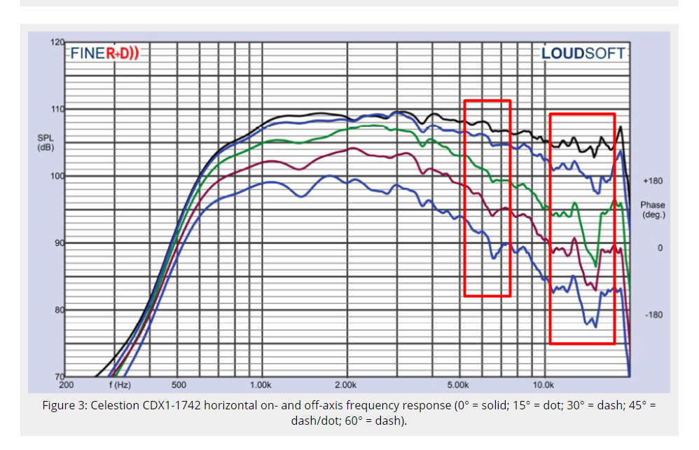

These are some first driver I found form the Test Bench.
aragorus, gotta think how the 0,0 mode and 0,1 (and other modes) "sum" with some ratio and form the total output of the system. Without knowing how the modes compose I tried to think about mabats visualizations and what 0,0 and 0,1 summed at some ratio would look like. There should be a slight dip ~6kHz and on axis peak at ~15kHz if the 0,1 mode is loud enough. I tried to look the measurements if any of this is seen in real devices (with some random horns they happen to be measured in).
I think these few db effects is the most that we'd ever see on modern devices.

I couldn't help but notice that the source in all 3 cases looks pretty much flat.
Am I missing something?
You missed what s going on at 3,2kHz impedance?
![20201104003650_Figure1-REDCATT-140FCDCompDriver.png](https://audioxpress.com/assets/upload/images/1/20201104003650_Figure1-REDCATT-140FCDCompDriver.png)

TNT, others, yeah the drivers have a lot of impedance wiggle. Particularly interesting is the first axial mode 0,1 output that could possibly show in the impedance plot, and then as mabats simulations show in the frequency response / polar plot mostly as a dip at ~6-10kHz and an "on axis peak" at ~15-20kHz or thereabouts
On a 1,4" driver this was lower in frequency, and 2" lower yet.

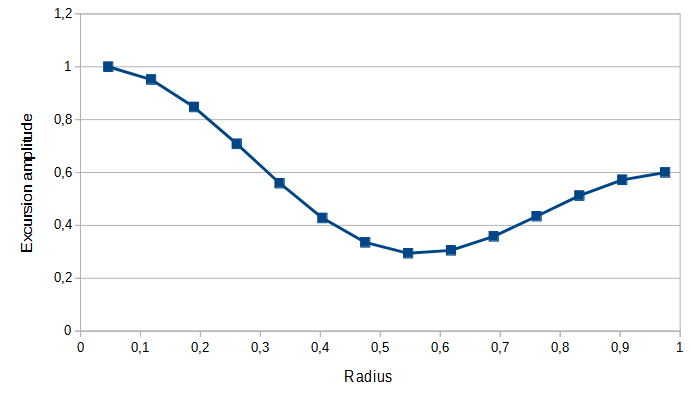

A mode is defined by the amplitude and phase (polarity) distribution across the throat area, which is considered flat here, as for a true flat wavefront. You can imagine a set of concentric rings that each vibrates with a different amplitude and phase - this is actually how it's simulated.I couldn't help but notice that the source in all 3 cases looks pretty much flat.

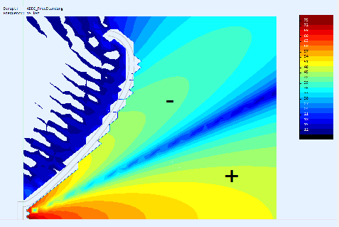

This was what I asked earlier, how accurately can this model describe a real wavefront at the exit of a driver that has a conical section there, not a duct. It's still an approximation - the better the closer is the output section to a cylindrical duct. Maybe I could also try to map the same distribution across a surface of a spherical cap corresponding to the exit engle of some driver, to see what difference does it make.
As the simulations match the real measurements quite closely approximately up to a frequency where the first higher duct modes start to propagate (12 - 13 kHz in a case of 1" throat), I believe these modes are really what makes the sims to deviate from the reality above that. But I would need to try to actually calculate (i.e. estimate) the weights of the modes and see how close I'm able to get to the real data.
I know and I know what you meant, I was just pointing to the fact you said no obvious faults when there was a glaringly obvious fault much worse than any potential mode issue.fluid, mabat 0,1 mode sims are wavefront at throat and the frequency response /polar plot seems to relate the throat size. The 3,5kHz is lower than this and is some other issue with the driver that doesn't produce the first axial mode in the wavefront but something else.

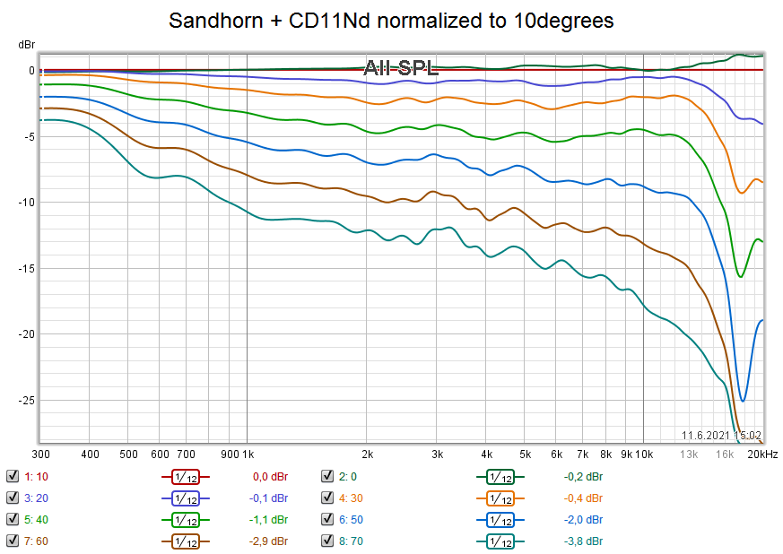

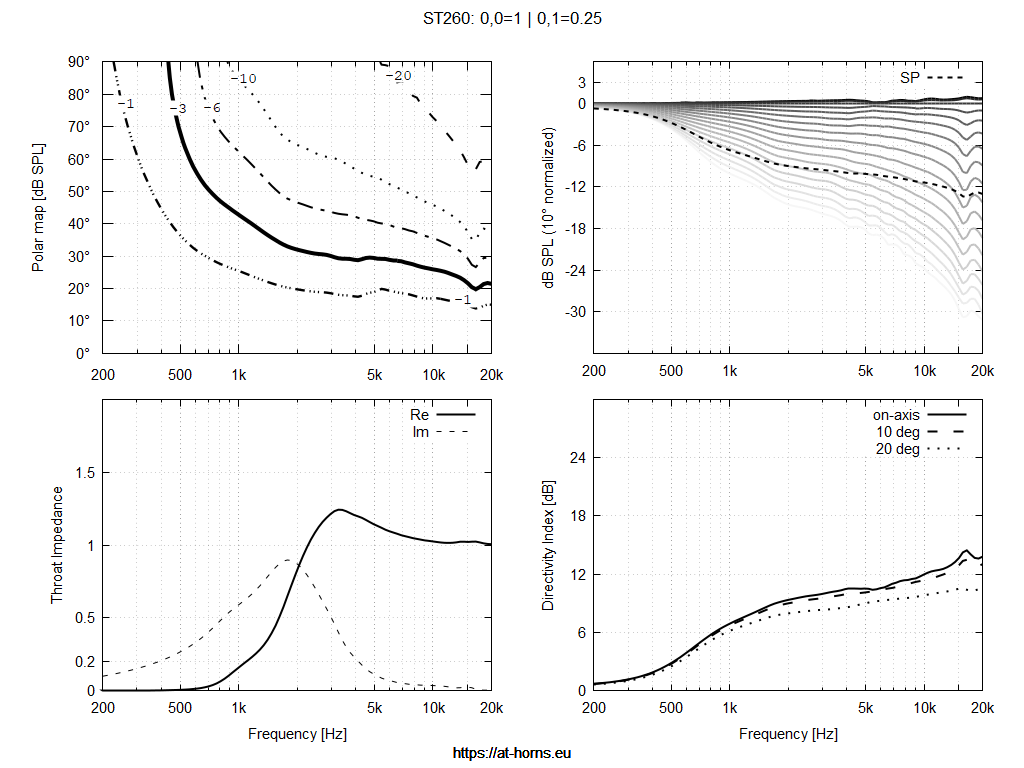

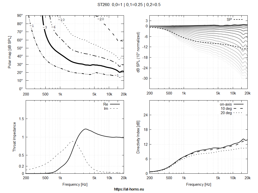

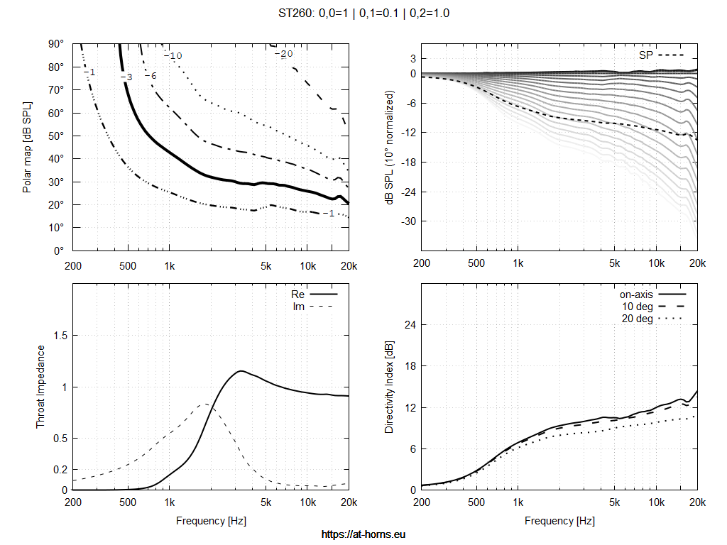

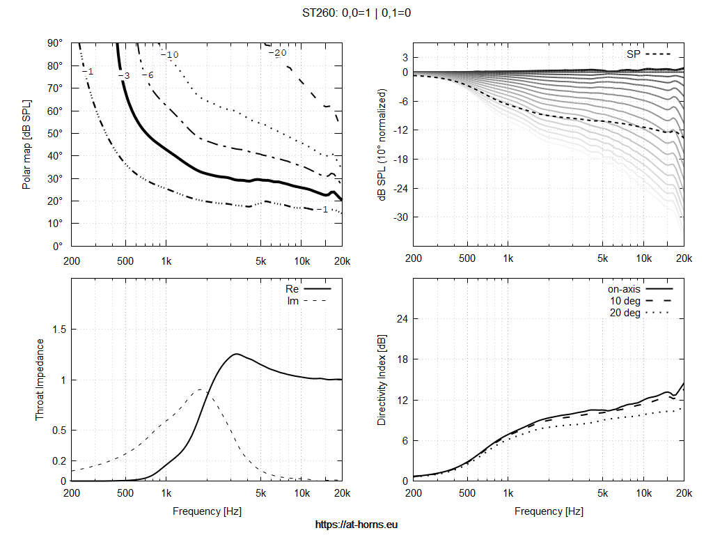

For example this is the sand horn, measured with a Beyma driver (courtesy of BV, who has the horn up and running). It seems clear how the first axisymmetric mode enters the picture above ~13 kHz and peaks around 17.5 kHz. This is pretty much in agreement with the simulations.

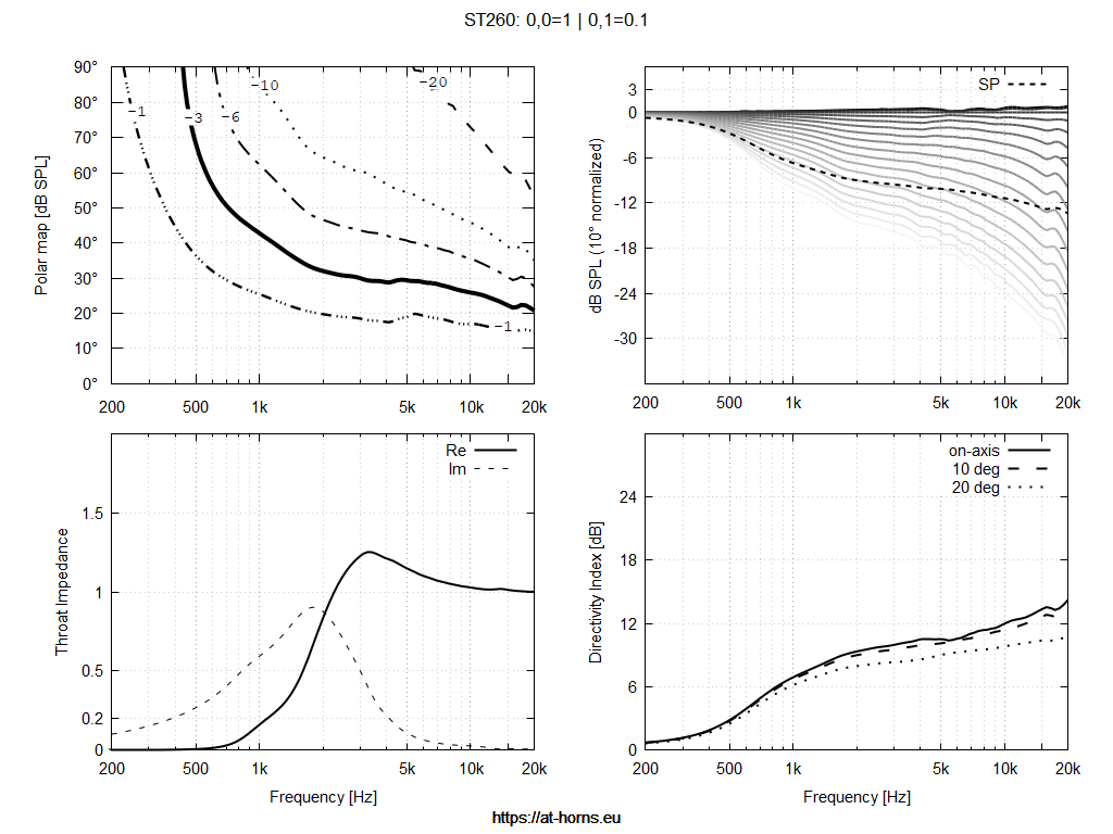

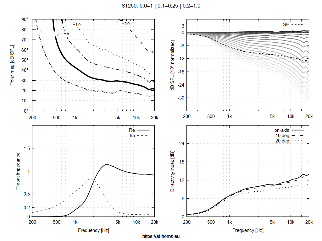

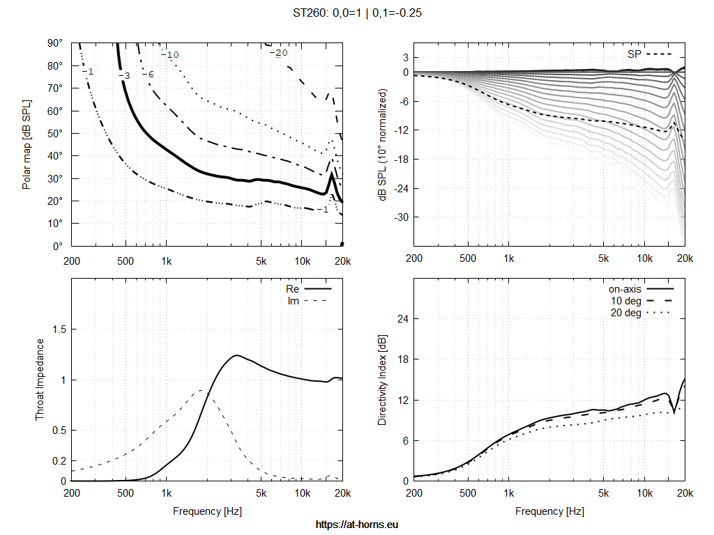

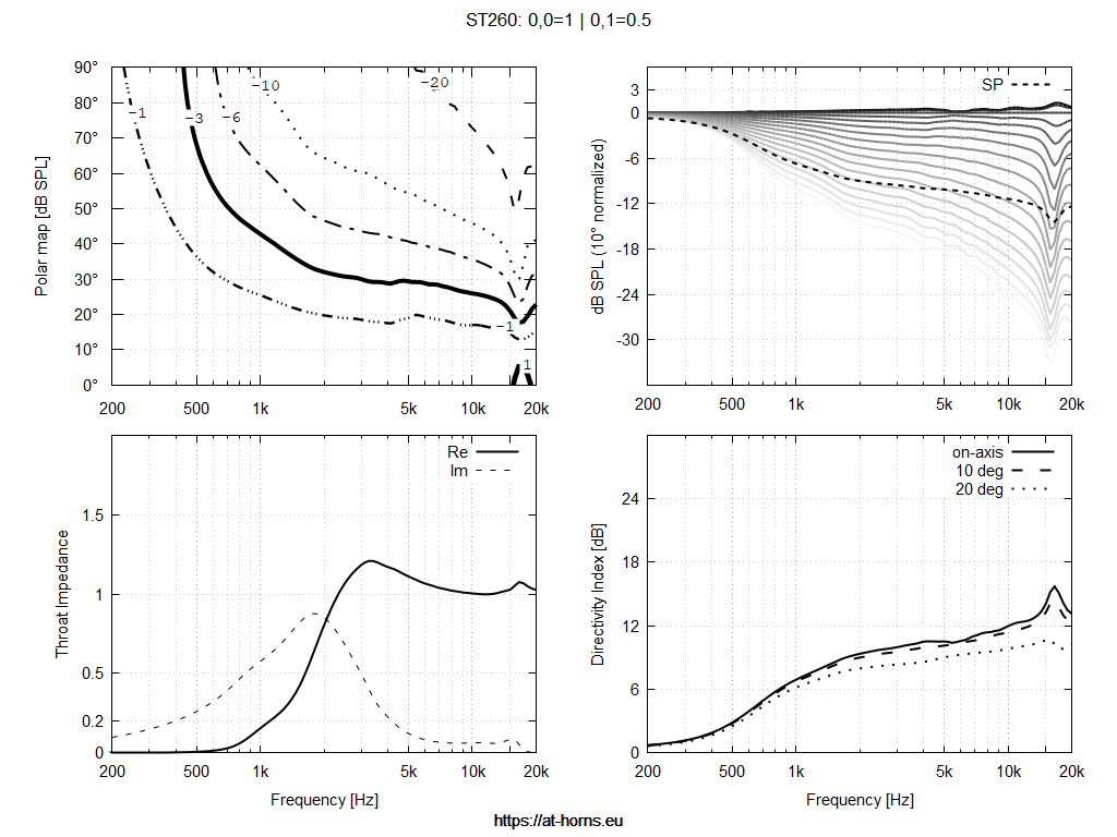

Now something very close to the ST260 waveguide - mode 0,1 added to the fundamental (0,0) in different ratios (independently of frequency).
Weights of the mode 0,1 relative to the fundamental, on plots from left to right: 0.0 (i.e. the fundamental only), (+)0.1, (+)0.25, (+)0.5.
(+) means the modes are in the same polarity on-axis.
Nice, the +0.5 mix looks to have similar pattern going on as in the celestion driver response on the previous page?
If I remember I think i've seen the - 0.25 lookalike results while trying out the various ath parameters few months ago (with a flat source). Need to look them up, if it could be a potential countermeasure? Not sure if I stored any of the poor looking results but if it was something real you might have seen it as well.
