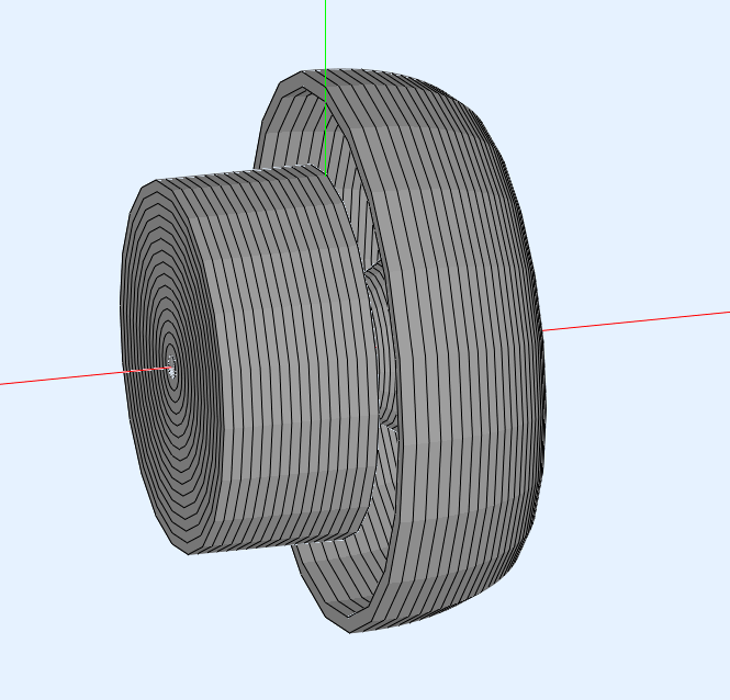

First I have to develop the calculation itself and there are still voids I don't know how to fill yet. The rest should be easy.
I also wanted to simulate some non-axisymmetric modes but that's another big amount of work, as any other leaving of axial symmetry...

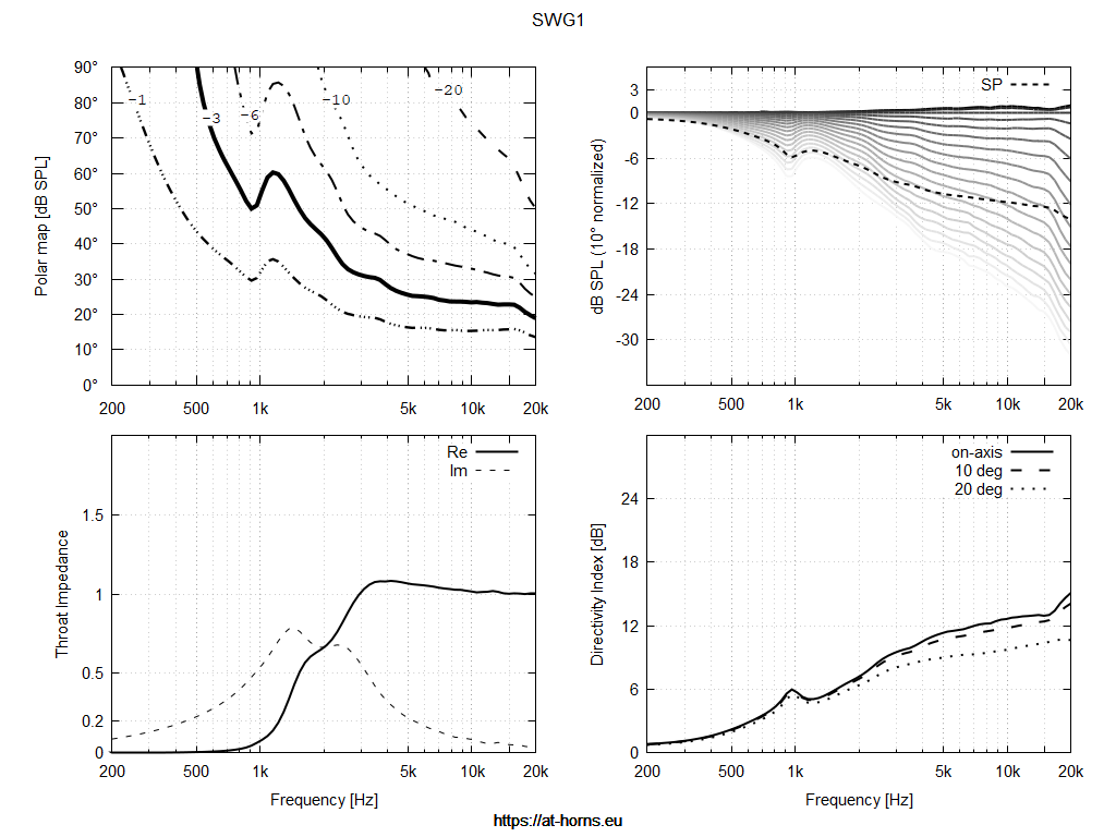

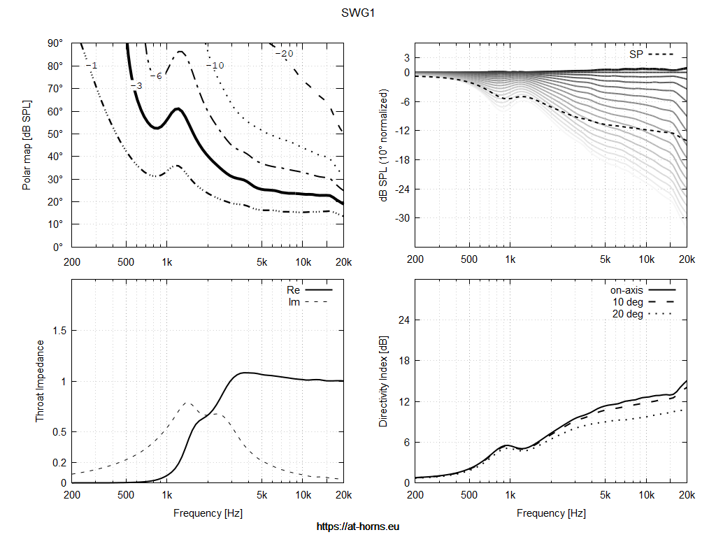

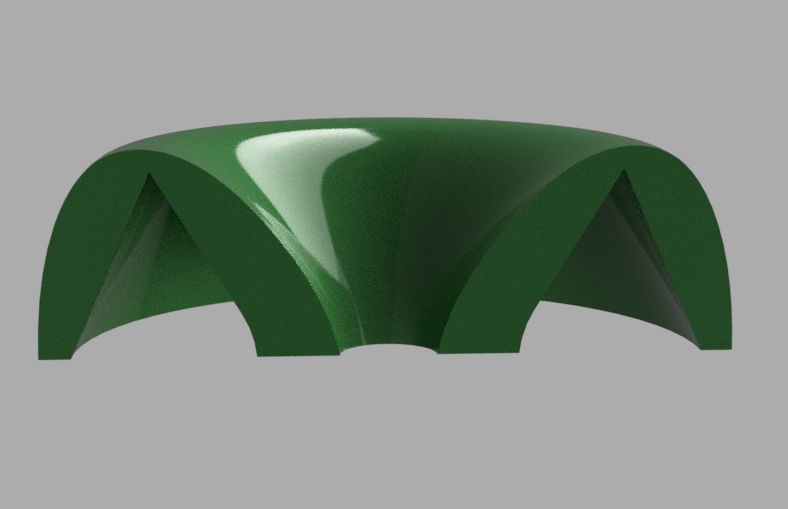

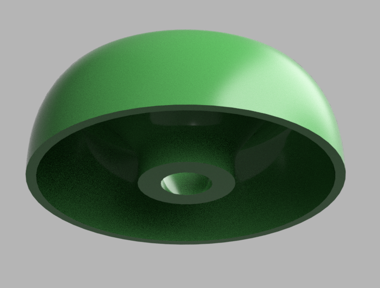

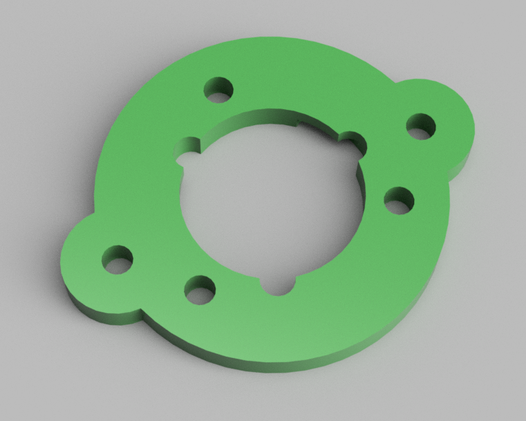

- I'm finishing the "reference waveguide" design. As it is, it should be easy to print in one go, without any supports (those who print know very well what I mean). It will compose of two pieces - mounting plate and a waveguide body. (For 1" drivers this is ⌀170 x 50 mm, not necessarily the final one.)
I'll do this on my next horn. Thanks for the tip. That's a very smart idea to make the inside triangular, no support and stronger/thicker horn.
