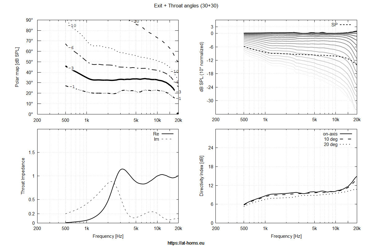

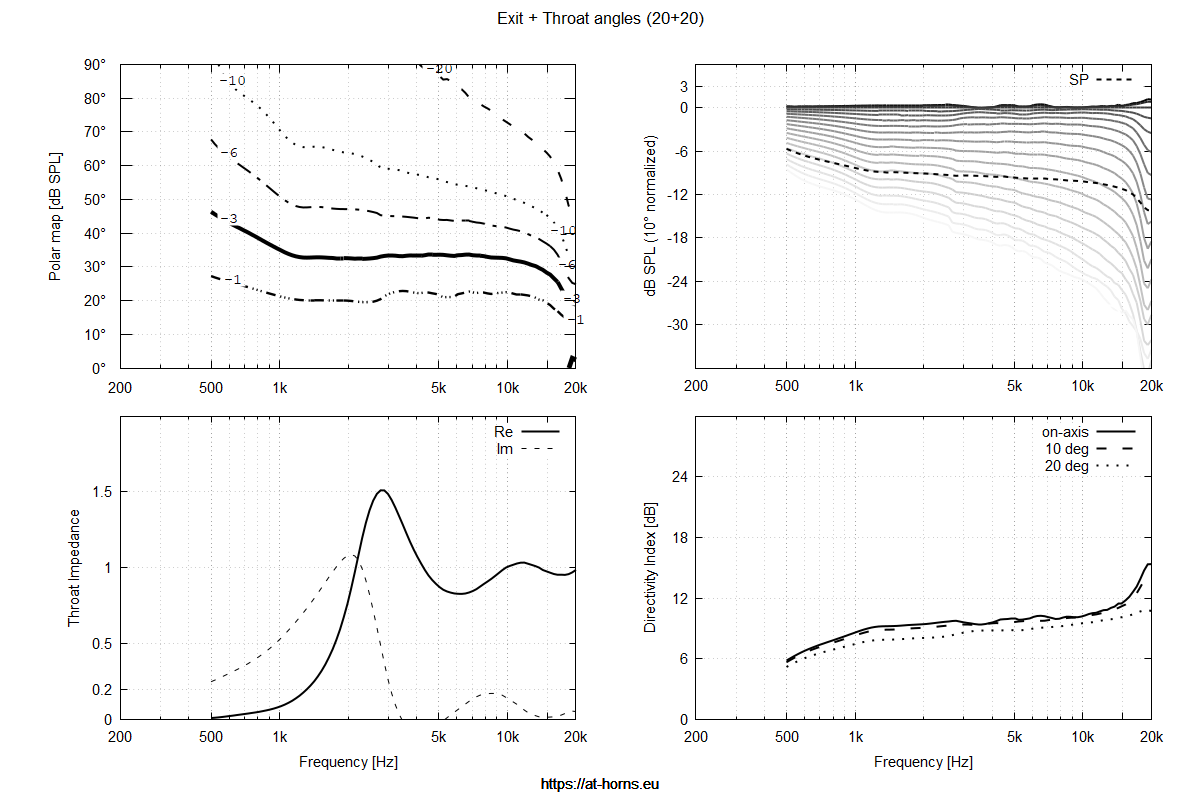

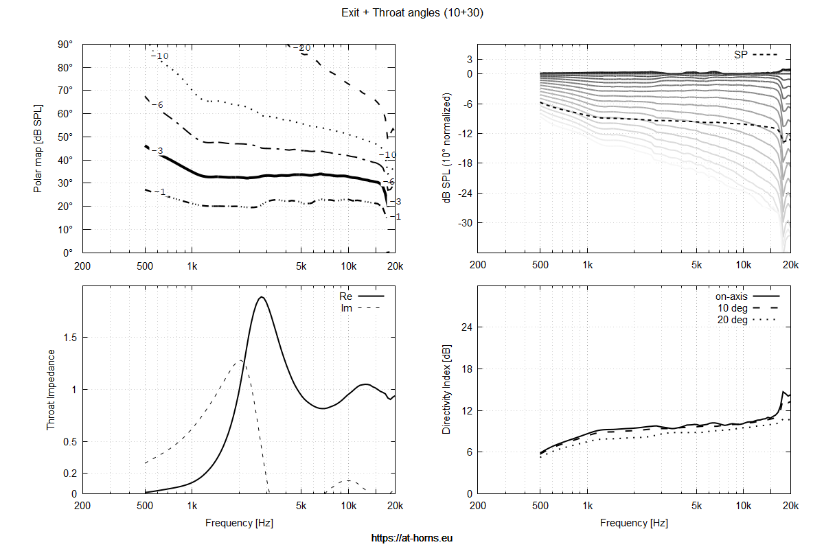

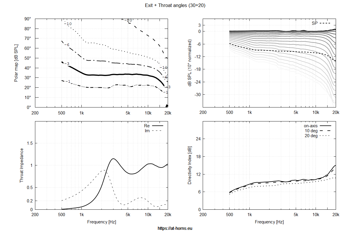

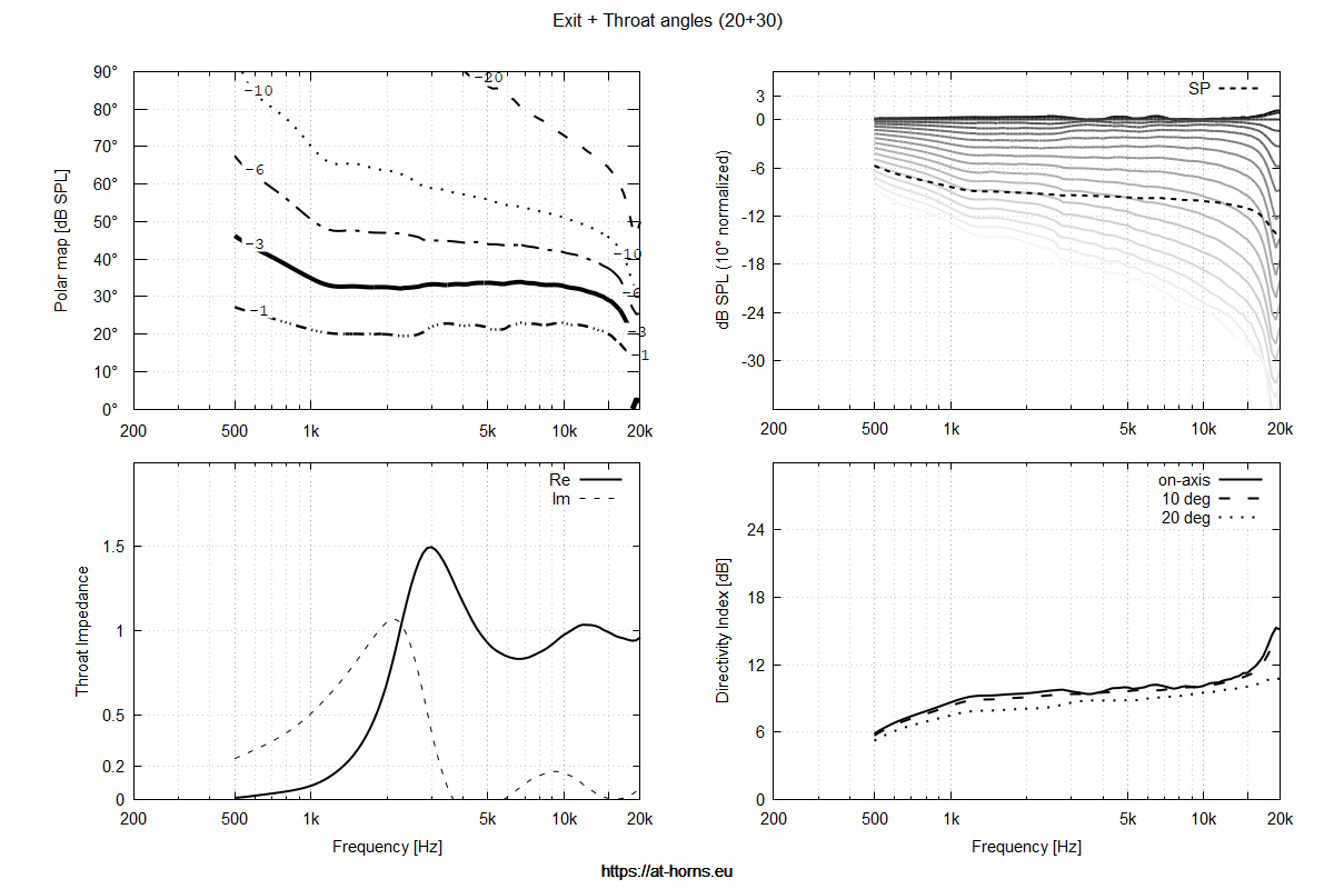

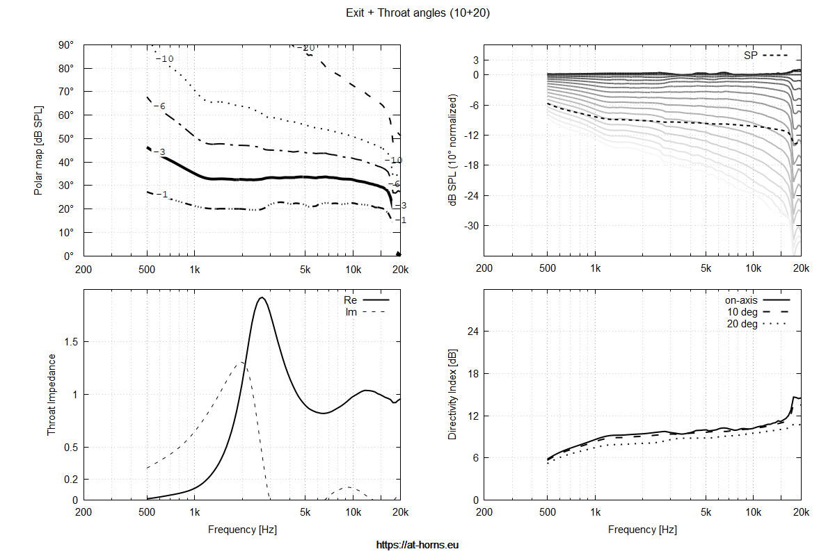

How did you conclude that? It seems counter intuitive to me. I would think that the smaller the angle difference the better. Thus, the best angle would be the mean of the angles of usable drivers.
Somehow I got this impression from the experiments. I now prepared again some examples where I concentrated on this. Honestly, these seem to be so little differences that it probably doesn't matter at all.
Set A: waveguide with 20° throat angle
Set B: waveguide with 30° throat angle
In each set there were three exit angles considered: 10°, 20°, 30°
(Conical exit section 15 mm deep in each case, driven with a flat source.)
Since 30+30° (exit + throat angle) seems better (with less reflection) than 20+20° to me, maybe this is where my impression came from, I don't know.

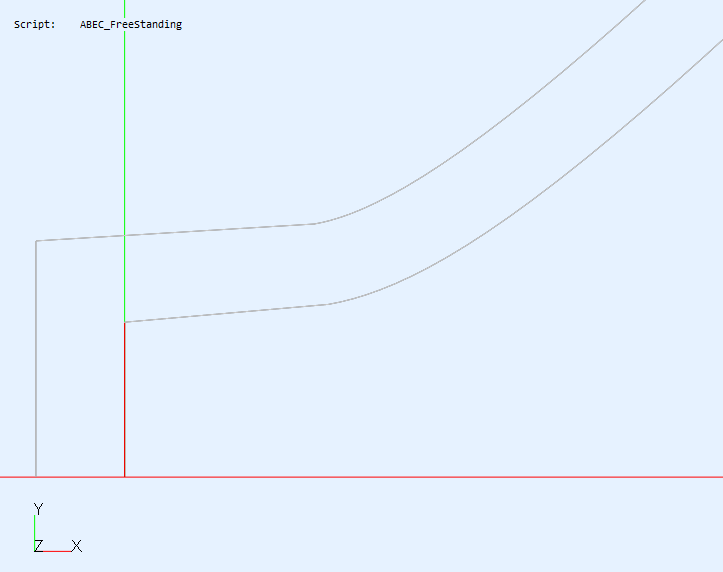

Marcel, can you show what a 10° exit on a 10° mouth does in your simulation? Just out of interest.
