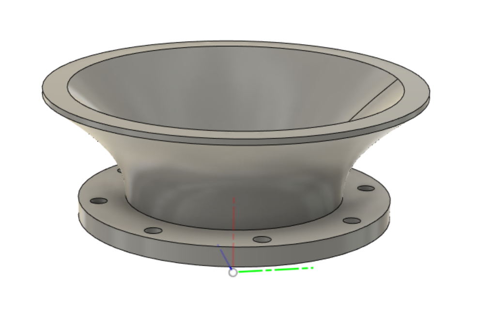

The flange accommodates a driver up to ⌀100 mm in diameter, with mouting holes on ⌀76 mm.

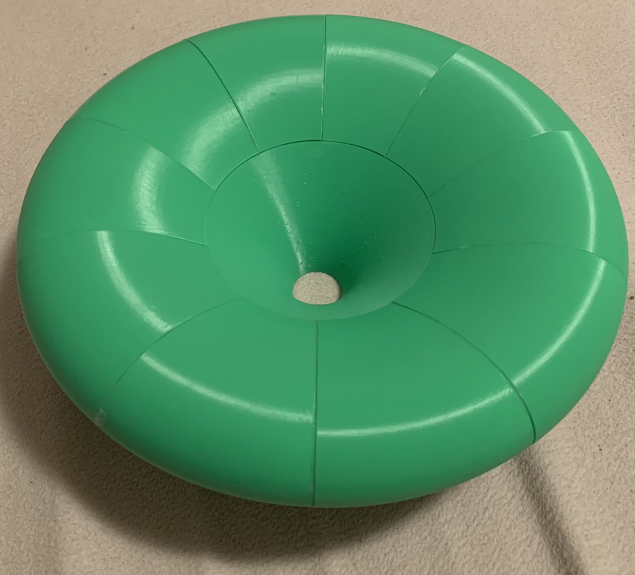

Actually, the picture looks worse than it really is. Even like this it would be usable with a bit of filler and dremel sanding. So I believe that with a simple alignment jig as mabat showed above it would be really easy to build a large horn like this.
Thanks for trying
It definitely looks usable.
I came to a conclusion that the steps on the petals are actually not the best idea. A simple flat top face will probably work just fine, with a simple jig template. Once the first petal is placed and fixed, the rest is simple.
The thing is it's not warped, like at all. It would be much harder to make it from larger pieces (as virtually all ST260 prints so far were warped to a degree, it seems almost inevitable when doing it from halves).

So it seems that by assembling it from a series of smaller pieces you get BETTER accuracy?
That's an interesting thought. I've noticed with my largest printer that the sheer size of the print tends to exacerbate curling.
IE, if you have a print that's 20cm wide and it curls up a bit, that might be a centimeter on one edge. But if the print is 40cm wide, the curling can be as much as 3-4cm.
Sure, that's the point. My understanding is that the warping&curling is mainly due to different cooling rates of different portions of the printed object. The smaller it is, the less it is an issue. The accuracy of the petals may be on the order of a few 1/10s of mm. It will probably get a bit worse with bigger petals. The base seems quite resistant to warping because of its symmetric and sturdy shape, that should stay pretty accurate overall.
