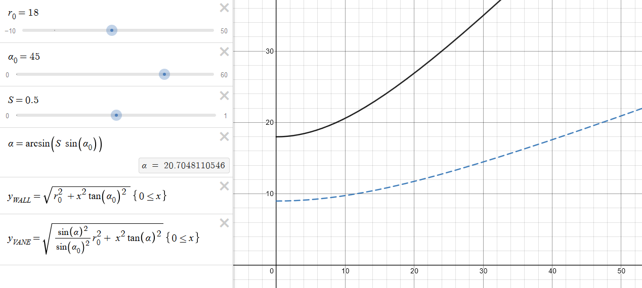

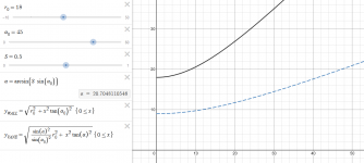

Maybe I misuderstand what you mean but a "parallel wall" works only for the tube. There won't be many coordinates sytems where this is actually applicable (I'm sure Dr. Geddes could name them right away) - OS being presumably one of those. The vanes must follow these coordinates exactly to be "invisible".
How did you generate the profile and the vanes? It would be interesting to see the mesh. (Beware that it probably must be a real OS, i.e. with k = 1.)
Haven't you tried the vanes longer?

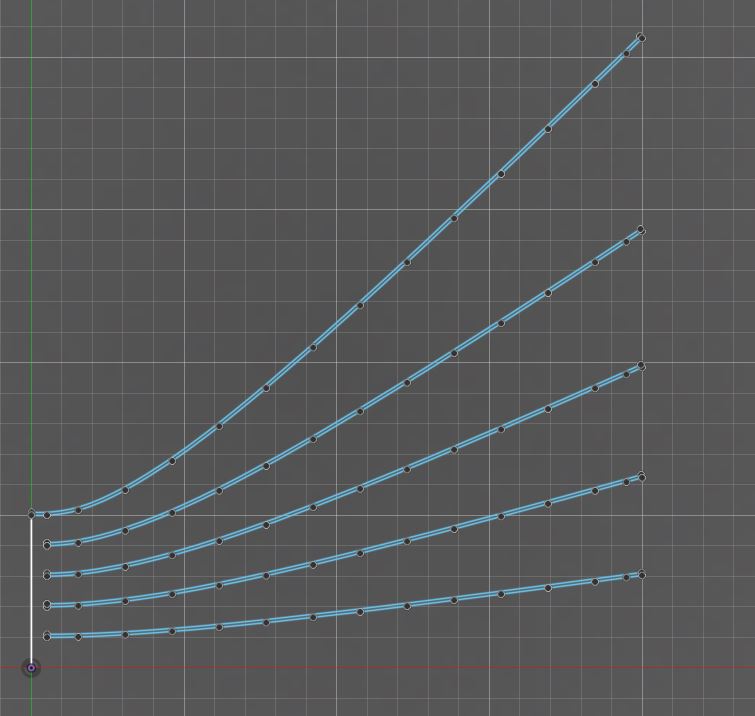

I took the original contour in Fusion, split it in slices and took the half points and connected them. So probably not the best way to do it.
What would you think the best way to do it is?
Maybe scaling in 1 axis?
I tried some different configurations with number of vanes and length, but there was always a bump.
And no difference in the HF directivity.
I'm using curcular symetry.

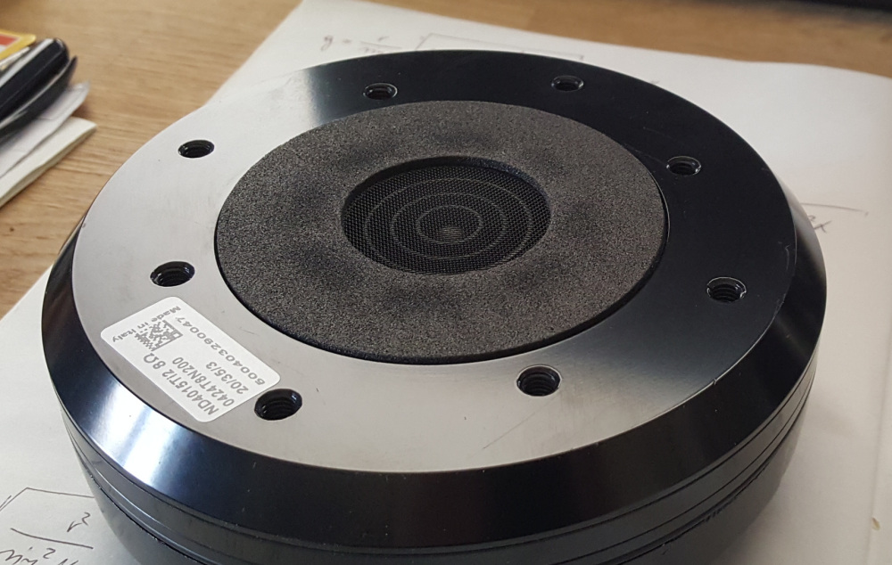

... As soon as you mentioned this, I wondered if there's a CD with suitable phase-plug termination to use the ends of the phase plug rings as the start of your vanes - allowing any cavities to be minimized. Otherwise, unless I'm mistaken, this - nice idea - is going to be rather hit and miss with different CDs.
I have this 1.5" 18Sound, which would lend itself quite nicely.
But I'll probably wait for someone who proves it does work at all 🙂
