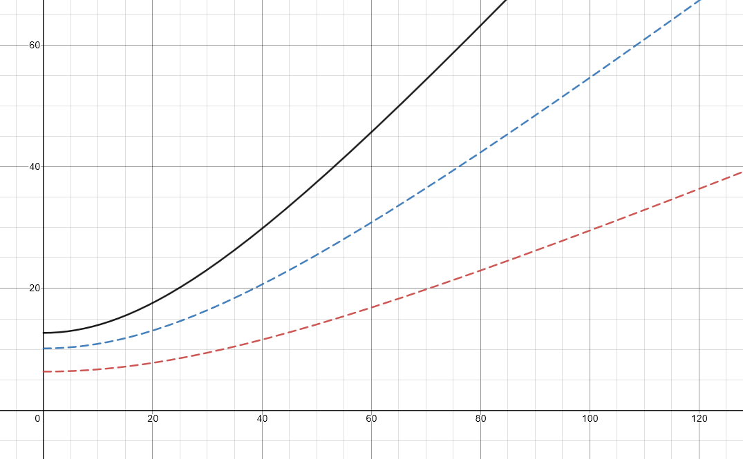

Do you have an idea how to simulate that? "cheap" additive manufacturing of today would enable objects like that be built easily but shouldn't there be some notions of system like that from the old days if it worked even though it would have been tedious to manufacture back in the golden age of audio? Is this what was showed few pages ago, some new phase plug or something that had many horns inside horns in the picture? Something new nevertheless. Would be nice if it worked. I predict it will beam the high frequencies (the axial modes from the driver).
Looking at the pictures, what about a "coaxial multicell" horn? I suppose it wouldn't work for some reason, right?
I think that it would work. It just seems to me to be problematic with construction. The HOM cut-ins would be much higher, but if this isn't important then it likely wouldn't be much of an improvement.
A single internal vane might work well for 2" waveguides. I could see stamping the inner cone in some metal and suspending it inside with foam. A very tough cut of the foam however.
Give me a few days, I'll make it an Ath feature. I'm woking on just that, it's not difficult.Do you have an idea how to simulate that?
Yeah, that's the reason for my doubts. I don't know.... but shouldn't there be some notions of system like that from the old days if it worked even though it would have been tedious to manufacture back in the golden age of audio?
After all it's not a problem to simulate driver axial modes as well.I predict it will beam the high frequencies (the axial modes from the driver).
Isn't it that the path lengths will be different on average inside each section? In that case I would assume a pretty wild acoustic summing at the end.I think that it would work.
Edit: Hmm, but maybe it doesn't make a difference. It's difficult for me to imagine what's happening there.

The path length difference is what creates a spherical wavefront. In an OS waveguide, the 0th mode travels along the radial coordinate and normal to ALL angular coordinates. This means that insertion of vanes that are angular coordinates themselves will always be normal to the wavefront and if the vanes are thin enough, then they will do nothing to the 0th mode. They will raise the cut-in for any HOM however, quite possibly pushing them out-of-band.
The thickness is an issue as the vanes need to be thin.
isn't the behaviour you just described made possible only when there are no vanes?
No. A plane wave traveling down a tube is undisturbed by a vane along the tube. As long as the vanes are normal to the wave motion, they are essentially not there.

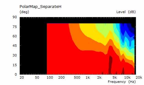

How did you generate the profile and the vanes? It would be interesting to see the mesh. (Beware that it probably must be a real OS, i.e. with k = 1.)I tried doing a simulation with a coaxial multicell with 3 "tubes" that followed the OS contour and were 2cm long on a 2" throat and didn't get great results.
I think it's probably my simulation that wasn't good.
Haven't you tried the vanes longer?
