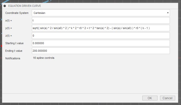

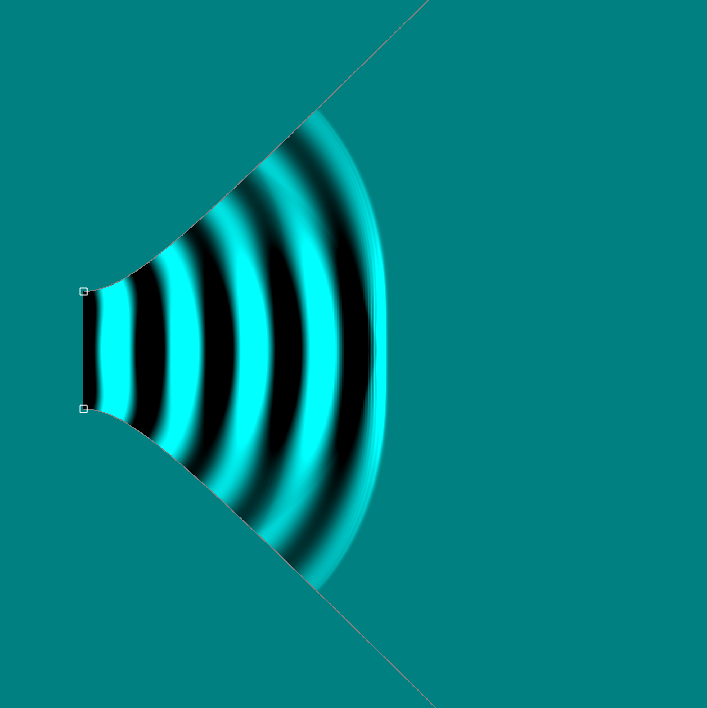

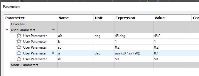

For those of you who want to try simulating, here is a way to generate the contours in Fusion360
There is a addon called Equation Driven Curve. It can be used to draw the OS contours with the help of a few predefined user parameters.
The equation in Fusion style: sqrt(( sin(a) ^ 2 / sin(a0) ^ 2 ) * k ^ 2 * r0 ^ 2 + t ^ 2 * tan(a) ^ 2) - ( sin(a) / sin(a0) ) * r0 * ( k - 1 )
I multiply the S parameter to get the offset curves (in my case by 0.2, 0.4, 0.6 and 0.8)

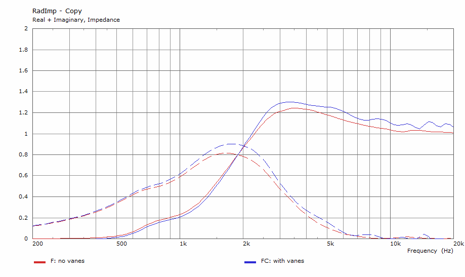

Why do you think the vanes will need thickening at all? My understanding is that the thinner the better and that there's nothing better that one could do about it (?).It will take judgement to decide how much to thicken the vanes as they extend outward, and at what rate.
Regarding the extension towards the mouth, I think it will only work as long as the wall contour really follows the OS profile, which is also why I wouldn't extend the vanes more than about 1/4 - 1/3 of the profile. Then it's not an OS anymore.
Anyway, BEM simulations should answer us all these question soon.

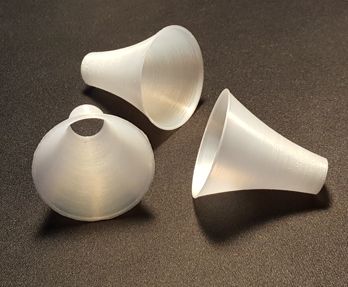

I already printed some on a FDM 3D printer just for a test and don't worry much about stability (this was PLA, 0.4 mm thickness, it's actually printed just as one spiral). But it needs an additional coating as it's not 100% airtight (I suppose it should be).
If epoxy coated I think it will be quite stable.

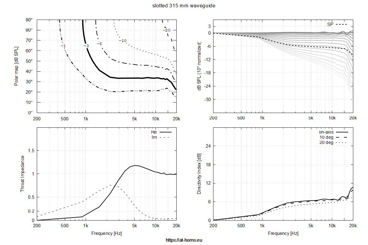

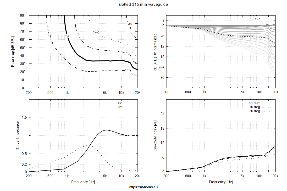

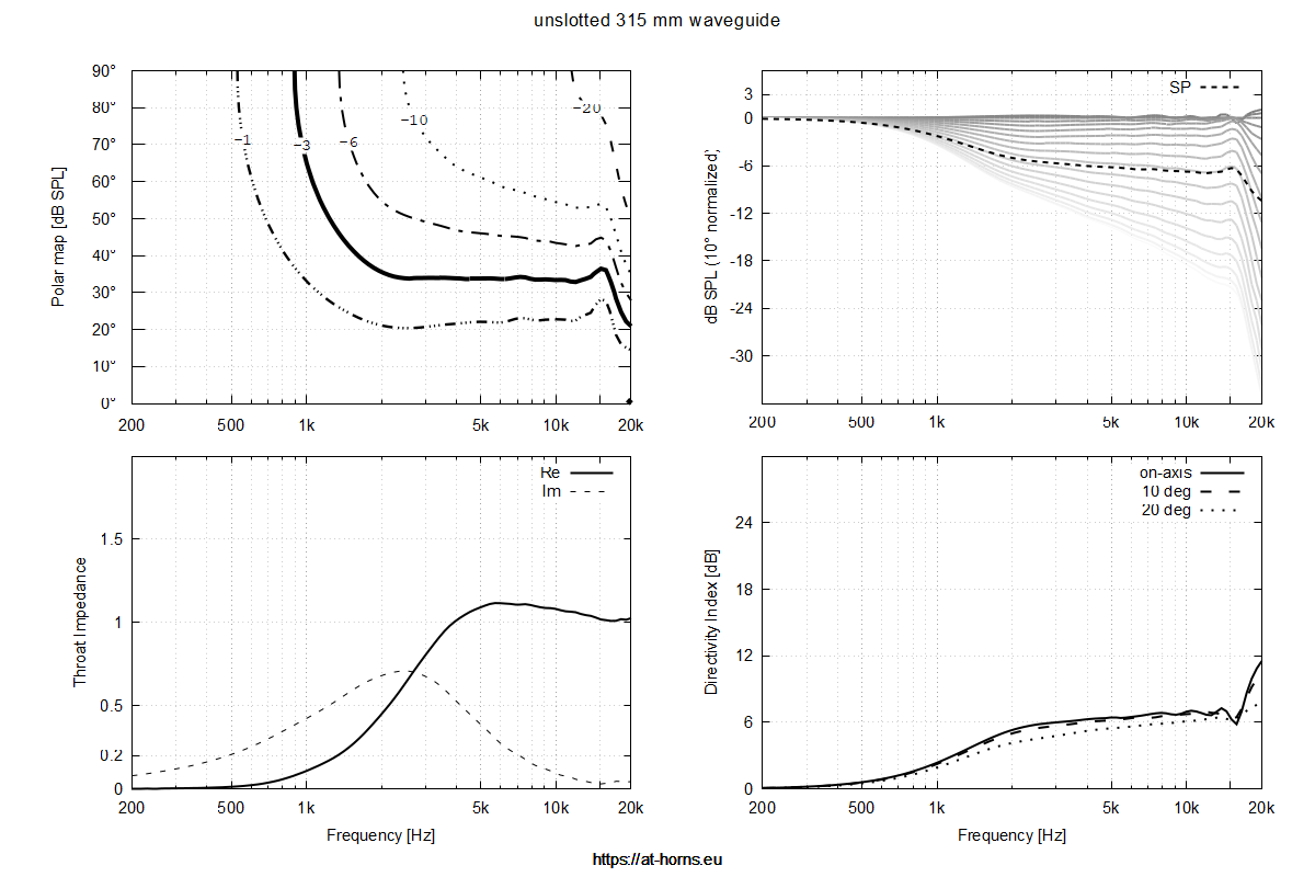

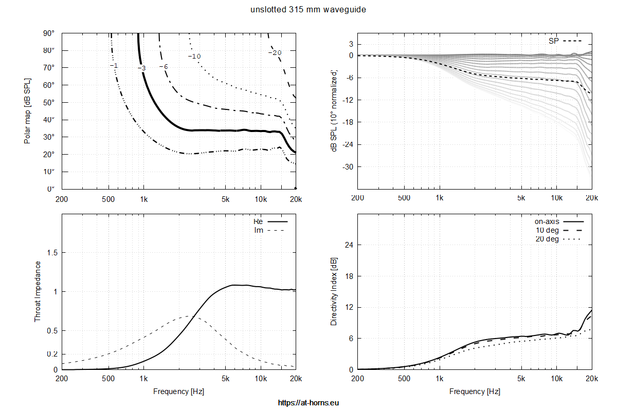

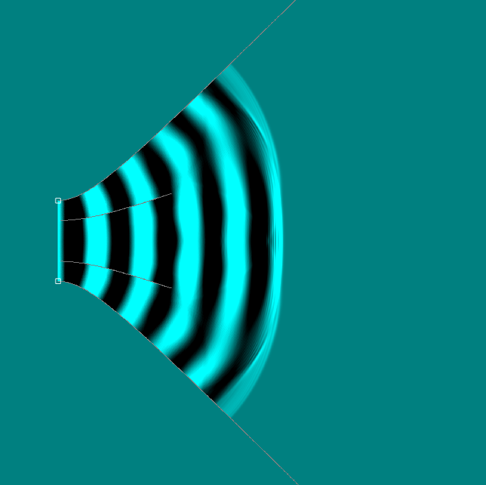

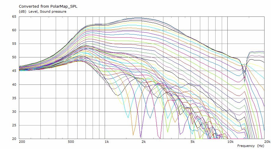

Now, I want to share my impressions with the idea to add a slotted throat. In the end, I could not really break through the brick wall that is at 15k. When Source.Shape = 2 is set, it does look very much better, but as noone knows whether this mode or Source.Shape = 1 represents actual HF behaviour, it does not seem to give a lot. Attached 4 graphs, first two in mode 2, HF peak with the unslotted, slotted shines, second two in mode 1, HF with unslotted look better than slotted in mode 2. I went to the extremes of Slot.Length = n*cos(2*p)^n, tried more than four slots (times*p) and made them wider, still a 15k brickwall, more or less. I could not figure how to make them very long but not widen, so that they would reach deep into the termination, but that is all I have missed. Until there is some other idea, I think I will go for an axisymmetric device.
The only thing that I could see is that the -1 and -6 dB lines seem to behave differently if you compare the first and last (best looking) graphs.

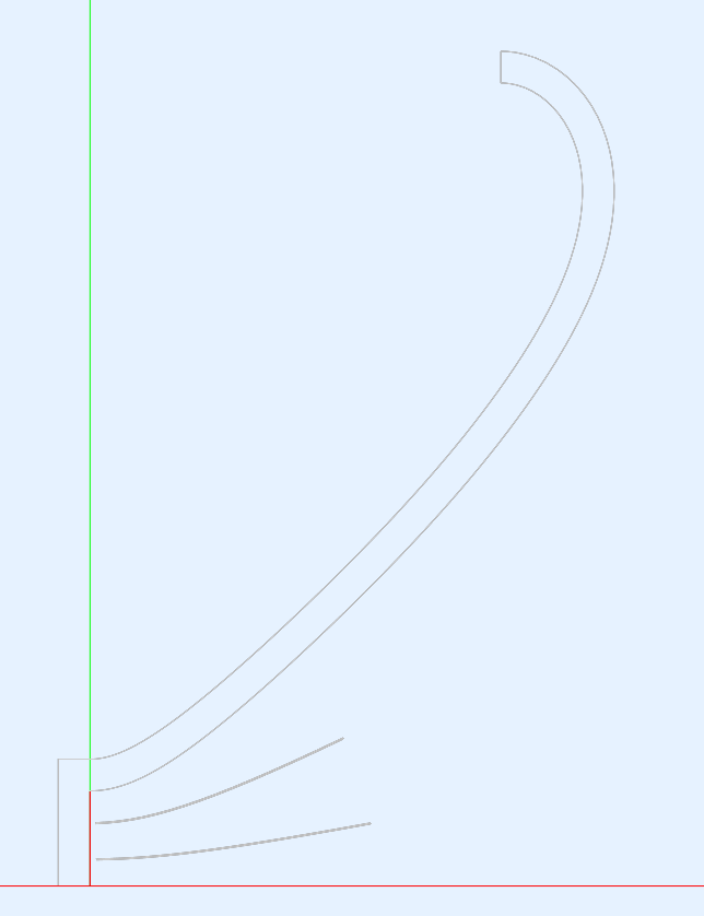

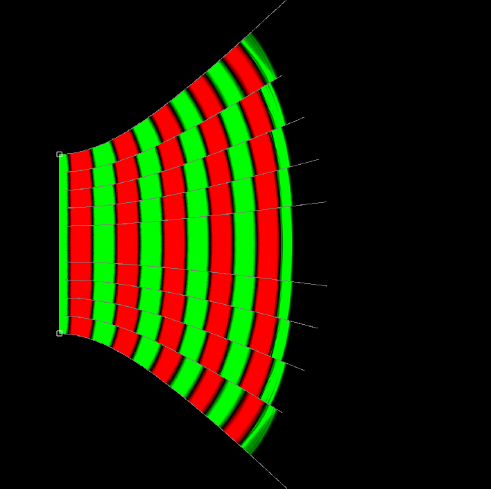

I have implemented all the above discussed functionality into Ath, including export of the contours into ripple tank. After the very first attempts, this is what I was initially worried about - dividing the waveguide into several "discrete" channels simply won't sum smoothly at the exit of the vanes. So far I was not able to obtain a significantly better result than without the vanes.

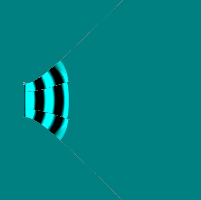

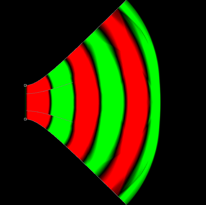

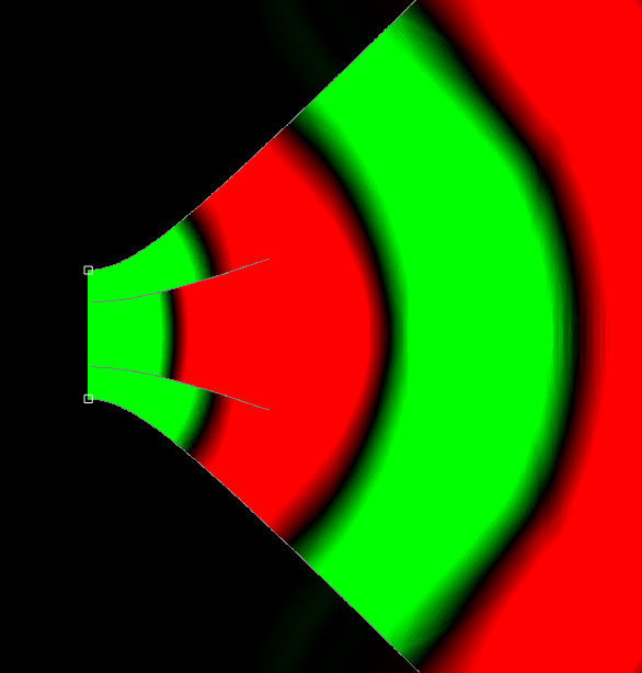

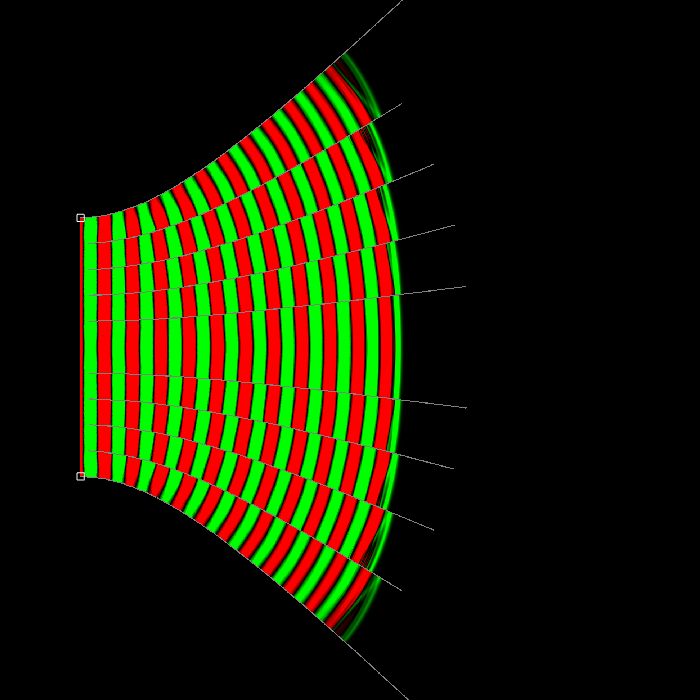

Anyway, it's fascinating to watch - here's a sample Ripple Tank code (Ripple Tank Simulation)
