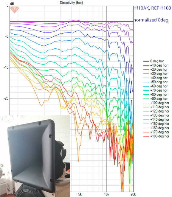

Diffraction looks like that, dip on-axis and off-axis ridge. Anyway, no mouth roundover seems to do this. Here is RCF H100 showing similar response. Asked a friend to print the petal version of 260, not here yet 🙂
Idk, if the waveguide shows considerable waistbanding between 1.3k and 2.7k, maybe. But what I see is ups and downs in the HF, the cause being lower, presumably already at 1.3k (26 cm wavelength). The diffraction causes more energy on-axis over 1.3k and this is why normalized looks as if the wg is waistbanding. From 5k on you can clearly see the pattern rip through the frequency band. Let’s see what it will do baffled. Yes, free standing does not have this problem, sure.
There will be all kinds of problems if the device is not properly terminated, which of course it isn't in this case (besides the fact it has a hole in it). Placing it in a box should improve the things a long way and I'm only curious how much, compared to the free standing version, as an actual comparison hasn't been done so far. It will be interesting to see.

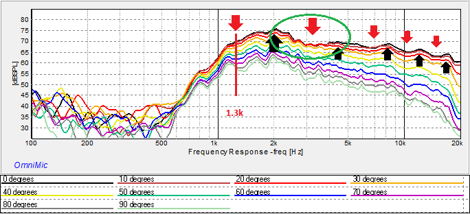

... and how to read this from the graphs please?
I see this:
26 cm diameter equals 1.3 kHz, this is where diffraction occurs naturally (edge of the waveguide). First dip is not too obvious because of the energy overhang of the waveguide there. But then follows the usual bump, stronger on-axis, when 0-axis is normalized it looks like waistbanding, and the pattern continues.
Marcel simulated the free standing ST260 baffled-device performance: Diffraction
You will see the behaviour. Also compare to infinite baffle: No diffreaction
Your data kind of aligns to this, doesn't it.
