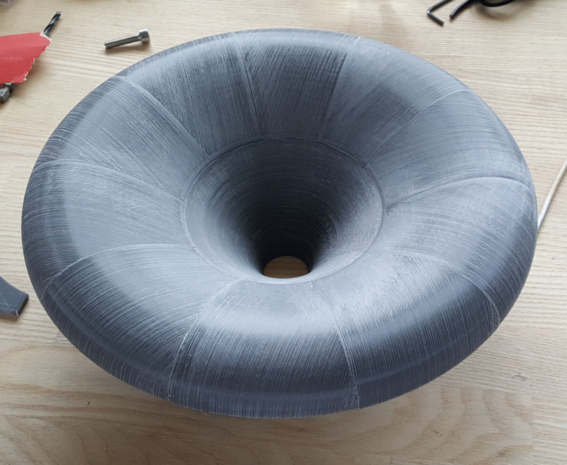

I've probably shown this already - it's how far I got with my own CE360 prints (well, it already has a primer sprayed on now). I need to measure it to confirm it behaves as expected - it still may be that the assembled prints are not accurate enough. I actually don't expect big problems, just need to be honest with you.
I can "share" what I already have but I must warn you - it won't be easy to assemble. I haven't yet fully tested or proven the workability of these files myself. All of this is on your own responsibility, so if it doesn't work for some reason, don't blame me.
I would recommend to assemble the complete petal ring first, then attach it as a whole to to the base. Let me know how it turned out.
