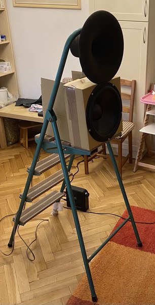

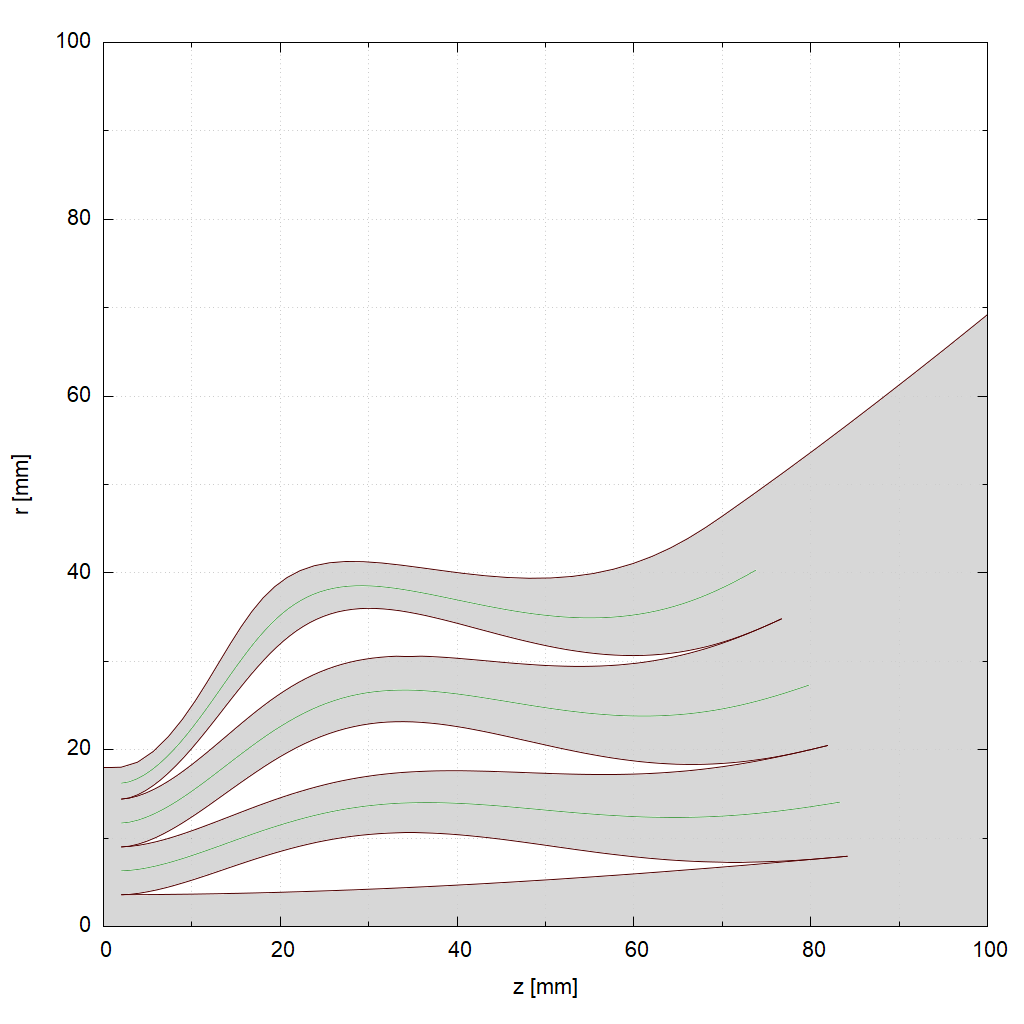

That's the downside of it. The main idea is that even if the input wavefront was perfect (perfectly flat), it should still improve things considerably - at least push the frequency where the radiation pattern collapses, hopefully outside of the audio band. For a 1.4" throat this is around 12 kHz otherwise. For a 2" throat just above 8 kHz - that would make a big difference. If it could increase acoustic load at the same time, perhaps it would make sense even for a 1" throat.
But it's quite possible that the flaws in the phase plug of the driver will spoil the effort completely, I'm aware of that. Maybe this will finally induce me to actually measure the existing wavefront - perhaps it could be corrected for after all, I don't know.

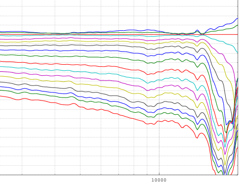

What makes me optimistic is that the modern drivers seem to be pretty good in this regard - see the Sandhorn with Faital HF108 below, for example - the result is pretty close to what the simulation predicts for an ideal wavefront, and if there are deviations, they must be relatively small, i.e. the net possitive effect should be considerably bigger than the differences caused by deviations from the ideal.
(vertical step 2 dB, per 5 deg, courtesy of miero)

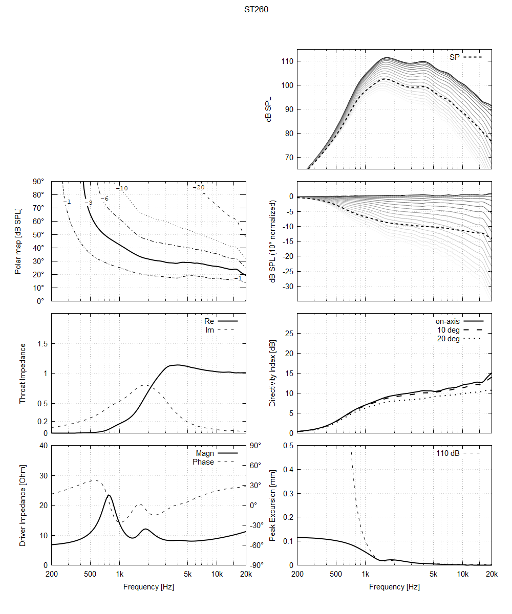

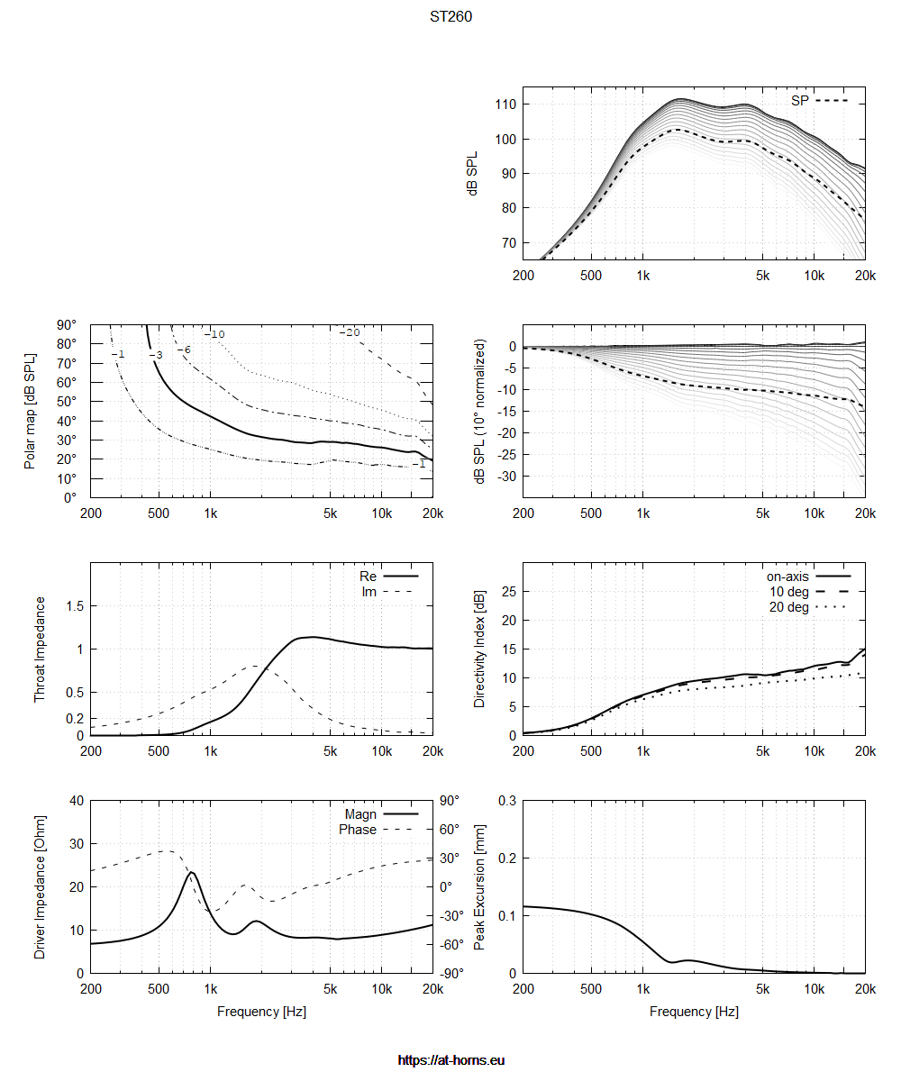

The ST260 with the same (generic) driver -Working on a new report including the driver LE model![]()

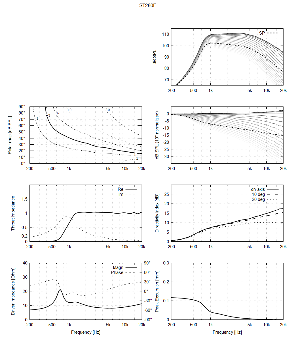

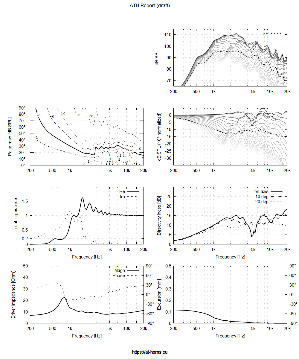

Yes, lower frequency generation requires more air to be moved and for the same Sd it means higher excursion. Your steep increased need for excursion is not only driven by the fixed physical relation between Sd and SPL but also the contributing fact that the acoustical impedance is dropping, coinciding with the excursion increase - hence a loss of loading or aka. "cut off" ;-D The bigger one keeps it's grip a bit lower.
No?
No?

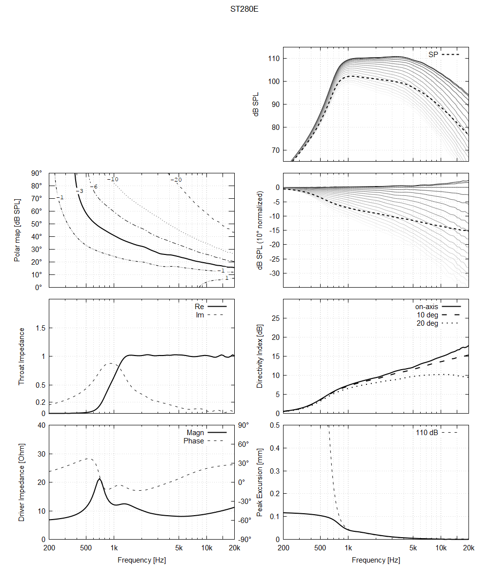

Excursion goes up with the input voltage linearly as far as the suspension and motor (Bl) remain linear.In the following two charts I added the peak excursion required to reach 110 dB SPL at 1m on-axis.
(Excursion goes up with the input voltage linearly, is that right?)
The trend for higher power capability compression drivers has also led to suspension designs that limit excursion to prevent diaphragm contact with the phase plug at higher voltages.
I still have to complete the user guide but in the meantime, anyone already interested in using the driver models can think about how to proceed with creating a model for a certain driver.
Below is (the only) one that will come with the Ath package (I think it's what bmc0 created some time ago).
The LE part of the simulation will always be connected to the BEM part via the node DrvGroup=1001 - that should be the exit of the driver, otherwise there are no limitations in complexity of the LE models.
