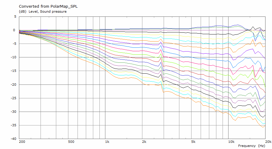

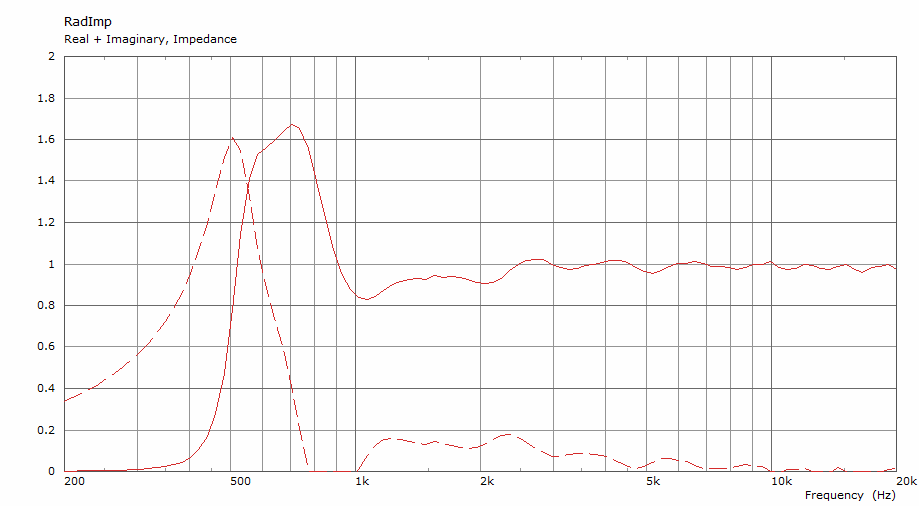

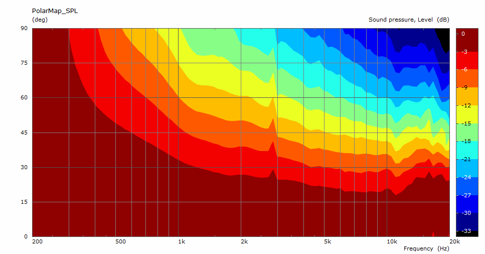

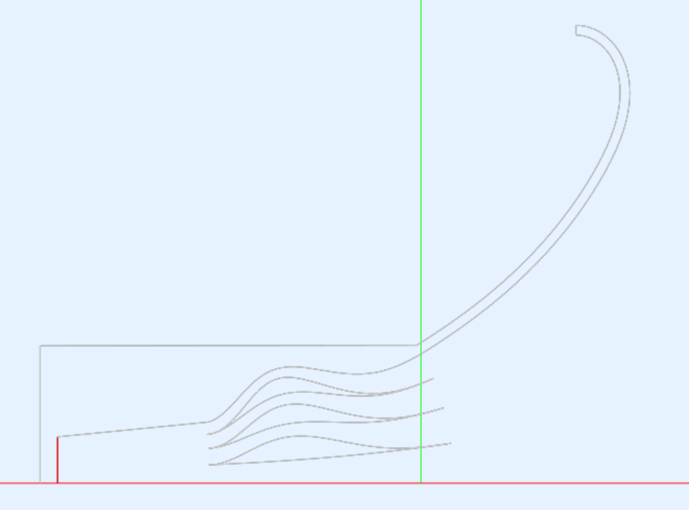

Wow! That looks really impressive!OK, here's the try - the outer channels "pinched" so that the area is only increasing. Seems to change something
(1.4" driver)
What it probably still needs is an adjustment of area expansion to better match the plug and the waveguide entrance.

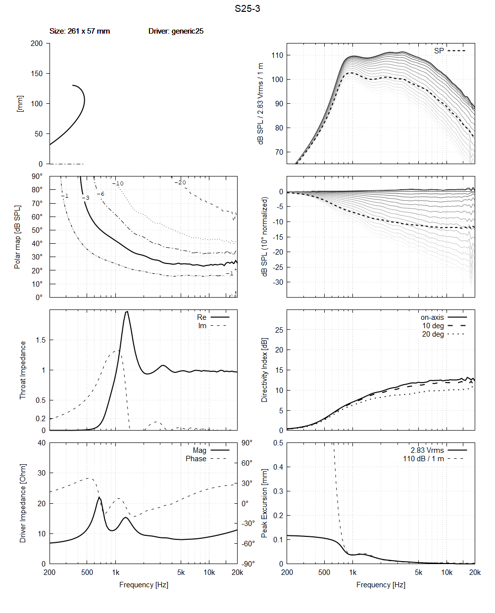

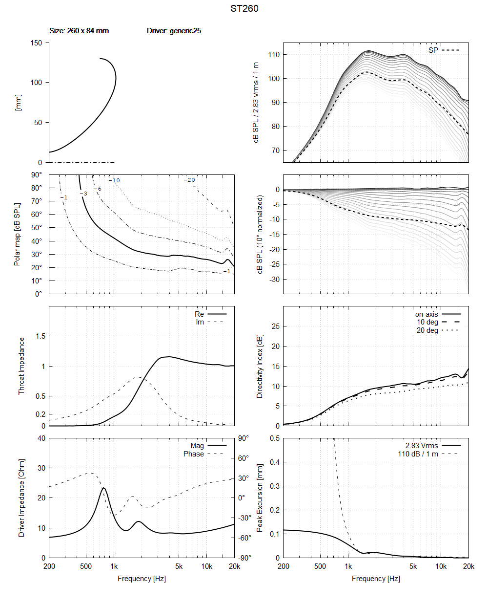

Could we get a comparison to a OS-SE of the same diameter/coverage angle to see how large of an improvement there is to polars and impedance?
Sincerely
Anton
I am not trained in natural sciences. Maybe the fact that the phase plug divides the pressure field into four chambers with four distinct exits is already introducing enough discontinuity at its 'mouth'. Any abrupt change in pressure will be relayed backward and inscribe itself into impedance as wiggles. Like when you simulate a baffled device that has no termination without an infinite baffle, the edge diffraction will rip the impedance. Do the tulip fins introduce discontinuity even though they create a sperical wave front?Any ideas?

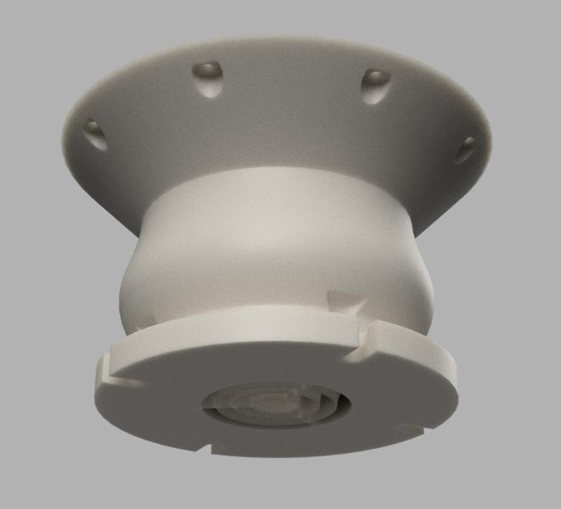

This looks incredibly nice!It might just be attachable![]()

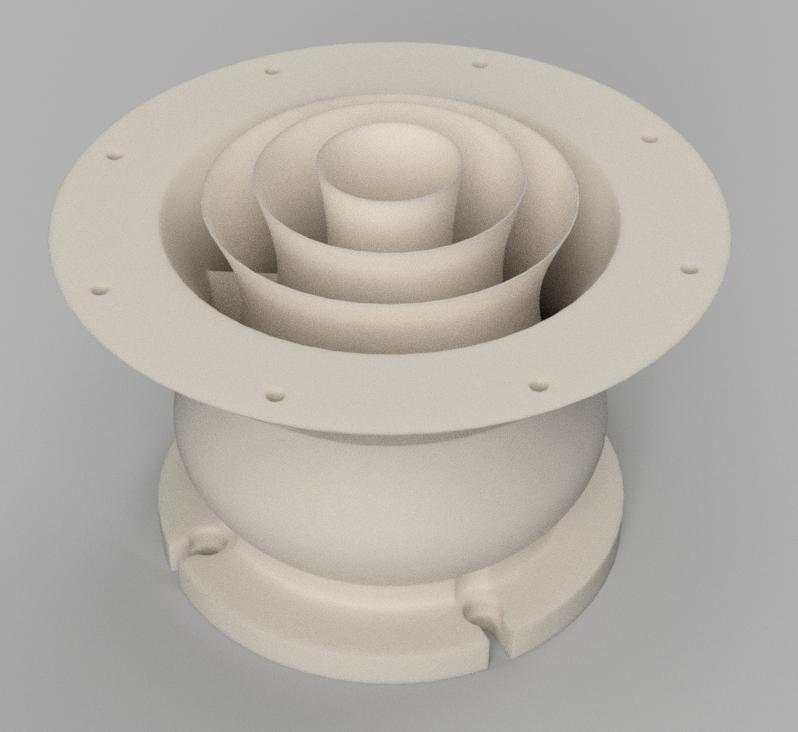

Extended HF. Also for 1", but more so for 1.4" and 2" drivers.What are the benefits of this approach?
Thank you for poiting out some quality tutorials and sharing some tricks.
Mainly the possibility of using large throat drivers without high-frequency beaming.What are the benefits of this approach?
The proof of concept is now in aragorus' hands. If the Axi2050 won't make it, I don't know what else canThis is all very exciting, what driver do you think would be a good candidate for this new phase plug? a 4" Be dome? (to avoid modal behavior of the diaphragm)
But yes, it may come down to finding a suitable driver. We would really have to measure the exit wavefront, I'm afraid (no progress on that on my side). Or just try it and see, like we always do. The simulation says it's definitely possible, IF the wave is uniform across the input aperture.
That would be probably the easiest to quickly see if it behaves at least remotely close to what we hope. It's not a problem to simulate a spherical cap in an infinite plane, or in free space in the middle of a disc.I'm not sure if I should try mounting it on a baffle first..

I still have the this 2" driver so I thought I will try something as well. The driver has quite long exit section, but who knows, maybe in the end it may be better to give the wave some time to "average out". I also thought about inserting a printed tubular ring into the exit section, making the initial profile exponential, instead of conical, i.e. making one smooth area expansion including the plug.
BTW, this would be ø375 x 175 mm including the plug.
