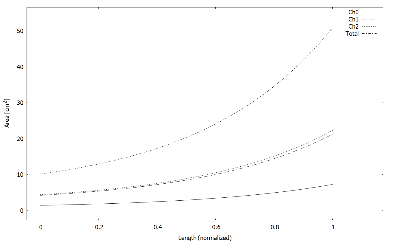

Looking at this picture:
993553d1635496884-acoustic-horn-design-easy-ath4-png
Makes me wonder, what happens if...
- we make sure each channel has the same expansion rate
- build up expansion, the further the channel is from the center (thus making the middle one fall in between the center and outer channel)
- etc...
It will look strange, in 2D, but the important part seems to be the gradually growing expansion.
I'd make the studs that keep the channels fixed drop shaped :). Round part toward the throat.
Joined 2004

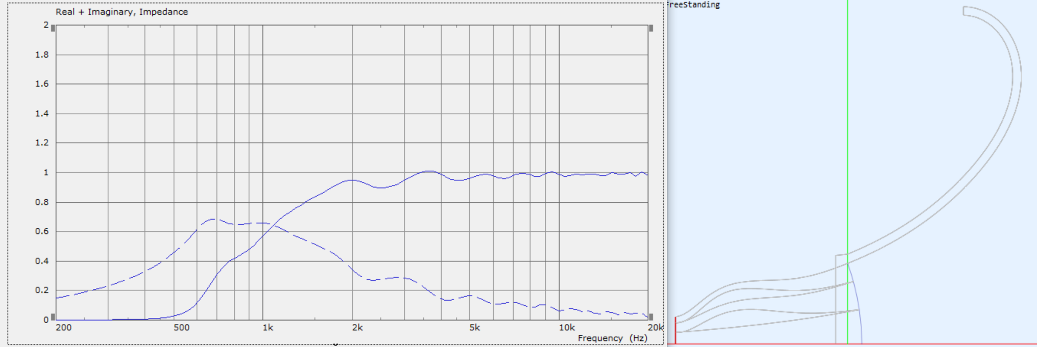

That makes no difference, I tried that already (didn't show). It seems it's only the total area that matters.
The widths/positions of the channels have effect on HF polar respose but not on the impedance, if that's what you mean.

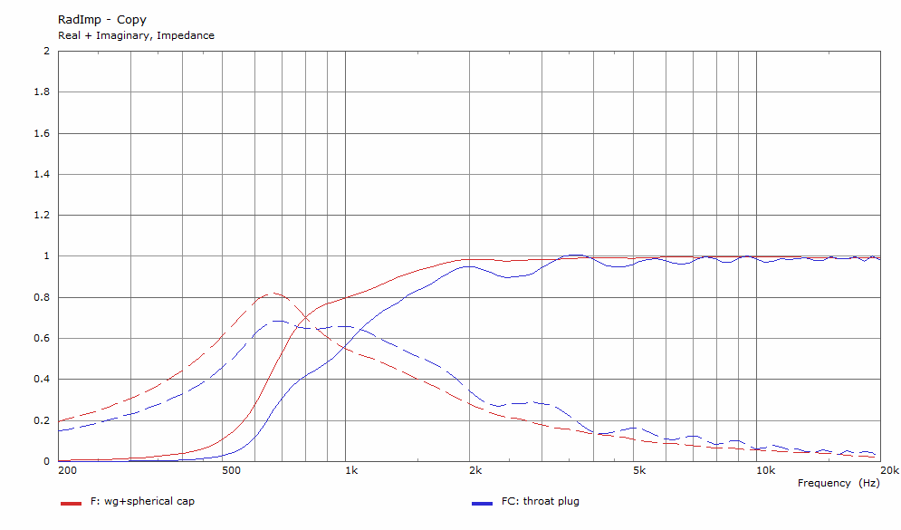

BTW, it's definitely possible to "shape" the impedance by changing the shape of the waveguide - there's the room for optimization.
This is for a 1" driver -
Joined 2004

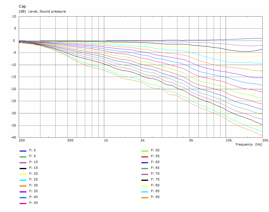

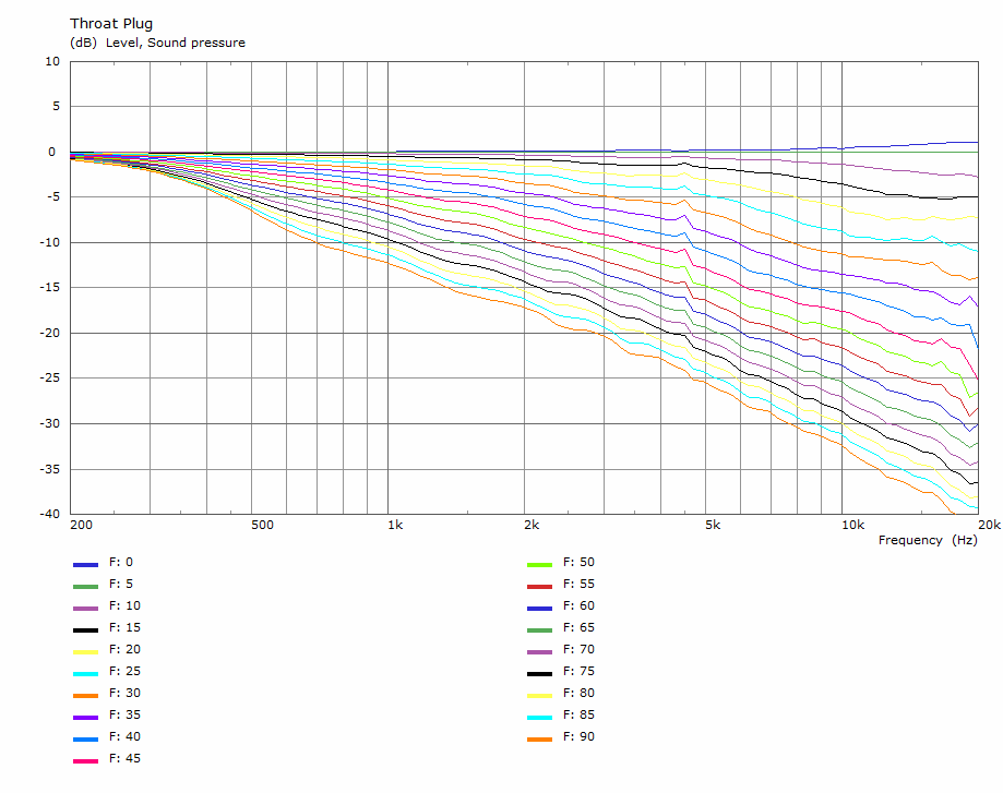

I tried to drive the same WG by an ideal spherical cap corresponding to the exit wavefront of the plug. Here's the result -

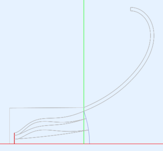

Joined 2004

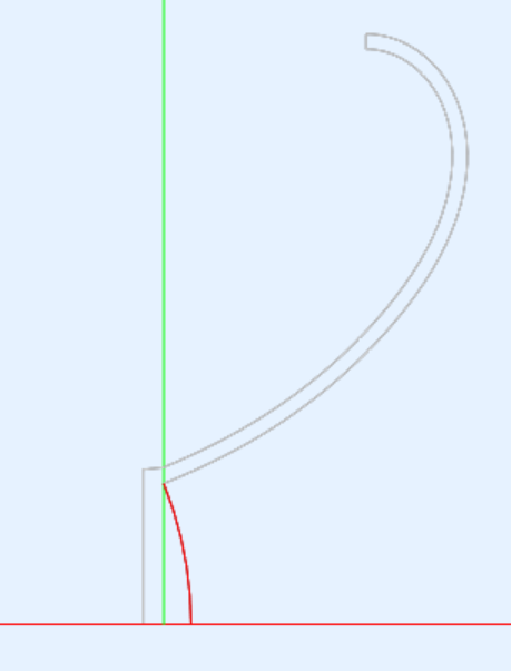

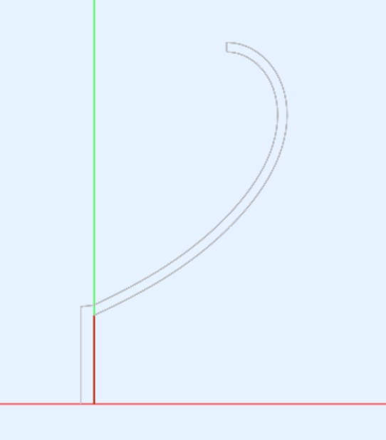

I used just a random shape for now, basically a conical horn rolled back very early on.
The whole point is that you have to drive this profile with a spherical wave, otherwise it would be utterly useless (attached results for a plane wave).
At this point it's still not optimized in any way.
So who is able to make it? :)

What is it with the wrinkles in impedance plot, this is indicating resonances? Simulated SPL naturally shows the same variance. Can this be further reduced? What is the sonic implication?
I just don't know (yet). I think it will take a while now to trace all the little remaining imperfections. It's already pretty complex structure.
Any ideas?
