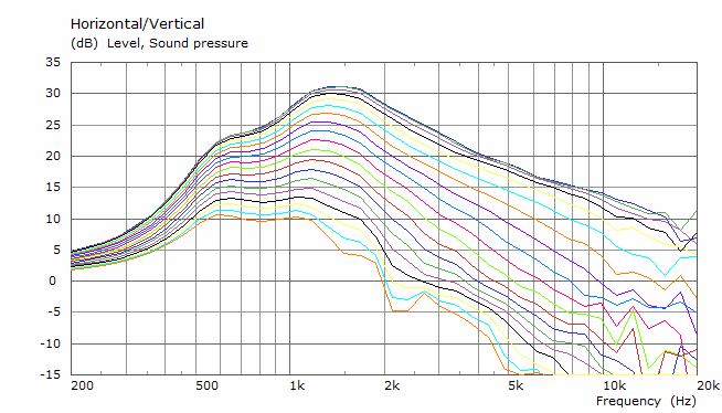

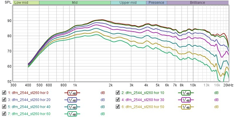

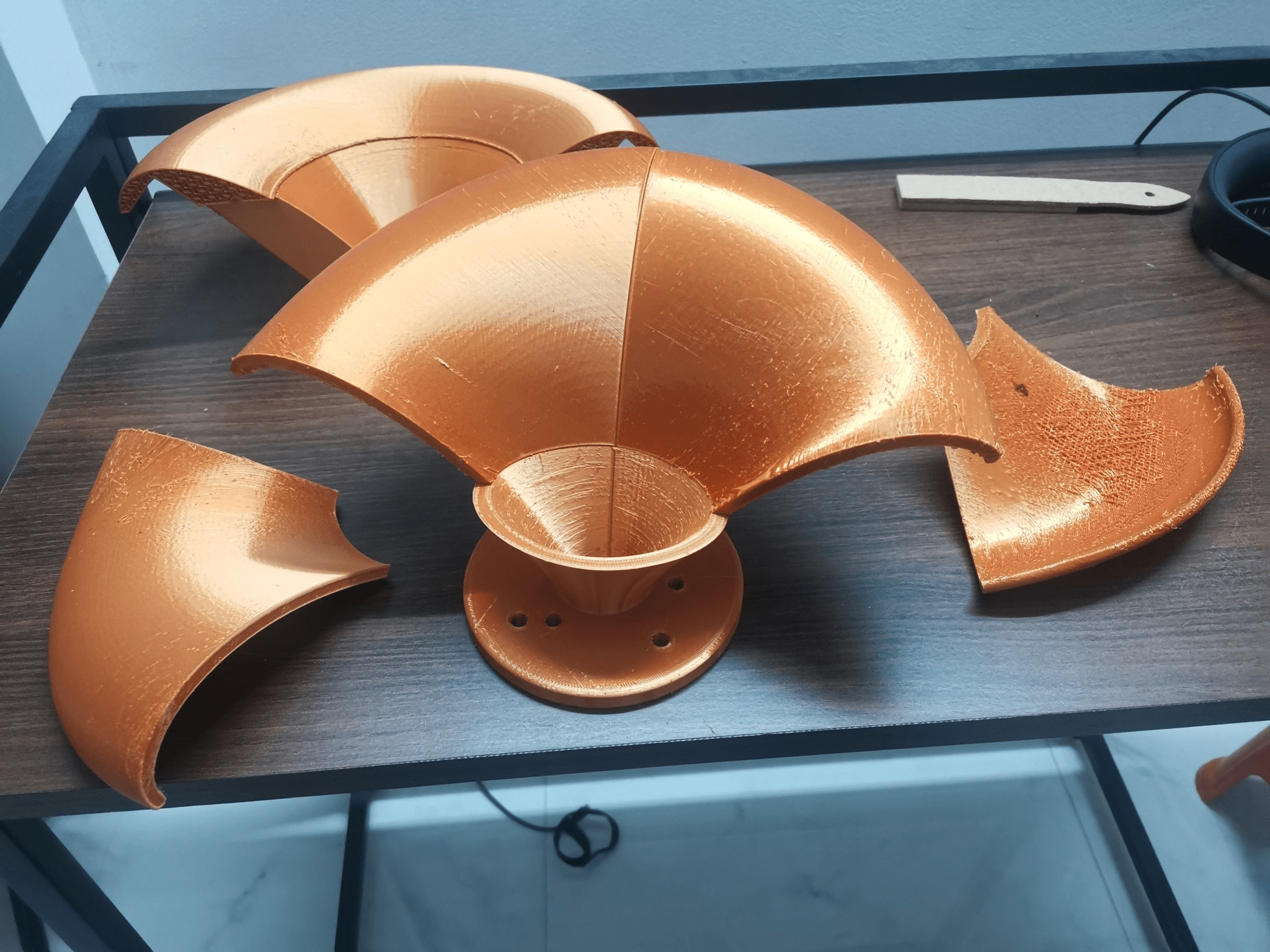

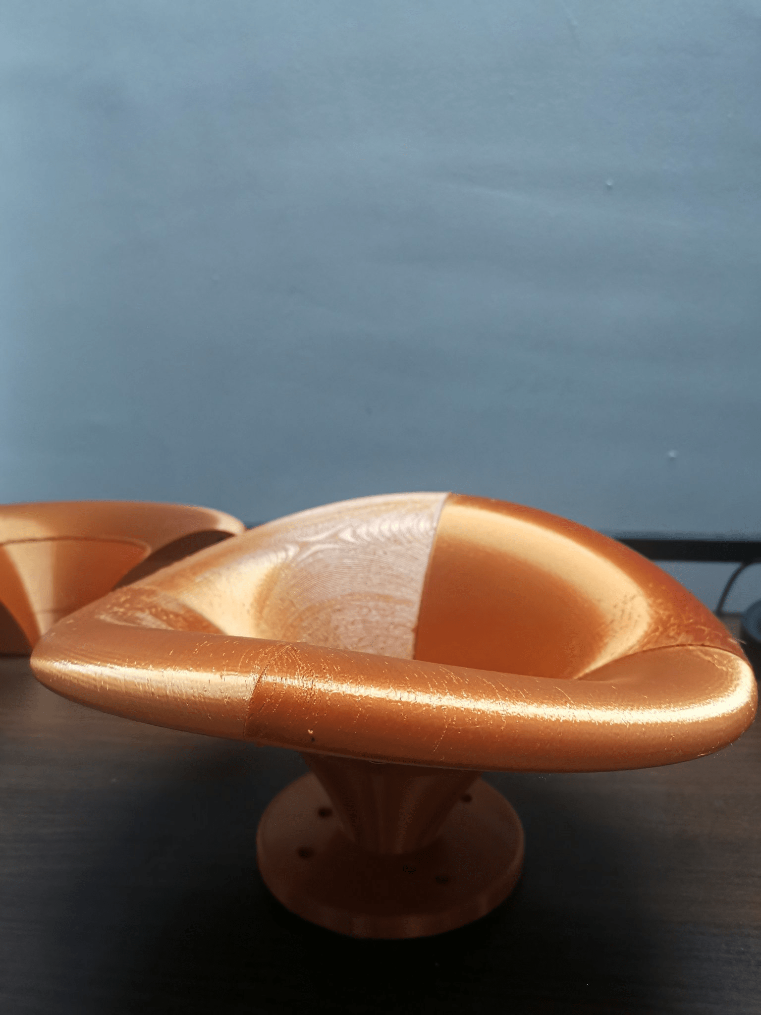

I 3D printed the ST260 KVAR horn and was able to do a few measurements before my measurement setup was damaged. Here are some results I got.

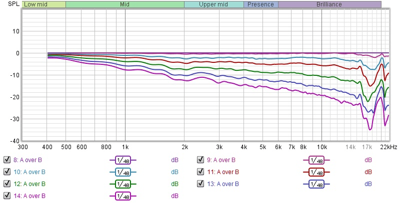

The compression driver I used along with this horn is Peerless DFM 2544R00-8 1 inch throat driver. This is a gated measurement with 4.06ms gate width and mic at 1m away from horn mouth. Measurement mic used in Dayton EMM-6.
I could get measurements only up to 60 degrees off axis in the horizontal plane before the horn and driver fell down and the horn was damaged.
I just used the files mabat had posted in a previous post in this thread (Thanks a lot for that) to print out the horn and assemble it like this:
Measurement setup
Raw measurements
Measurements normalized to ON-axis measurement

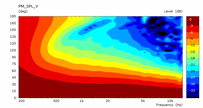

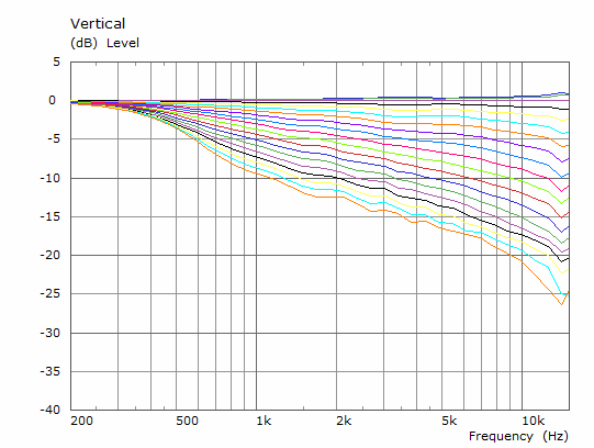

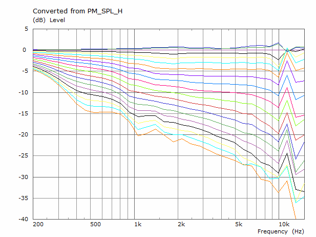

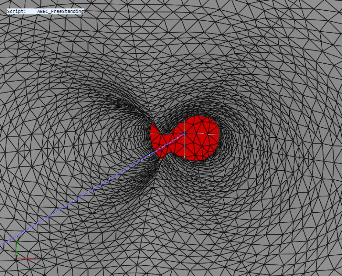

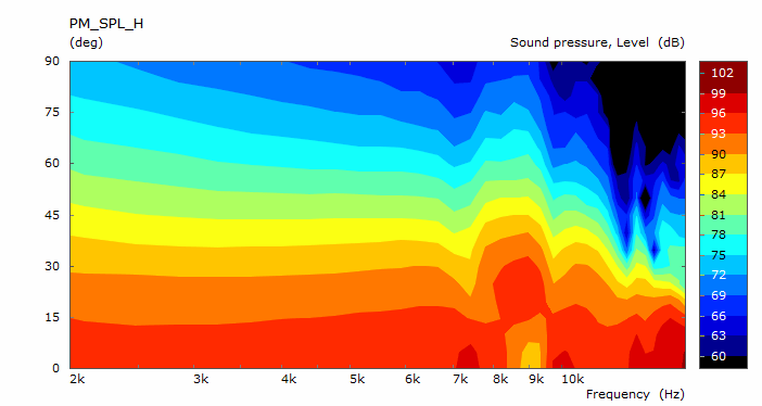

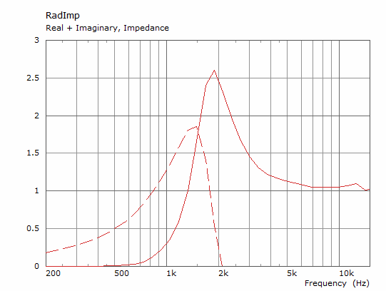

It's always nice to see someone actually doing something real. Good job.

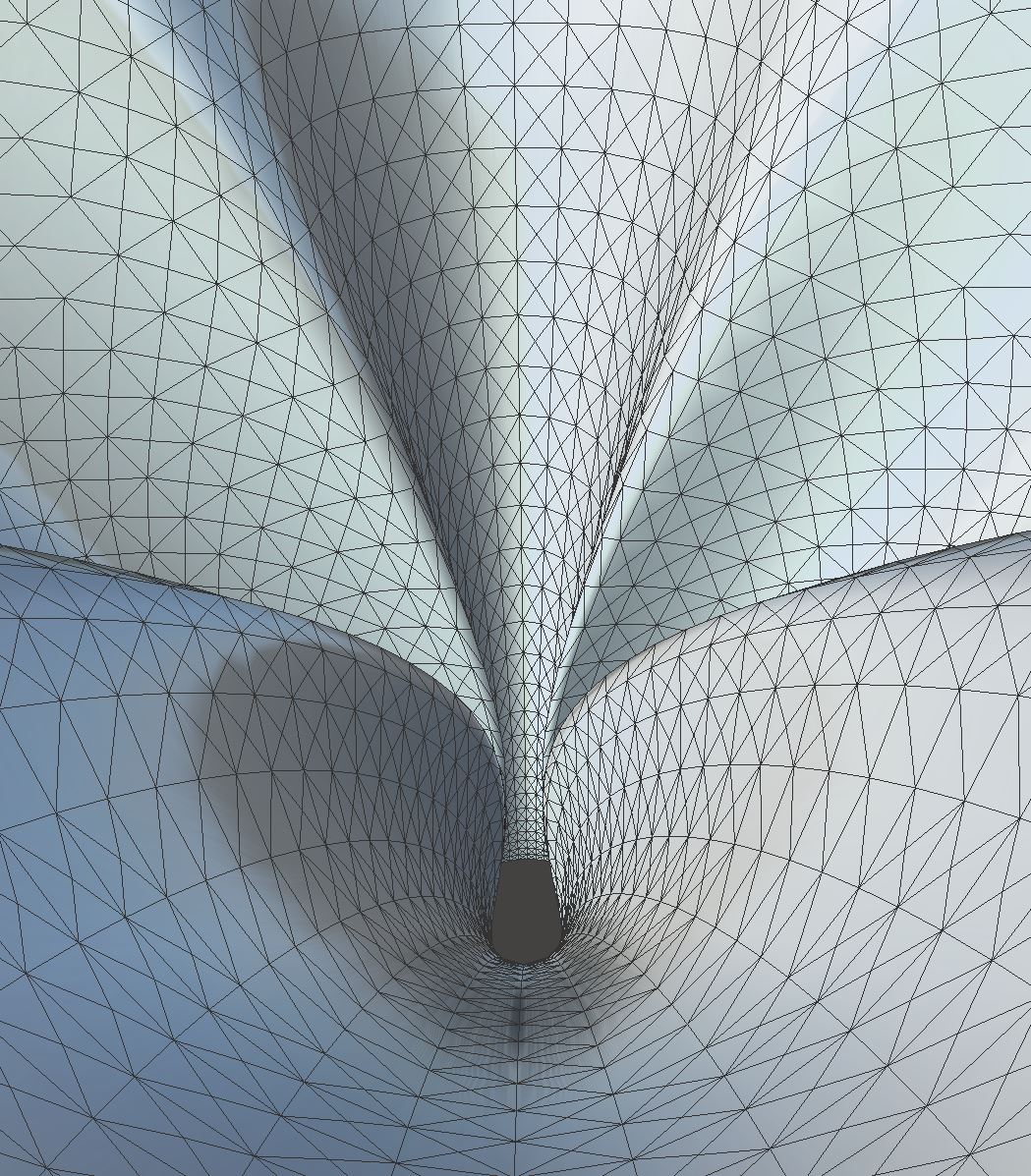

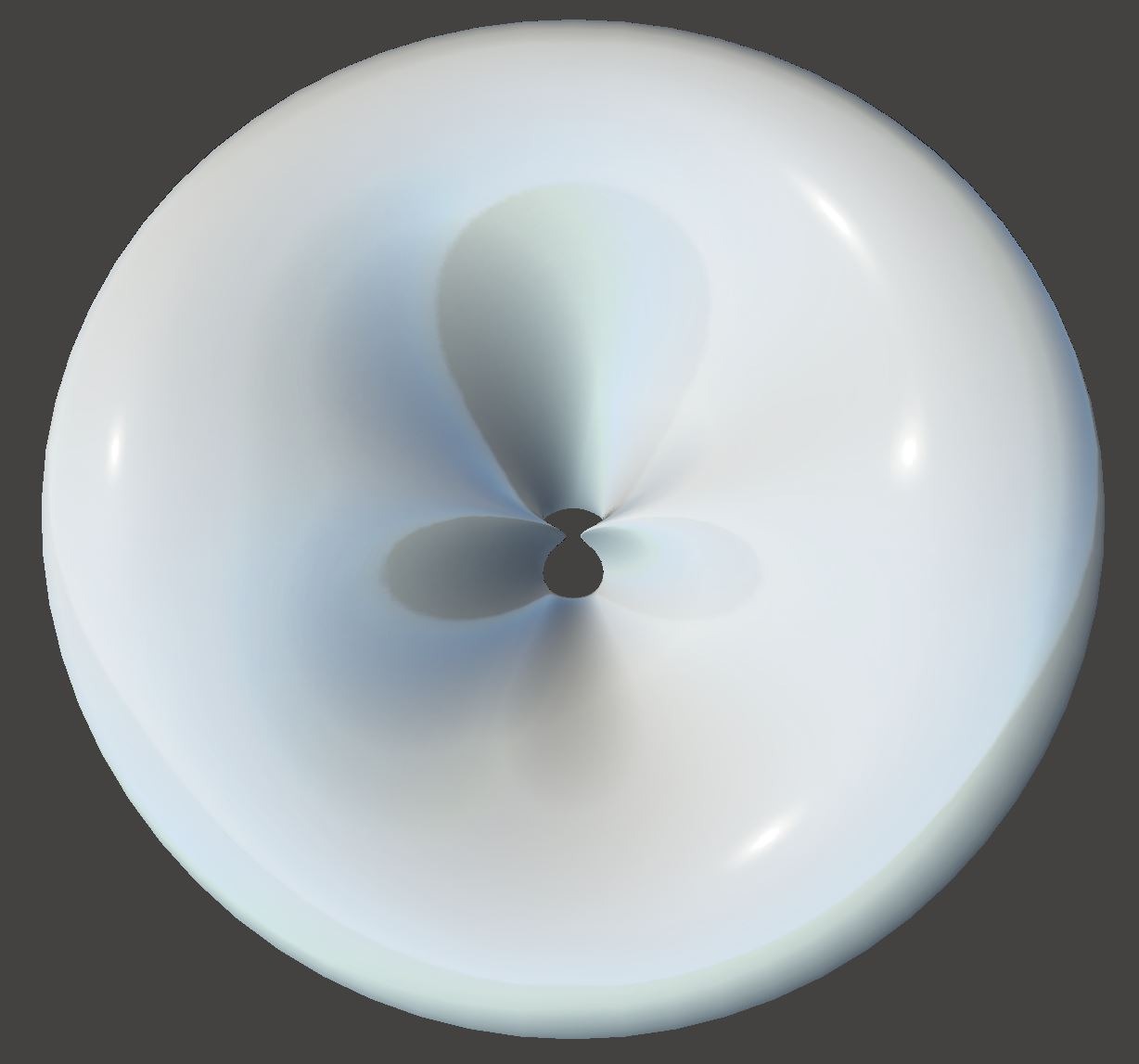

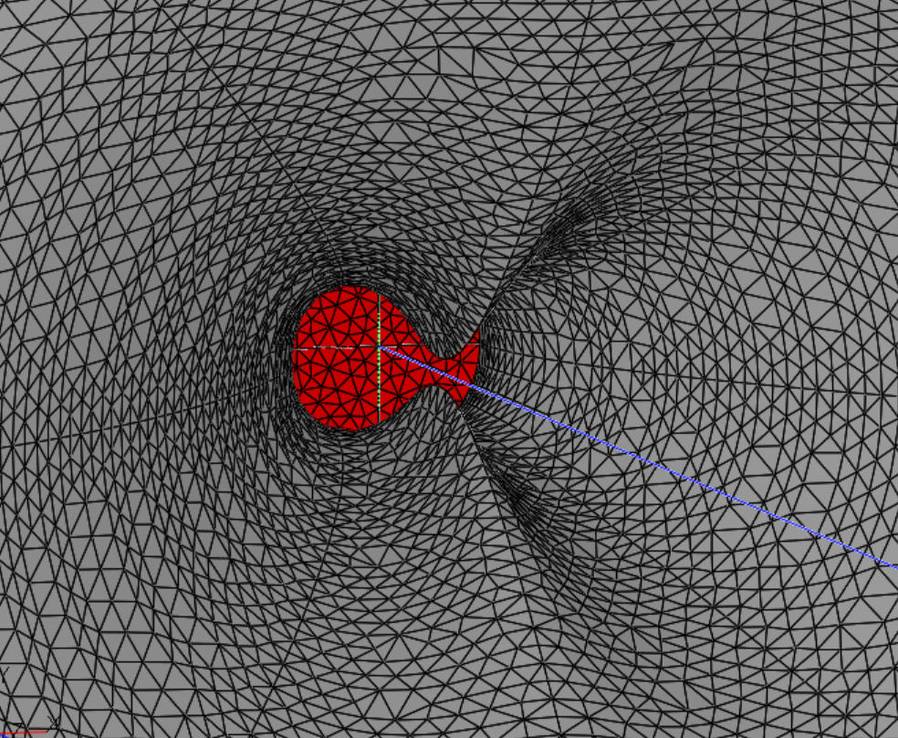

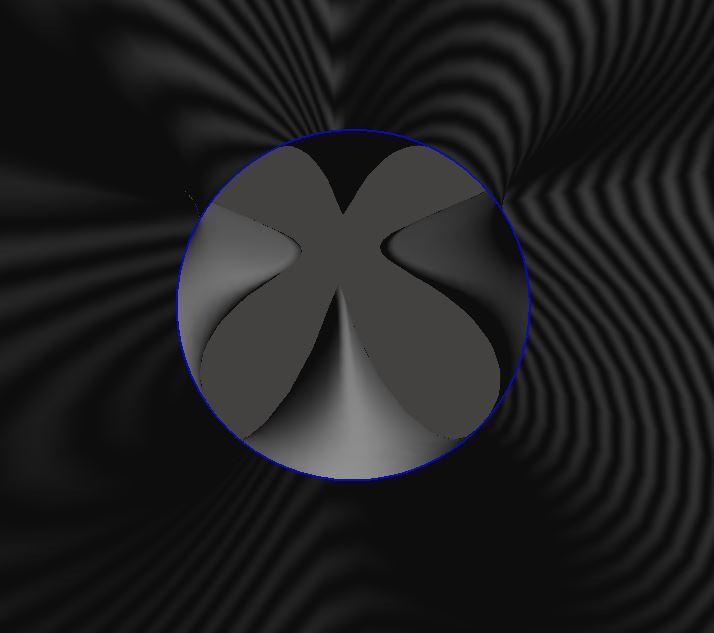

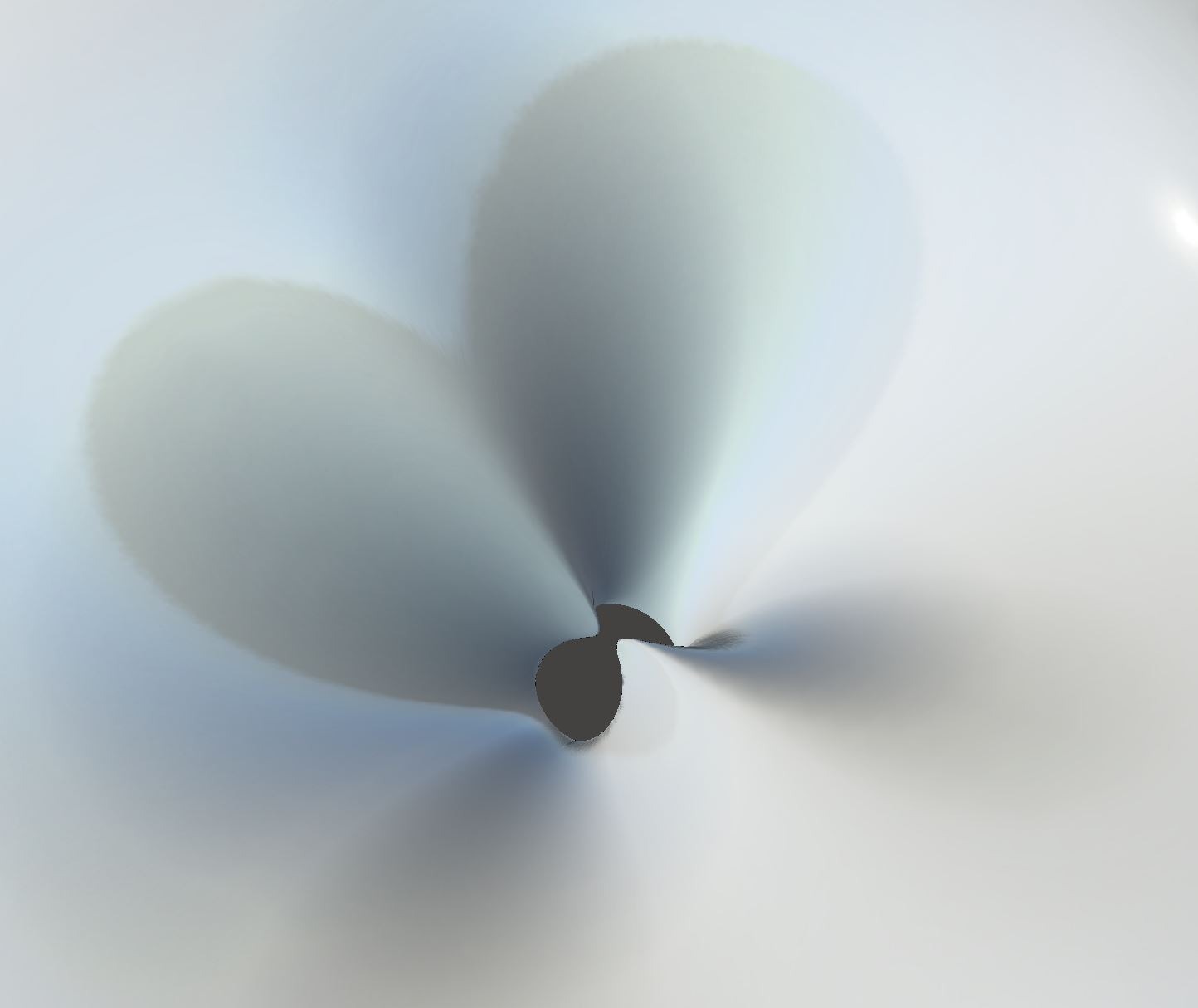

I still have many my own pieces (one of them being a 1.4" KVAR version already mounted to the HF1440) waiting to be measured properly...

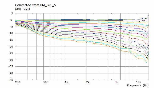

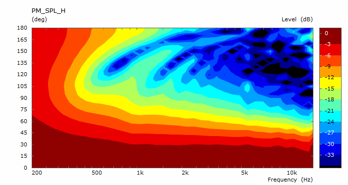

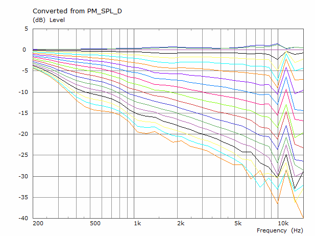

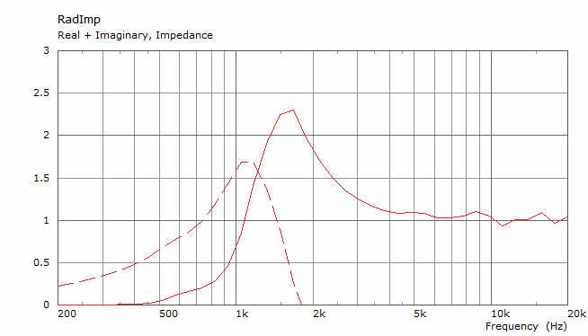

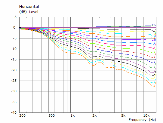

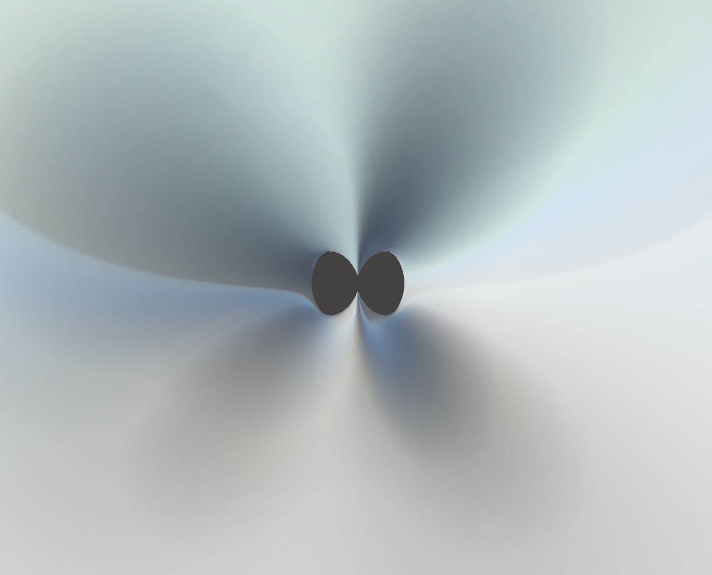

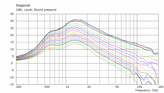

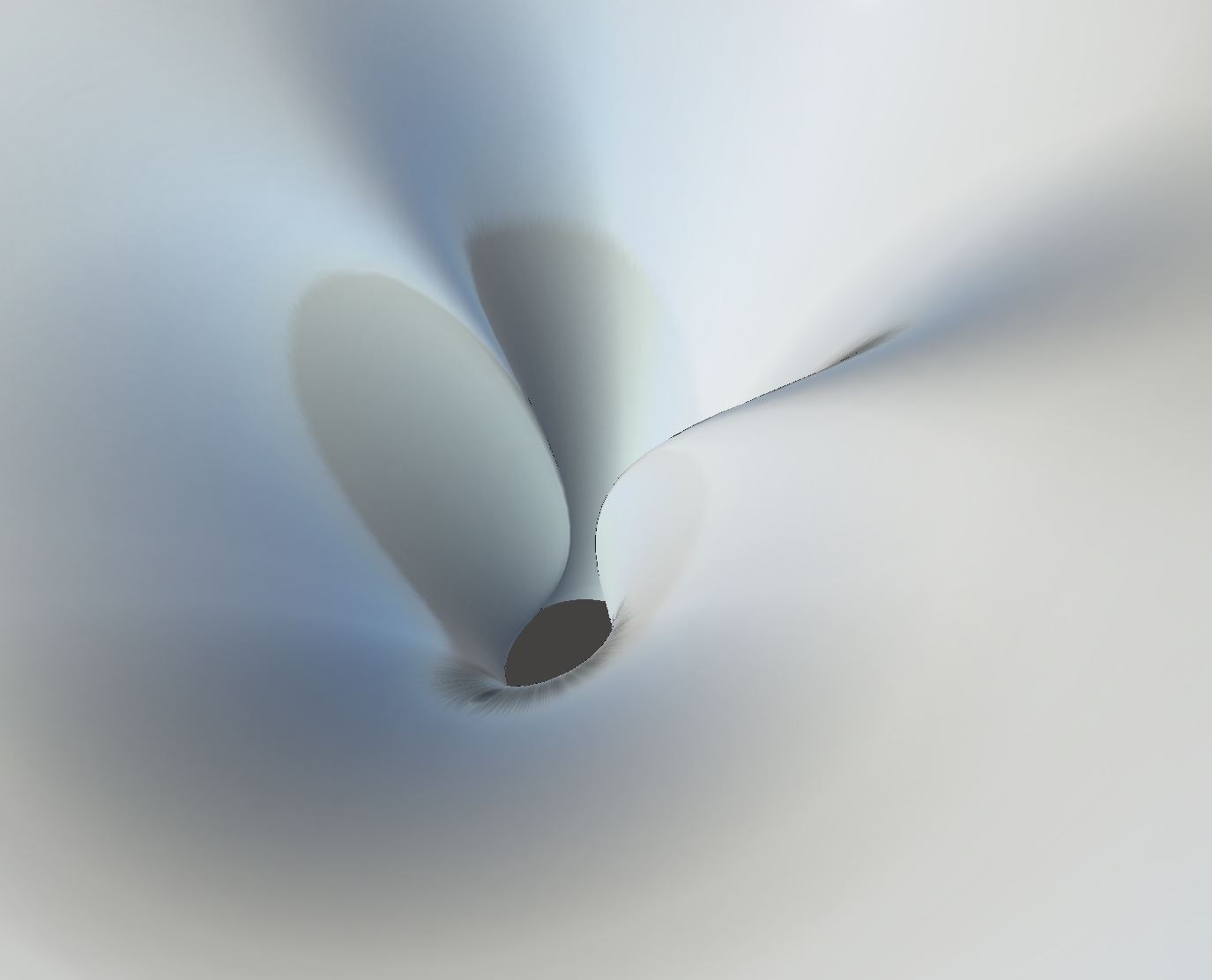

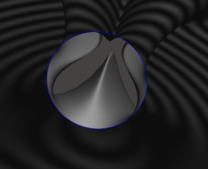

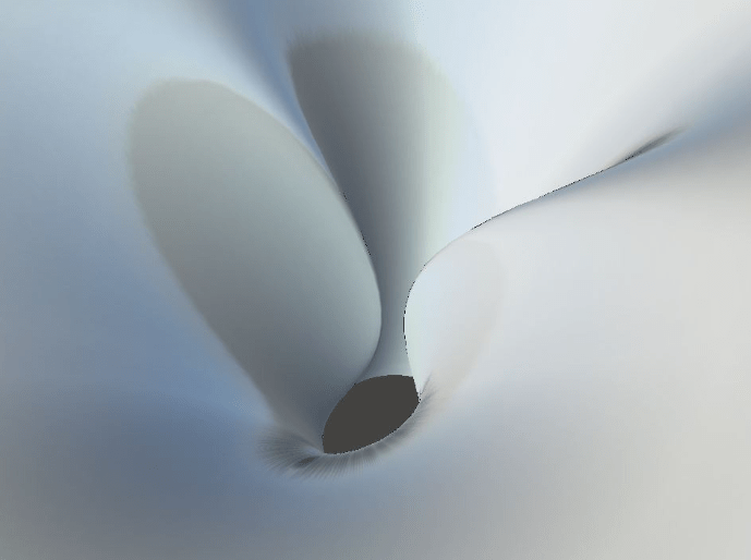

- In the meantime, a variation on the above theme (#10,461 etc.):
1" throat, ⌀480 x 190 mm:

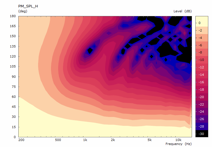

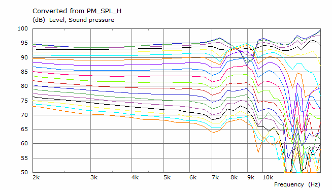

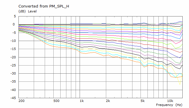

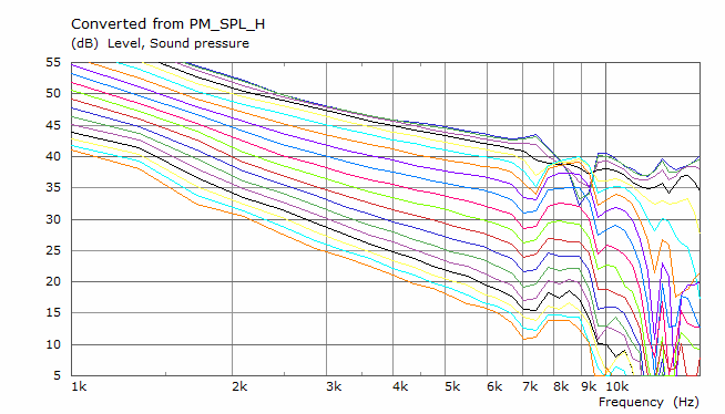

Horizontal 0-90/5 deg:

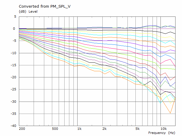

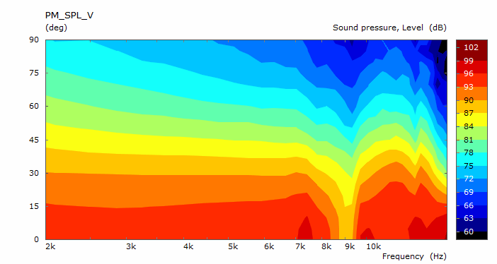

Vertical:

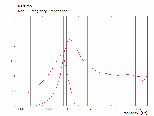

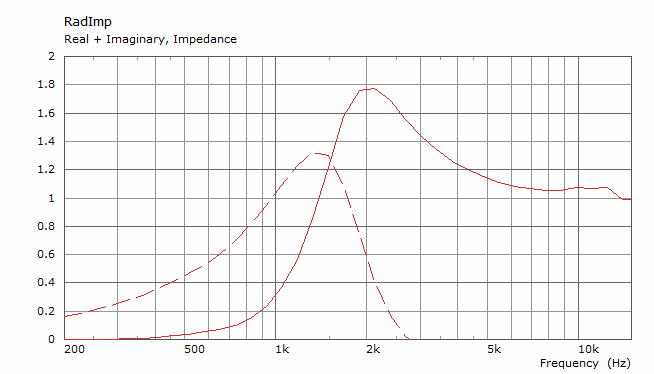

Throat impedance:
There's no need for a spherical source in this case, I think.
It's hard to say how does it really work but the horizontal polars are among the best (if not the best) I've seen.

Yes. It could also be morphed into a rectangle for a box mounting. Haven't tried that yet.i'm assuming that the 'guides in post #10,463 finish in a round rolled over mouth horn...(?)
