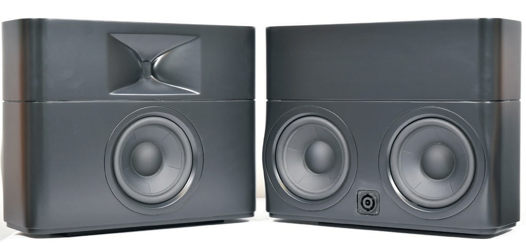

I am not very proficient with the slot feature. Can someone help me with what the required modifiers to the OSSE parameters are, to insert into an oval waveguide only on the horizontal axis -> wide and deep cheeks?
something like this would be the the starting point:
And I want to incorporate cheeks to widen the pattern, like here:
A great deal of it is just trial and error.
Take a look at something like this: Slot.Length = 1 + 24.4*cos(2*p)^2
Add that line to nearly any of the waveguides will basically create a slot where the depth of the slot will be long on the X and the Y axis, and short on the diagonals.
Do a search here and you'll see other examples of adding a slot: https://www.google.com/search?q=site:diyaudio.com+"slot.length"
Fair warning: I've never come up with a waveguide that performed better, as far as polar response and frequency response goes, than one WITHOUT a slot.
In the case of the JBL speakers, I think they're largely using the slot for marketing reasons and also to create a waveguide that has wider beamwidth than a conventional waveguide of equivalent size. The JBL design basically "robs from Peter to pay Paul." It widens the beamwidth on the X and Y axis by narrowing the beamwidth on the diagonal axis, at the expense of overall smoothness.

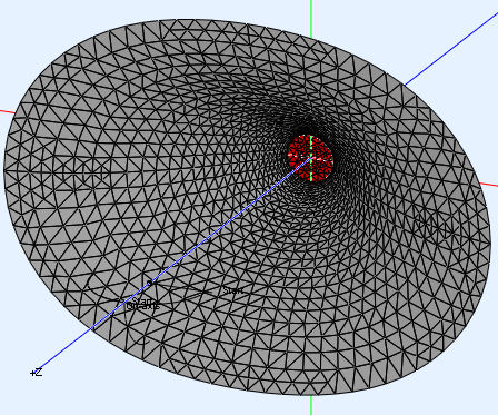

Yes, I know the basic formula and removing the multiplier for p results in purely horizontal bulges. Multiplier for cos seems to define depth / dimension and a smaller exponent makes them less slotty abd more bulgy. But I never get as far as that they become pronounced, and most times the waveguide looses shape. I applied a guiding curve but then, when I try to make the cheeks, ath fails to mesh.
This is not about slots for HF, it is for widening horizontal directivity. My results for a pattern wider than 50 degree where not as good as I had hoped, so I want to try this now.Fair warning: I've never come up with a waveguide that performed better, as far as polar response and frequency response goes, than one WITHOUT a slot.
How to overcome ath / gmsh limitations here?
Oval waveguide, working fine
Slot with wide, horizontal cheeks. Is getting meshed when Morph.TargetShape=2 is set active (; removed)
For oval waveguide, shape must be set with guiding curve however, is meshed.
But when Slot feature is enabled ..
Code:
Throat.Angle = 10.08
Throat.Diameter = 25.4
Throat.Profile = 1
Coverage.Angle = 53 -14*sin(p)^2
Length = 56.5
Term.s = 3 -0.04*sin(p)^2
Term.n = 3.5 +0.7*sin(p)^2
OS.k = 0.28 +0.4*sin(p)^2
Term.q = 0.87674
Code:
Slot.Length = 25*cos(p)^10
;Morph.TargetShape = 2
Code:
GCurve.Type = 2
GCurve.SF = 1.6,1.5,4,4.3,5.6,2.2
GCurve.Width = 256
GCurve.Dist = 1
Error : 'bem_mesh.geo', line 469: Unknown variable 'nan'
Error : 'bem_mesh.geo', line 470: Unknown variable 'nan'
Error : 'bem_mesh.geo', line 487: Unknown variable 'nan'
Error : Too many errors: aborting parser...
