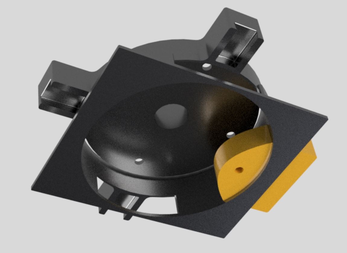

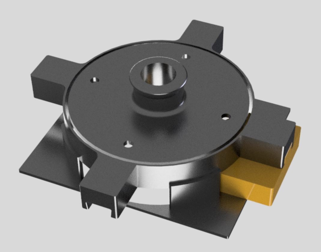

Started printing yesterday, though I think I'll run out of filament at 90%Nobody has tried the ST260 BLD?
https://www.diyaudio.com/community/...-design-the-easy-way-ath4.338806/post-7087469
The simulation promised it to be exceptionally good.
Here's a STEP file: https://at-horns.eu/ext/ST260-BLD-v1-STEP.zip

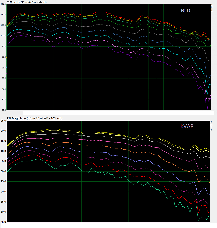

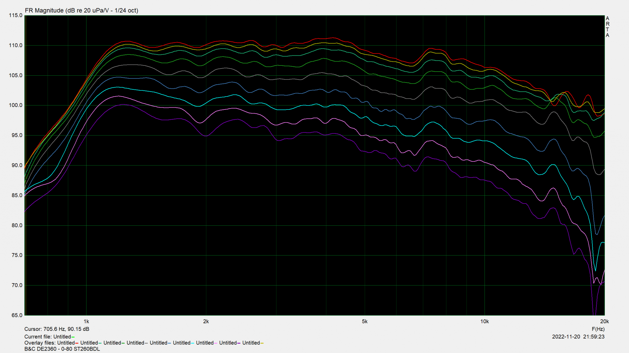

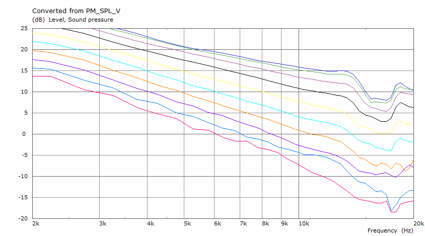

Here are quick measurements of the B&C DE360 - no crossover - at 1M - 0-80 degrees HStarted printing yesterday, though I think I'll run out of filament at 90%![]()
That looks pretty good to me.
This was the KVAR version: https://www.diyaudio.com/community/attachments/b-c-de360-ath-st260-kvar-raw-png.1052174/
- Is it possible that the BLD was measured using a little bit longer time window?
Looks very good to me, could you share Arta pir files of the above, also any distortion measurement made ? According to Xiometry, a pair of Alu CNC's of the BLD step files is about 1200-1300 € with the 10% black friday coupon...
That is incredible. Once you EQ it, it will basically sound the same anywhere in the room.That looks pretty good to me.
It's possible - I can try to re-bo measurements under the same exact conditions.That looks pretty good to me.
Which one? the KVAR or the BLD? If I remember correctly, I believe the BLD had better vertical polars than the KVAR. Will repeat the measurements this evening.That is incredible. Once you EQ it, it will basically sound the same anywhere in the room.
