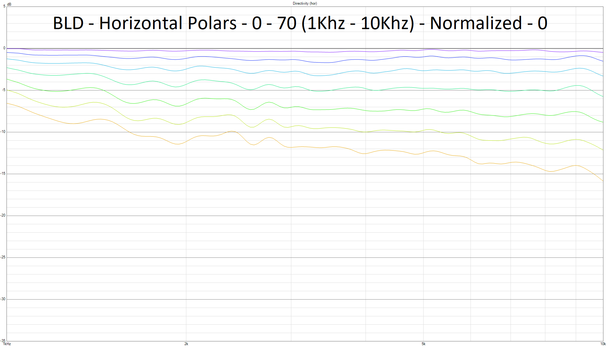

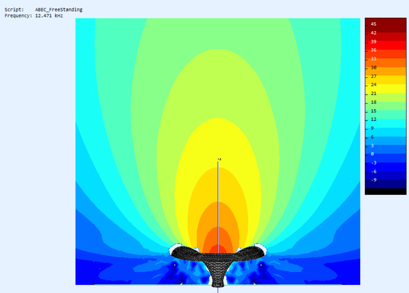

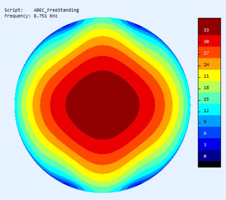

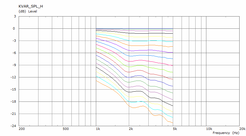

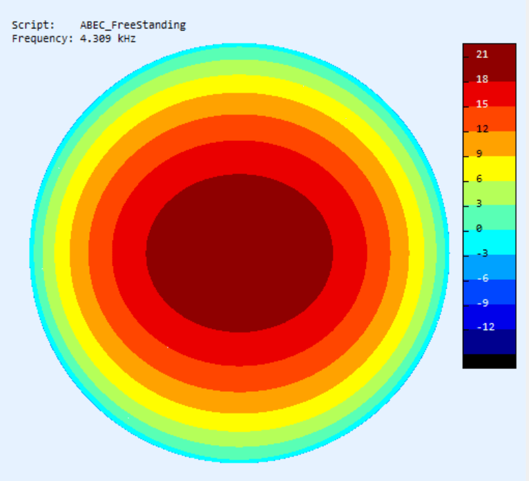

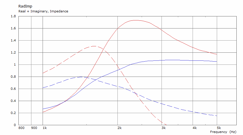

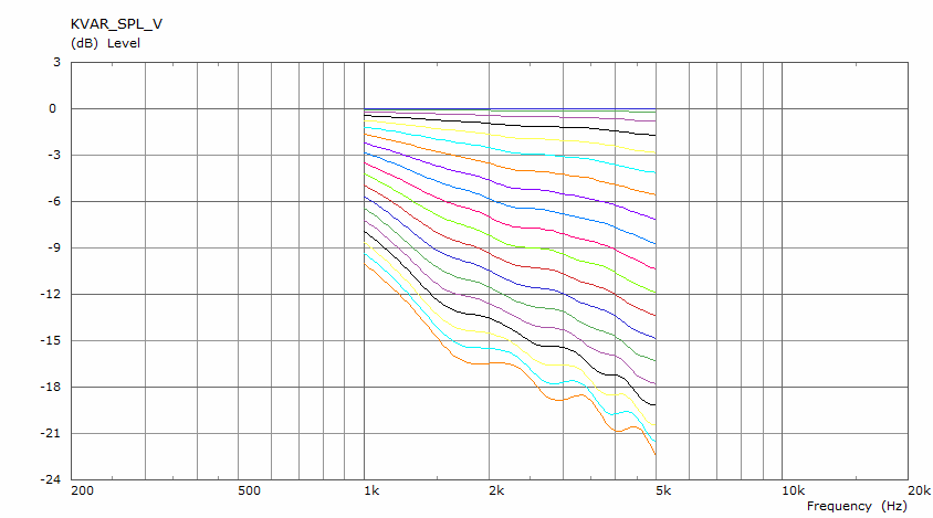

I made a quick hi-res simulation of the two (60 points between 1 - 5 kHz).
Maybe the BLD is really a little bit less smooth after all.
KVAR:
BLD:
Throat impedances (KVAR = blue):
Vertical BLD is really exemplary. Let's make it horizontal instead.
Is the overall linearity of the waveguide-driver combo less important than the normalized polar pattern - with the idea that the driver+waveguide linearity can be addressed with passive/active crossover/dsp?
Based on the first glance, the linearity of the driver's frequency response is less impacted by the KVAR version than the BLD, but the BLD has a tighter polar pattern.
Basically, yes. That said, it's of course always better if it's reasonably good enough to begin with.
(Beware of the word 'linear'. I understand you mean 'FR deviation from a flat line' but that's usually not what linear means when talking about systems, where 'linear' means that the behaviour is independent of level (obeys the superposition principle). Which is also a reason we don't have to pay much attention to a particular SPL here - the FR will still be the same, as long as the whole system stays linear, i.e. it's not driven too hard.)

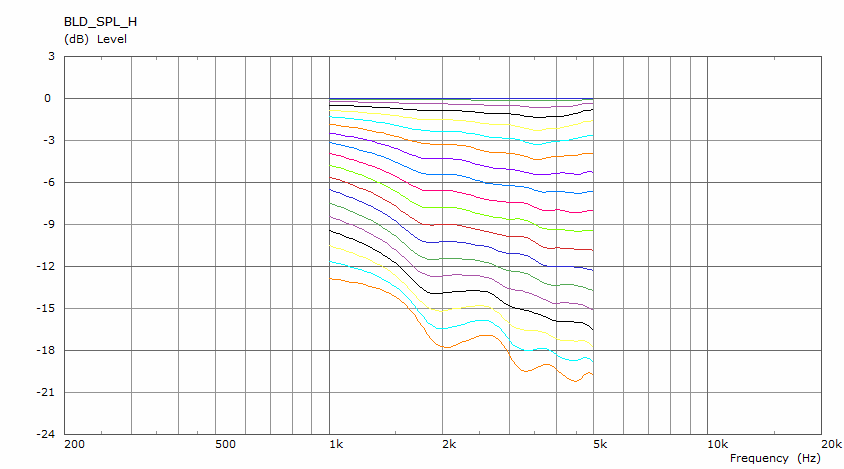

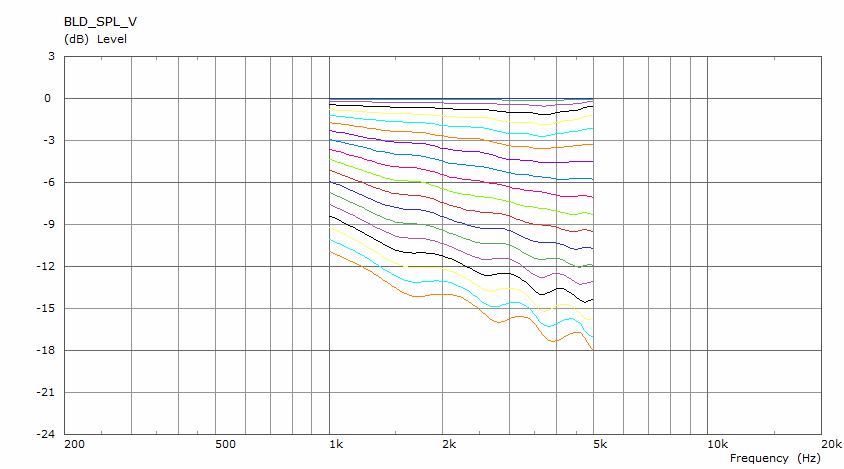

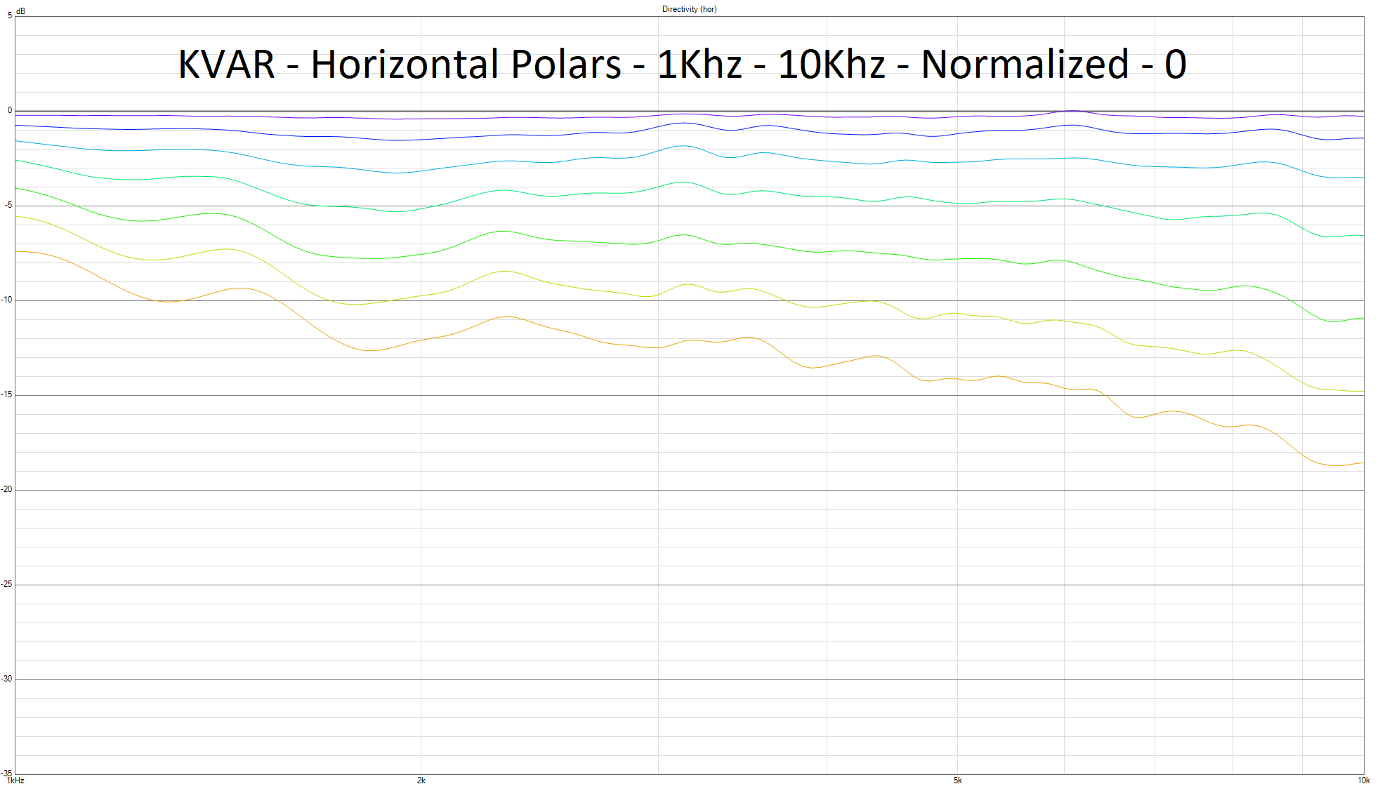

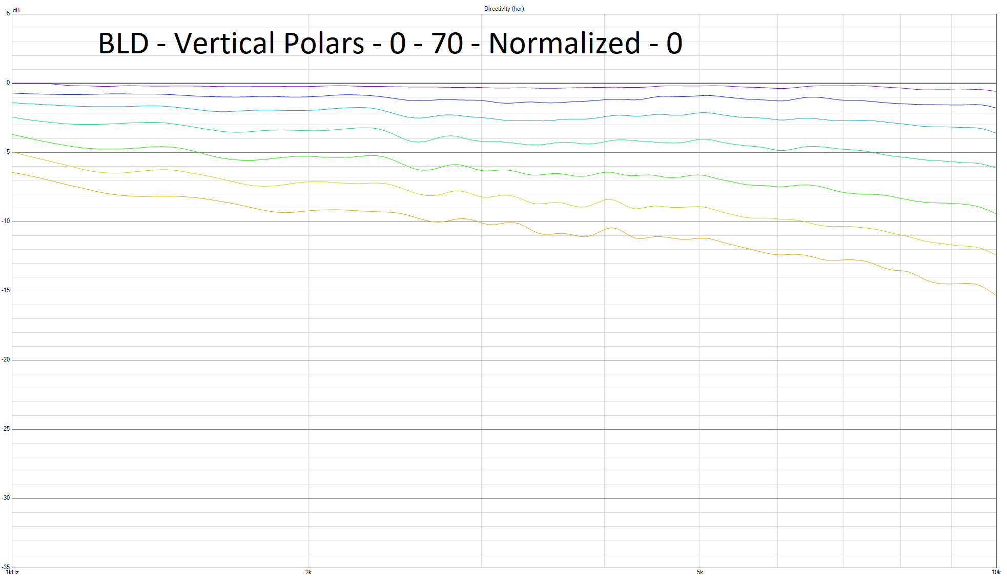

If normalized polars are helpful, see attached:
1) BLD - Horizontal - 0 - 70 - Normalized for On-axis (0 Degrees) - 1Khz - 10Khz
1) BLD - Vertical - 0 - 70 - Normalized for On-axis (0 Degrees) - 1Khz - 10Khz
1) KVAR - Horizontal - 0 - 70 - Normalized for On-axis (0 Degrees) - 1Khz - 10Khz
1) KVAR - Vertical - 0 - 70 - Normalized for On-axis (0 Degrees) - 1Khz - 10Khz
It's amazing how tight the radiation pattern of BLD-Vertical is (which, as @mabat pointed out, can be rotated to be used as horizontal)
