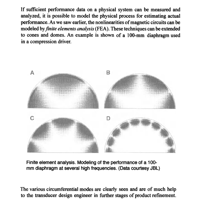

A CD diaphragm is not a stretched membrane (2nd order DiffEq,) it is a free edge plate (4th order DiffEq) and the modes are completely different than a membrane.
When JBL first showed their results, I questioned them as the modes that I would have expected (similar to what is shown above) were not there and ones that I did not expect (rim modes) were. I went back (to Ford) and had our FEA people run a test to see if they agreed with JBL and lo-and-behold they were the same. Hence, if any of you think that you know what to expect but have not actually done the analysis then think again, because you are probably wrong.
And, of course, material and thickness and what-not all make a difference, but for everything else held constant as the diaphragm area goes up the mode frequencies go down.

The modes that JBL showed and I confirmed were not axisymmetric, like those shown. They were modes around the rim with very low displacements in the center. If the analysis was axisymmetric, then these rim modes would never even show up. With FEA you have to be very careful about how the analysis is done. Plates are by far the most difficult thing to do because of so many degrees of freedom.

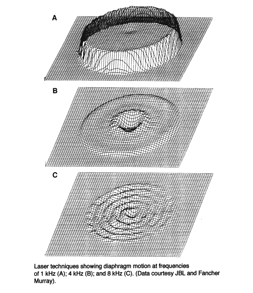

![d-5250-Hz.png](https://www.researchgate.net/profile/Angelo_Farina/publication/319137550/figure/fig19/AS:588498960650252@1517320494698/d-5250-Hz.png)
Dr. Geddes presumably refers to the work of Fancher Murray at JBL, around 1988. He showed circumferential modes by using laser technology, used FEA to predict such modes and published a paper:
Murray, F., “MTF (Modulation Transfer Function) as a Tool in Transducer Selection.”
The modes that JBL showed and I confirmed were not axisymmetric, like those shown. They were modes around the rim with very low displacements in the center. If the analysis was axisymmetric, then these rim modes would never even show up...
How are these non axisymmetric modes excited?
I would have expected very little excitation and hence very low level.
"f any of you think that you know what to expect" indeed true!
Best wishes
David
How much the modes get excited is a different question from what they are. The JBL stuff shows that they are excited, but how that happens is unclear.
