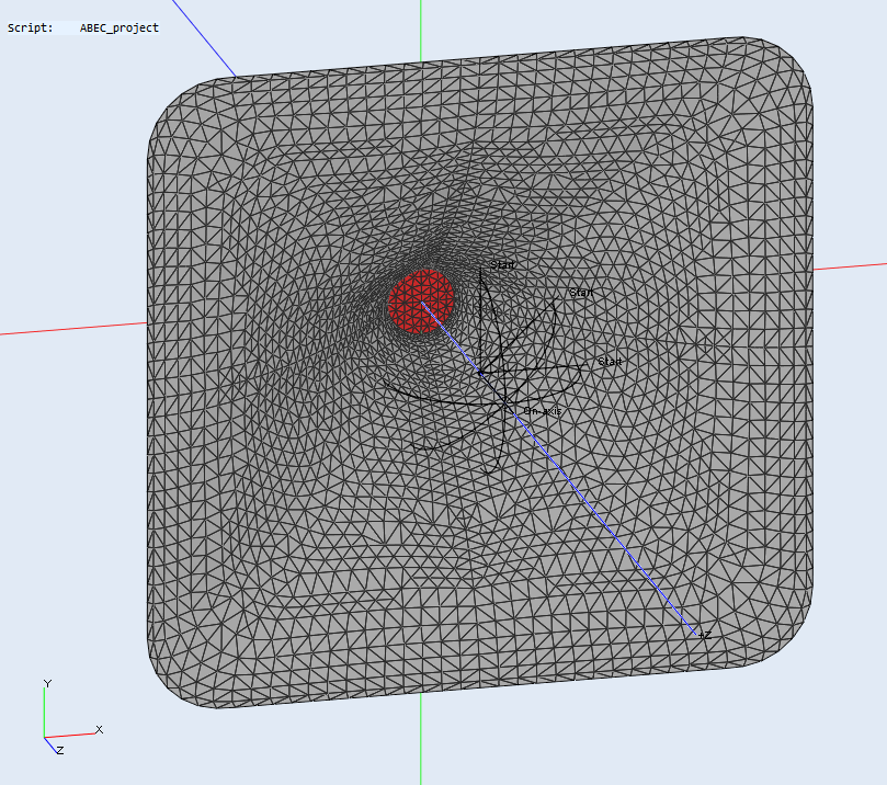

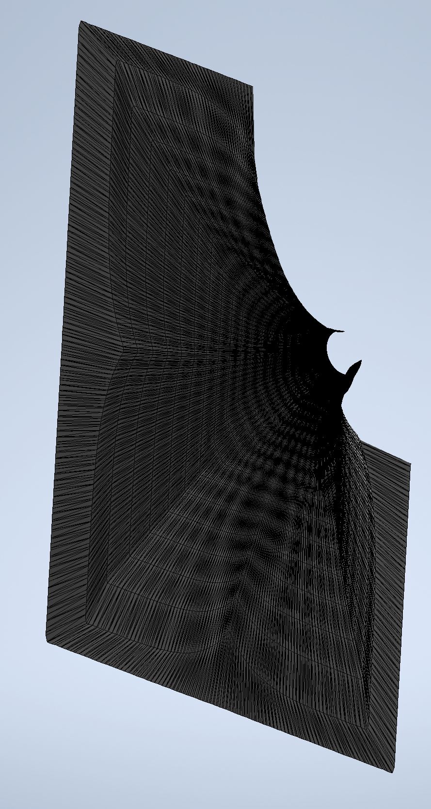

The combination of Matlab/Comsol works fine. I implemented something similar (I am not acociated with the Author of the aforementioned paper) by myself and did show it previusly here in this topic.
My current implementation takes almost 2 Weeks for an optimisation in two domensions. Which is part due to my Hardware (8 core Rayzen) and part due to Comsol as the calculation and post processing is rather slow (k-wave manages some higher frequency stuff in fraction of what Comsol needs but does not support objects in the frequency domain interface...). I tried to find other frequency domain solvers that work directly in Matlab and maybe even have GPU support but no luck so far (in finding something that I actually understand how to interface...)
Also, I do not use a CAD Programm currently ( My goal is to fully run it in Matlab) but that may Change again as I am having trouble post processing the finished Model.

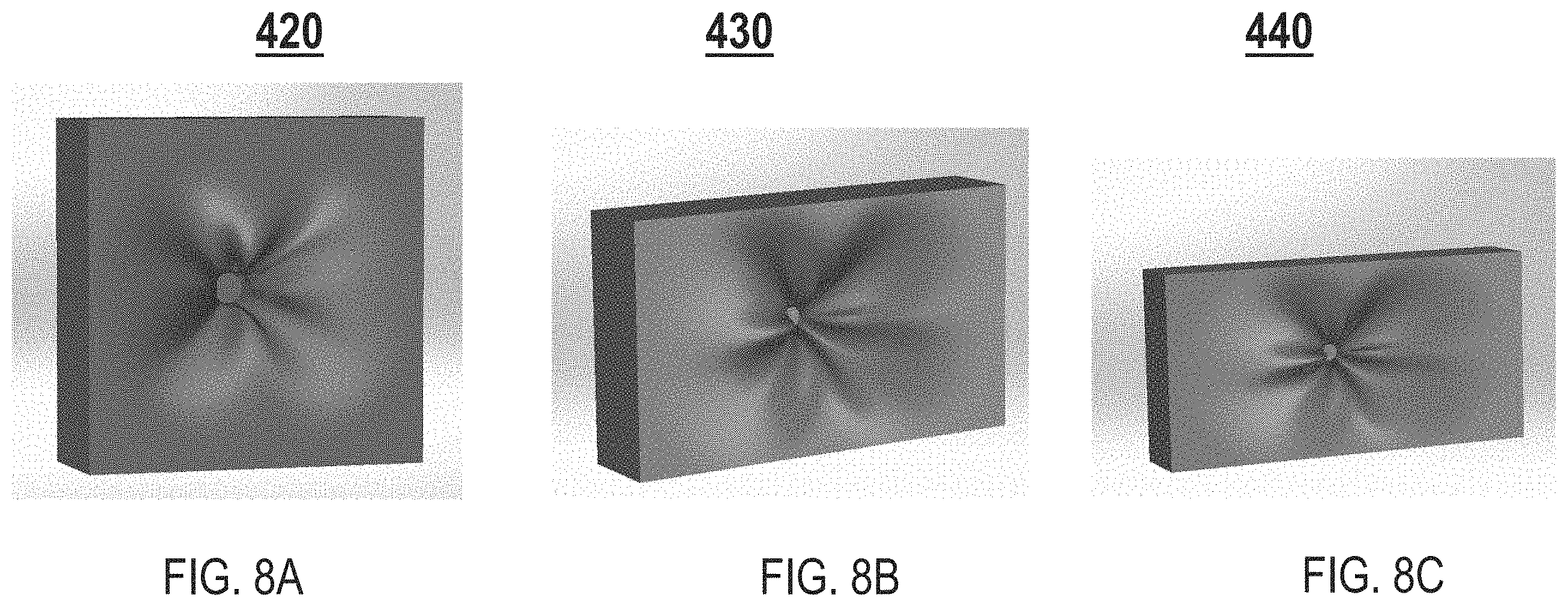

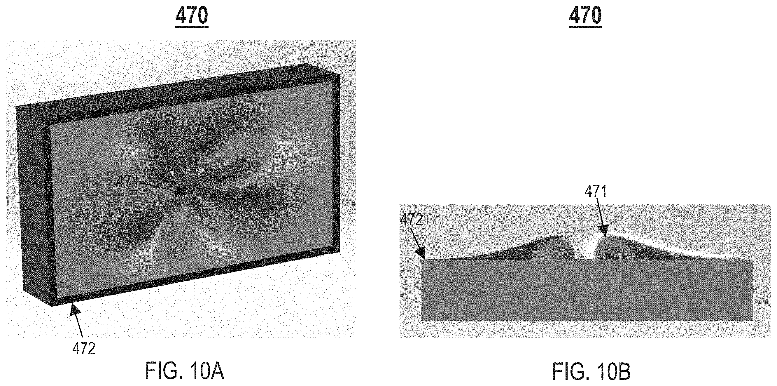

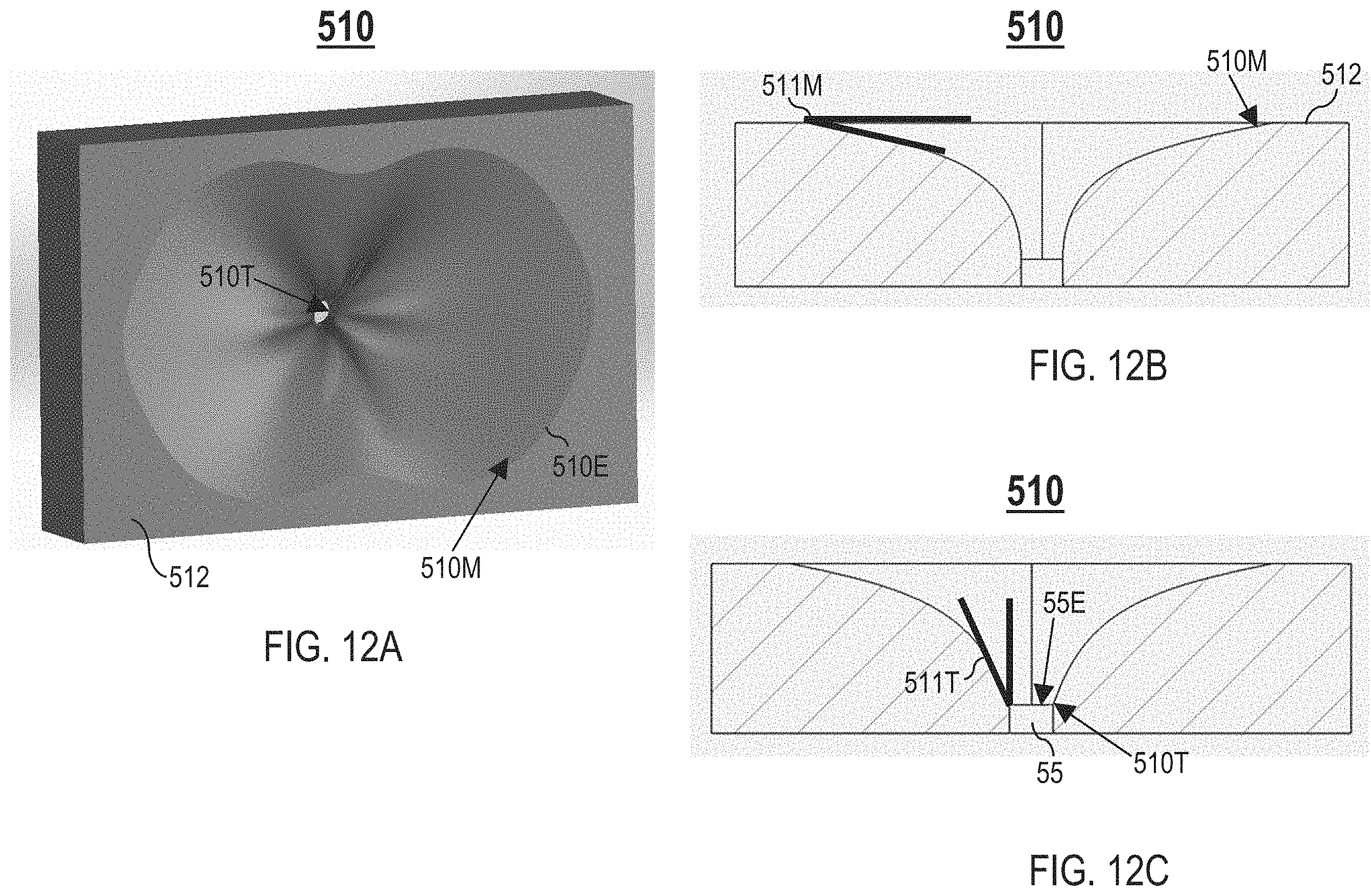

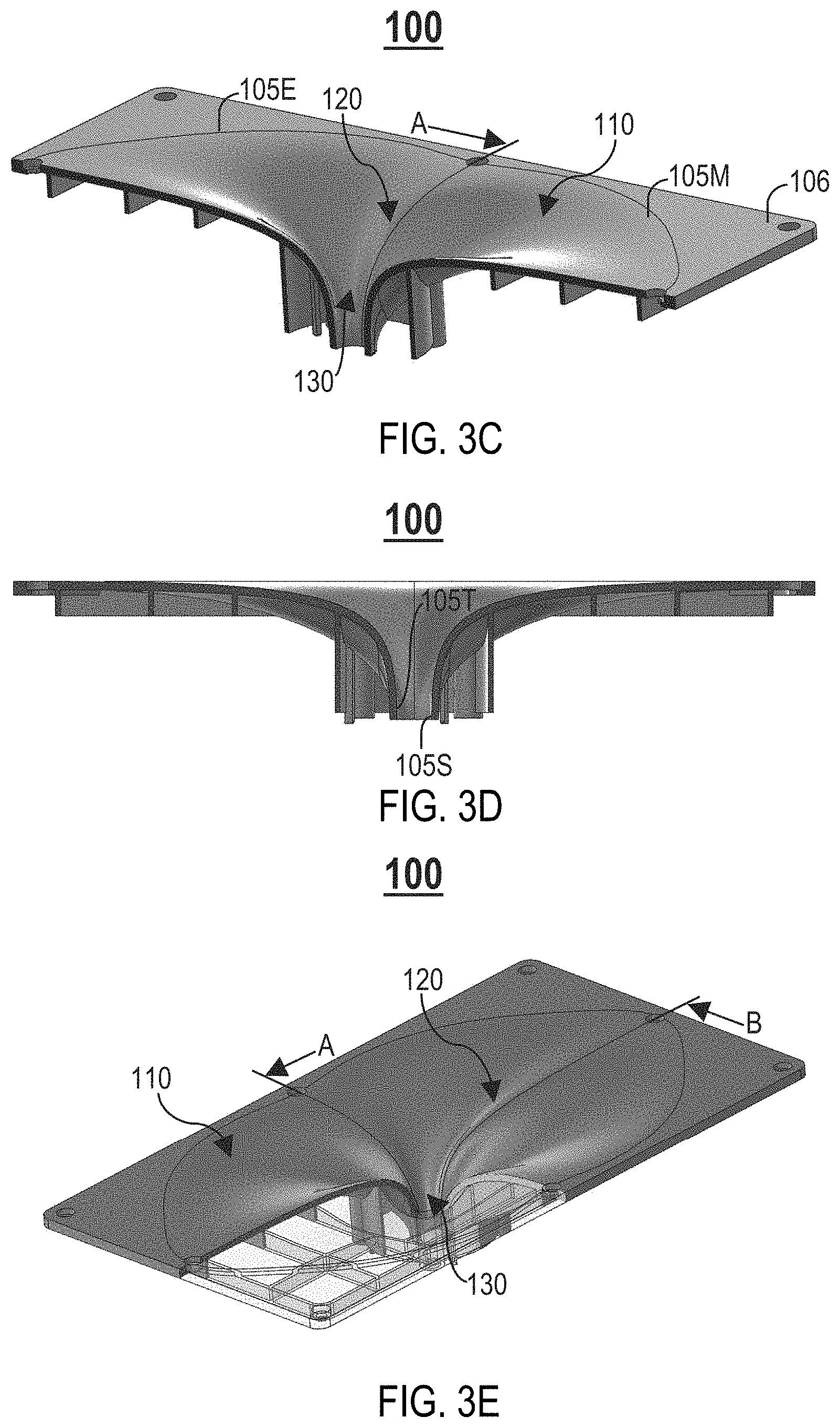

The rectal guide was discussed earlier in this thread. Now it is also patented by Samsung Electronics.
BTW, that shape is simply a result of the way they allowed the profile curves to change, which was very basic and still quite limited rule, IMHO (just bezier cubics, IIRC). So it is optimized in a sense that it may perform "best" within the limitations given. Which is of course true for any such optimization. Anyway, good luck with that!The rectal guide was discussed earlier in this thread. Now it is also patented by Samsung Electronics.
BTW, that shape is simply a result of the way they allowed the profile curves to change, which was very basic and still quite limited rule, IMHO (just bezier cubics, IIRC). So it is optimized in a sense that it may perform "best" within the limitations given. Which is of course true for any such optimization. Anyway, good luck with that!![]()

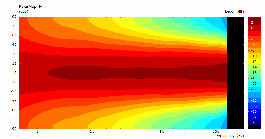

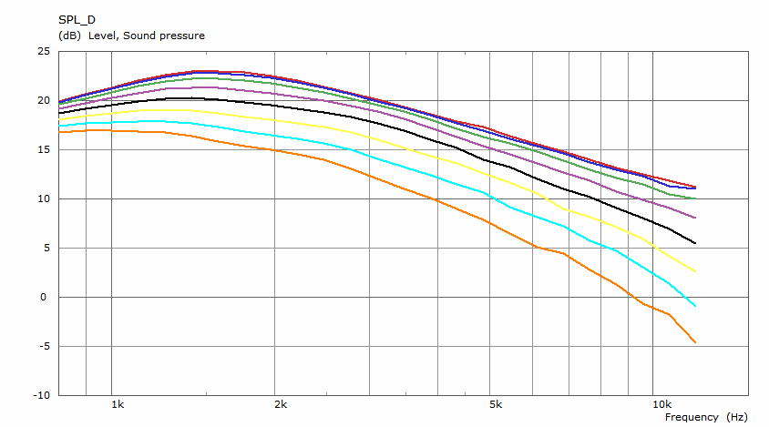

This is also funny: Today, solely by mistake, I tried something I didn't want (what could be considered as an error), but hey, the result is one of the best I have seen -
And that would be...?
I suppose, revolutionary improvement would mean
* Flat acoustic loading from 200-300Hz and up to the last audio octave (e.g. like Heavise or step Sigmoid function).
* Constant directivity in the same frequency range. (I suppose beamwidth of -+(20-30)° in all directions would be ok, at least for home audio).
*Horn-related acoustic nonlinearities would be comparable to that of the direct radiator.
*Perhaps, some kind of numerical criterion should specify a minimum value of HOMs amount.
"Revolutionary design" should improve all the point above at the same time. But as we know, "the horn reality" is completely different. Numerical optimisation helps to find a certain balance of contradictory horn parameters
