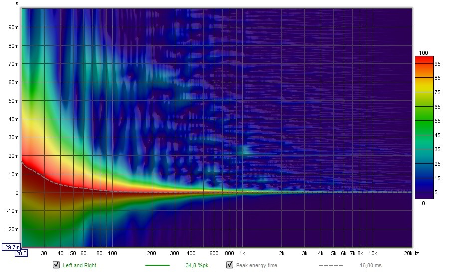

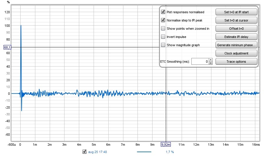

The timing of that impulse, as measured at the listening position looks like this in a wavelet:
In my IR you see no obvious large peaks from early reflections, as I've placed absorption at all first reflection points, observing the indirect sound I had at the listening spot to determine the thickness needed for the panels. The room isn't dead by any means. There's more than enough liveliness to make it a fully functional living room.
I still do have reflections, arriving at the listening spot from lateral angles (uncorrelated and specifically timed). In other words: a Haas kicker coming in at about ~20 ms after the main pulse. This gives me all the focus and attention grabbing direct sound plus envelopment and spaciousness that comes from the recording. Still sounding perfectly natural. It truly differs from recording to recording in size and shape. Much of that envelopment is originating from low frequencies starting below about 400 Hz (so keep that bass output stereo if you love that stuff

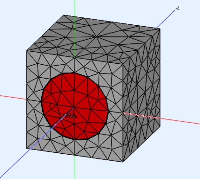

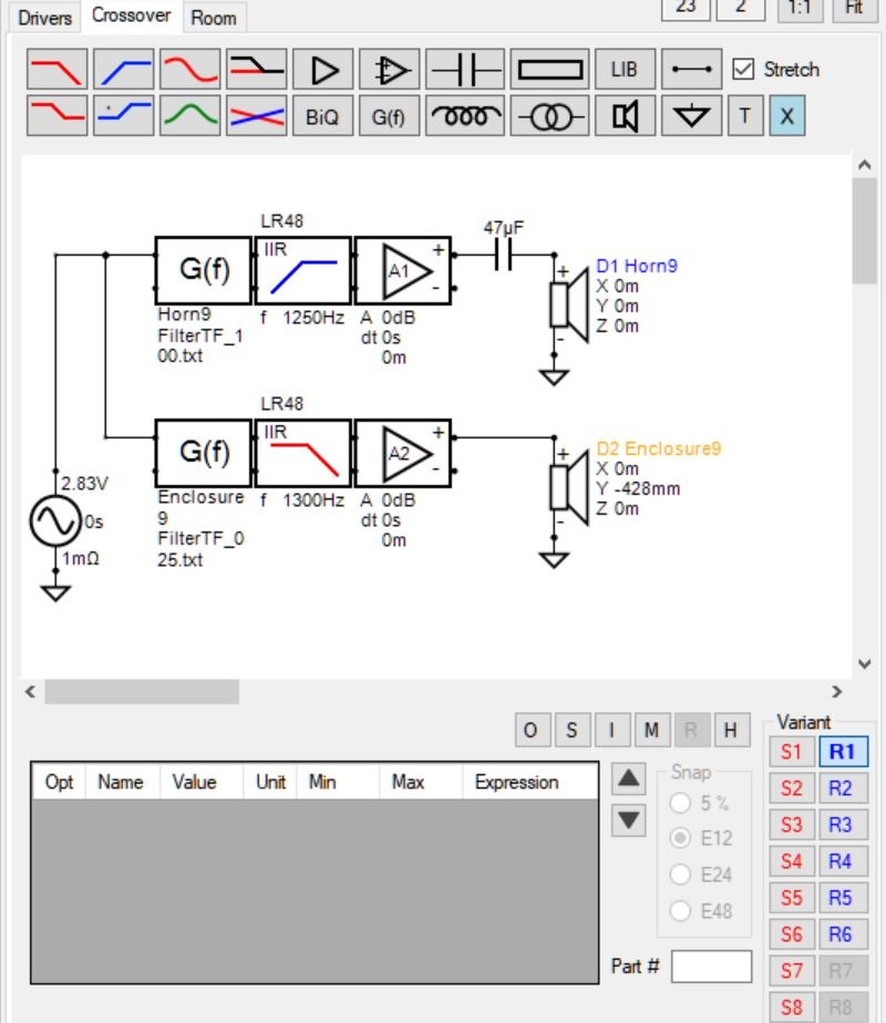

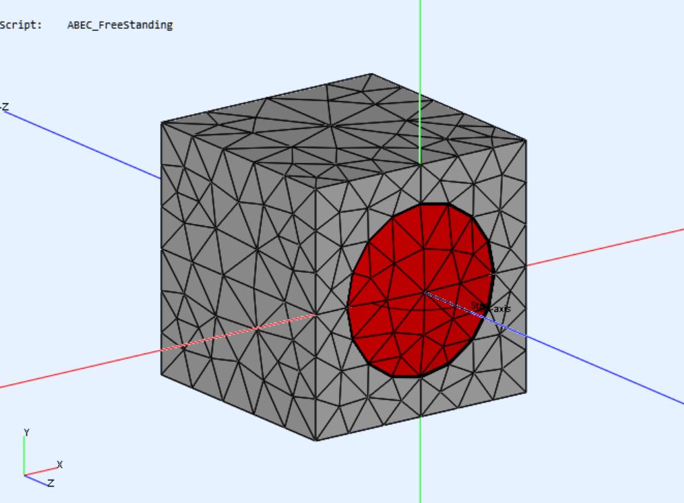

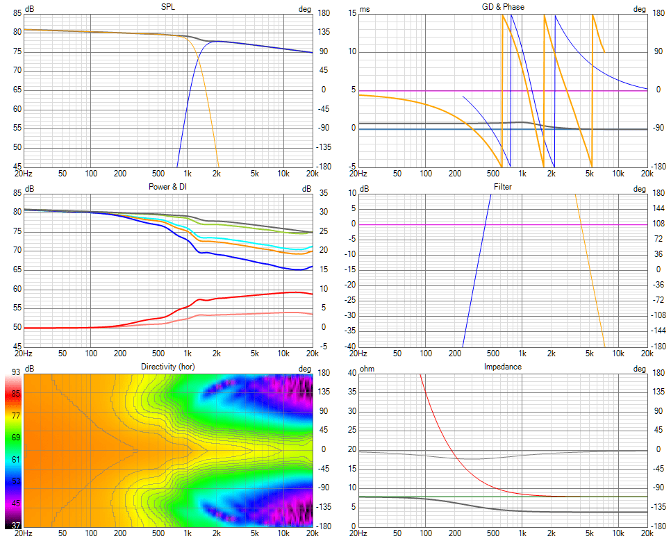

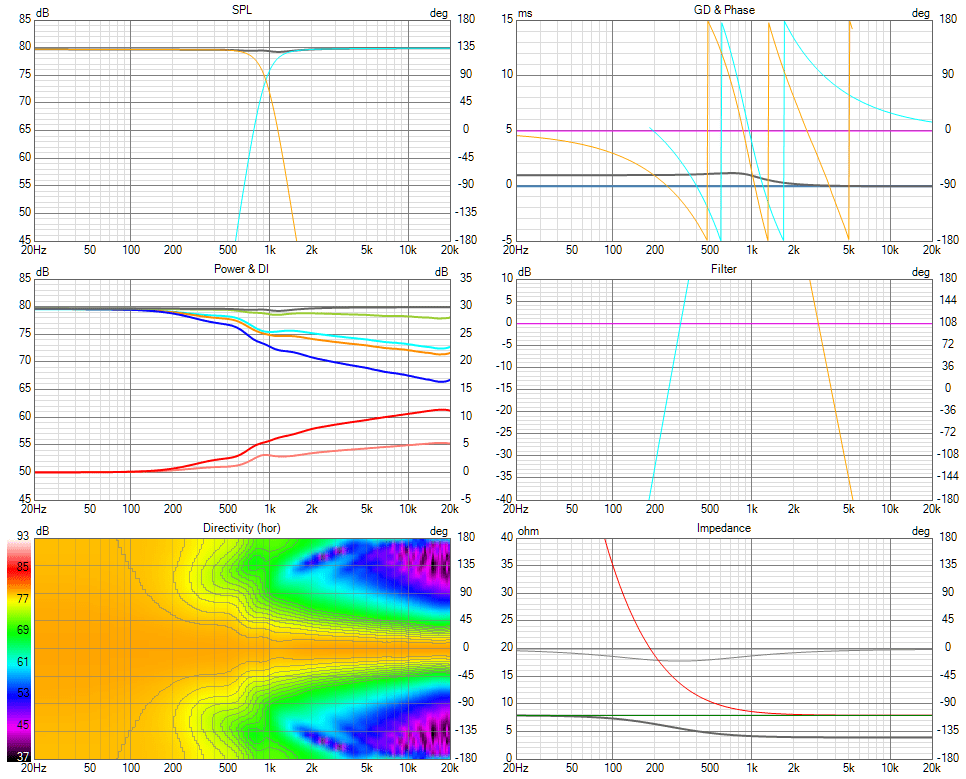

I used ATH to simulate a freestanding horn over an enclosure to create FRD files that can be imported into VituixCAD to simulate crossovers. @VoxCelestial helped me learn how to measure a freestanding horn (waveguide) over a simple box enclosure. Consequently, I tried to use ATH to model and simulate a freestanding waveguide over a simple box enclosure. I couldn't figure out how to place a real woofer into a simple box so I increased the ATH default compression driver diaphragm instead and reduce the horn length to 10mm.
After simulating the waveguide and enclosure separately (consistent with how I'd measure them separately in real life) I exported the resulting FRD files then imported them into VituixCAD so I could simulate crossovers. My main goal at present is to learn how to match the directivity between a waveguide and an enclosure so I generated several different waveguide diameters to try inside VituixCAD against the 9 inch enclosure box. I like the idea of simulating the waveguides separately from the enclosure because you can adjust center to center distance and z axis inside VituixCAD. It may or may not be good practice to simulated them in ABEC together once you settle on a final design. However, I don't think you'd measure them together in real life for import into VituixCAD so simulating them together may be unnecessary.
I'm including the configuration file I used for the enclosure and an 8 inch (20 cm) driver but don't copy my method because it's almost certainly the wrong way to do it.

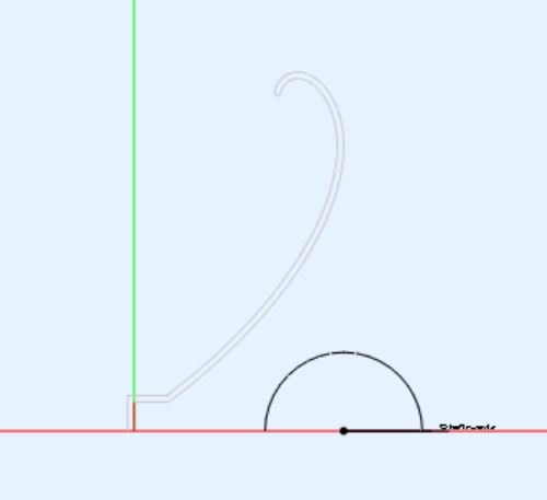

I created a separate ATH config file for the horn section. I did not place the center of rotation at the acoustic center of the horn because I still need to learn how to do that. For the sake of expediency I used the baffle surface of the horn (horn length) so I could create simulations.

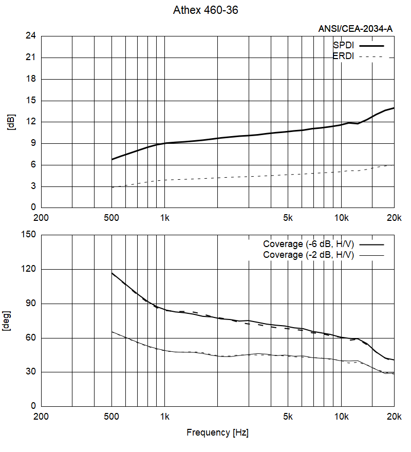

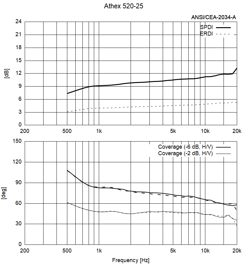

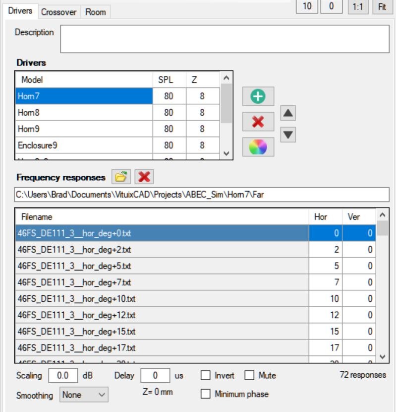

Here's the ATH configuration file for the horn. I will also include five additional waveguide diameters and directivity indexes I simulated vs the 9 inch enclosure box in the attached Zip file.
Running the ATH report ("-r") like normal generates the FRD files that can be copied over to your VituixCAD folders then imported into VituixCAD for crossover simulation.
You'll notice the SPL is at 80dB even though the amplifiers are at 0dB. That's because I set them to 80dB in the Optimizer window when I created the transfer files. In this case, I used the Optimizer window to set "D1 Horn9" (9 inch diameter horn) to a -1/dB octave tilt, down sloping over the full bandwidth of the compression driver/horn. Setting the SPL to 80dB here carries over to your simulations. If you set it to zero in Optimizer or didn't use Optimizer at all you'd have to adjust your power amplifiers to increase SPL.
I'll include all the files I used to make these simulations in the VituixCAD and ATH Configs Zip attachments. Just remember I didn't do it exactly right: 1) horn rotation not set at acoustic center, 2) a compression driver diaphragm rather than a woofer diaphragm, and 3) probably several other mistakes I'm not aware of yet. I also included instructions written by Reid Towsley for working with the G(f) block and exporting transfer function files into Equalizer APO in the VituixCAD Zip.

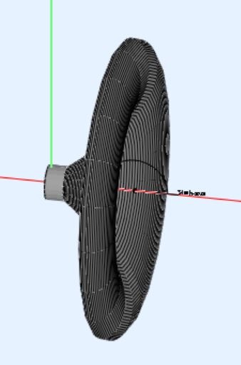

![Capture2.JPG Capture2.JPG](https://www.diyaudio.com/community/data/attachments/1100/1100902-2618a2a734c763d6602349f35facb708.jpg)
![Capture3.JPG Capture3.JPG](https://www.diyaudio.com/community/data/attachments/1100/1100938-646c3c3dda67dc16a3fc435c15db0850.jpg)
![Capture4.JPG Capture4.JPG](https://www.diyaudio.com/community/data/attachments/1100/1100928-144138221fde95b3a17840fa7505c72f.jpg)
![ABEC_Sim var1 Six-pack.png ABEC_Sim var1 Six-pack.png](https://www.diyaudio.com/community/data/attachments/1100/1100929-905d4d329c26d4044a1c1e5e68087c31.jpg)
![ABEC_Sim var4 Six-pack.png ABEC_Sim var4 Six-pack.png](https://www.diyaudio.com/community/data/attachments/1100/1100931-4c2199da4cabba3583c0d02b2bd0bae9.jpg)
![Capture5.JPG Capture5.JPG](https://www.diyaudio.com/community/data/attachments/1100/1100915-e10a96937469db6955eed078f18438b0.jpg)

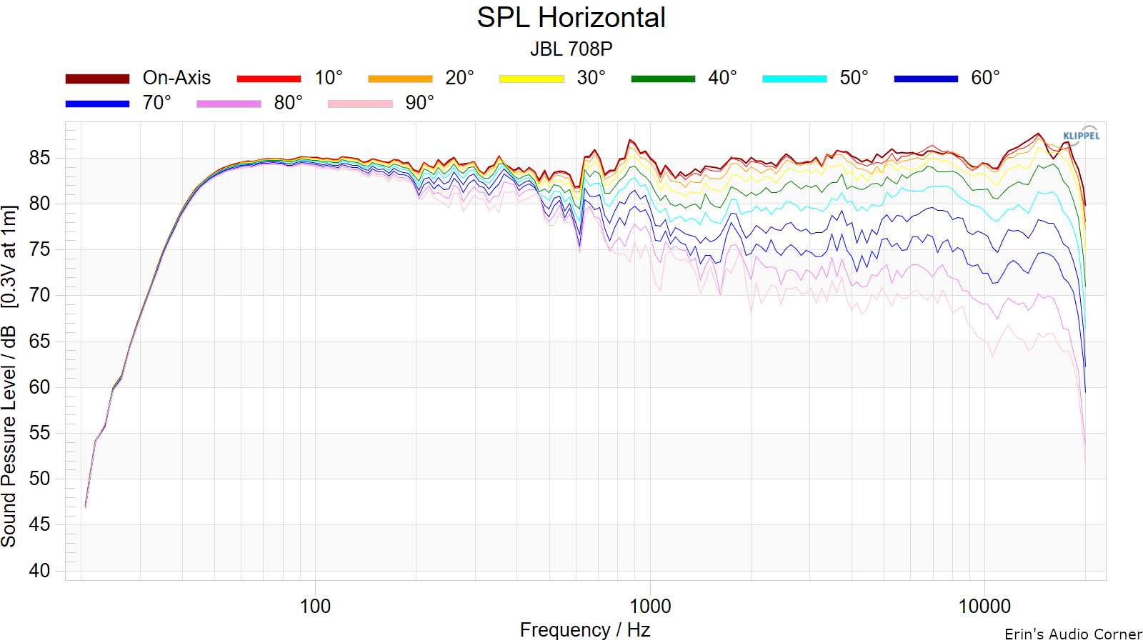

Realized I could have used the same process as modeling a dome tweeter to model the woofer. However, the difference between a real measured woofer and the ATH default horn diaphragm isn't too different. Good enough to at least get a general idea of how the enclosure will do. But you could model the woofer using ATH's "6.5 Modelling a complex source" instructions and examples.

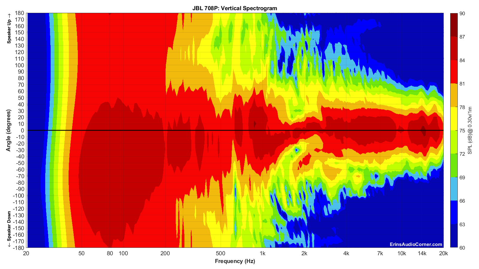

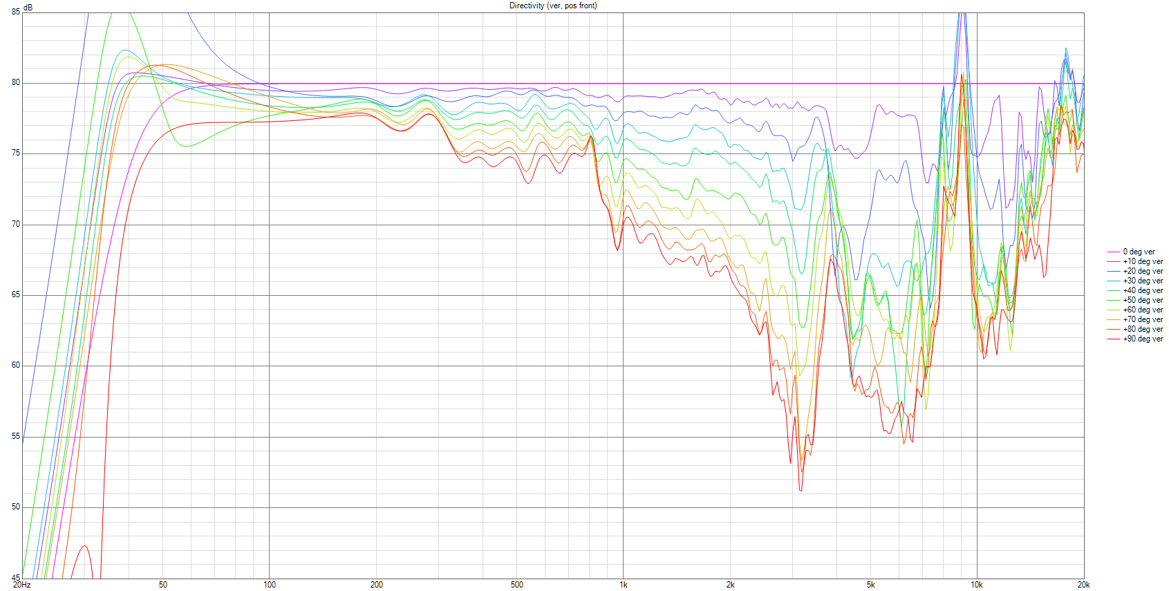

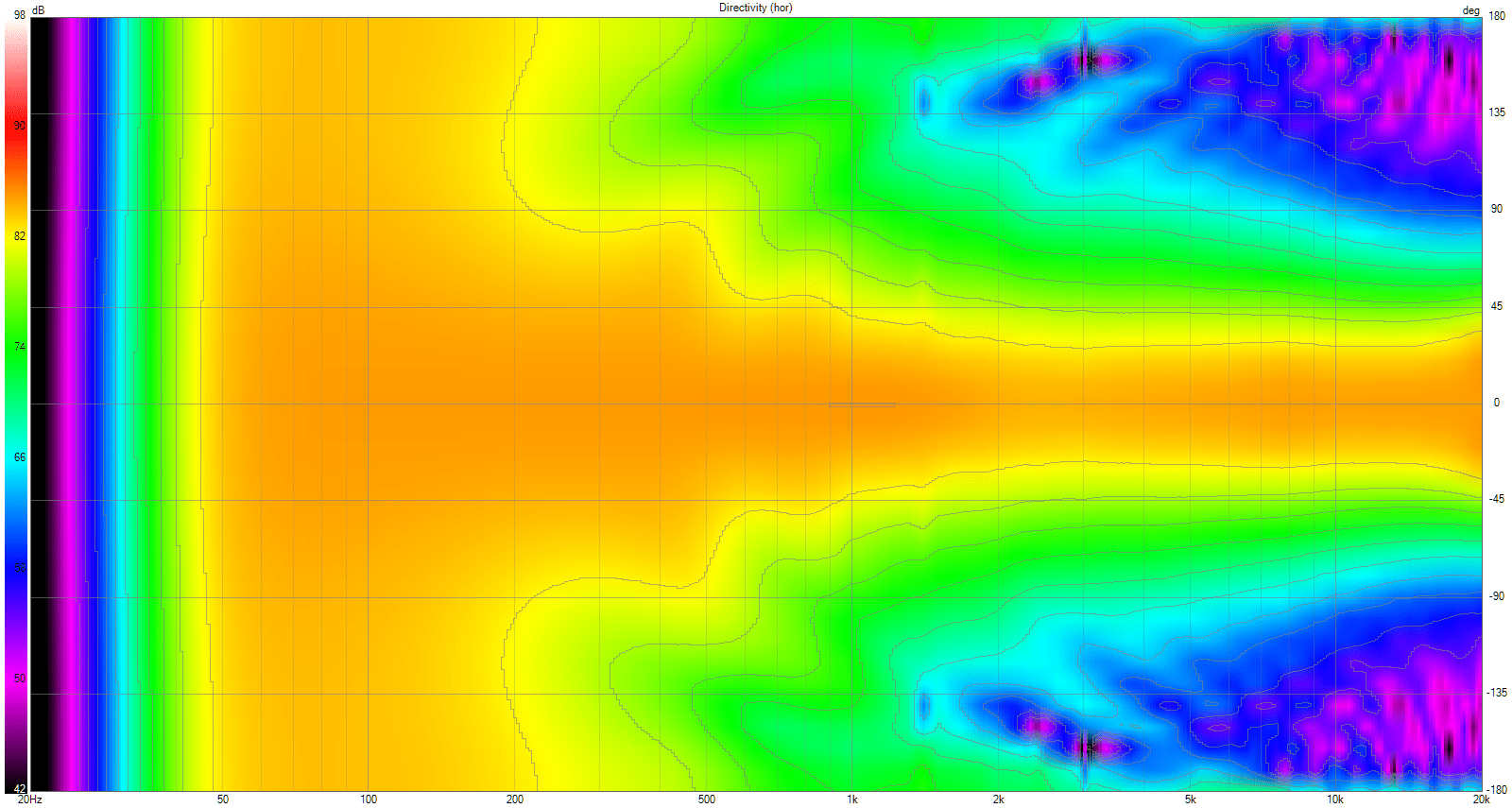

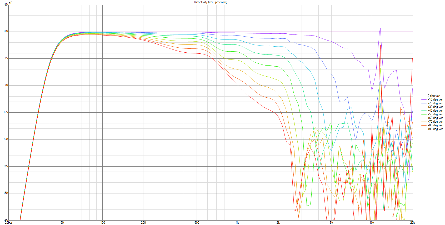

Real measurement vs simple model (default ATH diaphragm) - 8 inch woofer in 9x9 inch enclosure
![ABEC_Sim var7 Directivity (ver, pos front)2.png ABEC_Sim var7 Directivity (ver, pos front)2.png](https://www.diyaudio.com/community/data/attachments/1101/1101284-e6e3c7a96b119f32c0dc81f719d5fcd7.jpg)
![Capture.JPG Capture.JPG](https://www.diyaudio.com/community/data/attachments/1101/1101286-bec56d164ae70e8da632f367d5292324.jpg)
![ABEC_Sim var7 Directivity (ver, pos front).png ABEC_Sim var7 Directivity (ver, pos front).png](https://www.diyaudio.com/community/data/attachments/1101/1101283-1c057d03a2cca49870d4b89a79e06924.jpg)

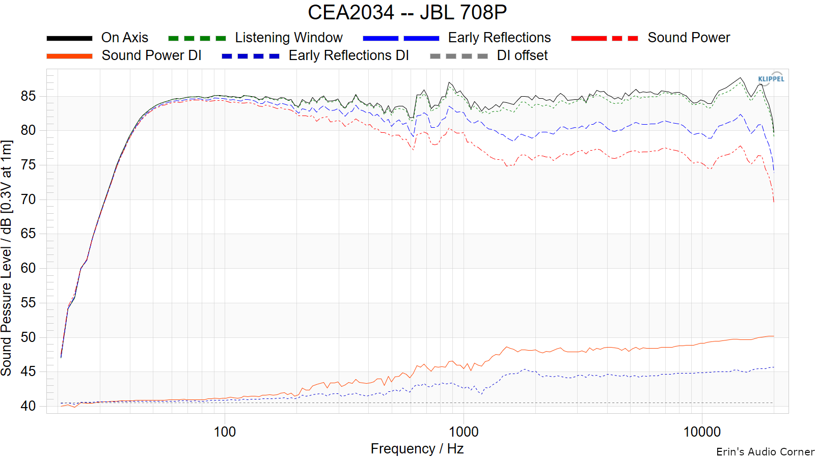

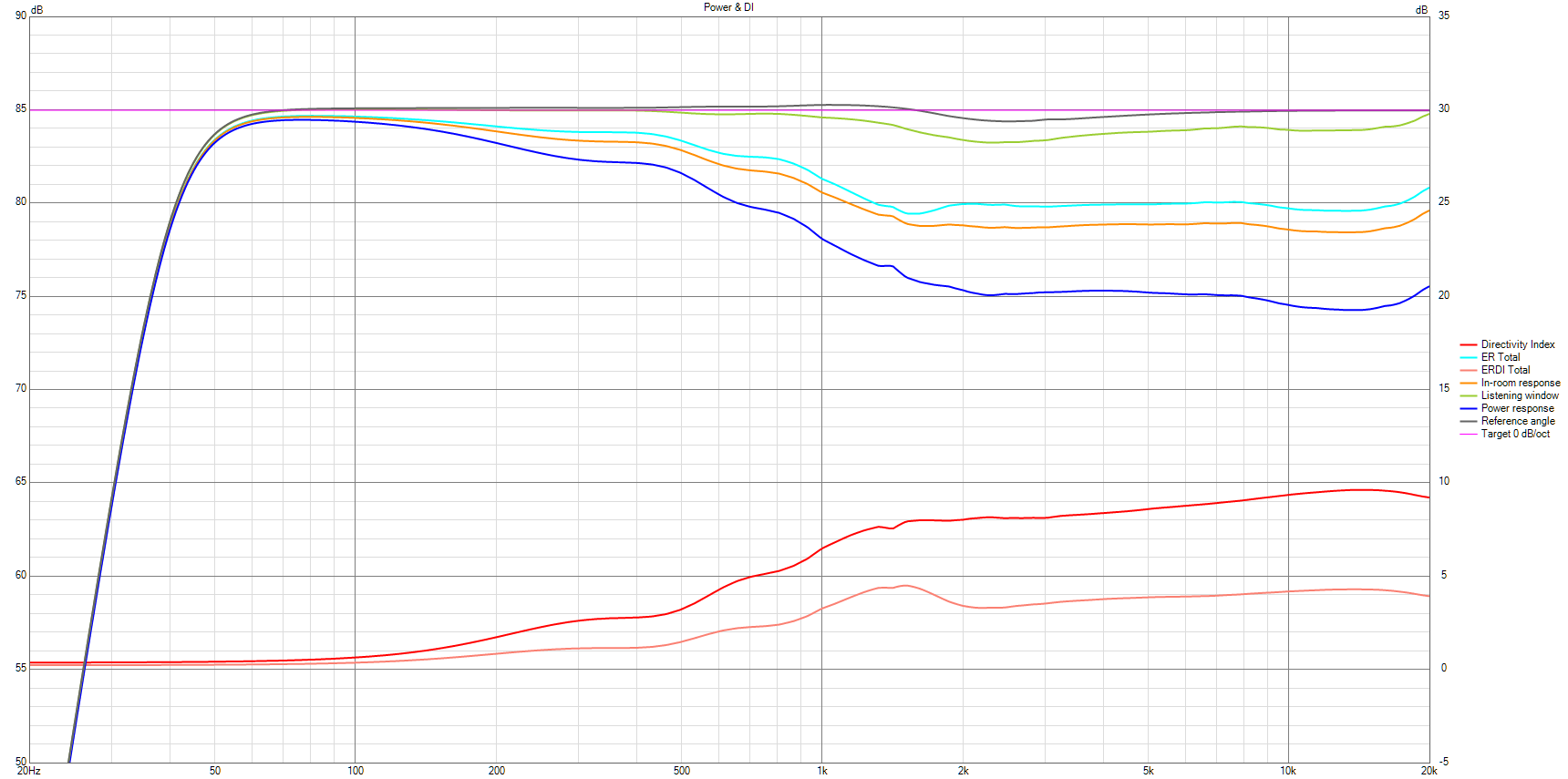

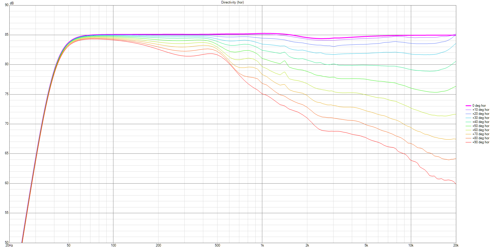

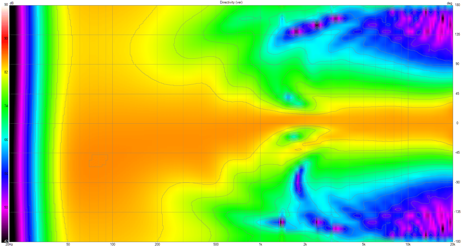

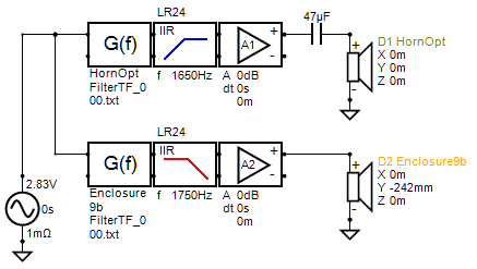

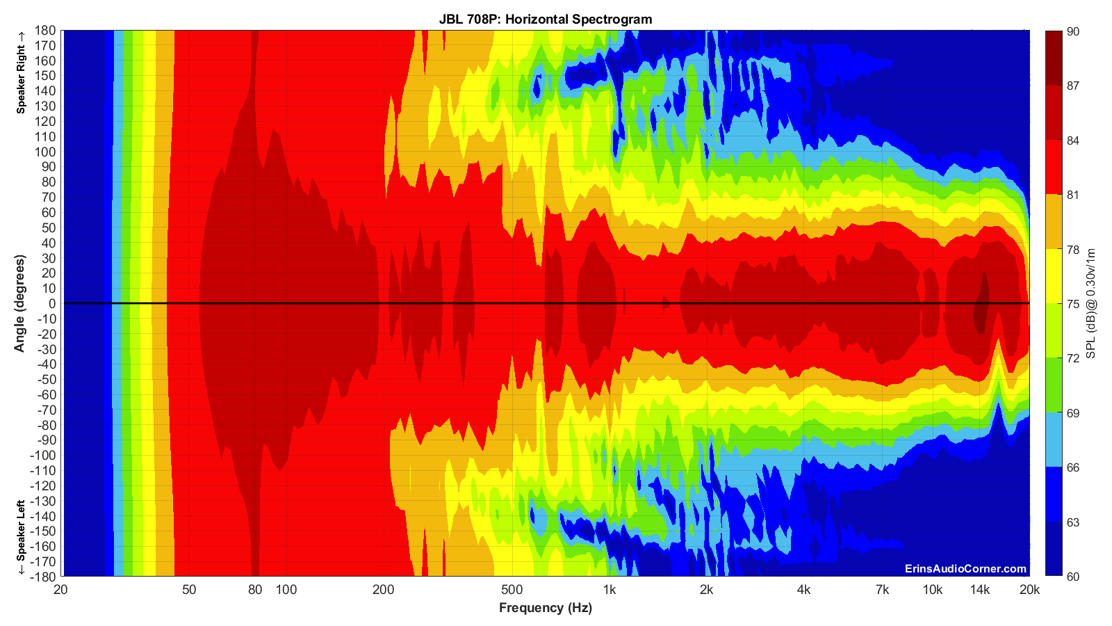

Trying to learn directivity matching between waveguide and woofer so I attempted to model a freestanding R-OSSE with similar directivity to JBL 708P. I used the same enclosure size as the 708P but I moved the woofer to the top. (ATH configs and VituixCAD project attached in Zip files)
The ERDI bump can be reduced by increasing center-to-center distance between the waveguide and woofer from -242 to -322 (comes at expense of reducing vertical polar listening angles by 5 degrees). JBL 708P crossover is listed as 1.7kHz. I used the same frequency with a LR24 but that can be adjusted to make improvements as well. I did not experiment with moving the waveguide on the Z axis. And I did not rotate the waveguide around the acoustic axis during simulation (ABEC.Polars Offset).
Horizontal Line
Horizonal Polars, non-normalized
Vertical Polars - non-normalized

![ABEC_Sim var8 XO-schema-8.png ABEC_Sim var8 XO-schema-8.png](https://www.diyaudio.com/community/data/attachments/1101/1101290-c618d7659b153e9a13f552bcbd9d41ea.jpg)

- I've added a new waveguide to my website (type 460-36):
http://www.at-horns.eu/athex.html
https://a360.co/3DlzDxv

Those are the full beamwidths, so probably twice as wide as you may think. They are not so wide (see the DI)...
BTW, as I implemented the SPDI and ERDI quantities of the CEA2034, I only now realized how much are these forgiving. They are heavily averaged and hence diffraction-insensitive. If these curves are not smooth, something really bad must be happening...
