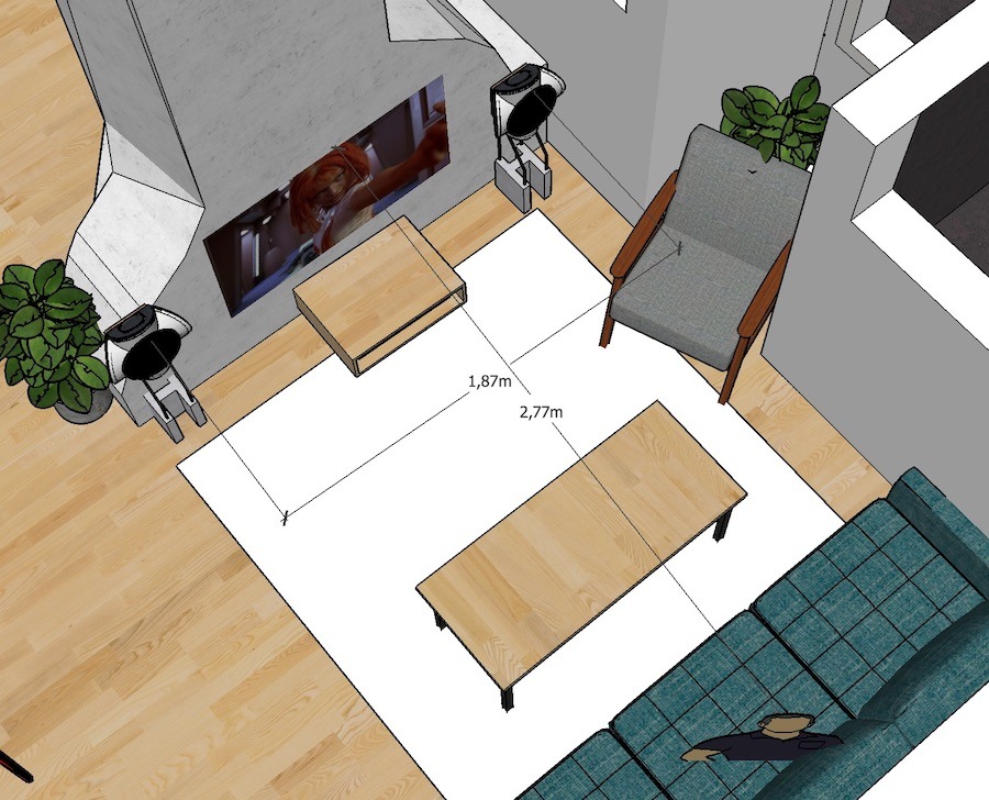

Btw - I find the ST260 still to narrow after have lived with a pair for a year. Can it be made to still be CD but wider?

TNT, if you want wider I suspect your listening triangle is too big, you listen "too far"? Nothing wrong with that, many people seem to prefer this, no toe in and all that.
Have you experimented with listening distance? if not I suggest take one day and try to find the transition point. You would then be sure which one you prefer and how to improve the system.
If it turns out you like the close enough sound better, which can have very big sound, then cure might be further narrow the response instead, if you must have far listening distance.
If the far distance is nice then optimize smooth DI, toe out to get wide stage, you might be better without much waveguide at all.
Just some thoughts

Nice, quite similar as mine, practical situation, sofa, rug, tv. Can't be to close to the tv.It's actually a quite small triangle - a bit pointy. Its a small place...
For such long listening distance, where distance from ear to speaker is ~3m, narrower coverage would possibly get the D/R ratio enough up to extend the good sound to sofa. Unfortunately distance between speakers is kind of limited to the fireplace? and you just cannot get optimal sound this way I think. For optimal sound its roughly equilateral triangle, wide, but not too wide to have hole in the center
Well, I'm on task to try and extend the distance to sofa, from 2.2m to perhaps 2.8m. I do not know how narrow coverage would need to be and at what frequency? Griesinger points out that ~1kHz region. Perhaps acoustic treatment is necessary.

Hi, yeah, either you need to be close and have about equilateral triangle for big image, or if you are at far you could have the speakers close together like you have now, closer than listening distance, but as you surmise you'd need to have wide coverage speakers and splash the side walls. This would create phantom center between speaker and wall. I think this is what many people strive for looking at pictures. But, to me this is inferior, the sound is huge but undefined. It is similarly huge with the close distance, with clarity and all that.It is like you are sitting in one of these boxes that fit 4 or 6 person on the opera. You sit and hear everything very detailed and proportionally well laid out - its just that it is like a doll house. You see a very nice replica of a real house with details and all but it is only 1 meter large and te frame where the music takes place is very obvious. Thats the best analogy I can give. Within this limited and clear frame, I also hear a very good reproduction of the acoustics of the hall so that interesting and nice but still I'm restrained by the size of "doll house" to really "be there".
This is for most recordings but I have had a few that was different.
Poor sound at side can be helped with time intensity trading. Have speakers heavily toed in ~45 deg angle. Now, at least with my cardioid mids, listening at side the closer speaker seems mute and sound is vlear due to highs from the opposing speaker, phantom center more or less between the speakers still. Again this needs about equilateral listening triangle to work for the main listening position. With wide coverage speakers the sound collapses to the nearest speaker.
Unfortunately your listening spot seems restricted (by reality), and perhaps omni speakers would work best. Clarity would happen only at very close listening distance, like now, but some other aspects that seem more important.
Power in all this is that you now know what the situation is and tailor the system towards better sound well, I do not know what the situation is but hopefully you do. I think finding the transition is very powerfull tool for this, you now know what is possible and what is not, what you like and so on
I know its not optimal and would like to hear these sitting on a wall without stands with quite some distance to side walls and in general a bigger like side triangle. I use actually a projector that sits under the table so no TV.Nice, quite similar as mine, practical situation, sofa, rug, tv. Can't be to close to the tv.
