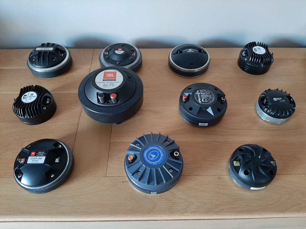

Attached are some parts of a comparison between eleven 1" compression drivers. The same horn (Dayton H812) was used for all measurements.
Intentionally, I left out the harmonic distortion plots 😉
Judge for yourself whether the differences are significant.

So, do you think you wound reliably recognize all those drivers just by their sound? Based on my experience, if the drivers were at least roughly equalized, I don't believe I could.

I would just at a guess suggest that no two of these drivers share the same exit angle and I would also guess that none of them are a match to the horn you chose. Given this is it a wonder there are differences. You measurements really don't prove much except that the best measurement is likely the closest match between exit angle of driver to the horn or at the least a best working or complimentary match.
From what I've seen, only a few take the full measures (and measurements) to equalize the samples to the "same" frequency response for the listening comparison. Remember that a 1 dB SPL (or even less) can make a major difference. When fairly equalized it can be really tough task. I'm not saying there are no audible differences among all CDs, only that is takes a lot of work to do it correctly, which is often not properly done, to be honest.
I agree with you completely, but for others I may have to repeat the results of our test yet again.
We compared two identical speakers with different driver sets both EQ'd by my algorithm to be the same. Among some 30 subjects, in a blind test, there was no statistically significant differences found. The drivers were a $3500+ set of TADs (great looking drivers) and $350 set of B&C. While there were no "significant" differences, the B&C had a slight edge. I stopped buying expensive drivers at that point.
"Recognize" is a big word in this case. I am quite certain some drivers would stand out, others not so much.
Evidently, the horn used for this test isn't the best match to every driver. Some of these drivers do no lend themselves to a low crossover point, eg. the RCF. Some lack output in the top octave. Finally, diaphragm materials and shapes are definitely a major contributing factor to sound signature imho.
In case you didn't realize it yet, this test was not mine. Why would I buy or otherwise collect eleven 1" drivers, when I already own one of the best (Beyma CP380M), as well as some B&C and BMS 1" drivers?
