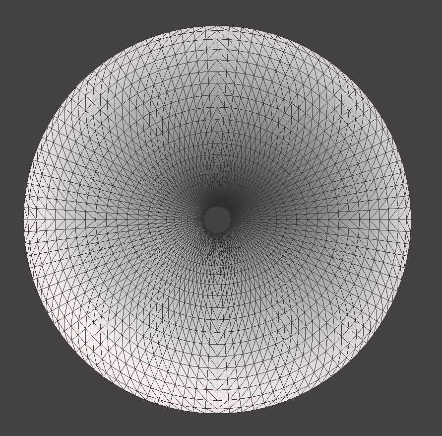

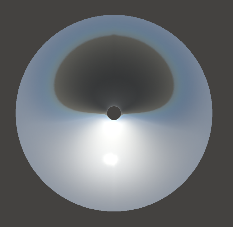

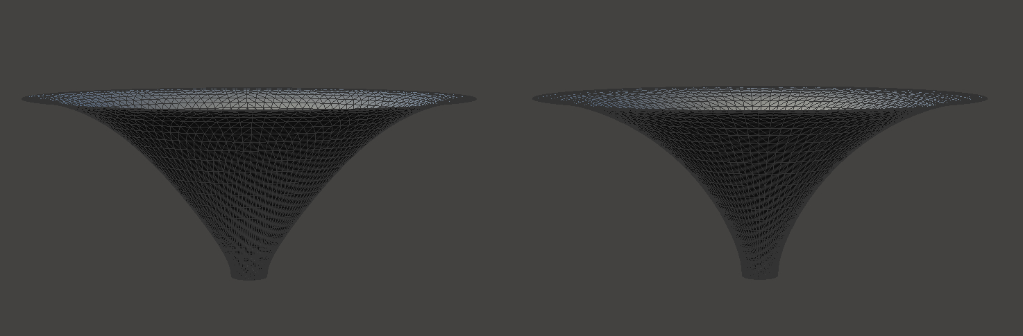

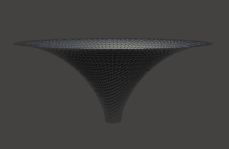

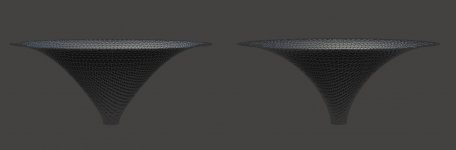

I think this will be my next waveguide. It is 19" across for a 1.5" throat and I want to go unbaffled this time, with an open baffle woofer. ![scratch2 :scratch2: :scratch2:](https://files.diyaudio.com/forums/images/smilies/scratch2.gif)

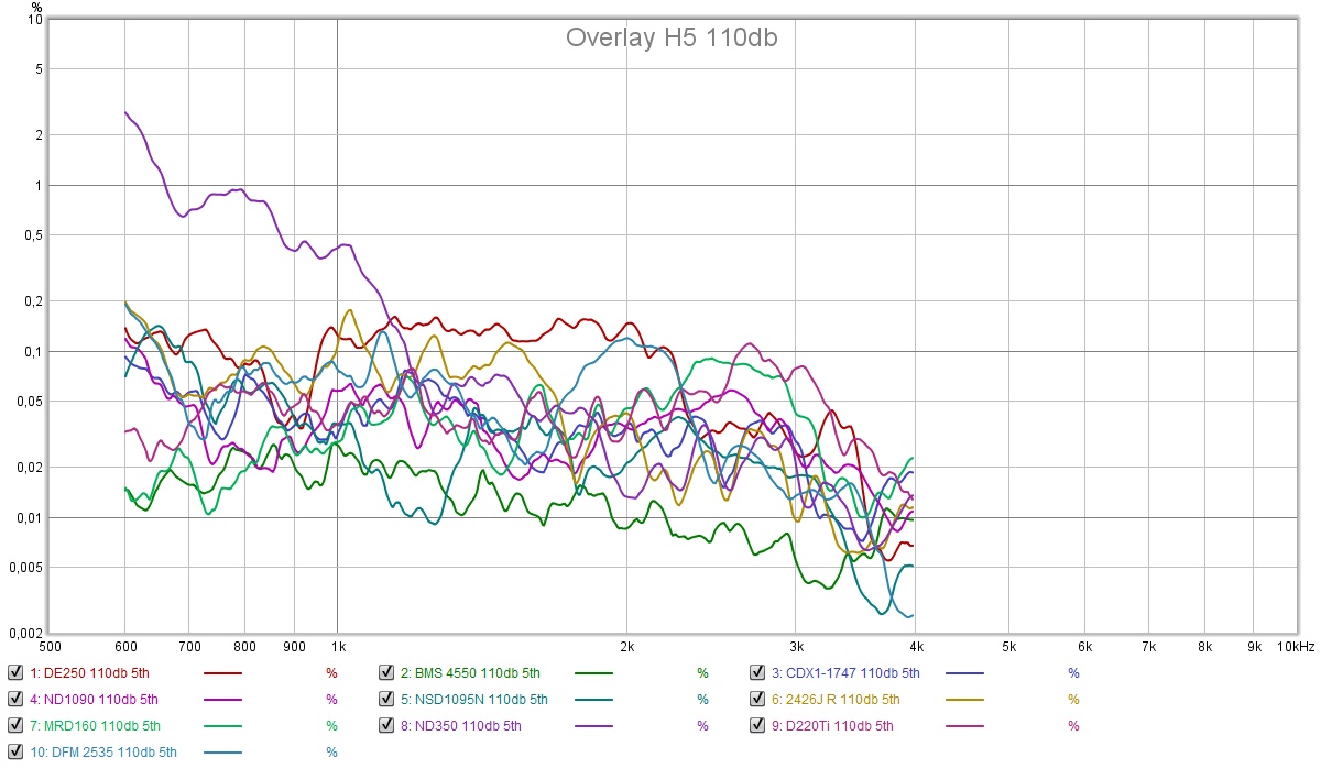

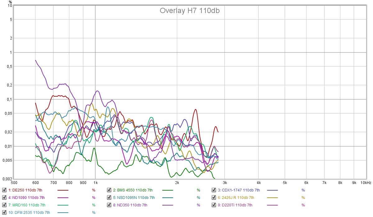

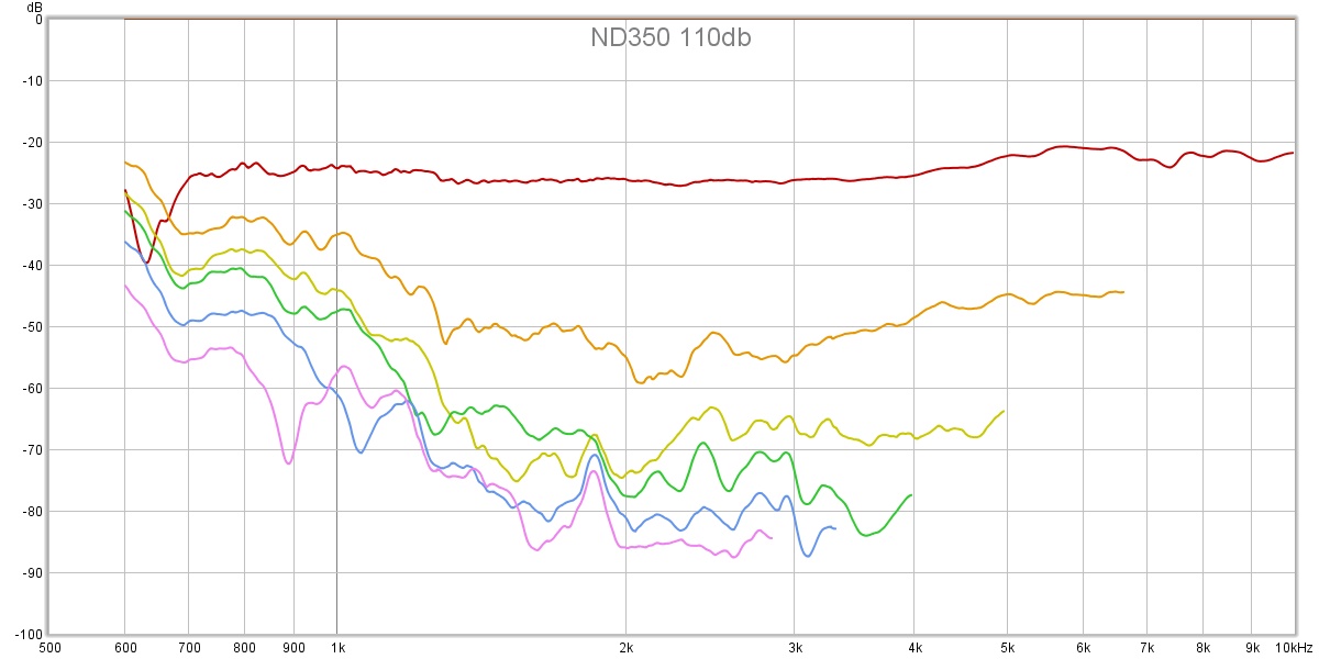

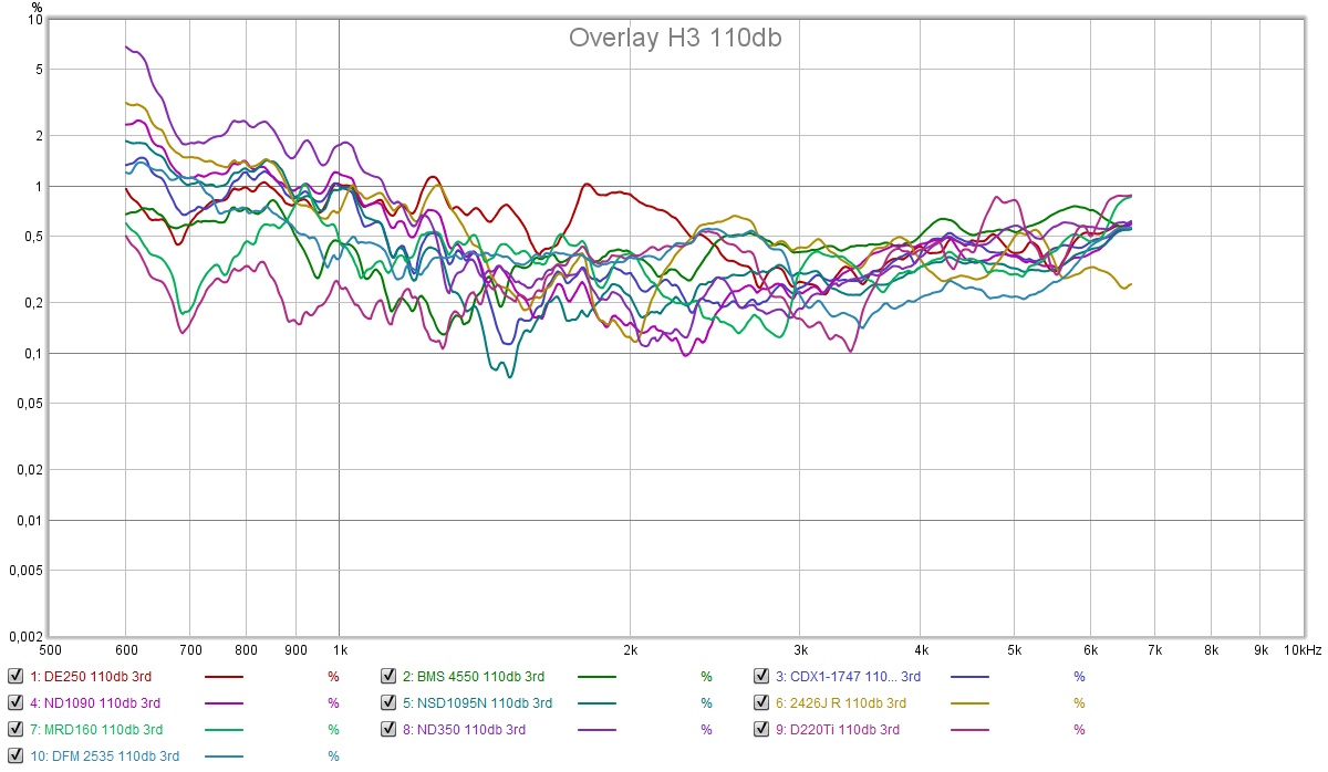

To finish the discussion on drivers, attached is the distortion plot of the ND350 at 110dB/1m and the overlays of the odd harmonics from all the drivers that were tested at the same level (probably difficult to read).
Translated to 4-6m at the listening spot, this is not an extremely high output level.
The ND350 is one of the best drivers in the test, provided it's not used below 1500Hz.
Comment of the guy who carried out the test:
"If we are interested in a low cut the RCF ND350 is out of the race at high level, on the other hand if we connect to> 1500Hz it is one of the best. The JBL is not comfortable either down there.
On the contrary in the low frequencies the D220Ti dominates the others even if it is much more arbitrary on the rest of the band.
The BMS 4550 also behaves very well at the bottom and is the one with the lowest upper harmonics." (I own this driver as well).

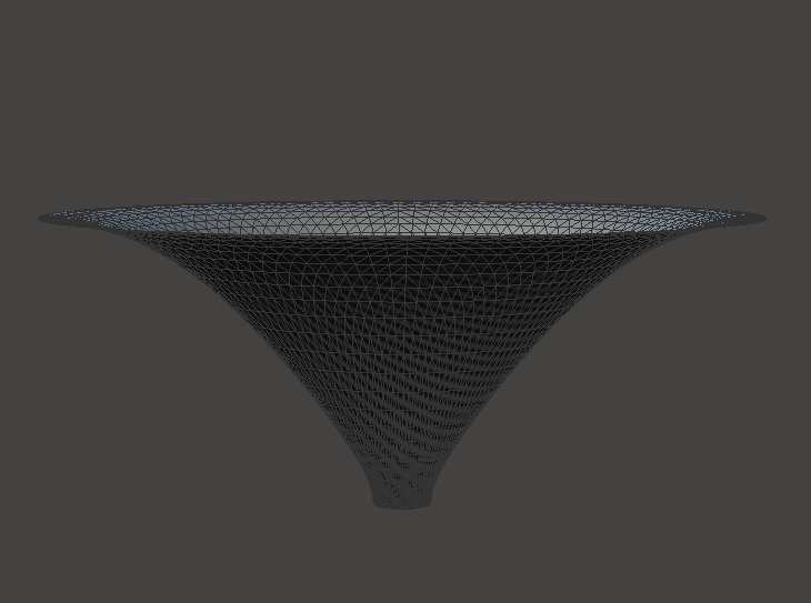

I think this will be my next waveguide. It is 19" across for a 1.5" throat and I want to go unbaffled this time, with an open baffle woofer.![]()
Unbaffled as in "free standing"?
Planned crossover ±800Hz?
I might join you, because it is easier to make (using a lathe) than a rectangular WG.
Yep, I just couldn't stand so big enclosure. I don't know yet, but I expect the crossover to be lower than that. That depends on how the woofer radiation pattern will turn out. I'm only beginning to make sketches. For five (or more?) years I haven't touched the microphone...
Hold on, this is NOT axisymmetric. I also want to make it myself but not on a lathe...I might join you, because it is easier to make (using a lathe) than a rectangular WG.
This WG wil fit on top of my cabs almost perfectly.
I could still "suffer" a few cm extra mouth Ø.
The mic will be dusty by now
My mistake!
I just glanced at the fist pic briefly on my phone and missed the differences between H and V.

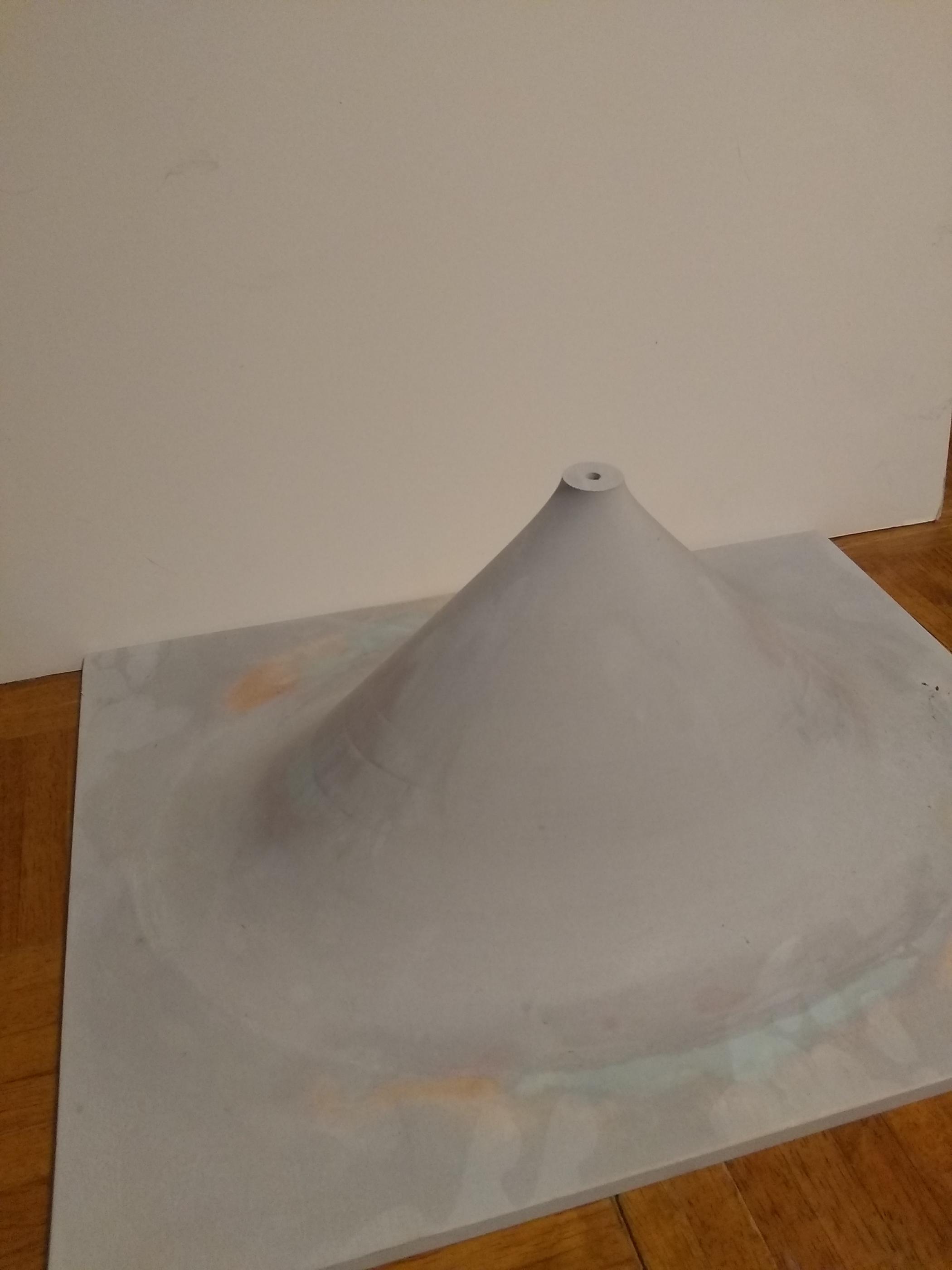

I have a mold of almost that exact waveguide, but it is 1" (smaller drivers work better as you said yourself.) I would let you have it for the shipping cost and the credit. It's not a simple shape to make, cost me >$1000 to have this mold made on a CNC.

Really? Now I get curious - was it ever used in your speakers? Wasn't it superior to OSWG, or what is the history of it? Would seem like a fine piece of waveguide.I have a mold of almost that exact waveguide, ...
Of course it would be a great pleasure for me to have it from you. What is your estimate of the shipping cost?I would let you have it for the shipping cost and the credit. It's not a simple shape to make, cost me >$1000 to have this mold made on a CNC.
I had it made with the intention of trying it out, but as I proceeded I found that it just didn't make any sense commercially, so there it sits.
As you see it is elliptical with a full OS contour all the way around. I am not sure what the initial angle is however. It would need a back mold made, but these can just be roughed out. It is made of polyurethane boards and can't talk a lot of heat, so fiberglass might not be a great idea. Casting with polyurethane was never a problem, but it hardly generates any heat. It needs to be sealed well or you may have problems with sticking on the first pull.
The board is 20 inches by 15 inches. Throat 1 inch.
I actually have no idea what shipping would cost, but at this point it isn't possible anyways. E-mail me offline when this all clears and we will see what we can do.
