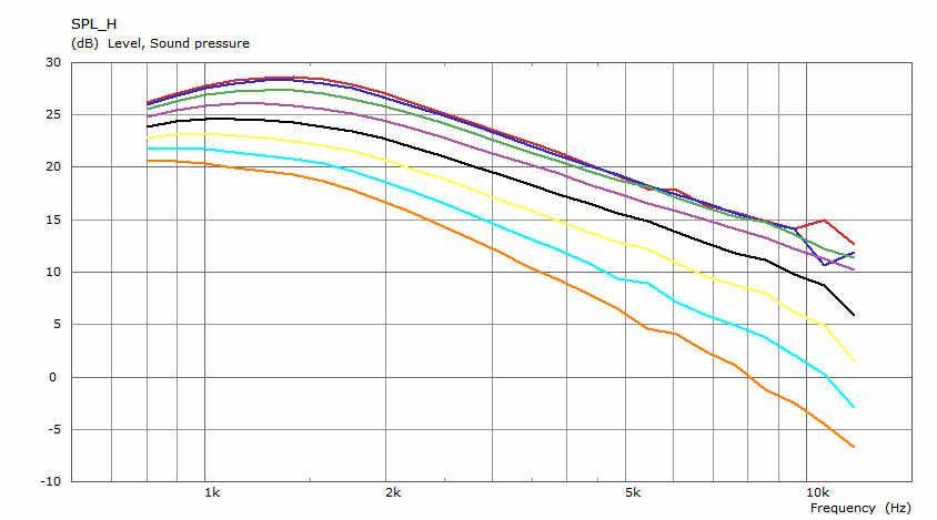

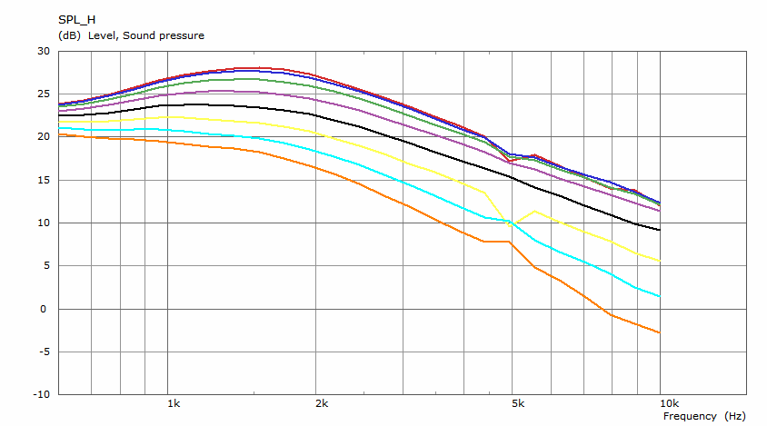

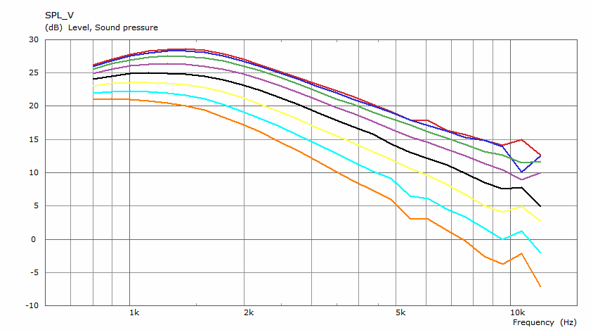

If the mouth is elliptical then it is different to what I have. Seems to me that left like that it always tends to narrow in the midrange. Maybe not so much in this case, it's hard to judge based on a photo.... As you see it is elliptical with a full OS contour all the way around. ...
What I tried with the last waveguide was to stretch the ellipse to a circle at the mouth again. Which lead to a slightly higher vertical beaming since the vertical profile is not OS anymore (it gradually diverges from that in a nonlinear manner) but the overall smoothnes of the polars is now excellent.
I also like the circular mouth better by purely aesthetics reasons.

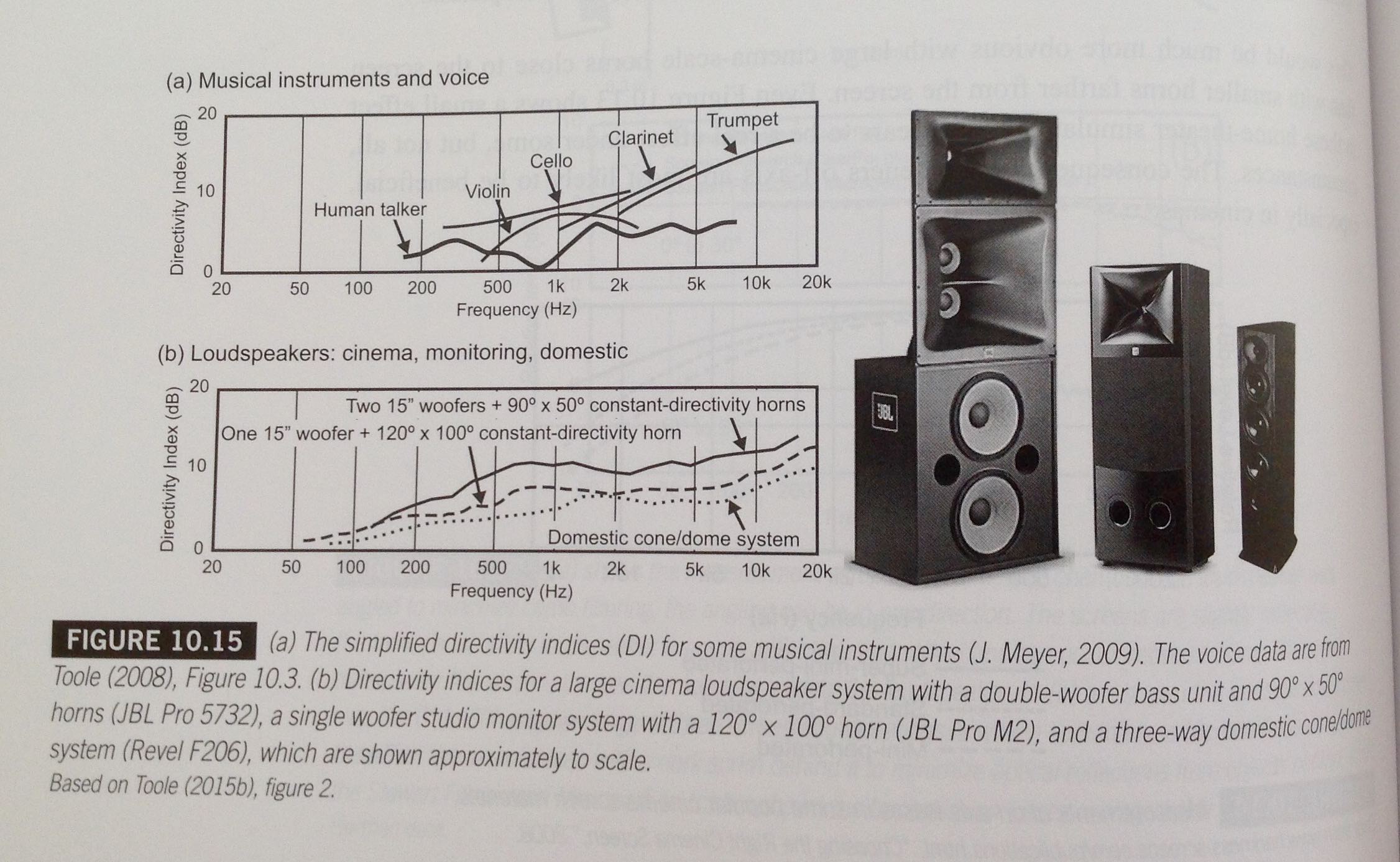

I still don't understand how can they claim that. They are crossing a 15" around 800 Hz and keep the DI about constant from that point - how can it be close to "cone and dome" speakers?Floyd Toole said:The M2 uses a 120 x 100 deg horn, which is close to the DI of cone and dome speakers (see Figure 10.15 in the 3rd edition of my book). ...

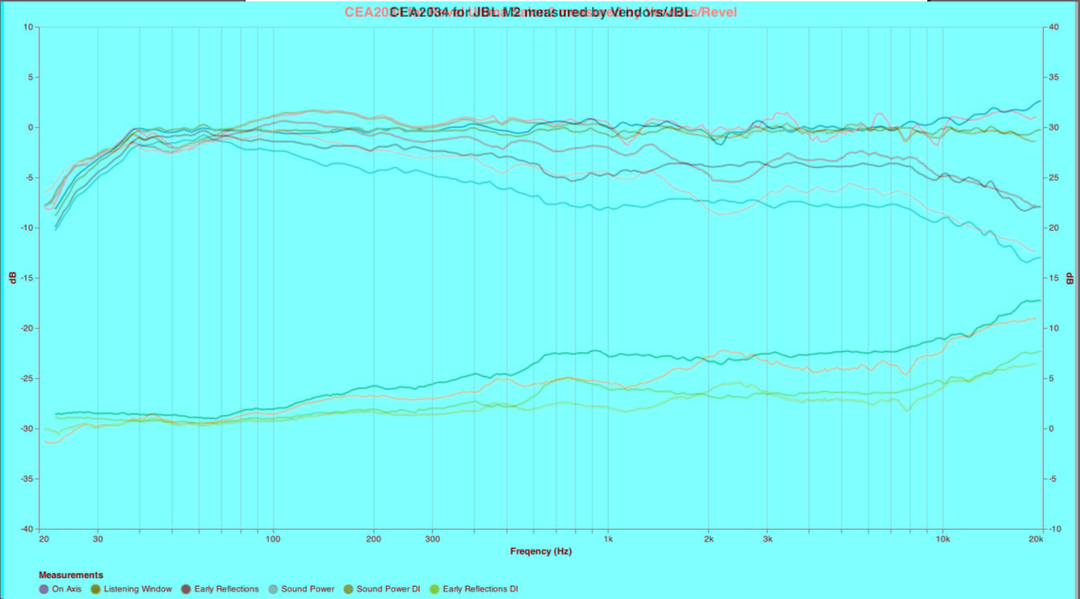

Here's the directivity index for the JBL M2
Here's the directivity index for the Revel Ultima Salon
Their measurements are surprisingly close, considering how different they are.
I've listened to JBL back-to-back with Revel, and if you put a blindfold on me it would be challenging to tell which is which. At very high SPLs, the JBL will exceed the Revel, but tonally they're surprisingly similar.
Patrick
Thanks, now it is clearer to me what is going on there. For the M2 the DI is really a bit lower (the flat part, around 7.5 dB) than, say, Earl's speakers (which have about 9 dB?) in exchange for it not being so gradual under 1 kHz. Would be interesting to see their woofer alone.
Still, it is higher than Revels, which is (surprisingly) not as even in the midrange as I would have thought. Thanks for those plots.

I don't think I am missing the point, since I am the one who raised the point: "Toole would probably* also say that compression drivers and larger-than-standard-dome-tweeter-guide waveguides are absolutely unnecessary in home audio, in that they make no difference worth noting."You may be missing the point:
As you can see above, it is very much "about CDs per se", specifically, are they unnecessary in home audio. The answer appears to be yes, if Toole himself eschews them, and he publishes graphs showing similar DI progressions achievable from conventional speakers that are readily available.This is not about CDs per se but about the DI values desired in the design and why.

I overlayed the JBL M2 and the Revel Salon Ultima2 in one graph.
One thing I notice, is that the M2 has *significantly* narrower beamwidth in the midrange.
I wonder if this might be contributing to people's preference for the Salon?
IE, the M2 waveguide has a beamwidth of 120x100, which is quite wide. But the xover point is 700Hz, and the gap between the midbass and the waveguide is about one half of a wavelength. At that spacing, you're going to be stuck with a vertical beamwidth of about seventy degrees, at the most.
So I wonder if the pattern flip that's caused by the large distance between midbass and waveguide may be causing issues?
Some have said that they prefer the sound of the cheaper JBL monitors, and perhaps that preference is because they won't suffer from pattern flip as much, because the center-to-center spacing is much tighter.
Note that in the midrange of the JBL M2, there's a widening gap between the early reflections and the on-axis output, in the midrange. This is probably caused by the center-to-center gap at the xover point.

OK, now back to earth. I've tried a pure OS made from the horizontal profile of the last waveguide shown and it's basically the same.
Hey, I've basically ended up with the OS waveguide!![wizard :wiz: :wiz:](https://files.diyaudio.com/forums/images/smilies/wizard.gif)
The size and the mouth termination matter. That's all, folks.
