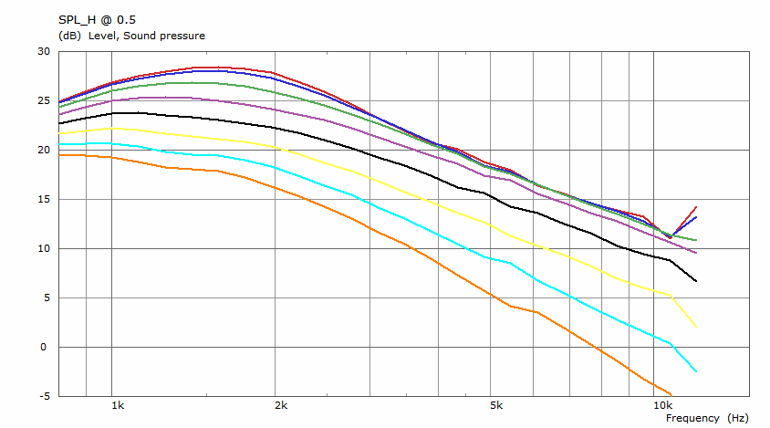

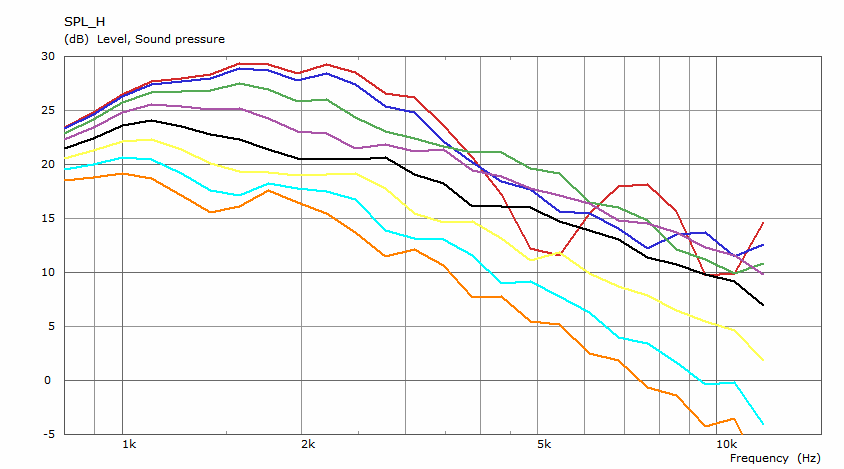

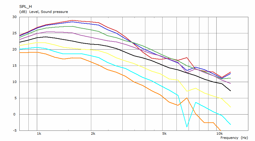

This is for s = 0, 0.25 and 0.5 (0.7 was shown already).
(See the influence of s here - just use the slider).
