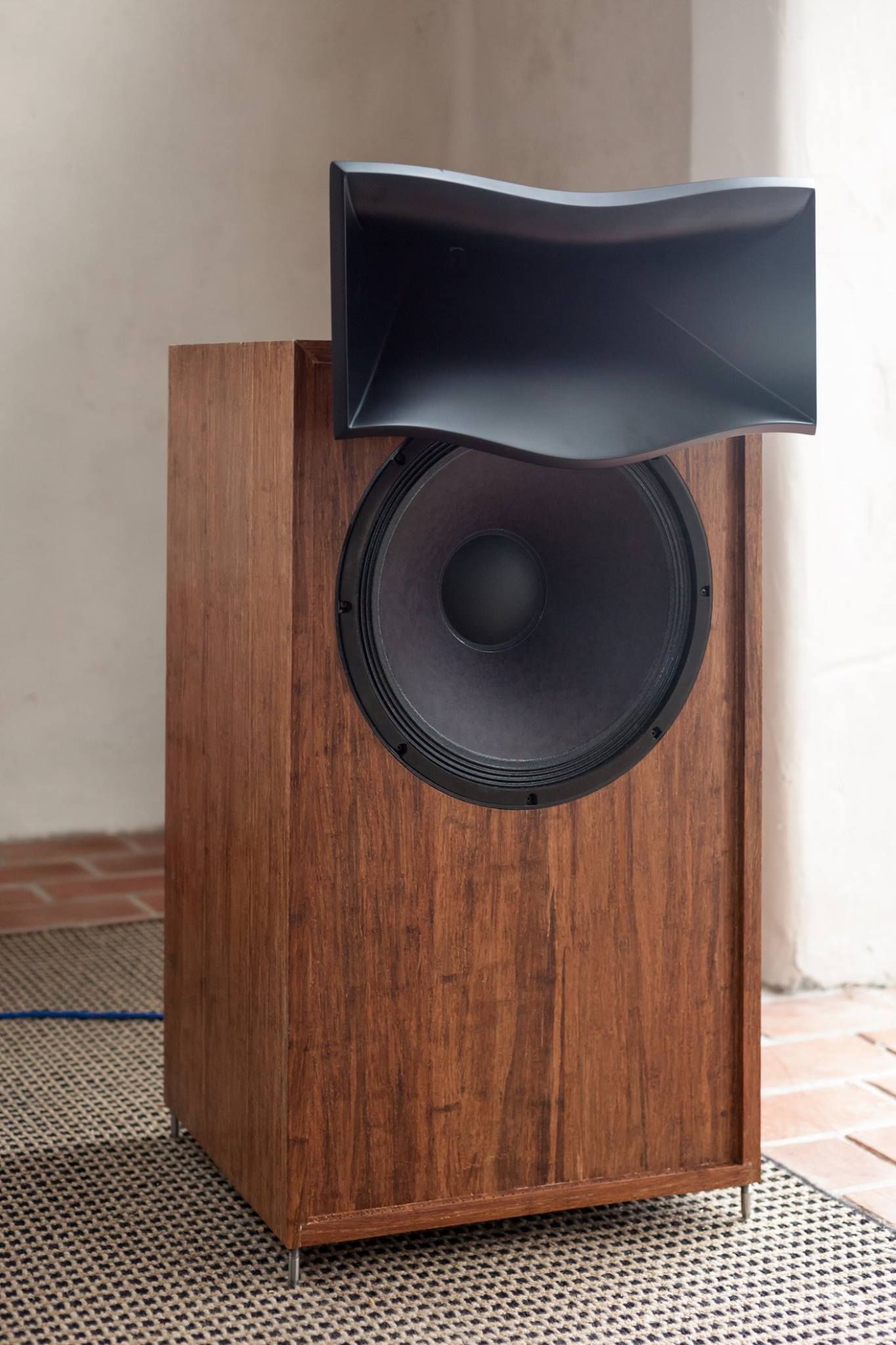

Did you ever consider to push the woofer closer to the horn axis, just let it take a small "bite" out of the mouth?
The relationship between the distance between the axes and the bite area is non linear- the bite area increases approximately quadratically as the axis separation falls linearly so obviously can't be pushed too far.
But it seems a small bite would have minimal impact on the horn polar yet improve the vertical combined polar.
Once you approach a crossover at 500 Hz (wavelength = 27.12"), C-C spacing becomes less of a problem.
Additionally, I don't think it would hurt to let a free-standing waveguide hang over the top woofer edge, like this:

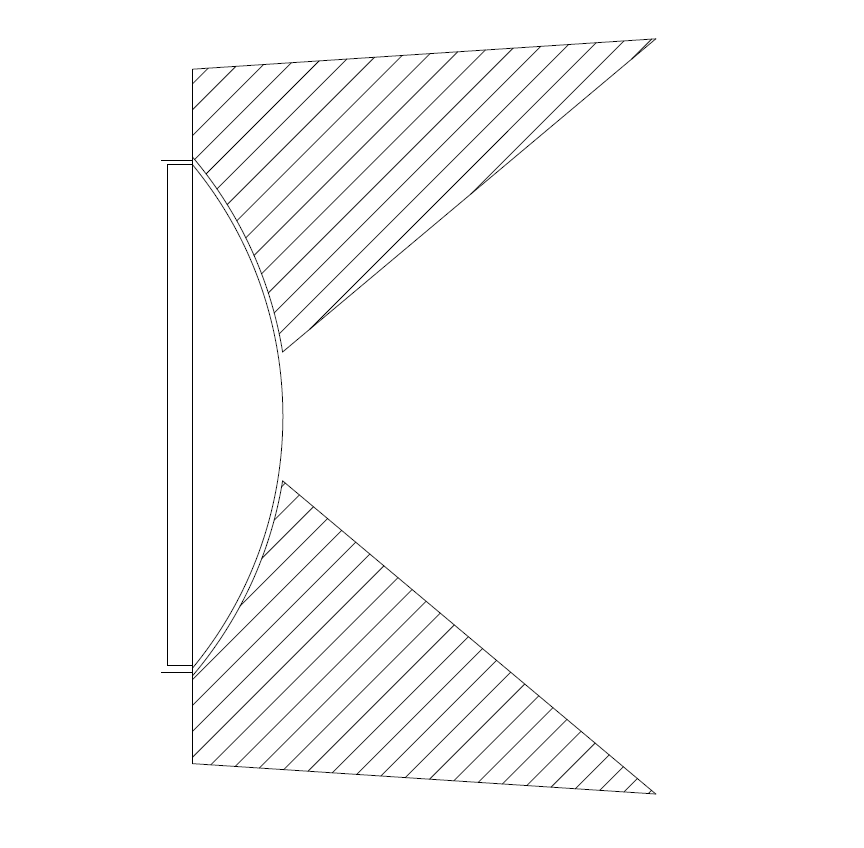

Just thinking aloud, couldn't this work reasonably well?
A compression driver on the left (open back side), conical waveguide on the right. An OS throat could be used instead to better match the actual curvature of the diaphragm.
Ro808: From the photo I would think there will be much more serious problems than the driver spacing in that case.

Looks like a Dali horn, not the Danish company but Salvador😉
The style you show looks sub optimal to me.
I have always expected there would be interference and reflections.
But I must admit I have never seen it actually measured, anyone have any data?
I planned to blend the horn into the front baffle, not so dissimilar to Earl's Summa.
Or many others with excellent measured performance, Genelec and so on.

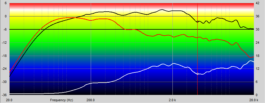

Marcel did you mean to keep it axisymmetric but add an extended transition curve?
Plainly, it seems to me that it should be possible to make an 18" axisymmetric waveguide (as in NS15) without the axial hole(s). I even think I have already shown that. I considered that settled.
In fact, it it possible for any waveguide size without a significant harm to the pattern control - if not improving it actually. But you won't achieve that by adding a simple radius to the end of the waveguide. At least I think this is clear from the analysis made so far. There simply don't have to be any axial holes (i.e. mouth reflections) in any waveguide.

I would disagree here because it is possible to make the axial hole go away with a mouth radius only. The hole results from diffraction of the mouth and as the mouth radius is increased this diffraction will decrease and the hole becomes negligible. The NS-15 does not actually have an axial hole, nothing pronounce at any rate - its mouth radius is much larger than the Abbey, which has a much more pronounced axial hole.
In a small device it is not possible to do a large radius so smaller devices tend towards an axial hole if they are axisymmetric.
That is certainly true. My point was that if you have a waveguide still showing something like an resemblance of an axial hole, it could be most probably improved without increasing the overall size just by replacing the radius by a more gradual flare. And that this would also lead to even more consistent polar response.
Maybe it's not such a problem but it's still about 5 dB on axis. Could still be improved to negligibility, IMO.

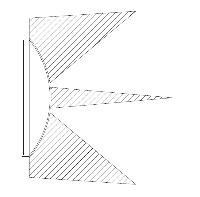

That's basically a regular compression driver without a phase plug, no?
As for this experiment with the convex side of the diaphragm, my whole reasoning was that it must be easier to get a spherical wavefront from that side than from the concave one (via phase plug and OS throat). I think I will at least give it a try in the simulator to see what I can get. Just in case someone wrote that it's completely silly and why, I would save some effort.
