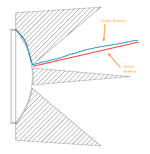

As for this experiment with the convex side of the diaphragm, my whole reasoning was that it must be easier to get a spherical wavefront from that side than from the concave one (via phase plug and OS throat). I think I will at least give it a try in the simulator to see what I can get. Just in case someone wrote that it's completely silly and why, I would save some effort.
Well, the further parts of the diaphragm will be out of phase with the center since the sound has further to travel. You'll get cancellation as wavelengths get shorter and more out of phase.
Hmm.. Are you sure it works like that?
Yes

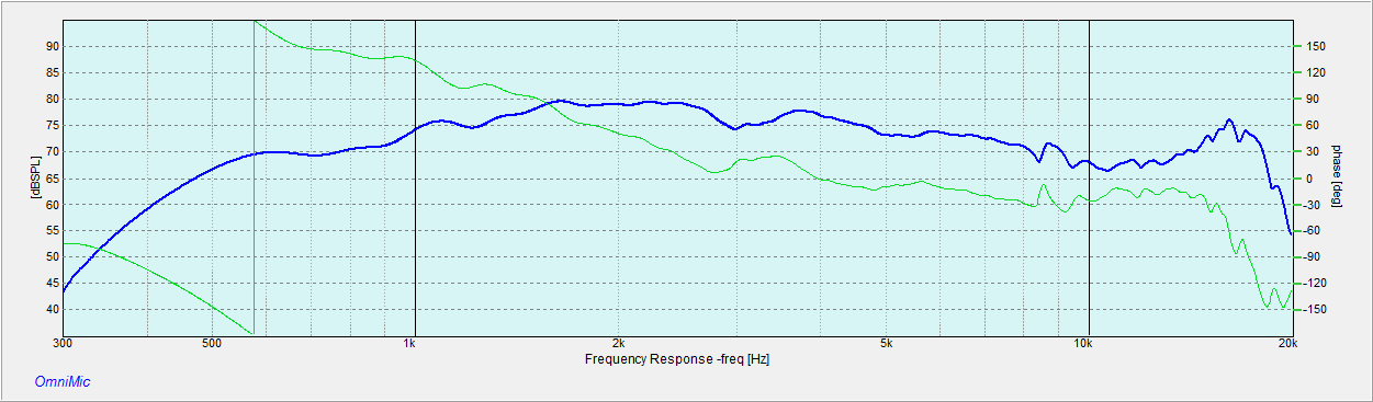

For years I'd wondered why the QSC waveguides performed the way that they do. They don't have an on-axis dip.
Your post explains it : their round waveguide is almost all roundover. The conical part of the waveguide is about 30% of it.

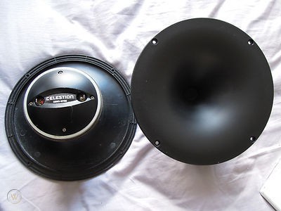

I have a pile of these that I've been unable to sell, but it also feels kinda tragic to dump such a nice waveguide.

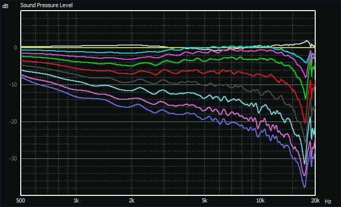

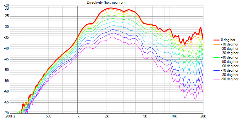

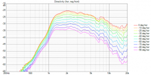

... Do you have examples of a waveguide whose DI drops in a "smooth" way. That's not how I remember things.
Would you consider this as a smooth enough transition? This is a waveguide of about the size of your Abbeys (12" woofer). The axial problems are also vitually gone (the graph is for 0 - 120 deg / 10). I would put this as my piece of evidence for all the points just mentioned. As for the curve C, I don't know if it is any special but a segment of an Euler spiral (or the curve corresponding to my waveguide formula) works very well as the remedy for most of the problems as you can see.
I must admit I'm a bit surprised now as I have really considered this as settled facts.

Again, this is what hapens if you change the mouth round-over from abrupt to gradual for one particular axisymmetric OS waveguide - I don't know whether the hole is eliminated, went away or diminished to neglibility, but for the best transition it is just not there anymore.

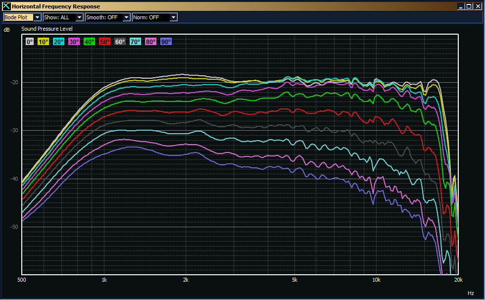

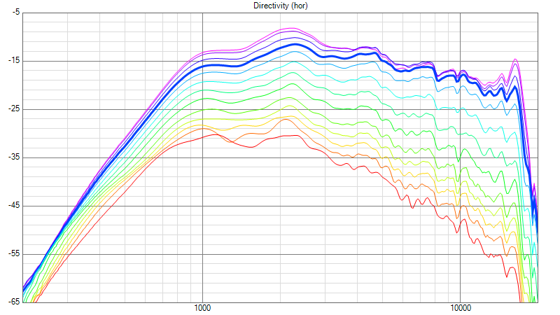

Same measured data as above, EQed for a flat response and normalized to 10 deg. This is still what I would consider a small wavegiude today (and actually the first one that was tried doing it right). Think of what can be done with an 18"! :)

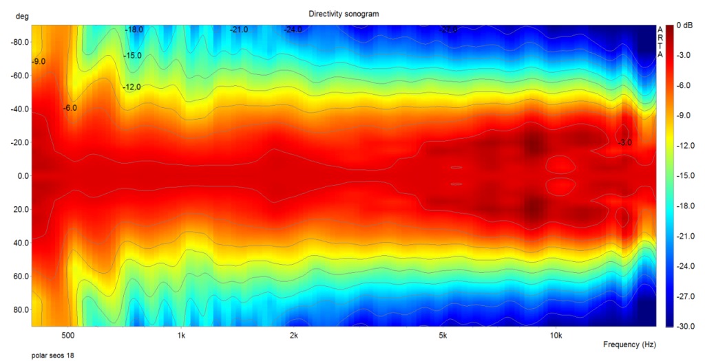

For comparison, some plots by BWaslo of the Denovo BA-750 + SEOS 18.
The SEOS' depth is only 15cm, the rectangular mouth is undersized and there's a considerable throat angle mismatch between the BA-750 and the wg, which partly explains the ripple.
Nevertheless, it doesn't look too bad
Apart from a few resonances, the BA-750 doesn't look too shabby either.

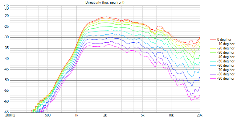

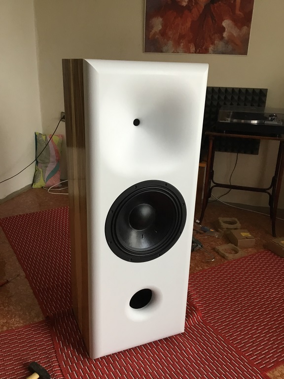

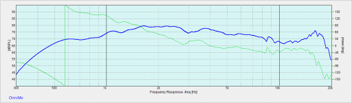

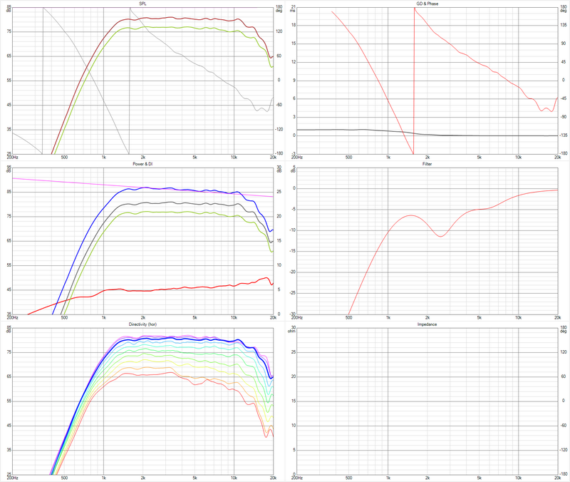

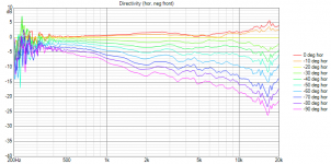

There has been some more results of even smaller waveguides during the recent months, based on my tools - these are some of them from a local Czech forum.
All of it behaves quite well, I'd say.
So it's not completely true that there hasn't been verifications of my work, only the biggest ones are still missing. Basically, today there's really not much to improve on the waveguides alone.
