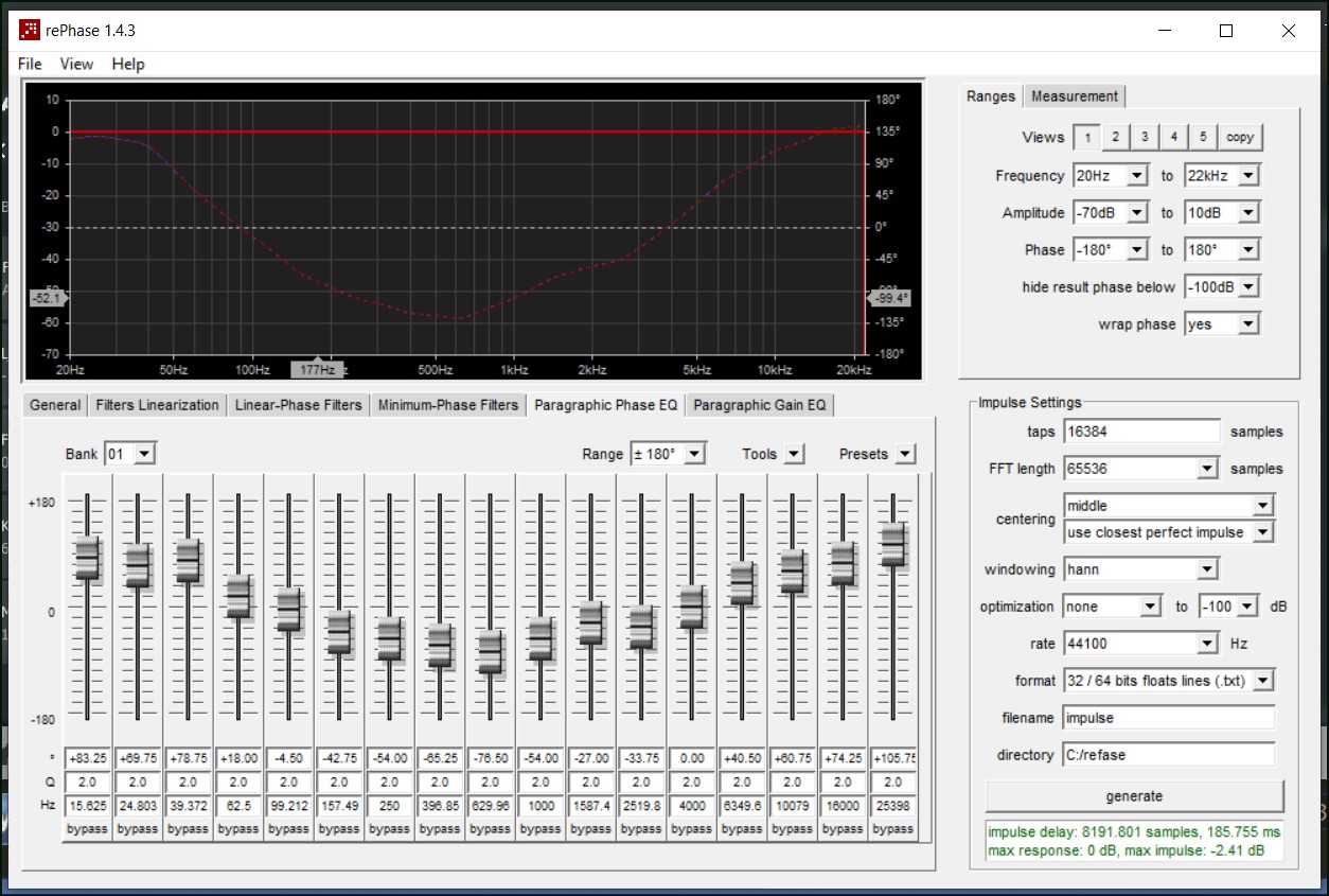

Has anyone tested our audibility of phase shift by itself with an all pass filter at different filter settings? I guess there would be some kind of threshold of audibility.
Plas, like this? I'm new to FIR but will test it later on, the bad thing, the memory flip is 2 sec silence on OpenDRC-DA8.
The best i think is to record the signal 2 times and flip between the same song.
