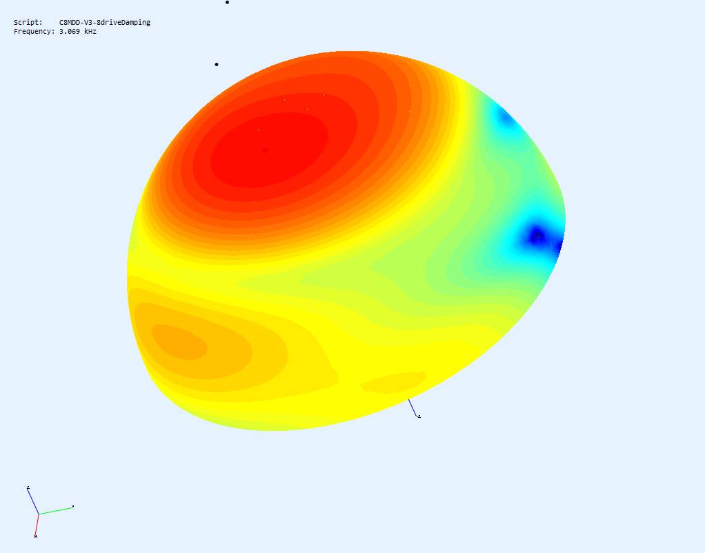

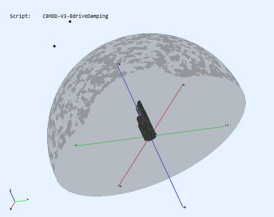

Starting from the acoustic side which is where @fluid started.
The pic below shows a speaker inside an observation hemisphere showing the SPL at all points on the hemisphere surface. Acoustic power is proportional to SPL^2 so if we integrated the SPL^2 over the surface we'll get total power. There is no need for phase or direction we just need SPL magnitude. This procedure would need to be done for every frequency of interest. To approximate we could sample surface points and sum the power (assuming its constant over some small surface area). This should also show power dips.

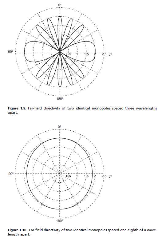

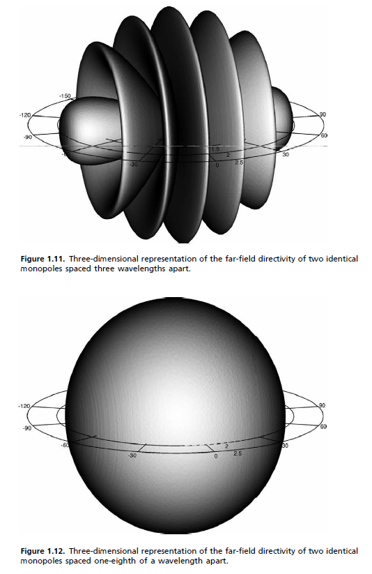

Before jumping to the LR4 crossover, let’s look at the simpler example of two full-range point sources spaced 1/2 meter apart.
This will help illustrate how the terms correlated and uncorrelated relate to power response.

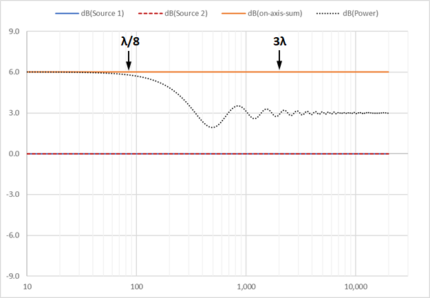

Attachment #1: With two +0dB sources, summation on-axis gives you the expected +6dB. However, looking at the power response, you can see that although the total radiated acoustic power increased by +6dB at low frequency it drops to +3dB at higher frequencies. Why is this?
Attachment #2 & 3: If you look at the 2D and 3D representations of the polar response for 1/8 wavelength and 3 wavelength for the source separation distance things should start to “click”. At low frequencies, the phase difference between the sources is negligible for all locations on the sphere; you could say the source are correlated. At high frequencies, the phase difference between the sources varies dramatically from location to location on the sphere resulting in lobing; you could say the sources are uncorrelated. The higher in frequency you go, the more variation in phase between sources there is for a given movement on the sphere. In other words, the sources are becoming more uncorrelated and the total radiated acoustic power asymptotically approaches +3dB. This power response curve is what you would measure with an RTA if you placed these 2 sources in a perfectly reflective room.
With this example as a foundation, I’ll post similar plots and explanations for the LR4 crossover after lunch.

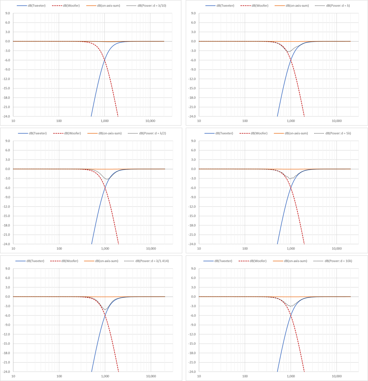

When the two sources are not full range but rather tweeter/woofer with associated HP/LP crossovers, the lobing behavior leading to a -3dB drop in power response only happens in the crossover range where both sources have similar output magnitudes. As shown in the previous post, the lobing also only happens if there is significant difference in phase between the two sources as you move around the sphere. With LR4 crossovers, the tweeter and woofer are in phase throughout the crossover range. So, the only possibility of phase differences occurs from the separation distance between them.
If the separation distance is kept < λ/10 at the crossover frequency, there will be minimal dip in the power response. The attachment summarizes the power response for a range of separations distances “d” for a 1kHz LR4 crossover between two ideal point sources. As soon as you start dealing with real size woofers and tweeters, their inherent directivity will generally cause more droop in the power response than what you get due to the level of phase correlation between the spaced drivers. All that to say, in my experience it is more of a theoretical issue than a real world problem.
