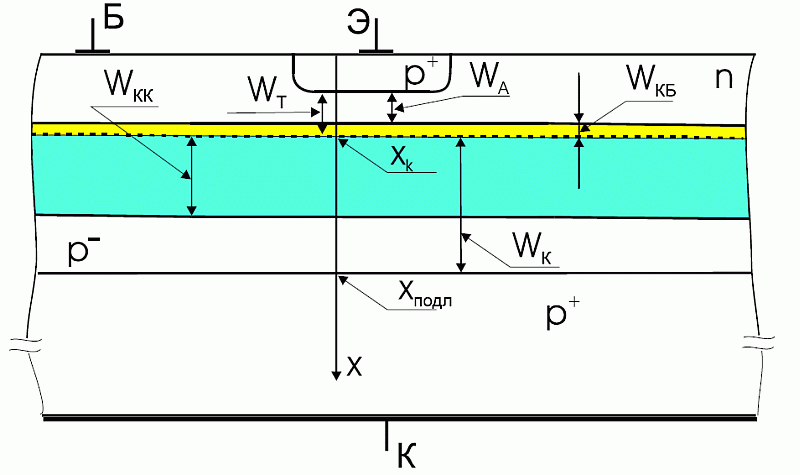

Not really; Cob is defined by the collector side (lightly doped) not by the base region. The big conflict is between Beta and rbb. The solution is very high base doping and a very thin metalurgical base, with extremely well controled impurity profiles. That's why all these Sanyo devices are using ion implanted base regions. By diffusion only you can get something like the MJE15030. Low rbb (also very good for secondary breakdown) and low beta (under 100).
I'm suspecting Hitachi is using the same type of base ion implanted process, otherwise I can't imagine how to get a beta of 400 and rbb of a few ohms.

Add "conflict" to the above list. Here, it means it's difficult to manufacture devices with both high beta and low rbb, rather impossible with standard diffusion processes.
