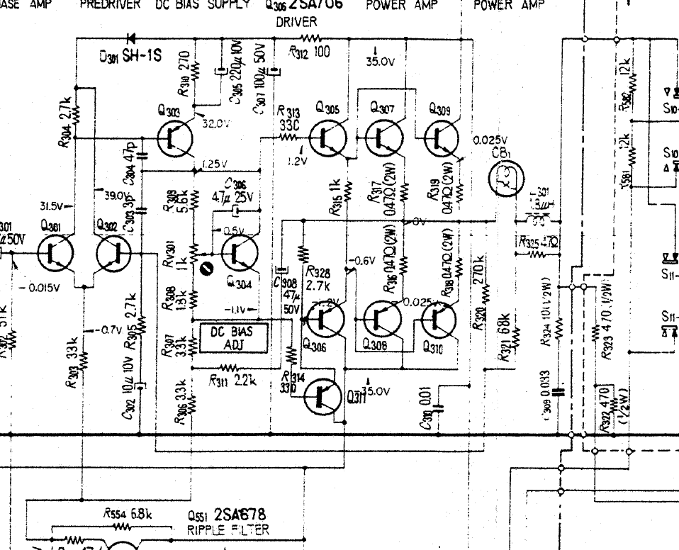

As per the service manual, the target is 25mv and the left channel bias was pretty close. The right channel was nearly 60mv so I attempted to adjust that channel's bias pot.
As I rotated the pot, both 1.6A fuses blew and I noticed the telltale odor of an overheated component. Even now, I fail to see anything that shows heat damage.

So those voltage readings show lots of current flow in the output stage.

So just now, I removed the 3 remaining right channel output transistors. Q410 is still out of circuit as it has been since I jump wired the bases of Q405 and Q411. Q405 and Q411 are still jump wired.
So the transistors I just removed ar Q407, Q408 and Q409.
I dispensed with the component tester to usie a DMM in diode mode and followed 5 steps....B to E, B to C, E to B, C to B and C to E.
What the DMM displayed made me question if it was functiong properly which was 0.0 readings in all 5 steps for Q407, 408. & 409, To see if the DMM was functional, I checked the transistor from Q410 and saw voltage readings where they were supposed to readings and OL where it was supposed to be.
With all right channel output transistors removed, I used full power from the variac and DBT stayed dark. I left it powered up for 20 minutes and it remained dark. I thought that might be significant because with 3 right channel output transistors in circuit, DBT was a dull orange glow then suddenly went full on bright after a few minutes.
Presumably that transistion from dull orange to full bright was the result of an output transistor failing? Those were fresh new transistors not long ago.
And should I continue with the jumper wire from Q405 base to Q411 base?

Lets look logically and critically at that.
DBT dark shows minimal current flow which is what we want. So all good there.
The DBT glowing with three of the output transistors removed needs investigating. If we look at the circuit we can see removing any three of the four output devices removes either an upper or lower pair completely and leaves either a single NPN or PNP in place.
With just one transistor fitted there is no low impedance path current could flow in. A short in the output line (the line from CB1 or CB2 current breakers) to the speaker socket would be one possible route.
I thought I should clarify. The DBT glow I referred to was with 3 of the 4 output transistors in place, not removed. At that time, there was one output transistor removed - Q410.
That was done as instructed in post #109.
The "one transistor" I referred to was removed, not left in place. I have not attempted turning on power with just one only output transistor.

All I can offer for thr one transistor I removed (an NPN) is that C to E reads OL. If helpful, reversing the leads, to E to C also reads OL.It would help to know if they really are failing though. The one you removed and that stopped the DBT lighting... does it read short circuit or very leaky from C to E?

First thing that stands out is the OL or 'open' from C to E meaning they have not failed short circuit and that is the most common failure mode for any power transistor.
Those look fine. The 0.5 result is the meter displaying the forward volt drop across the junctions B/E and B/C junctions which read like a diode. So all good there. The red lead would be on the base for that with a NPN device. So E to B and C to B with the leads reversed gives OL or open which is correct. No conduction from C to E which is the one that usually throws up as short for any failed power device.

I did a quick re-check of those other three output transistors that displayed 0.0 volts all the way around and used the DMM's audio continuity function. Not surprisingly, the audio alert sounded all the way around for all three transistors. So dead shorts on all combinations of BCE.
It seems to me that those transistors were damaged when the amp was under full variac power and I was using the probes to make voltage measurements across the emitter resistors. It was at sometime during that process when the DBT unexpectidly went from dull orange to full bright.
I insulated the probes metal sections except for the extreme tip. So I can say with some degree of confidence that I caused nothing to short. In fact, one incidence of the DBT's brightening, occurred when my hands were elsewhere - not near the board.
Starts looking like probe invoked oscillation.t seems to me that those transistors were damaged when the amp was under full variac power and I was using the probes to make voltage measurements across the emitter resistors. It was at sometime during that process when the DBT unexpectidly went from dull orange to full bright.
What is peculiar about this schematics is that there are no base (grid) stopper resistors in use and with today's fast devices (in parallel) they may be necessary to tame the output stage.
Can you check for oscillation in any way - during next time DBT becomes bright?

Bias points that make no sense at all and that change when you touch or just approach a node with a small insulated screwdriver are usually signs of oscillations.
That is a possibility.
Can you remind up what actual replacement types you are fitting for the outputs as this is a very old amp now. We're so many posts in I can't remember all the twists and turns Have the driver transistors been replaced and if so with what?
(I've intermittent internet access at the moment so may not get to look in as much for a while)
For possible ease of reference, I am including what transistors this amlifier was initially equipped with:
Original output transistors PNP were 2SA670.
Original output transistors NPN were 2SC1060.
Replacement output transistors PNP are MJE15033G.
Replacement output transistors NPN are MJE15032G.
