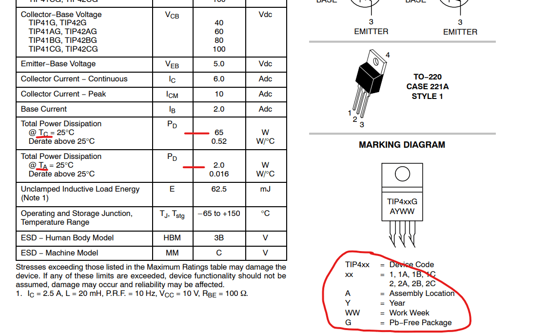

There seem to be 3 versions of TIP41C and TIP42C transistors. Two of them have additional letter suffixes, G & -BP. Those two have max power figures of 2W plus a specified transistion frequency of 3MHz. The version without additional letter suffix (TIP41C & TIP42C) show max power to be 65W but no transition frequency is given,
Because they will be output transistors, even though no transistion frequency is stated, I assume the 65W version is the one to get?
The 2 watt figure will be when at ambient temperature of 25C with no heatsink (free air operation) and 65 watt is when cooled with a suitable heatsink. The other letters denote lead free (Pb free) and where made.
The important thing is that they must be the C version which is the highest voltage rating.

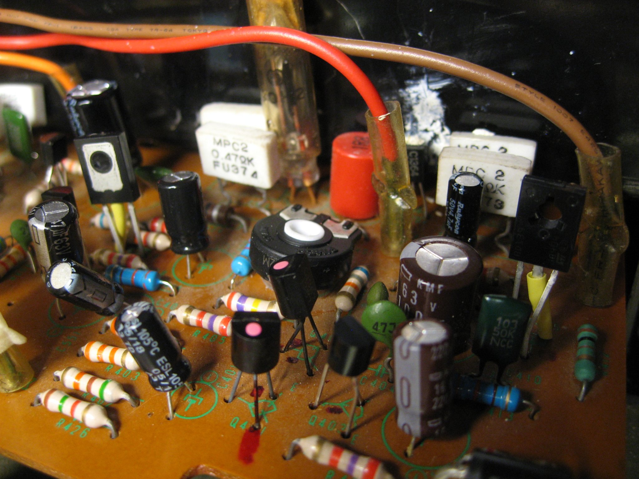

Yesterday I removed the jumper wire from the bases of Q405 and Q411. Then I installed the new right channel driver transistors. A BD139 at Q405 and a BD140 at Q406. I did not install any of the TIP41C or TIP42C as output transistors yet.
FWIW, I fitted the old Q405 transistor, a 2SC1124, in my cheap component tester and it's display identified that transistor as a resistor. I checked it not that long ago and it registered as a BJT transistor so it was seemingly OK. Somewhere in the inervening time, it got damaged.
After installing the new driver transistors BD139 and BC149 (no output transistors installed) in the right channel and powered on the amp with DBT and variac. DBT remained dark at full power on variac but after a few seconds I noticed wisps of smoke. It took a few times of powering up the amp to see what was smoking which turned out to be R415, R413 and R414.
First thing I did was replace those resistors with fresh ones then unplugged the entire amplifier board to examine it under better light. I thought I may have gotten polarity confused so I pulled those and installed fresh ones.
With that done, I reconnected the power amp board , turned on the amp, again with DBT and variac. As before, DBT was dark with variac up full and once more, I saw smoke rising, It was originating again from the freshly installed 1K ohm at R415. I shut off power so I do not know whether R413 and R414 would have followed suit.
I cleaned up the trace side of that board with acetone to get rid of flux and any Sharpie ink marks I left. As far as I can tell, which is a questionable observation, there does not look like any solder anomolies left from my unsoldering and resoldering of components. The traces are not crystal clear to see, because or the masking I am not viewing it under ideal conditions and my eyesight is not what it used to be so I can be overlooking something.
What reading I had done on 2SC1124 (original Q405) and 2SA706 (original Q406) had me believe their pinouts were BCE same as BD139 and BD140. I began to question this so I pulled Q305, still the original 2SC1124 and still good, and placed it in my component tester which identifies what each transistor leg is. Turns out, their pinout is EBC not ECB. So eiither I got it wrong from bad info or I messed up. In either case I will pull Q405/406 again and install yet more fresh ones in their place and adjust their orientation accordingly.

I have replaced all the burned resistors also the BD139/140. And I just now removed and checked Q403 which was a KSA1015. Q403 was damaged so there is now a fresh KSA1015 in place.
I have not proceeded further as in turning on the amp. At this time I am calling it a night. It's been a long day, I've been awake for 18 hours and do not wish to try falling asleep knowing the DBT glowed bright or more smoke was created.
EDIT: Both the new BD139 and BD140 are now oriented correctly. C legs and B legs are crossed and their C legs were insulated with yellow shrink tube.
